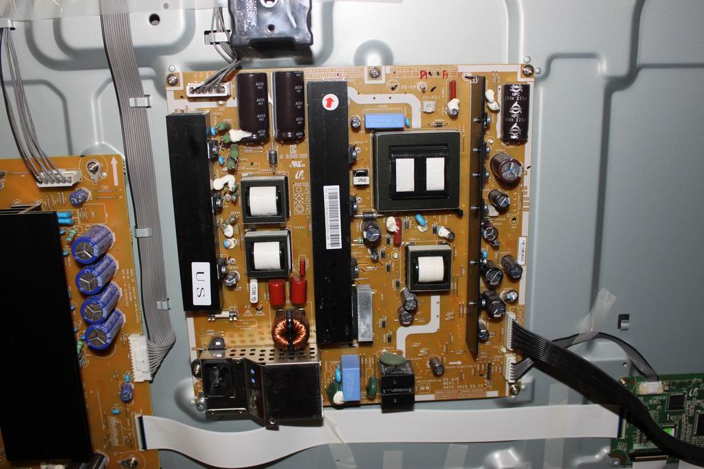

    I've got my 50in plasma that just gave up on me : no image, but sound is working.
    From what i have read, the cause is usually one of these three boards:
    - power supply
    - y sustain
    - y buffer
    I have done a visual check for blows caps and couldn't find any defective caps.
    I have check th AC fuse and it is fine.
    The 110VAC line is fine.
    The Va and Vs lines behave strangely:
    Right after power on, the DV voltage is near their nominal DC voltage (about 200VDC and 50VDC, but decrease until they reach 0V in about 20 seconds).
    (This is with all boards connected).
    Anyone have seen such behavior and could help troubleshoot the problematic board ...
    I don't mind replacing 1 board if it has a good chance of fixing the problem, but I don't want to end up replacing 3+ boards and spending almost 50% of the tv price tryinng to fixing it.
    Any ideas/tests/measurement that could help identify the culprit.

        Re: Samsung Plasma PN50C550G1F : no image, but sound is ok
        Need pics of PSU. Most newer Samsungs have protection circuits to shut down VA & VS when there is a fault on X ,Y or PSU.
        You can disconnect the cables that power the X & Y boards and force PSU on with a 1k ohm resistor to see if VA & VS volts are present and stable.

          Here's a pic of the power supply (BN44-00330A).
                            The resistor is for jumping the PS-on signal to 5vstby to power on, not for a load. You can use wire but it makes the VS volts read high.
                            Main board connector disconnected, this is where the resistor will go. Most Samsung psu's jump ps-on to 5.3v stby to force on. It actually only needs > 2.5v that's why the resistor is needed. Some also have a VS-on that needs a jumper also.
                            According to pic here http://assets.shopjimmy.com/media/ca...330a-top_1.jpg
                            You need to jumper CN802 pins 1 & 2 with Pins 5 & 6 w/ 1k resistors to fully power up psu. No connections to other boards.
                            Then check for 15v on CN801 and VS & VA volts at their test points.
                                Ah ok, so it's like a PC power suppy, where you ground a wire to let it fire up...
                                Sorry, i misunderstood the instruction in the first place...
                                So basically, I disconnect all connectors from the power supply and short (using the resistor) the specified pin to activate the power supply.
                                Then I should be able to verify the different output voltages to see if they are at their expected levels?
                                    PS-ON needs to go LOW (active LOW), VS-ON goes HIGH (active HIGH) this will turn on low voltages and high voltages (~200V, ~60V Vs/Va)
                                    This is for Samsung, it is different for other brands, most use active HIGH for both PS-ON and VS-ON.
