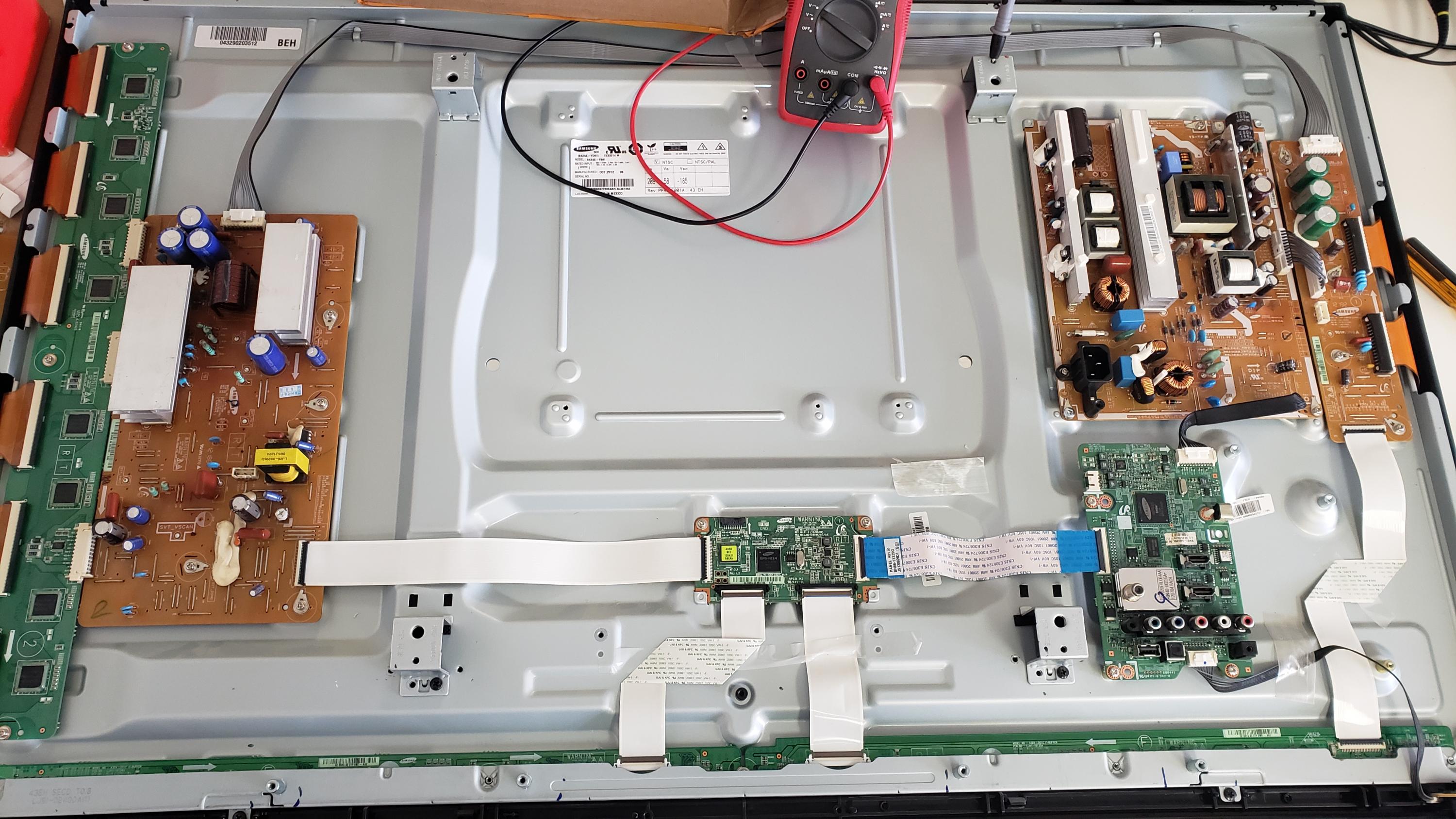

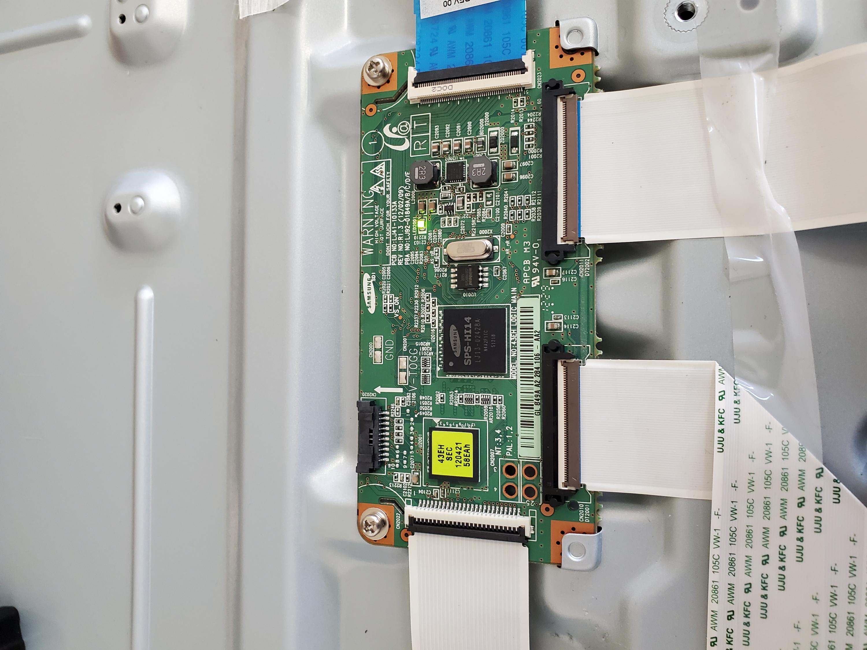

    The customer of this TV Heard a pop sound before it went dead.
    The VS and VA voltages turn on imediatly and then slowly die off.
    I got a replacement Y-Board (Large board on the left) from aliexpress and still no luck
    If tested all the IC chipson the board all the way on the left by running meter along the connectors and couldnt find any shorts there...
    I think ive checked most the capacitors for shorts as well as most of the diodes and mosfet/transistors on the big boards.

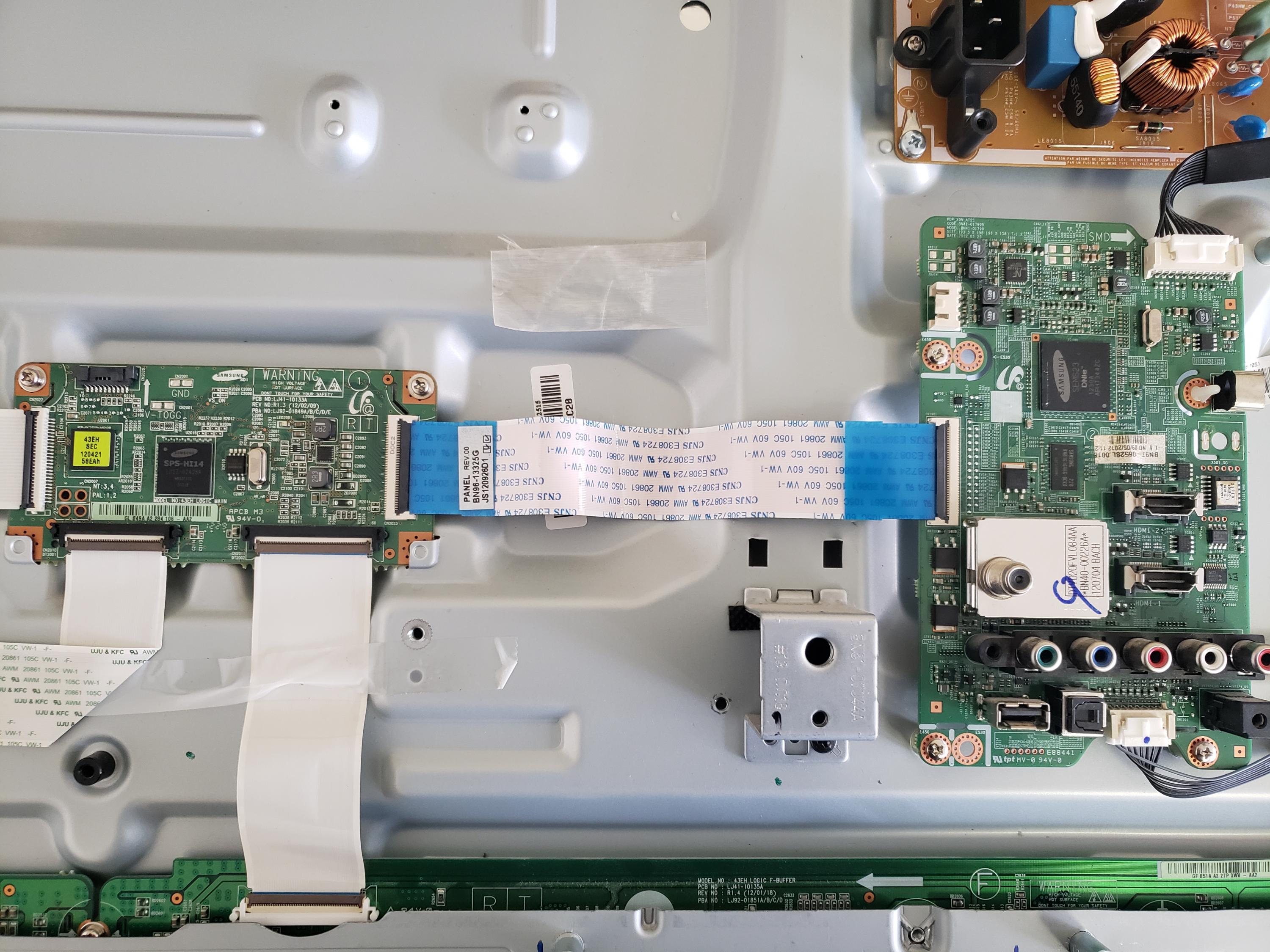

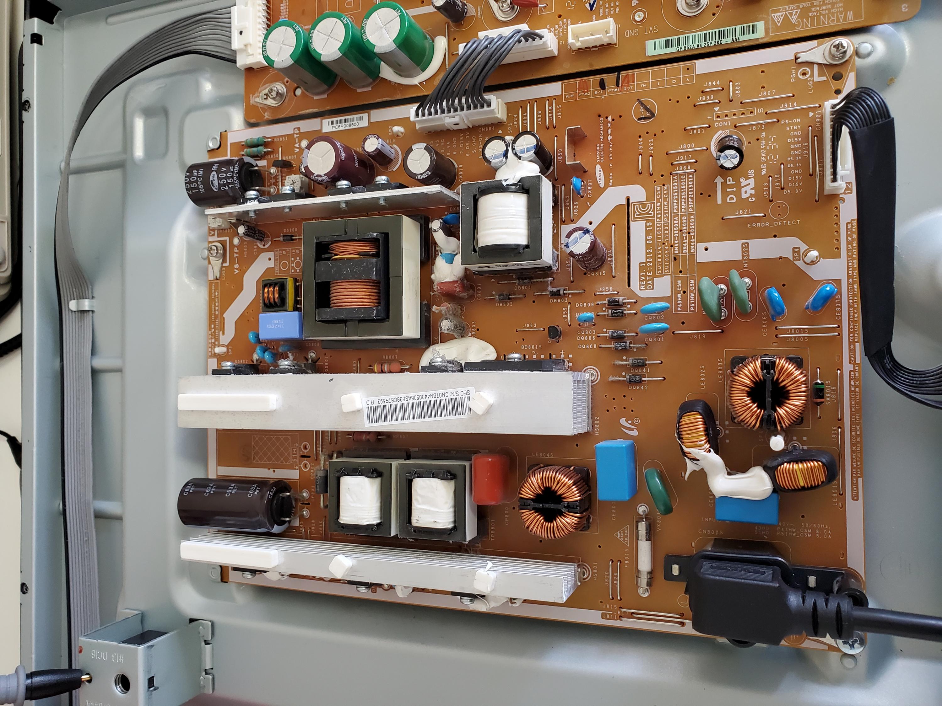

      Thanks, Here are the pictures..
      I forgot to mension a few things.
      Once you hit the power button the green LED on the small board in the middle blinks one second on on second off.
      Also the customer said that after the pop and no picture, the sound was still working.

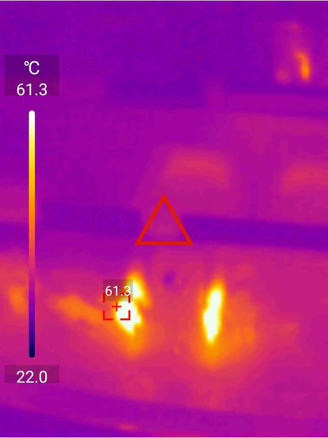

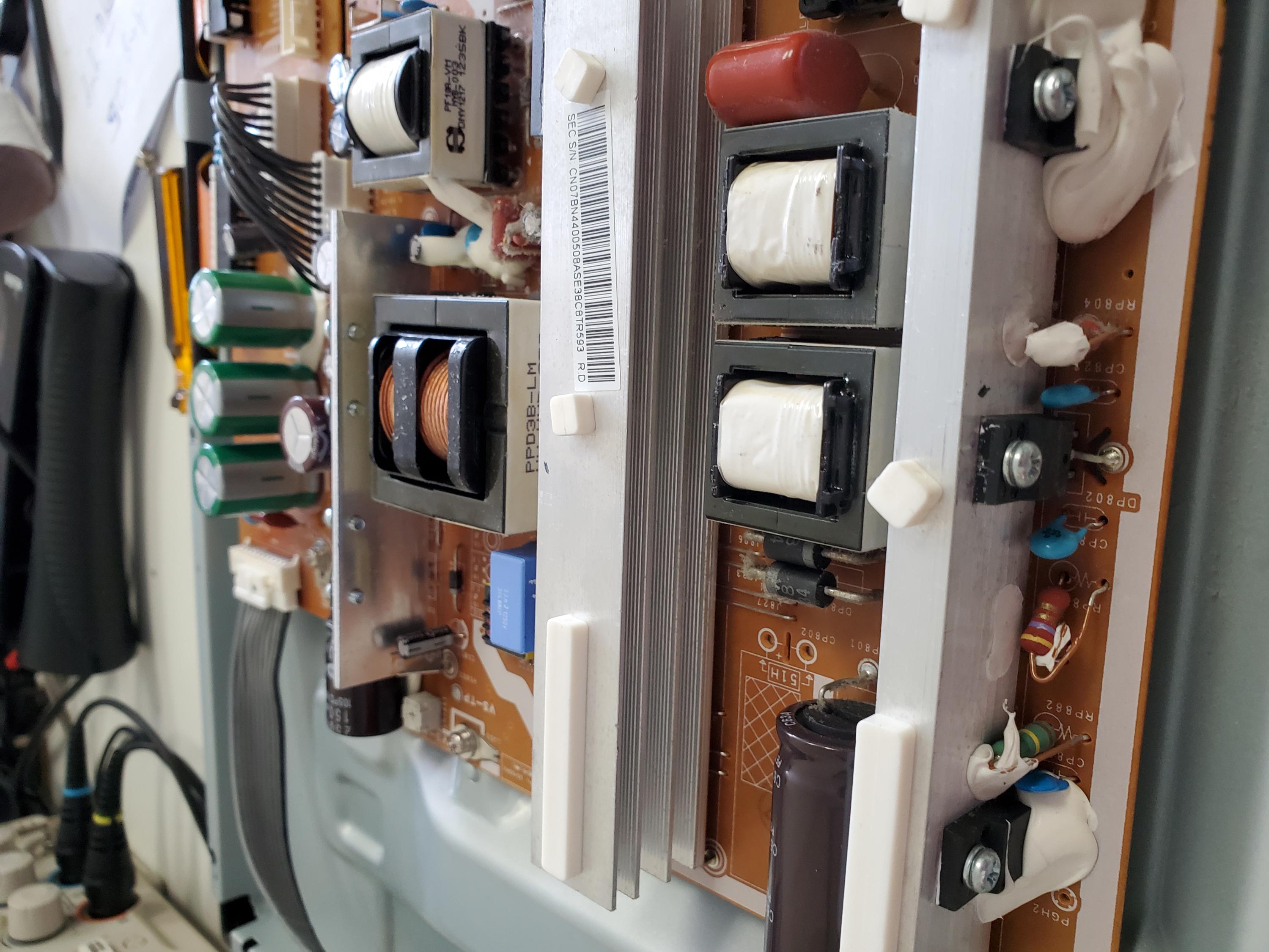

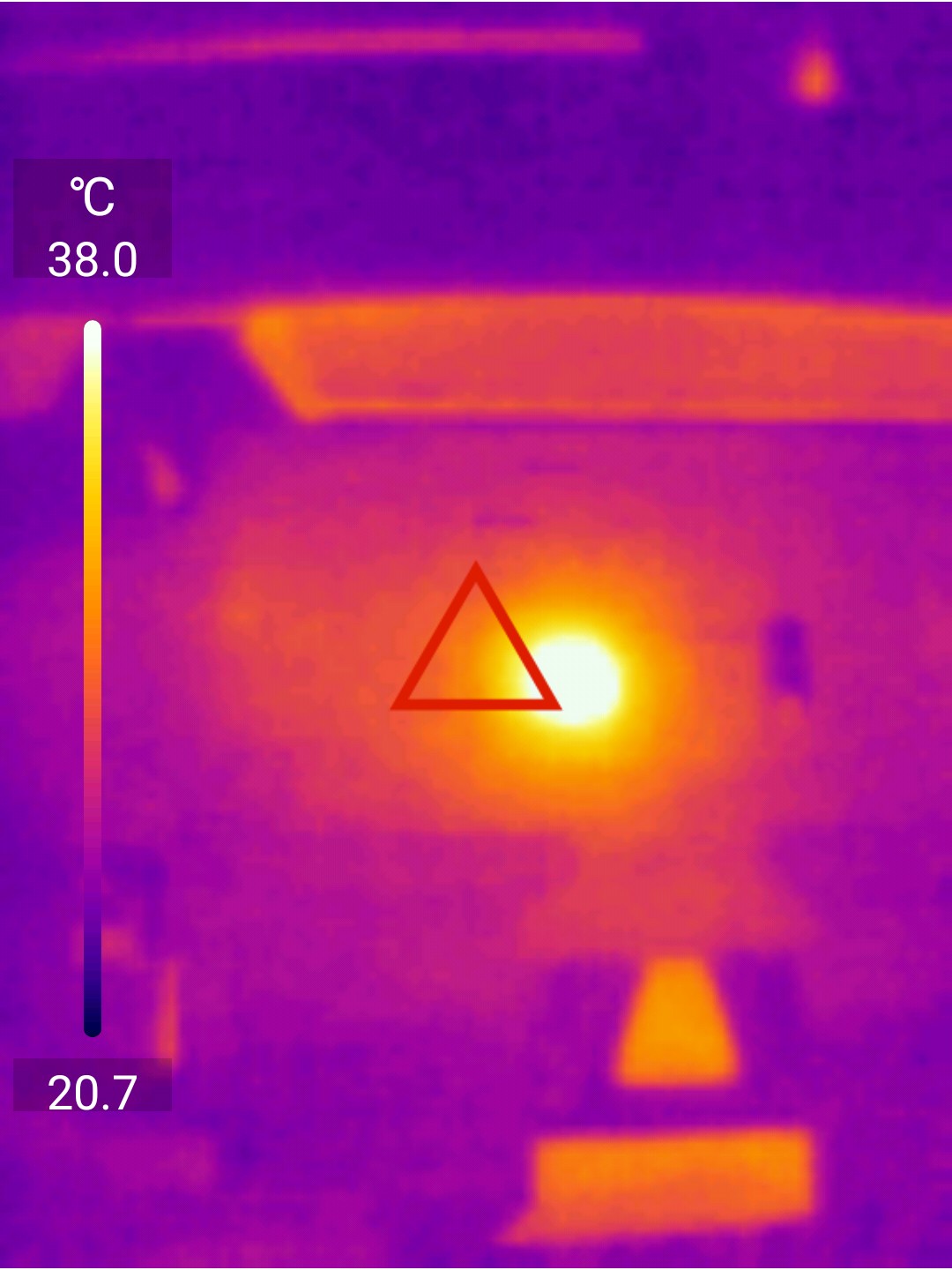

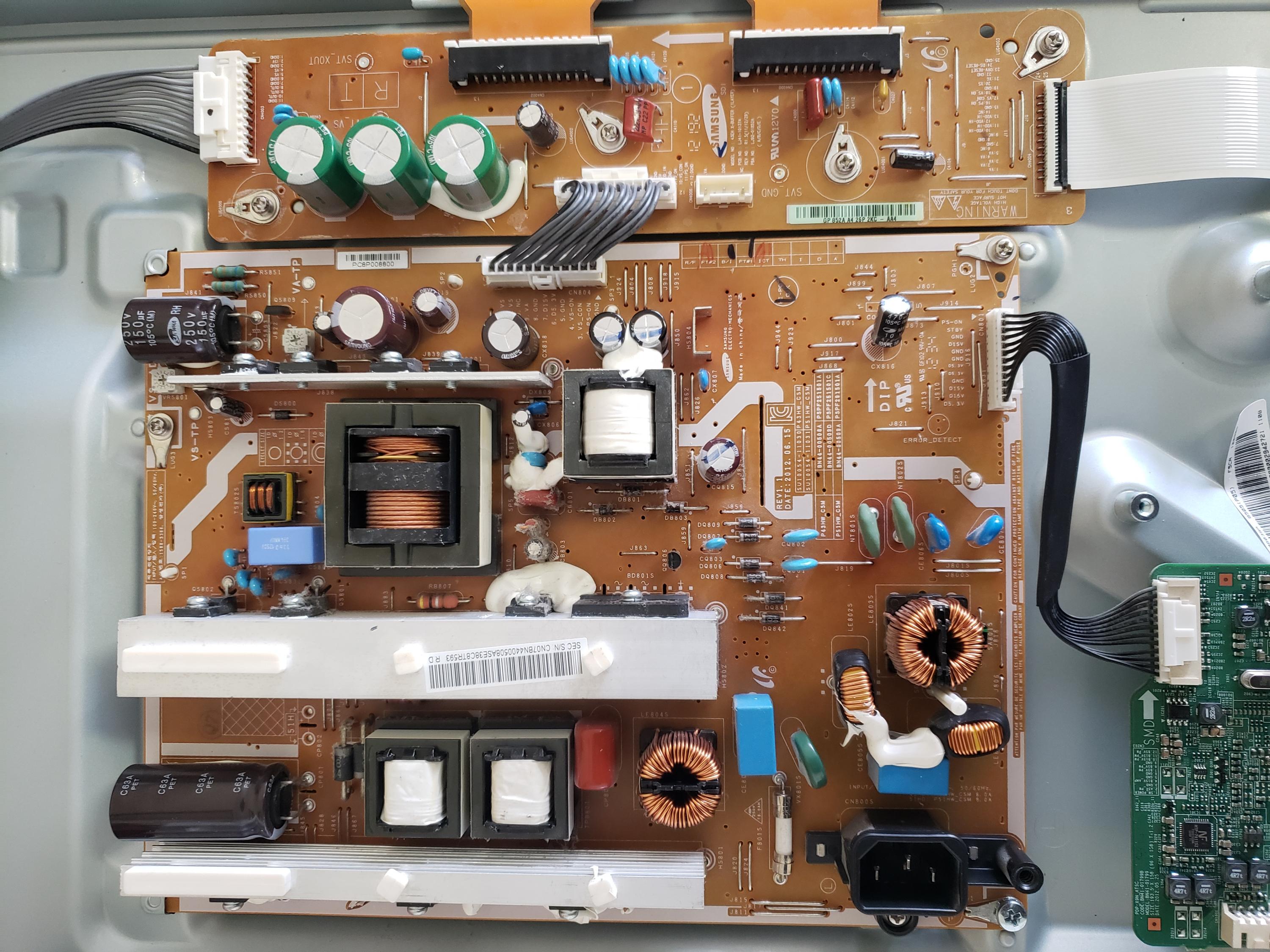

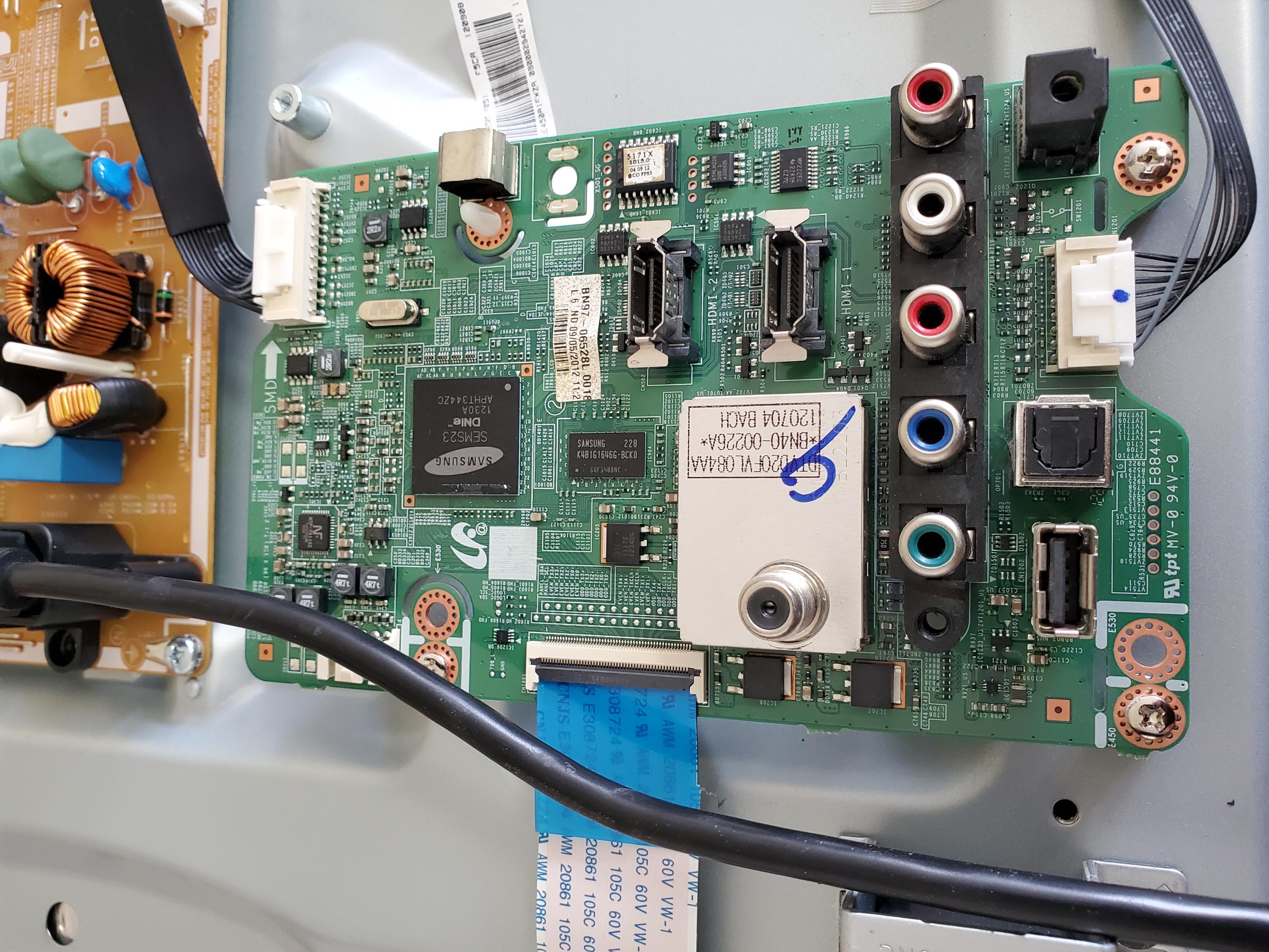

        In the last set of pictures, On the main power board, there are two small blue ceramic capaictors that are getting hot. They are on both sides of double diode attached that heat sink.
        I took the double diode out. Tested a short on the board and injected voltage... the transformer in the middle of picture got warm.

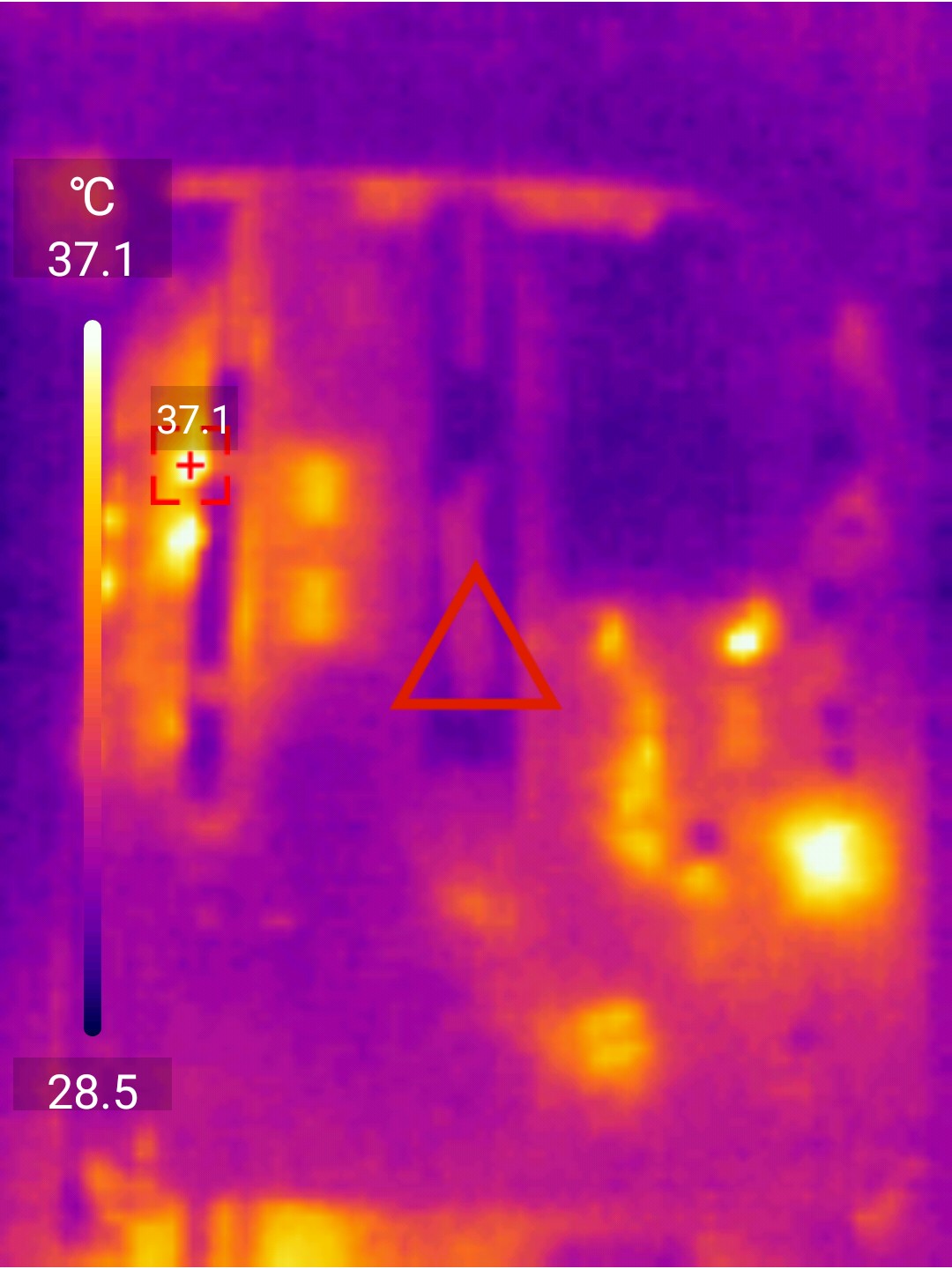

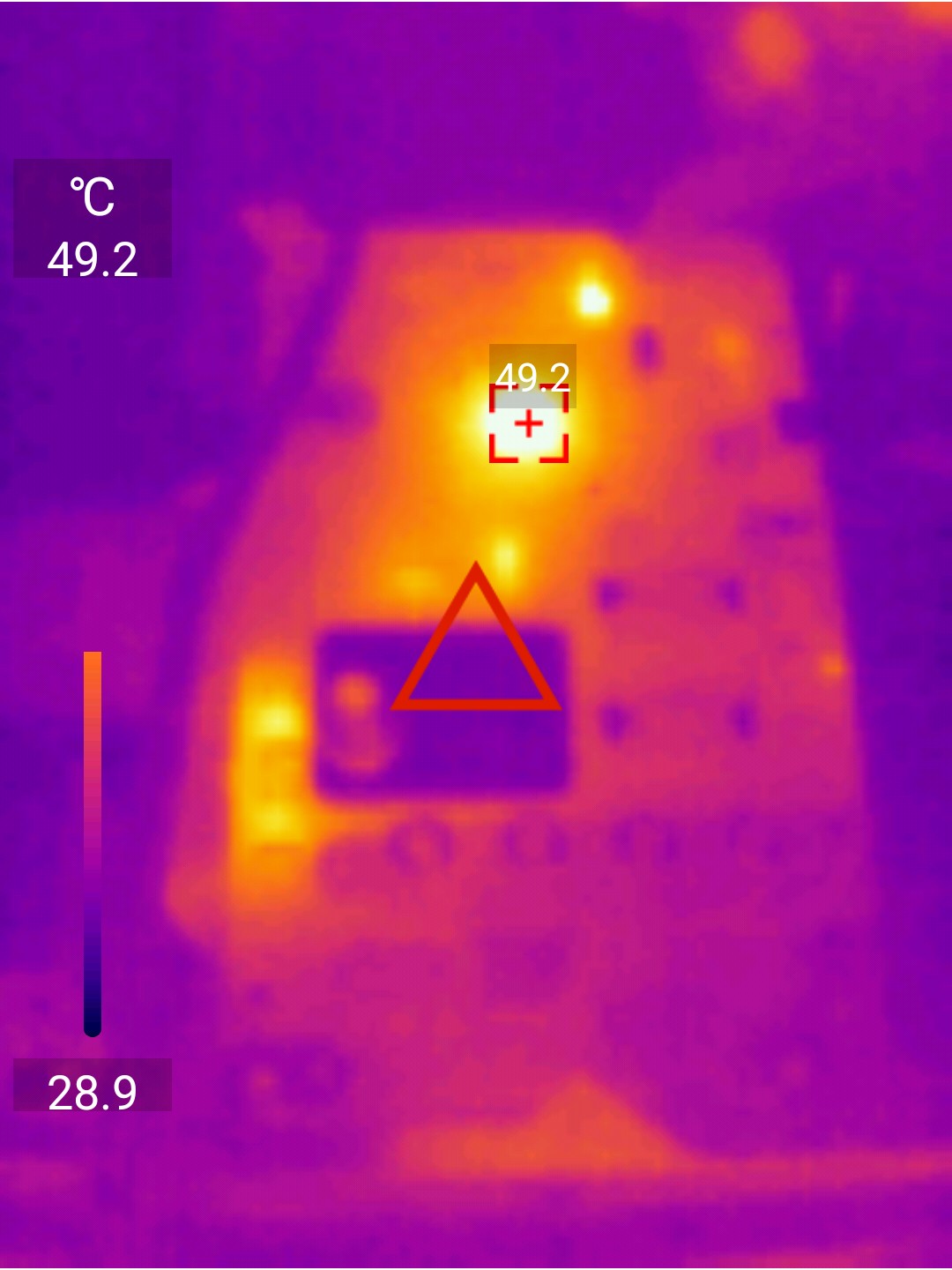

        As for the two smallest boards, i havn't touched those at all. The big chips on each one are getting warm.

          If VS/VA go down slowly it means the psu is disarming because the mainboard signaled a shutdown, check the leftmost and rightmost boards(x-main and y-buffer) for shorts, and this board you bought too if there's anything wrong with it.
          I recently repaired the Y-SUS of this TV, and there were a lot of possiblibly bad solder joints especially in the ceramic capacitors.

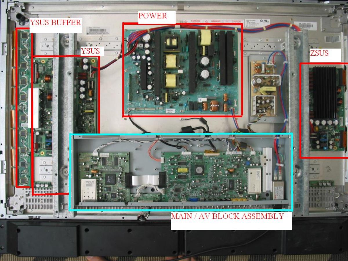

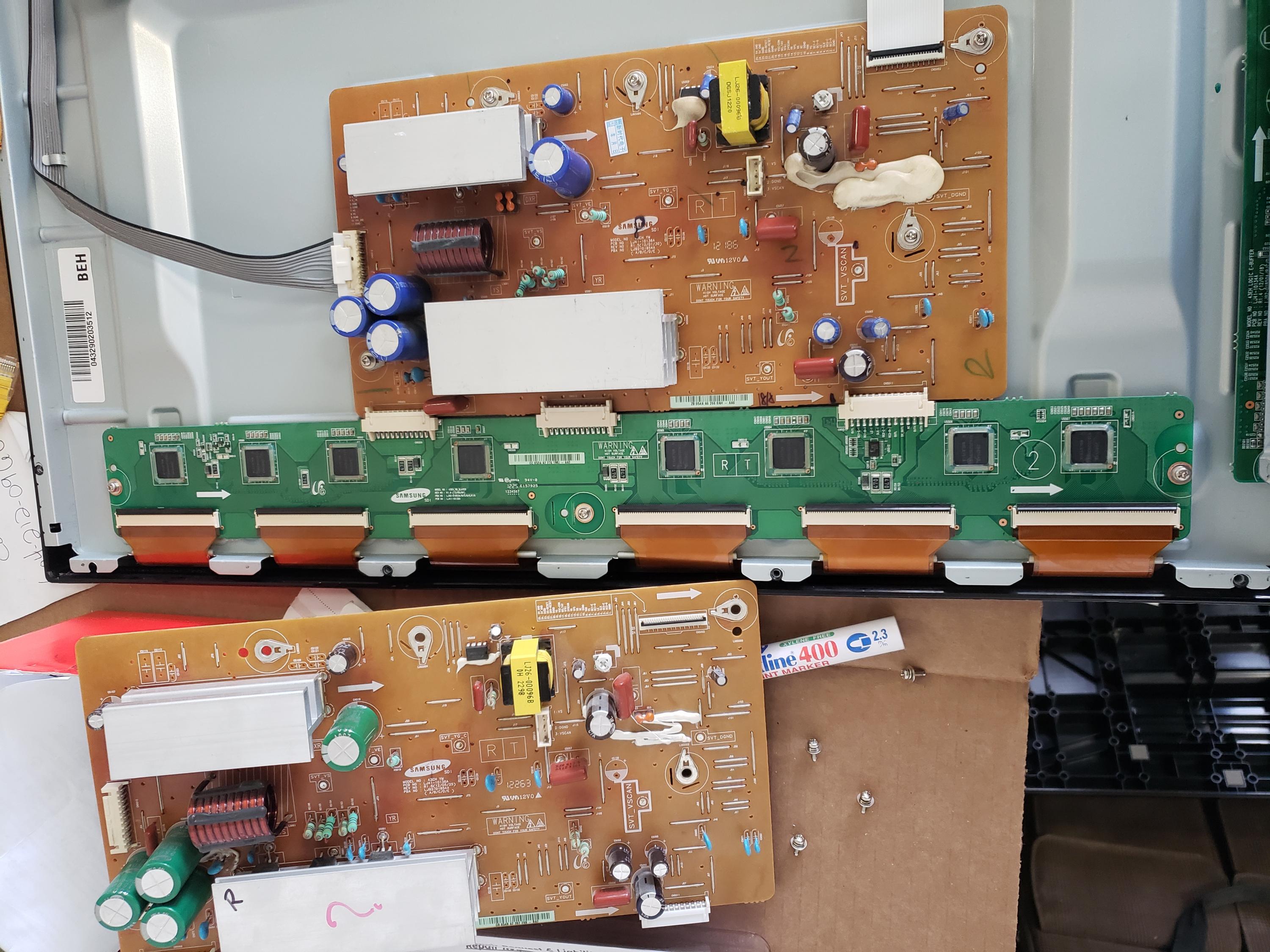

            Dangit, found 3 bad IGBT chips on the Aliexpress Y-Sus board.
            What is odd is that one of the chips that was shorted was also shorted on the original board..."FDG4536"
            Could it be possible something shorted on the YSUS Buffer board is toasting the mosfets on the Ysus Board. Or it came that way?
            Spent a bunch of time today double checking mosfets and solderjoints, cant seem to figure it out with meter...
            Would it make sence to try and trace the VS and VA lines and try to figure out where exactly they go? Or perhaps inject voltage into the sus boards...
            PICTURE IS JUST FOR REFERENCE OF BOARD NAMES. NOT WHAT IM WORKING ON
