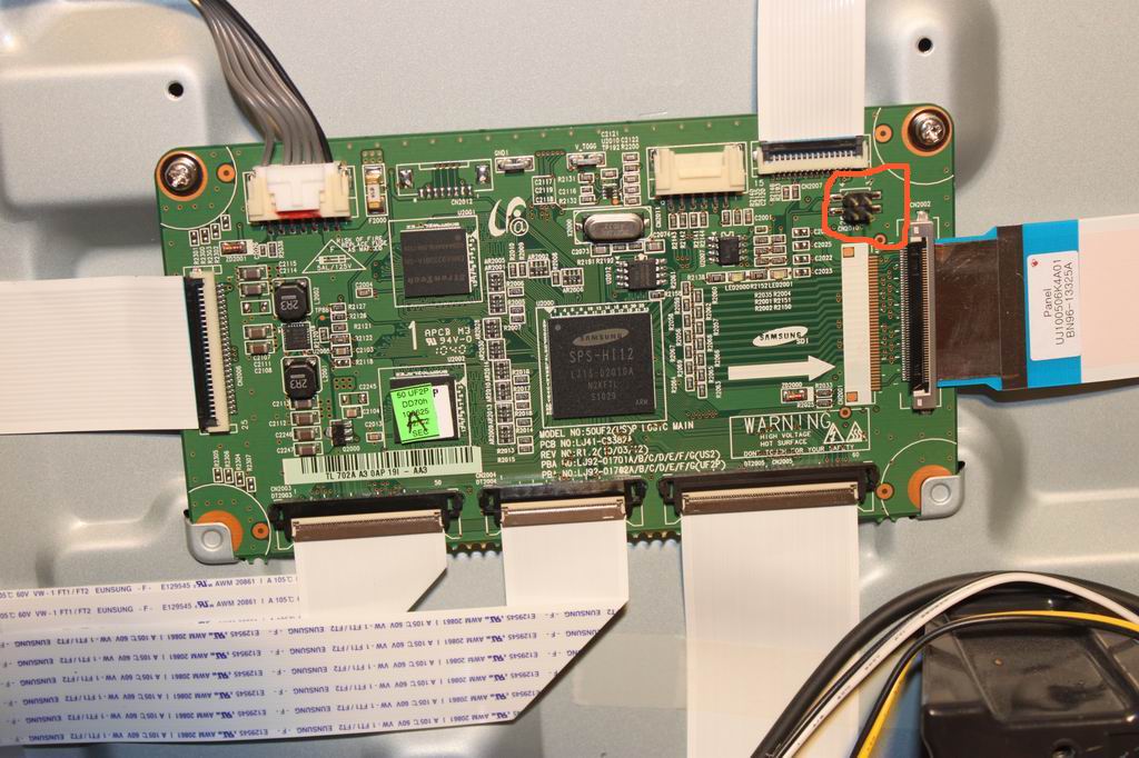

    #41
    Re: Samsung Plasma PN50C550G1F : no image, but sound is ok
    Originally posted by tom66
    It's a little four pin connector, 0.1" spacing, square in shape and should not be connected. Vetical. Pins marked 1, 2, 3, 4. There may be another connector but don't use that as it's probably the programming header.
    Thanks Tom66 for the clarification... At first, I thought you were talking about that programming header connector. I have located the 2x2 diag connector as shown on the picture.
    i'll install the jumper on it and also on the PS-ON pin of the connector and run the tests and report the results.
      #42
      Yep that's the one.

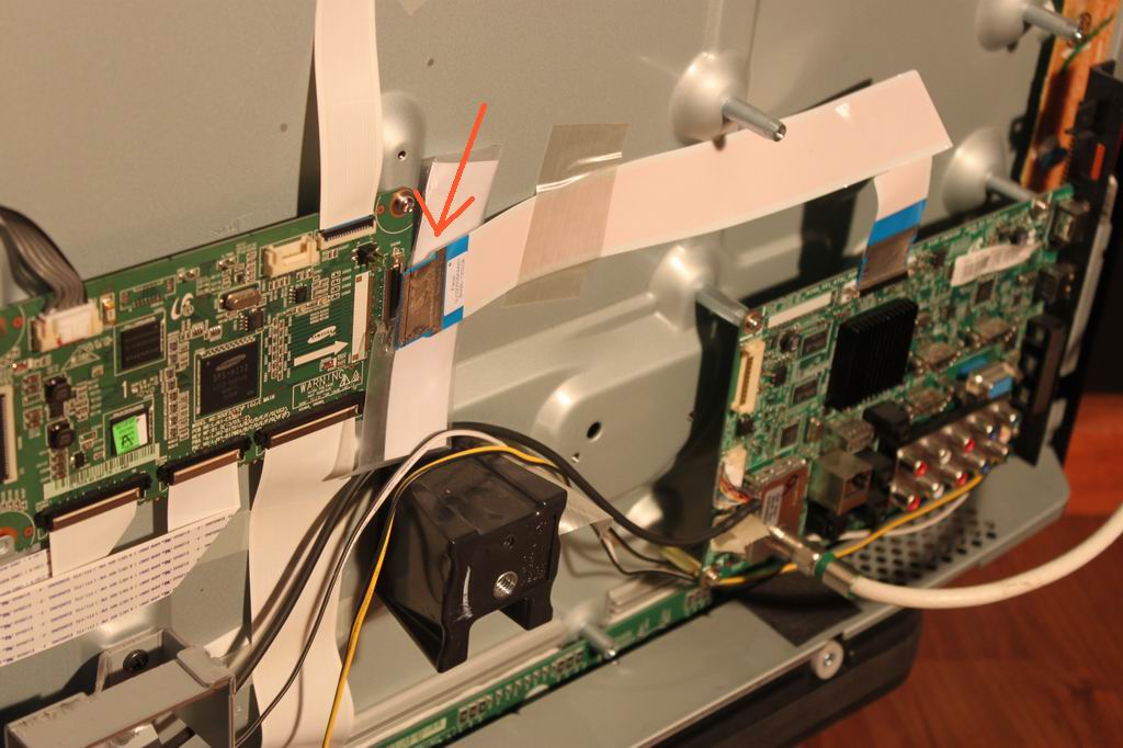

        All right,
        I have disconnected the really thin flat data cable connecting the logic board to the A/V board (LVDS cable).
        I have disconnected the ribon cable between the PSU and the A/V board, and added a pull down (80 Ohms) on the PS-ON pin.
        I added a jumper on the diag connector of the logic board (pin 3 and 4).
        As soon as I turn the power bar on which the TV is plugged in, the power supply turns ON (It clicks like when I press the power button when everything was connected).

          #44
          The LVDS I have disconnected is the one shown in picture
