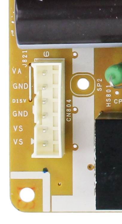

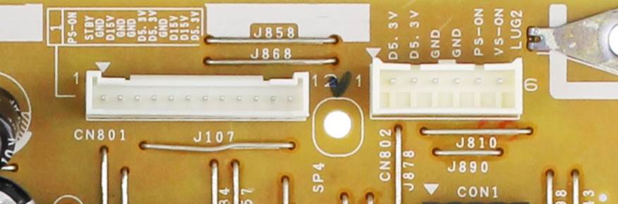

DISCONECT ALL 3 CABLES
I disconnect the CN804 that is connected to the Y-Sustain board.
I disconnect the CN802 that is connected to the logic board.
I disconnect the CN801 that is connected to the main A/V board.

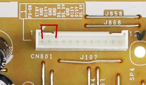

JUMPERS:
Install the jumper on the CN801 cable?
i'm asking, because in your post, you're talking about the cable connected to the main A/V board (CN801) and that cable is wider/larger than the CN802, but tinner... Also, that connector only has PS-0N that seems relevant.
The CN802 on the other hand has both PS-ON and VS-ON, and in previous posts, MagicSmoke told me to drive them to activate the PowerSupply and the Vs DC line ...
