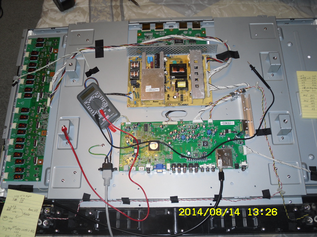

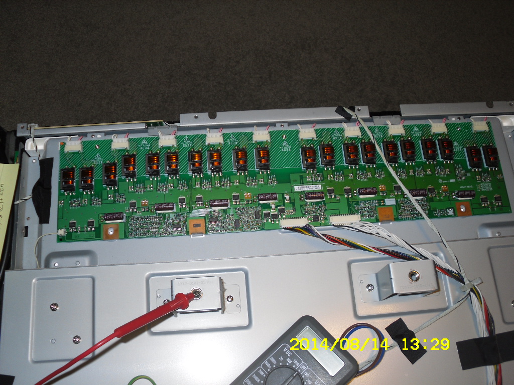

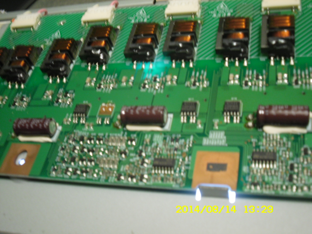

    I've done several hours of research. Found the common issue with Vizio's is the U33 and not powering on completely, but that isn't my symptom, and my meter readings indicate the regulator reads ok, based on values I've seen posted here.

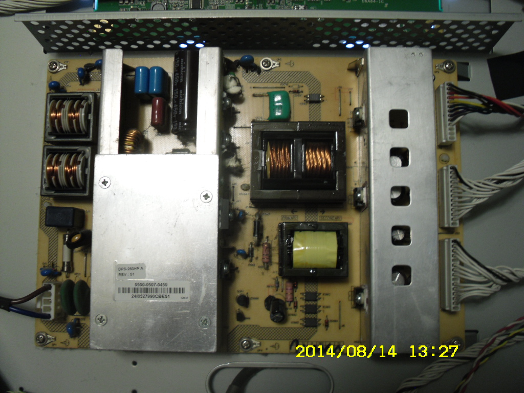

    Powersupply readings
    24V lines both read 23.7v
    2nd 24V lines both read 23.7v
    12V lines both read 11.9

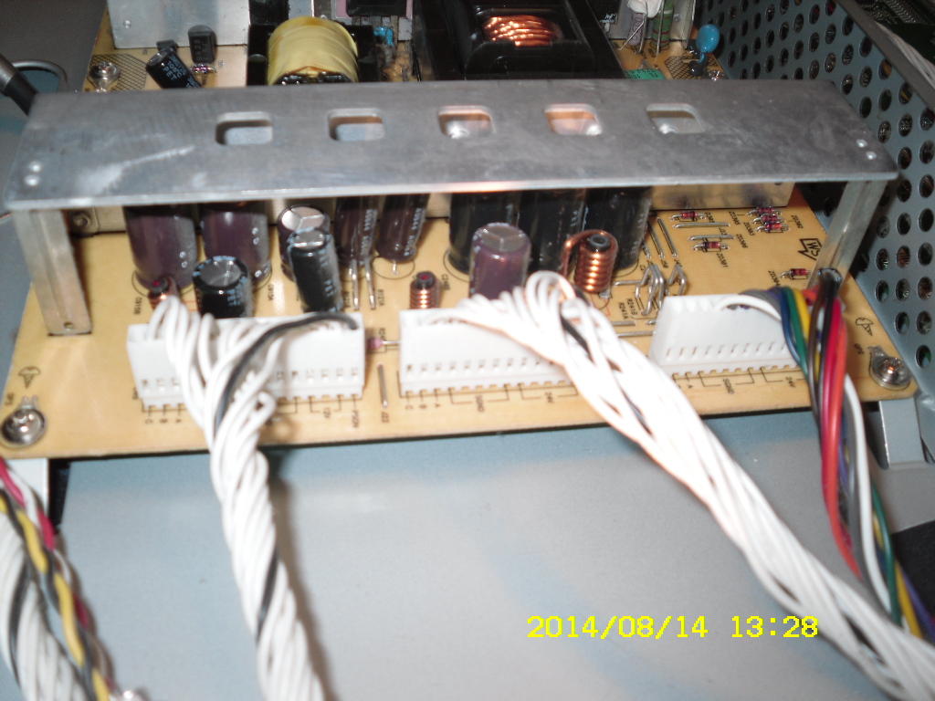

    I've looked over the capacitors, all seem to be flat. No noticable bulging and definitely no bleeding of any kind.

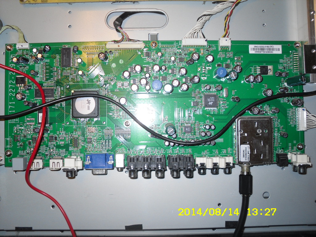

    regulator readings
    U7 - 3.29 / 1.27 / 0.03
    U9 - 3.29 / 1.50 / 0.01
    U33- 5.03 / 3.29 / 2.05
    U8 - 5.08 / 3.30 / 2.06
    U2 - 5.04 / 3.30 / 2.06
    U4 - no chip from factory
    U3 - diff style chip 11.82 / 0.01 / 5.01

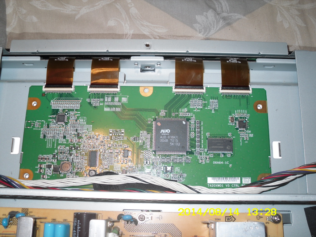

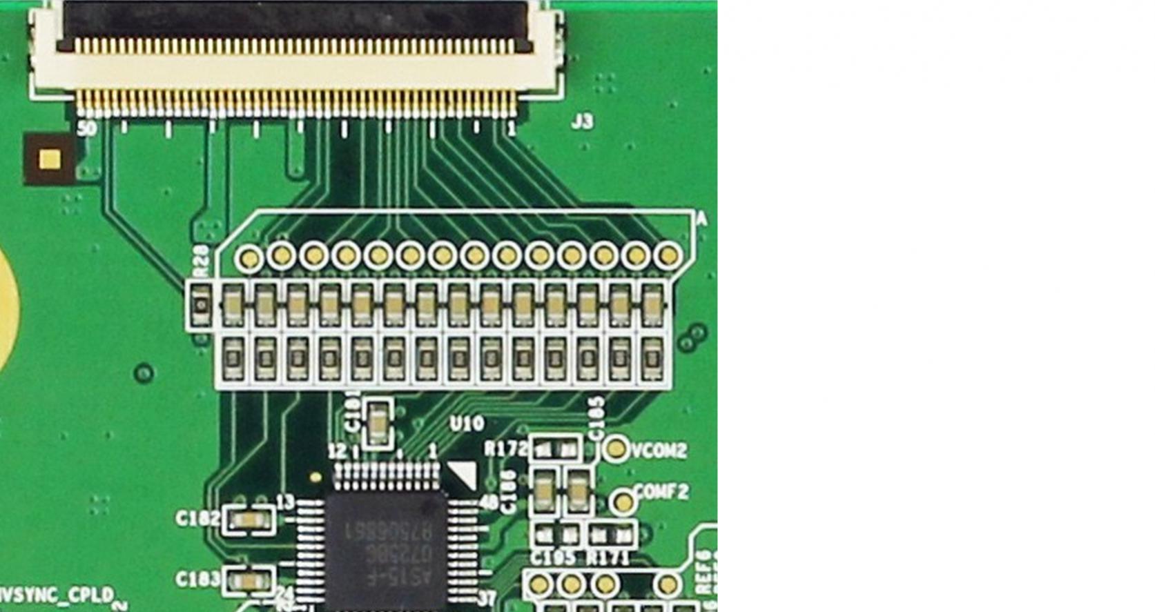

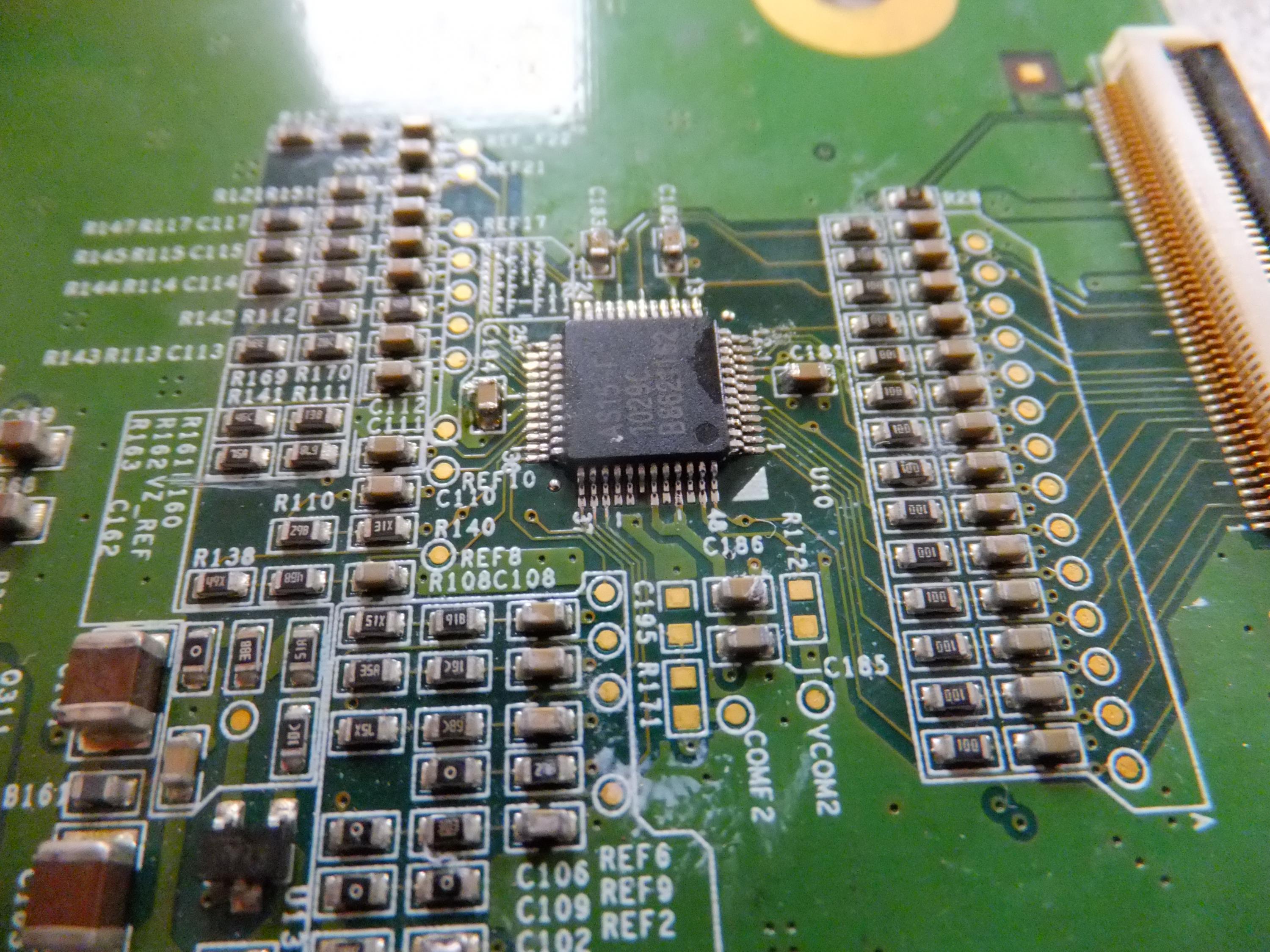

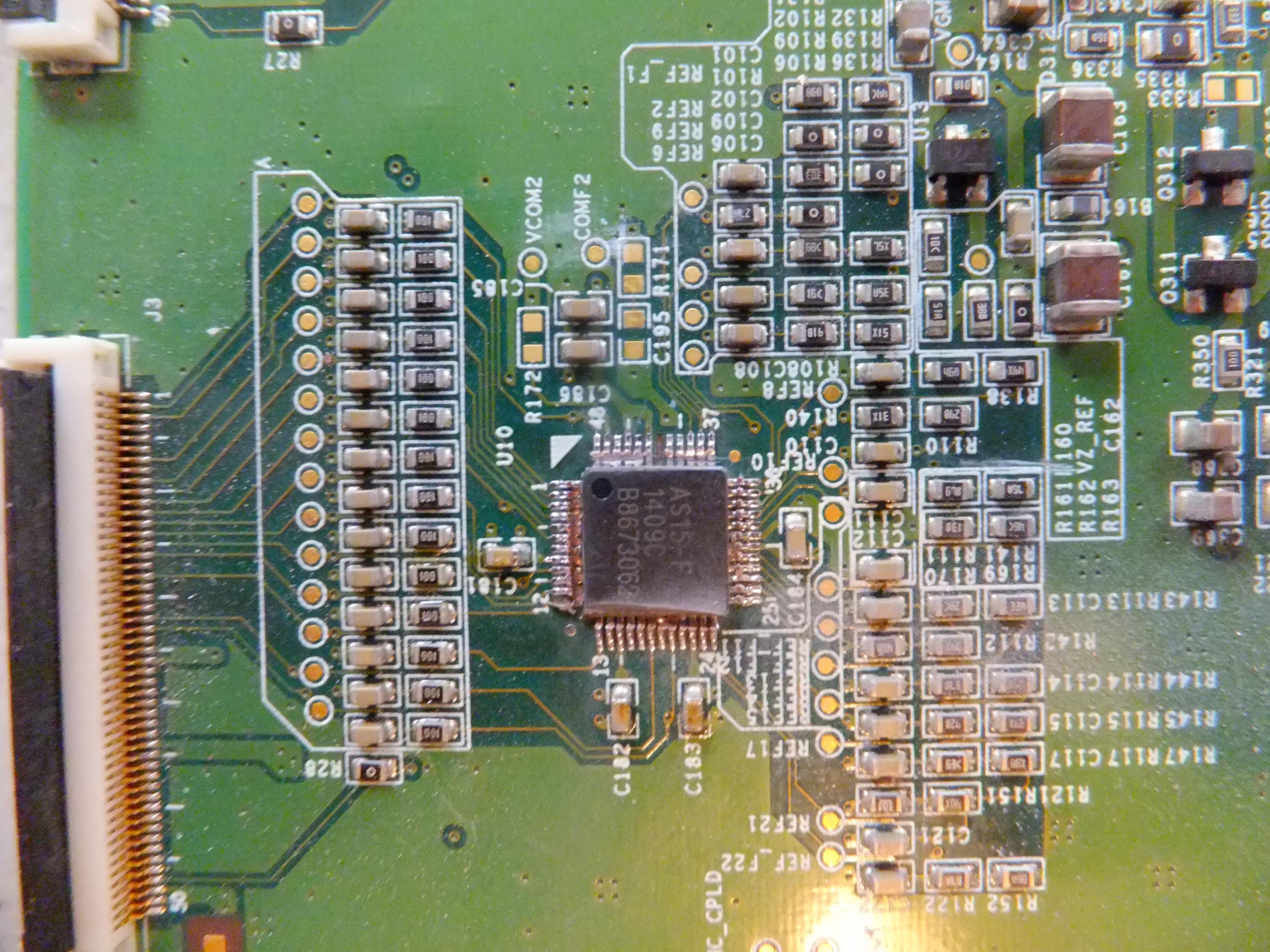

    Top left corner of your AUO Optronics t-con board there is an AS-15 chip, see the copper pads under the two cable connectors, test those voltages and report back.
      Re: Vizio VX42L - functions fine, but bad colors
      Thanks for the quick response Shinju - I grabbed an image off shopjimmy as I couldn't get my resolution high enough - same setup as mine
      https://www.badcaps.net/forum/attach...1&d=1419967122
      Attached image - R28 values, left (closest to R28) to right:
      0.31
      8.40
      3.94
      5.03
      4.87
      6.30
      6.58
      7.76
      7.98
      9.31
      9.42
      10.41
      15.09
      15.33
        Yes that is a defective AS15-F

                  I dont think it is a matter of "correct" voltages as much as the progression so on yours a 12 followed by 3 10s and then a 15 would indicate a problem

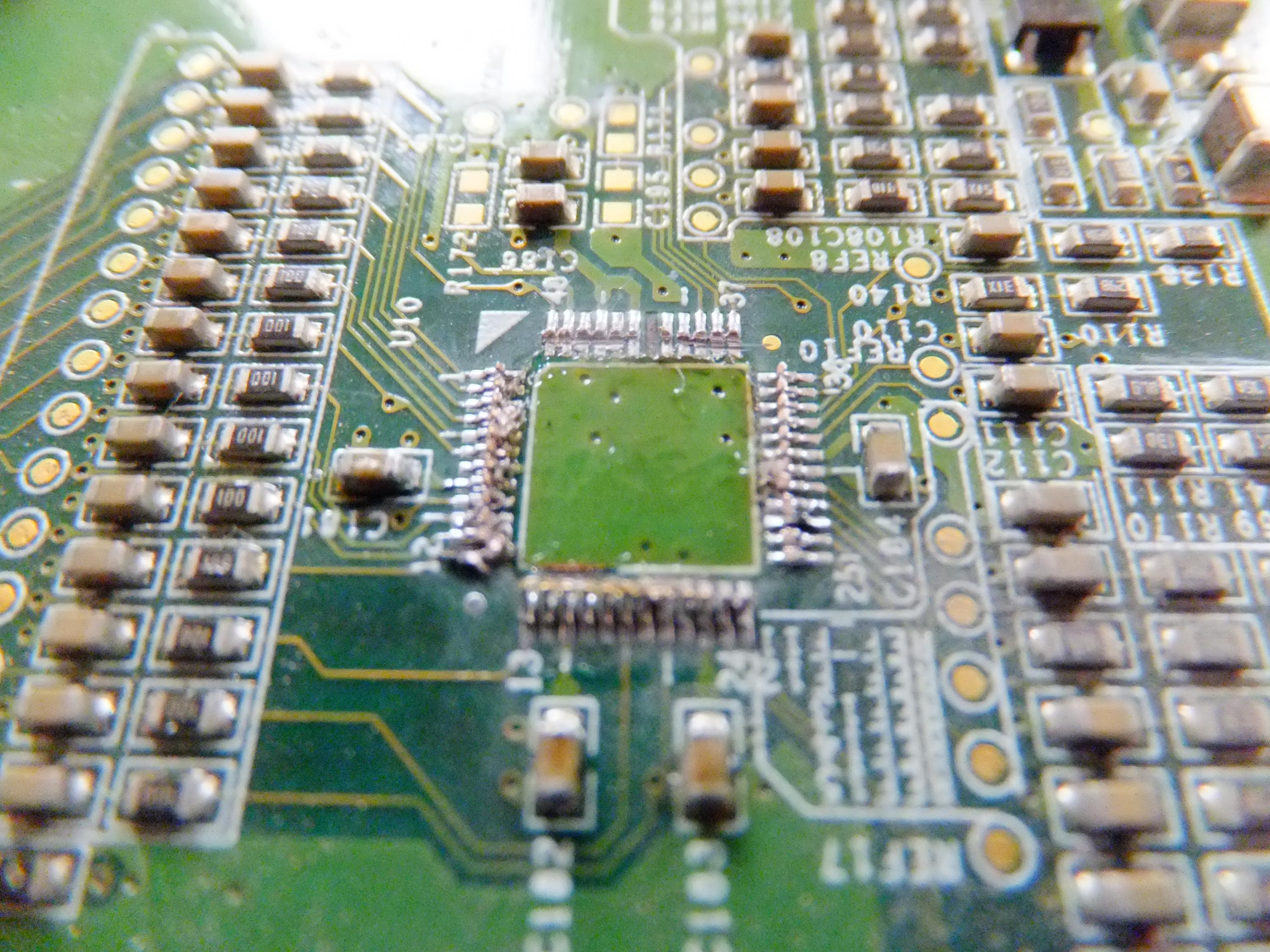

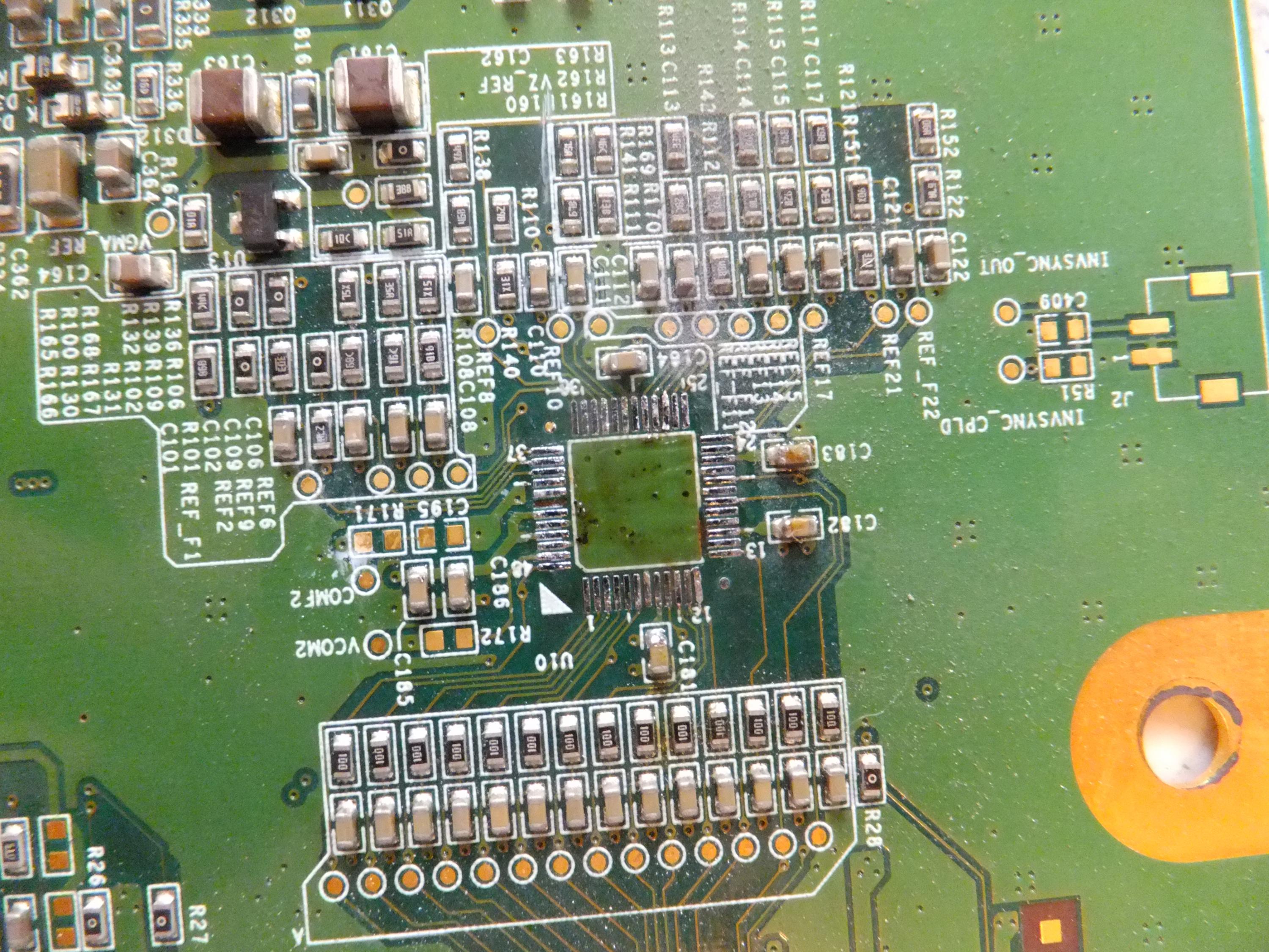

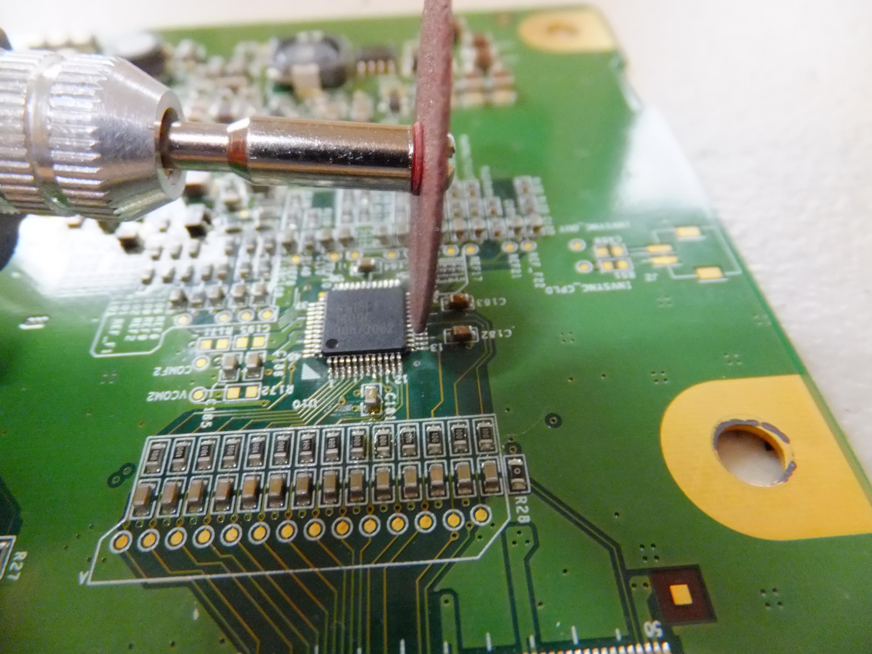

                      So I tried to replace the as15 chip. I should have practiced a bit more. I bought several. I got the first one on, but no picture. I wasn't the happiest with the soldering job. I have to give you guys that do this a major kudos! I had problems even getting the chip off. I eventually had to flow a bunch of solder on and heat in a circular motion to remove the chip. Got the new one on, but not the easiest to just hit the pins. Some people I saw just flooded and cleaned up with solder wick. I cleaned up what I could but no luck - that was the blank screen.
                      I tried to put the second one on, but messed up the leads off the board.
                      Oh well. It was fun to try.
                      Thanks for all the feedback - I do appreciate the time taken to read and respond.

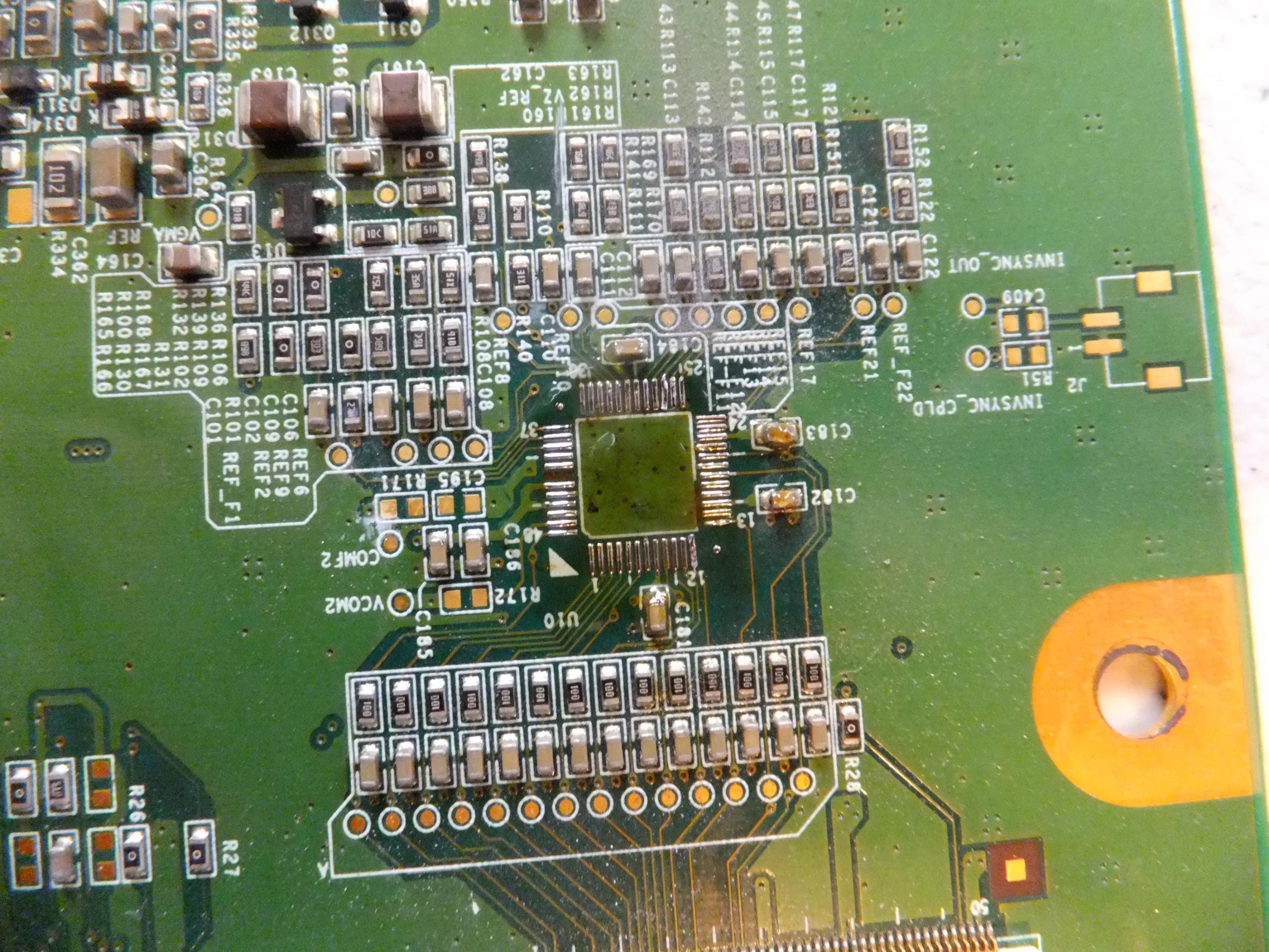

                        I cut my AS15-F chip off with a dremal, that is the easiest way. Then I remove the legs with the soldering iron. Then I use flux and add solder to all the spots but not a whole lot. Then I put it in place and use a 15w iron. I messed one up already but I got another one to try. I think the trick is to lay the chip on the solder spots and just touch each leg for one second enough to make a connection, if you do it longer you may burn up the chip. And I am only going to do one leg at a time. I will do one leg and then wait a minute before I do another one. Just touch it for a second and no more.

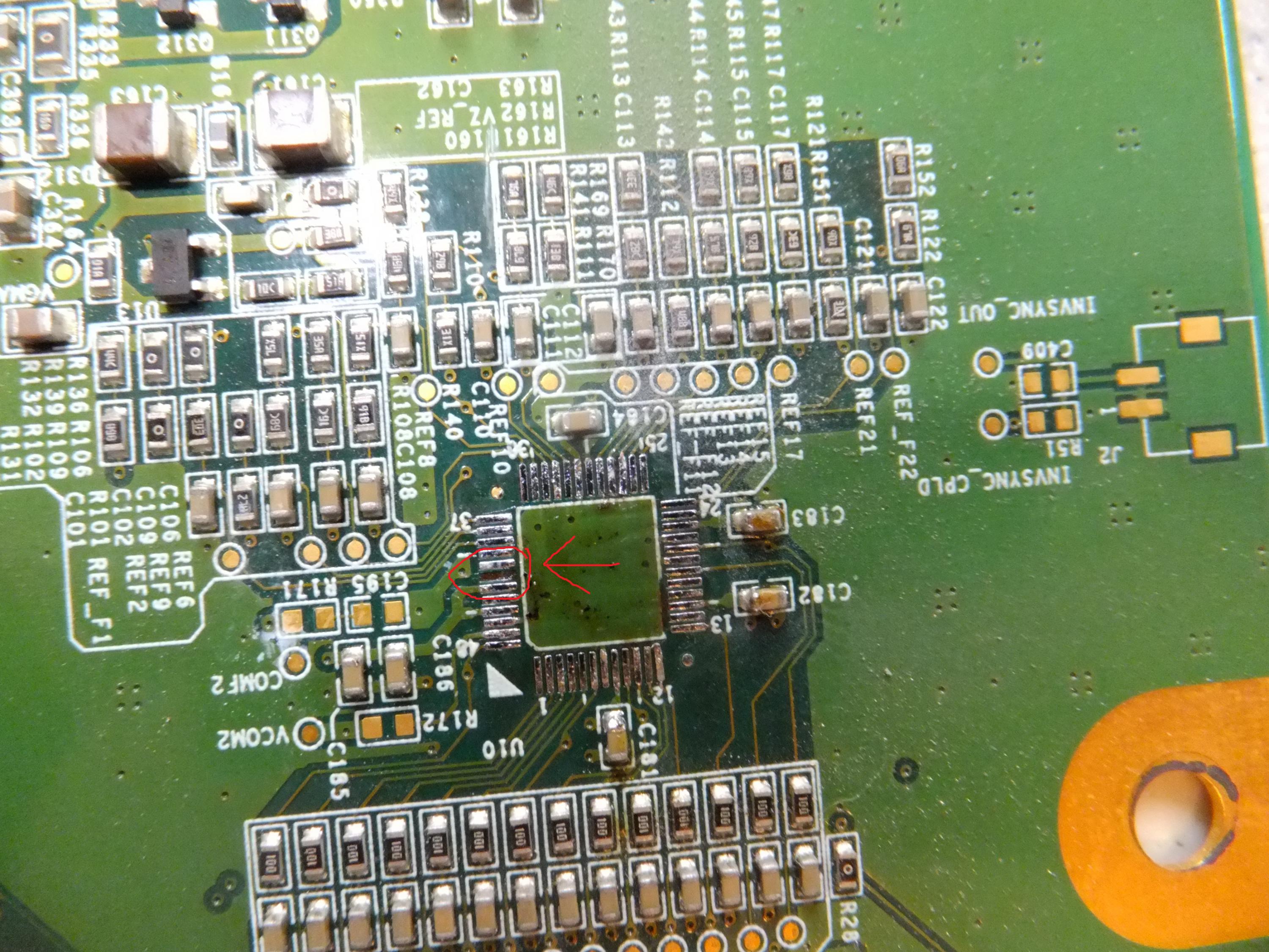

                          OK, well I put another chip in the TV and I was real careful like I stated. I put the solder down first on the board, laid the the chip on it and just touched each leg for a second, looks good. I noticed one leg was not connected to anything and I guess I tore that part off the board but from my pictures it does not seem important. But the TV is not working so maybe it was important. It is pin 42 so if anyone has a picture of a board with the chip off or knows I did a boo boo I would appreciate the comment. I added pictures. So now when the TV turns on the logo turns white and the backlights flash once real fast. So I can't get the voltages of a good working board yet because it is not working. I guess I may have to cut this chip off and try again.
                              Probably not - could be a bad LCD panel or the T-con you got is bad.
                              The pad you have removed is a no-connect pad so should not cause problems. However I have found the AS15-F chips to be incredibly fussy and often defective out of the package. I would try a second one, if possible.
