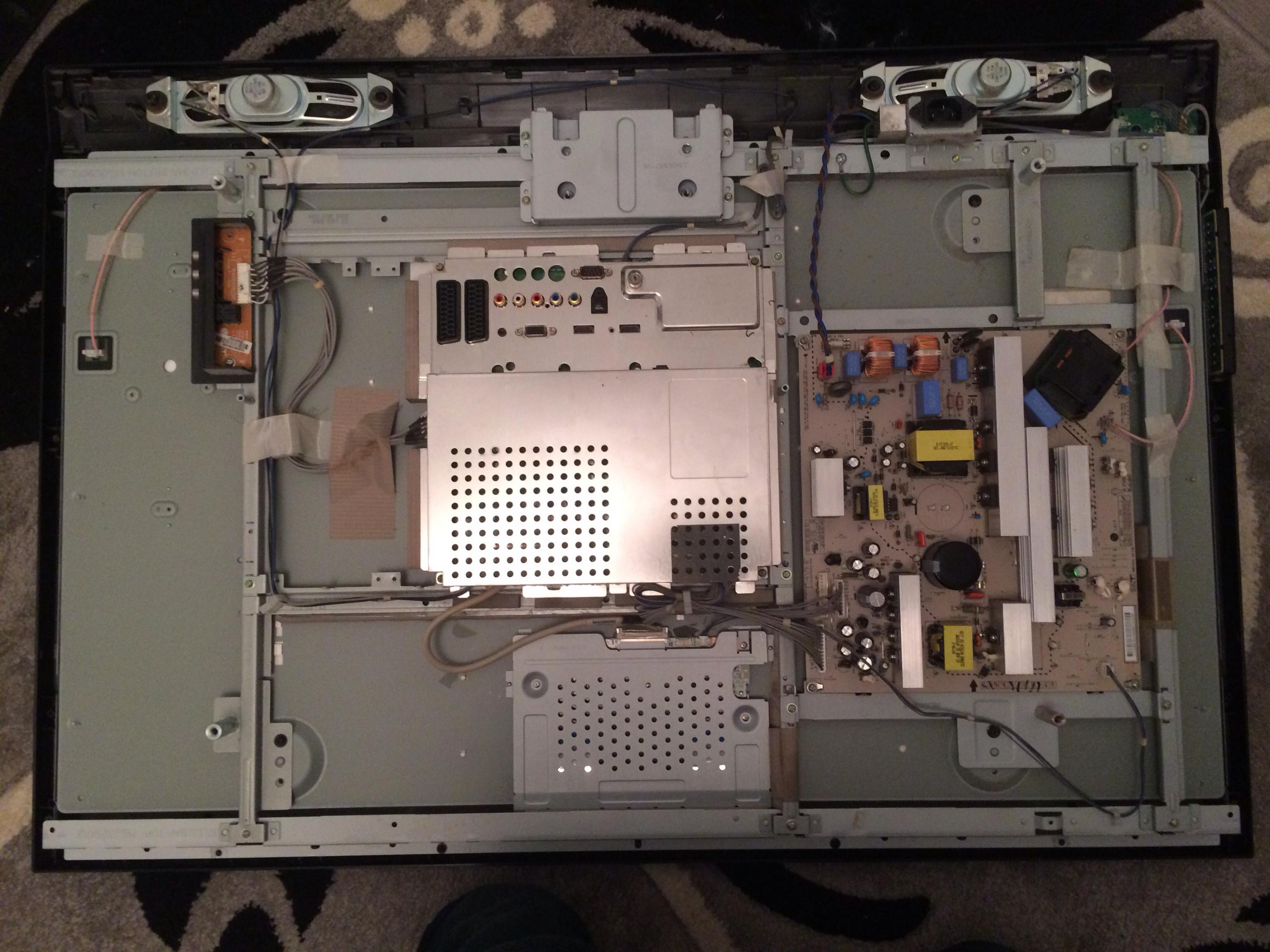

    You need to include model number of the TV & supply photos of the parts inside the set.

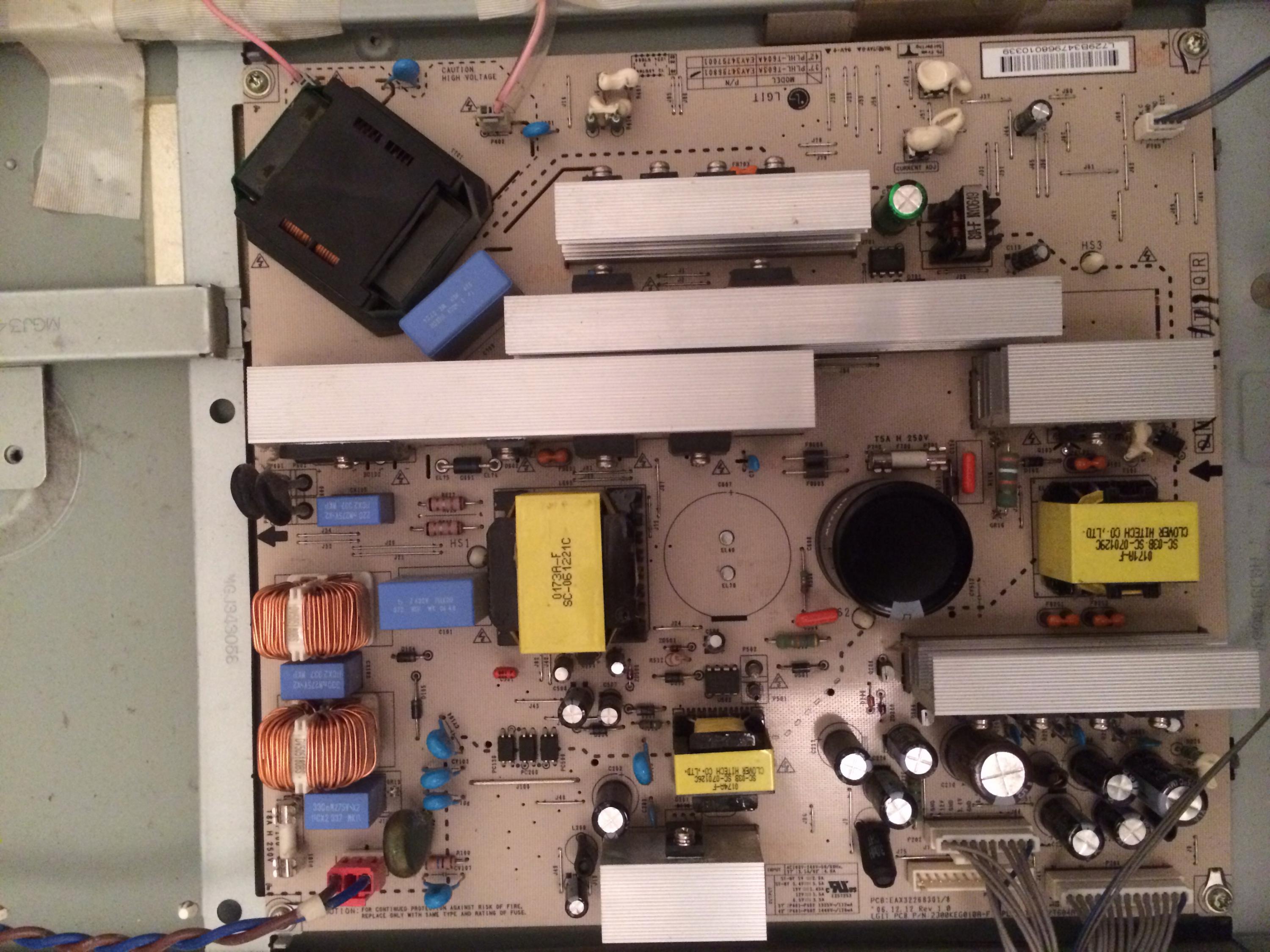

          Whole back of tv

            Re: 37" lg tv pixelated screen help
            Are they pics ok tom66

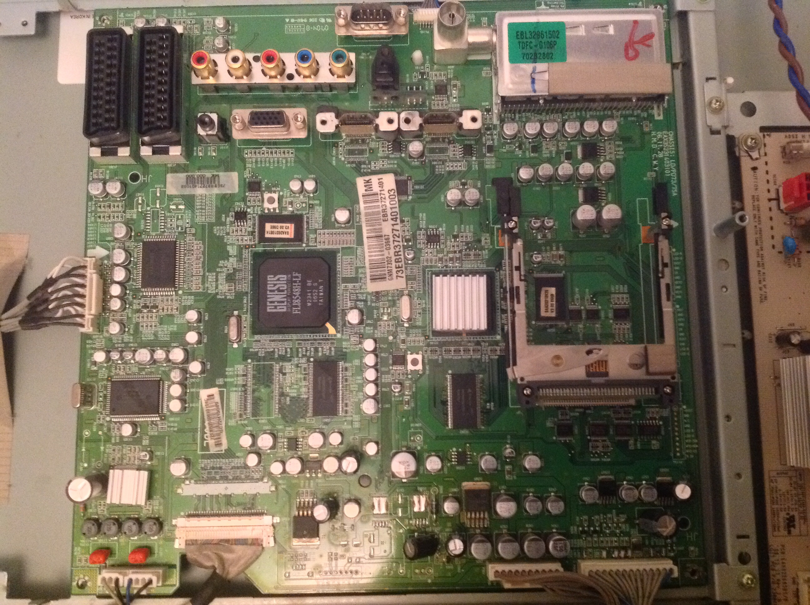

                        It lasts a lot longer with just the back off the tv so its defo somthing thats heating but what would it be how would i find out what part to change
                          My guess would be this looks like one of the LGs that suffer bad SMD capacitors on the main board. See the recent reply on this thread where Arudge replaced caps on a 37LF65 with a similar problem and resolved the issue. The capacitor numbers are in the post:
                          https://www.badcaps.net/forum/showth...676#post517676
                          Can you take the metal cover off the main board (in the middle) and post a close-up pic?
                            Here is a pic of board I've changed the said caps so we'll see how it goes
                                Let us know
                                Thanks alot tv seems fine now been on few days with no probs
