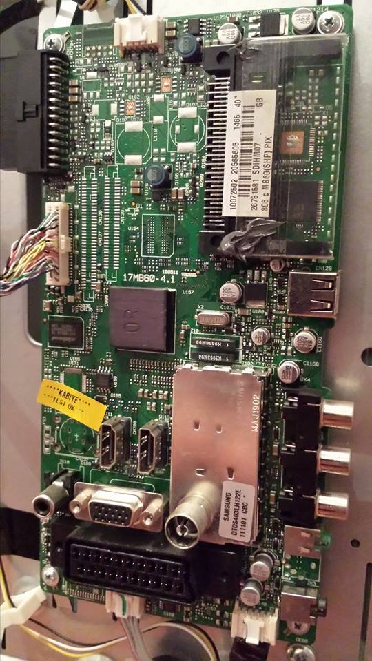

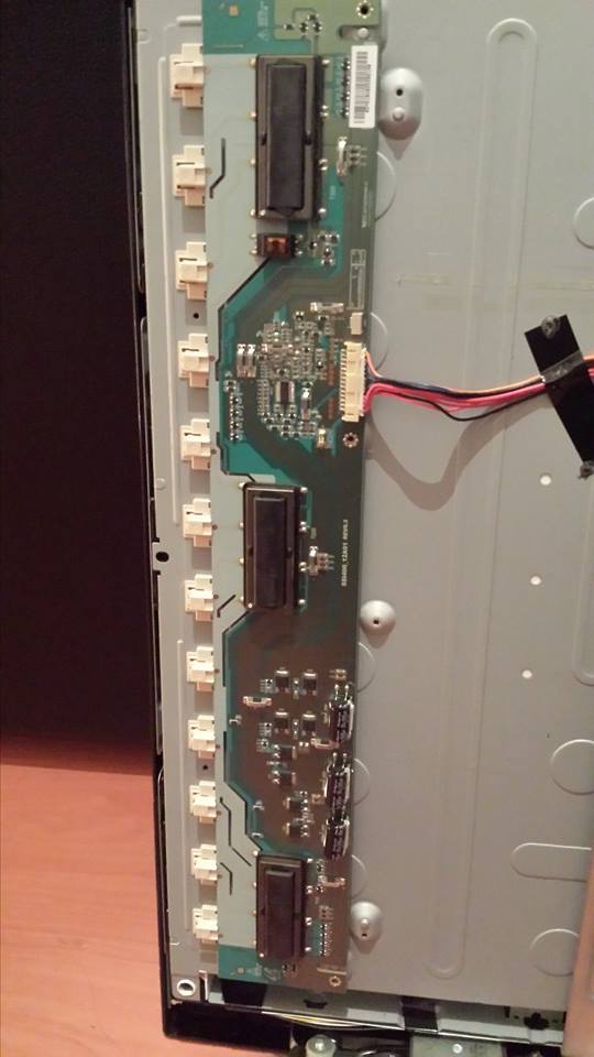

    hi guys i have had this sharp lc-40sh340k laying around for a while now. when you switch it on it goes on displays picture and light on screen but after 2 seconds the backlights switch off. i have tried different PSUs and same issue, also purchased a used inverter board on ebay for this tv and same issue. could it be the mainboard or even possible one of the CCFL tubes itself possibly breaking the circuit and shutting down the inverter ?
    any help would be great thanks

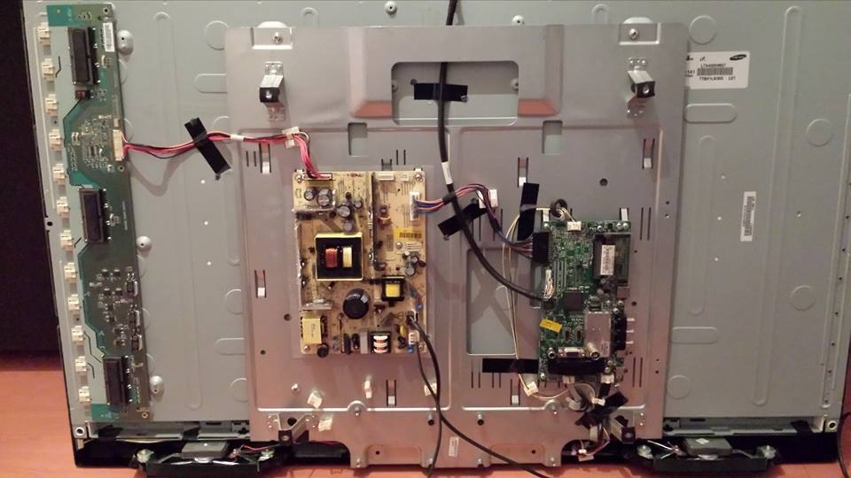

          post some good clear pics., of all the boards and one of the whole back and how theyre connected, a pic. is worth a thousand words.

            you might have gotten a bad inverter from ebay, it may be a lamp issue.

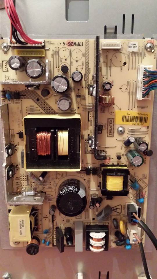

                  are these any helpfull ? and not sure what im looking for in the service manual ?
                    Re: sharp lc-40sh340k Baclight Ptoblem.
                    It will only take one bad lamp to cause the inverter to shutdown.
                    You can first verify that the 24VDC is still present on the inverter board and also the bl_on is also present.
                    Some time you can bypass the detection time out on the PWM IC of the inverter circuit but you will need to get the spec of the IC.
                    You may have to take the panel apart to inspect the lamp but it is delicate works.
