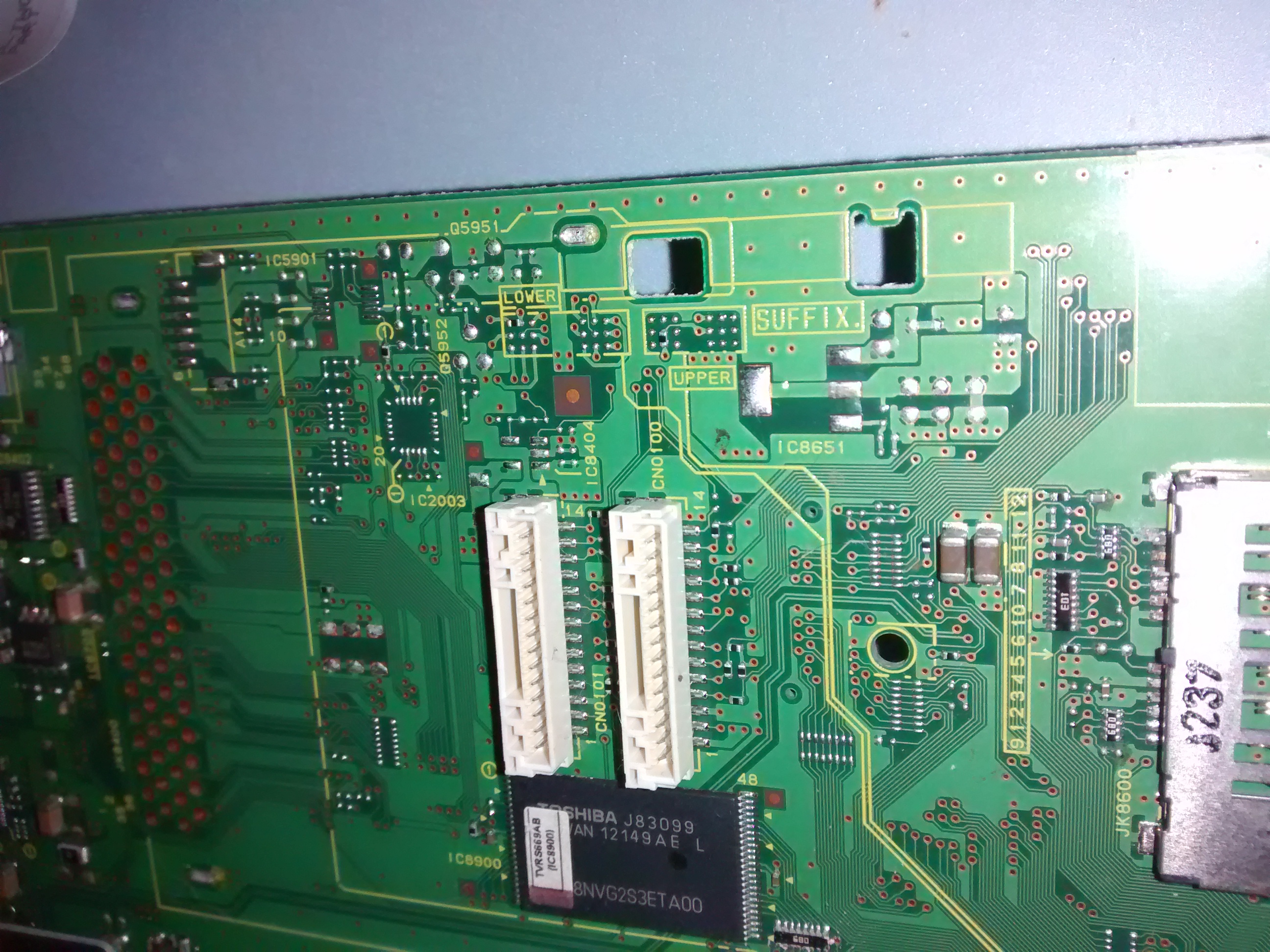

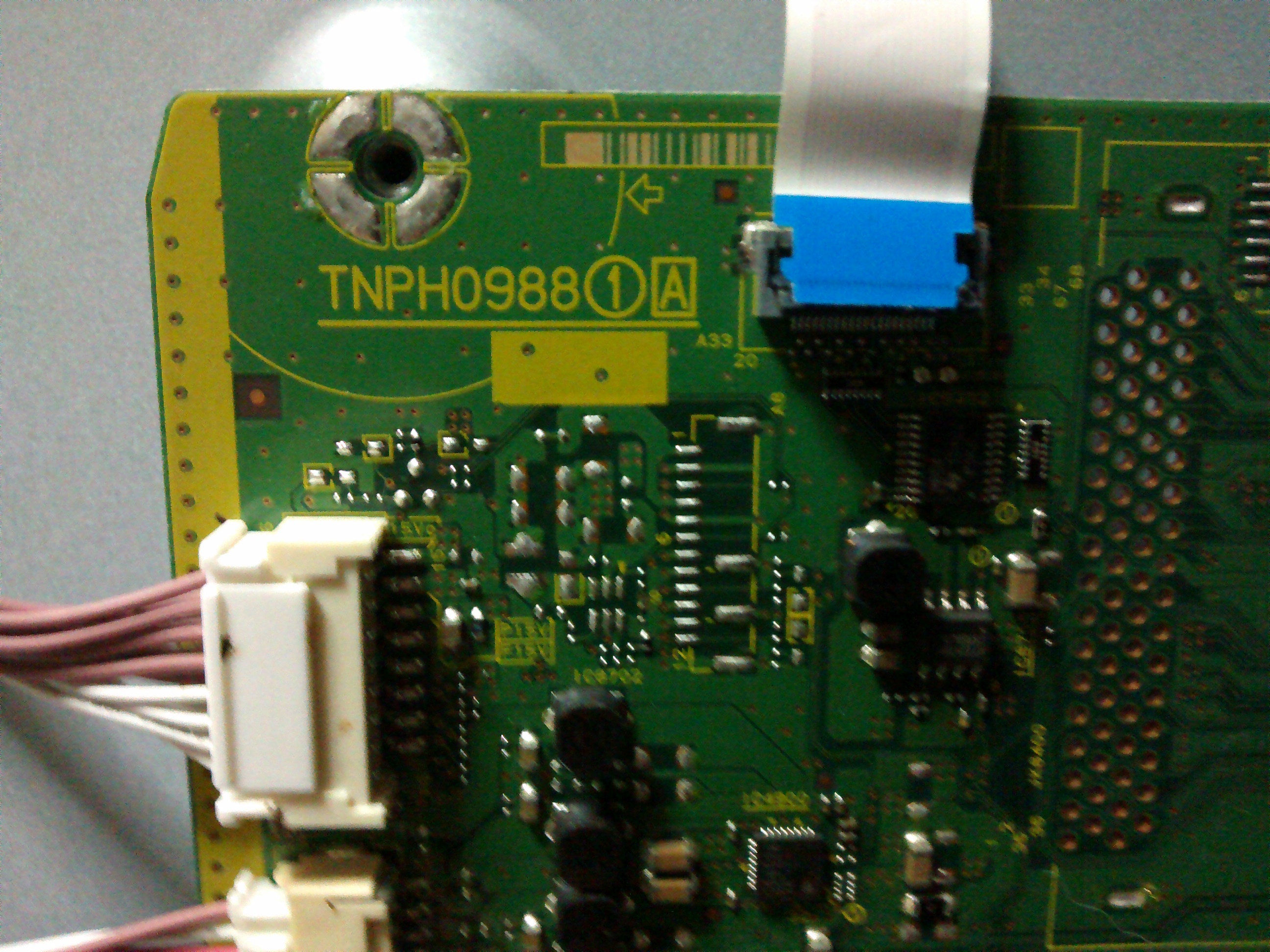

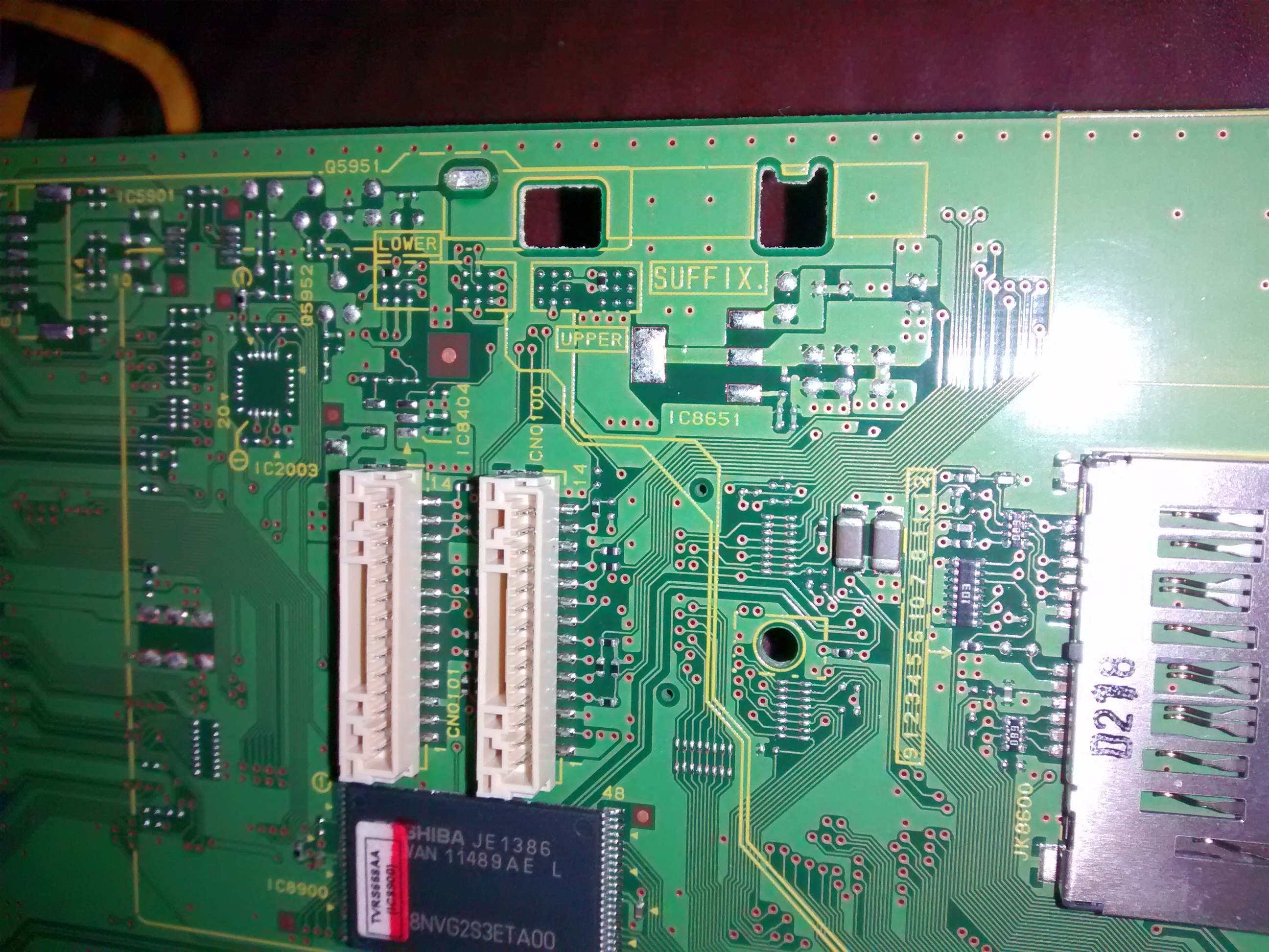

                      Negative... Attached is a pic from the original board... I also checked at shopjimmy and hdtvparts, they don't have listed the same exact board... That's why I waited until one from the very same TV appeared in ebay; same code, but different suffix (check the first post). The one I bought I suppose uses the ATSC standard for digital TV (USA origin), mine uses ISDB-Tb; apart from that, I don't see any difference.

                        Re: Panasonic Viera TC-P50GT50 one blink error
                        yeah, I'm having trouble working out the suffixs with the new legend. It is possible to convert it to your standard. Just have to work out which eeprom has the tuning data.
                        I had to do the same thing for one of mine. Got a 50" board from New Zealand and then went about swapping the eeproms and flash ICs to convert it back to original.
                          TNPH0988 (1) A is not the revision of your board, more to do with the blank PCB
