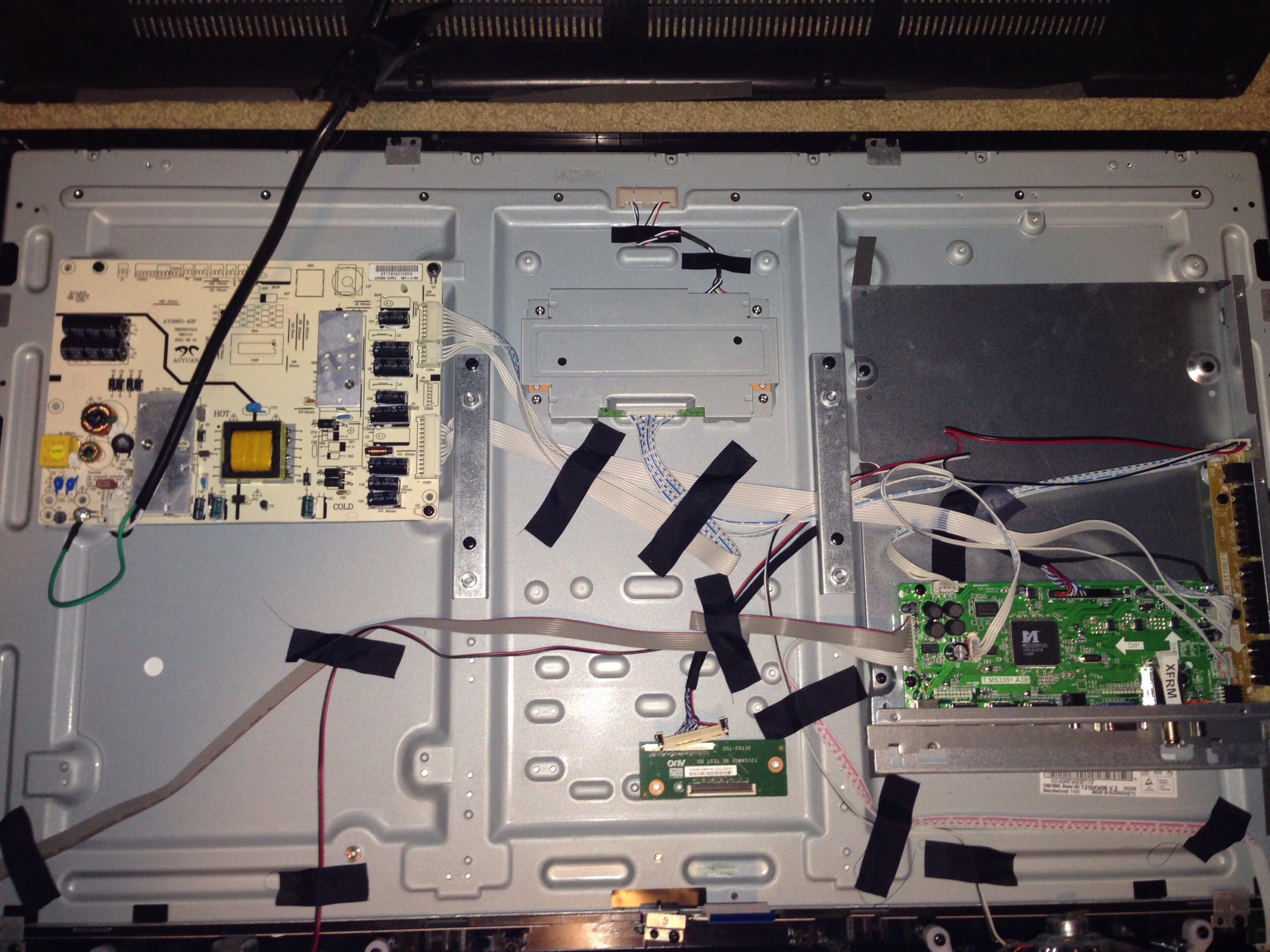

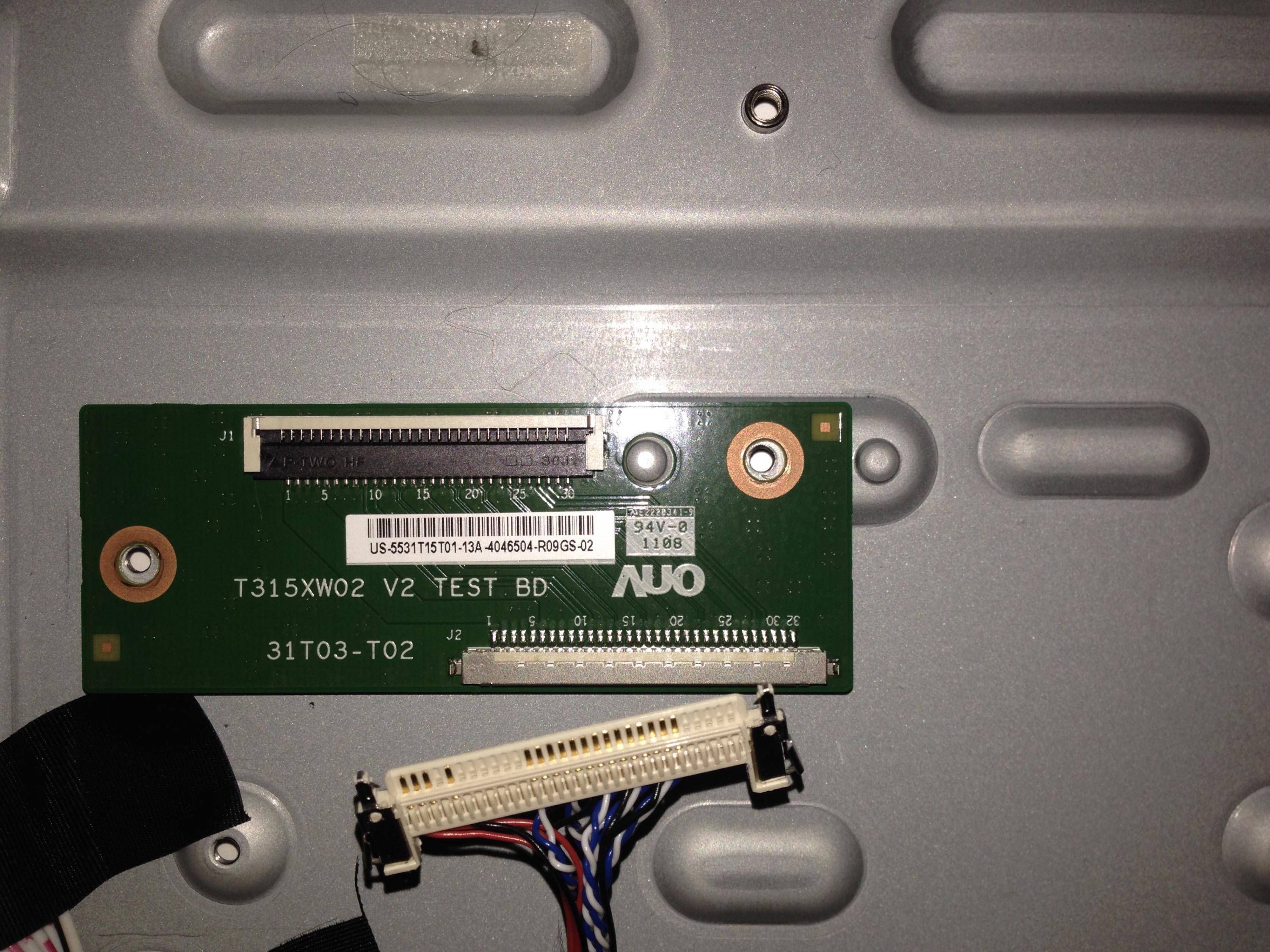

                  Re: proscan pled3216a upside down picture (mainboard replaced)
                  I will upload some photos, there is a AUO LVDS adaptor board.
                  • Shinju
                    • Mar 2014
                    • 1239

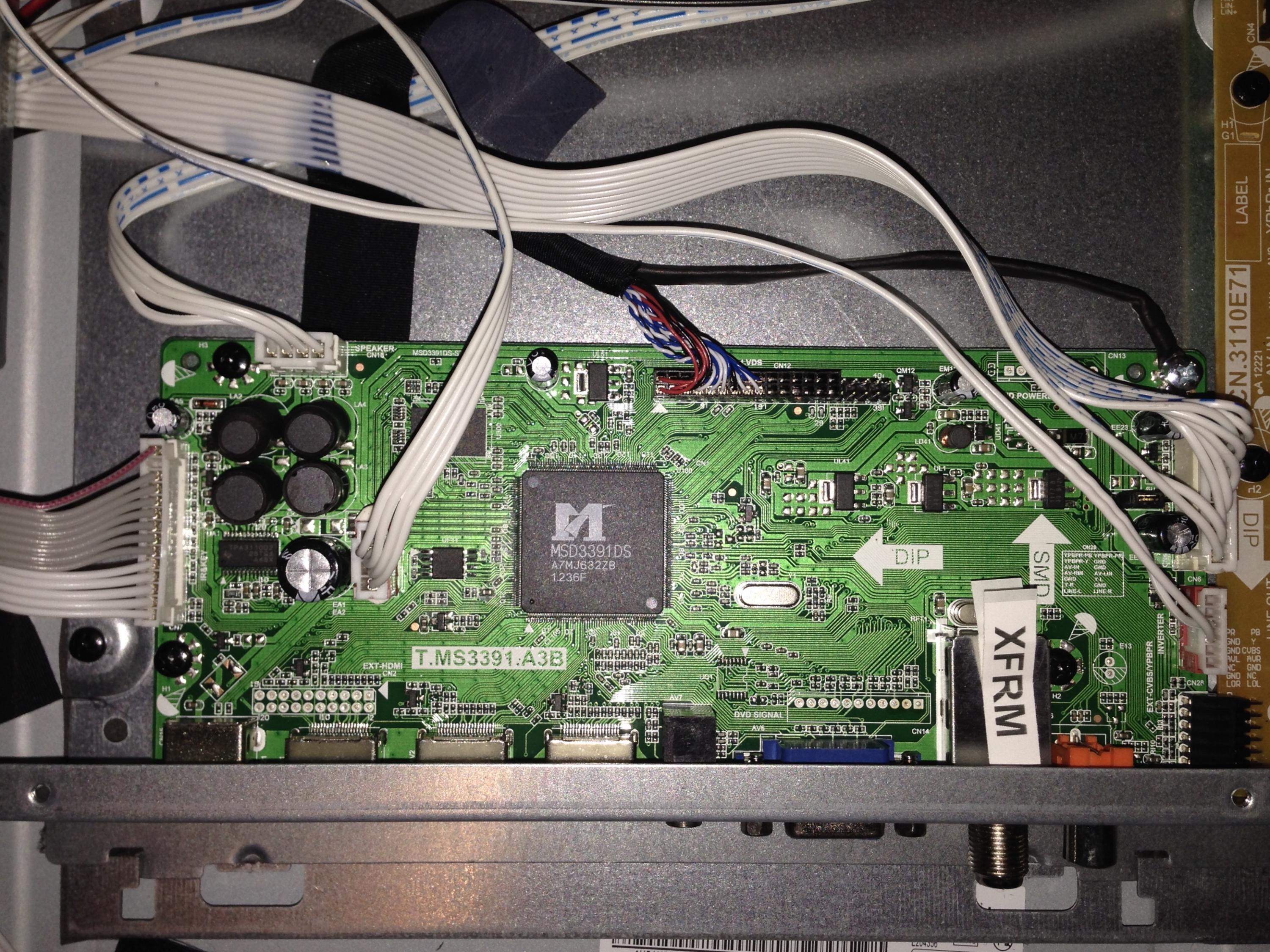

                    Mainboard
                    • Shinju
                      • Mar 2014
                      • 1239
                      Everything.
                        I look at the spec sheet of your panel, there is no control pin for the picture orientation setting.
                                      I was able to get in. But I don't see any setting for screen orientation. I did see an option for LVDS odd or even the panel set to ODD if I put it to even then the screen goes blank back light stays on.
                                      I see some options for mirror mode, debugging and advance debugging but when turned on I don't see any extra screens I'm not sure how to access that stuff.
