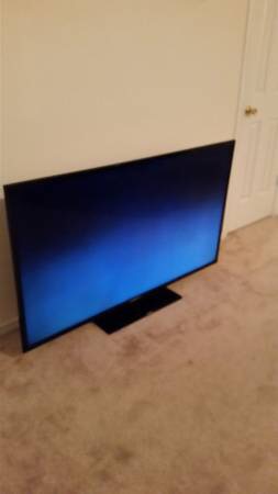

    I saw ad for this tv for sale model UN60EH6002F.I want to know if any have seem this and if so was it a bad panel.Please look at picture and give me your opinion. Thanks
    Re: UN60EH6002F Should a buy look at picture
    Could just be an off-axis photo from an LCD i.e. backlight no picture. But on a modern TV like this there is a good chance that backlight no picture is caused by a panel failure.

      Thanks tom66 the guy is asking 200 or best offer but at that price big risk of it being panel failure it is not worth it.

        Are you sure it's not a UN60EH6003F? I don't know of a 2F. The 6003F is a 3D LED. That and the 60EH6000F are having a very high T-con rate failure. I know because I sold several T-cons lately for them and they go very quickly on Ebay. My guess is it's a 6003 with a bad t-con. The t-con will run around $150-$200 but there are some places offering repairs on them for $50 or so.
        Again, this is completely a guess.

              that could get very expensive if the tcons just keep on failing each one you put in.

                  Maybe it's possible to identify the fault with some testing, but in my mind $200 is a lot to pay for a broken TV when the panel could be a possible fault.
