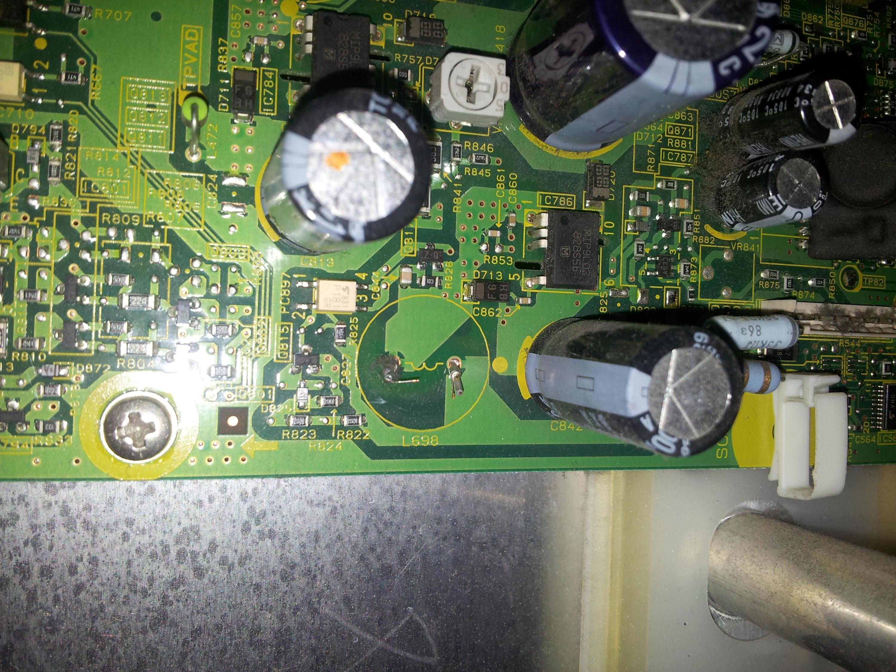

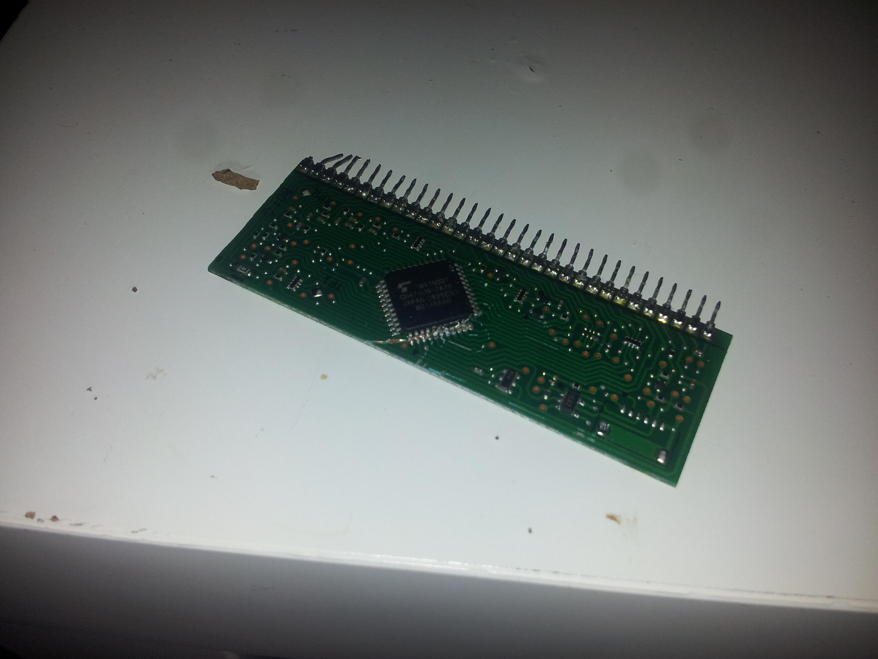

    So, picked up this 50" Panasonic to repair and give to a friend's dad who helped me with a lot of the things around the house.
    Guy claimed he had never opened it, well I could see one screw loose so yeah. So much for that. Anyway, he looks like he has never used a soldering iron on it, so that is good.
    It's dead, no power. The first damage, he managed to take some pins off a chip on a module on the power board - MC701. (The bent and missing PCB pins are due to quick removal of the original module... he didn't break those!) The power supply did not have any standby voltage on pin 9 of P25. Luckily I had a spare module from a 42" board and they are identical. This resolved this first problem, but the TV is still dead, which I suspect is the original fault (before this idiot messed it up further... seriously people should stay away from stuff they don't understand!)
    Trouble is, the standard test method of unplugging two connectors to get a white screen doesn't work on the PZ800 series. So I need to find an alternate method.

    yes it does, A5,A6,A7 from memory unless a 50PZ800 is drastically different to a 46PZ800. I've done it and get full white.
    If the LVDS is left in it still fires up, just with a dull grey panel

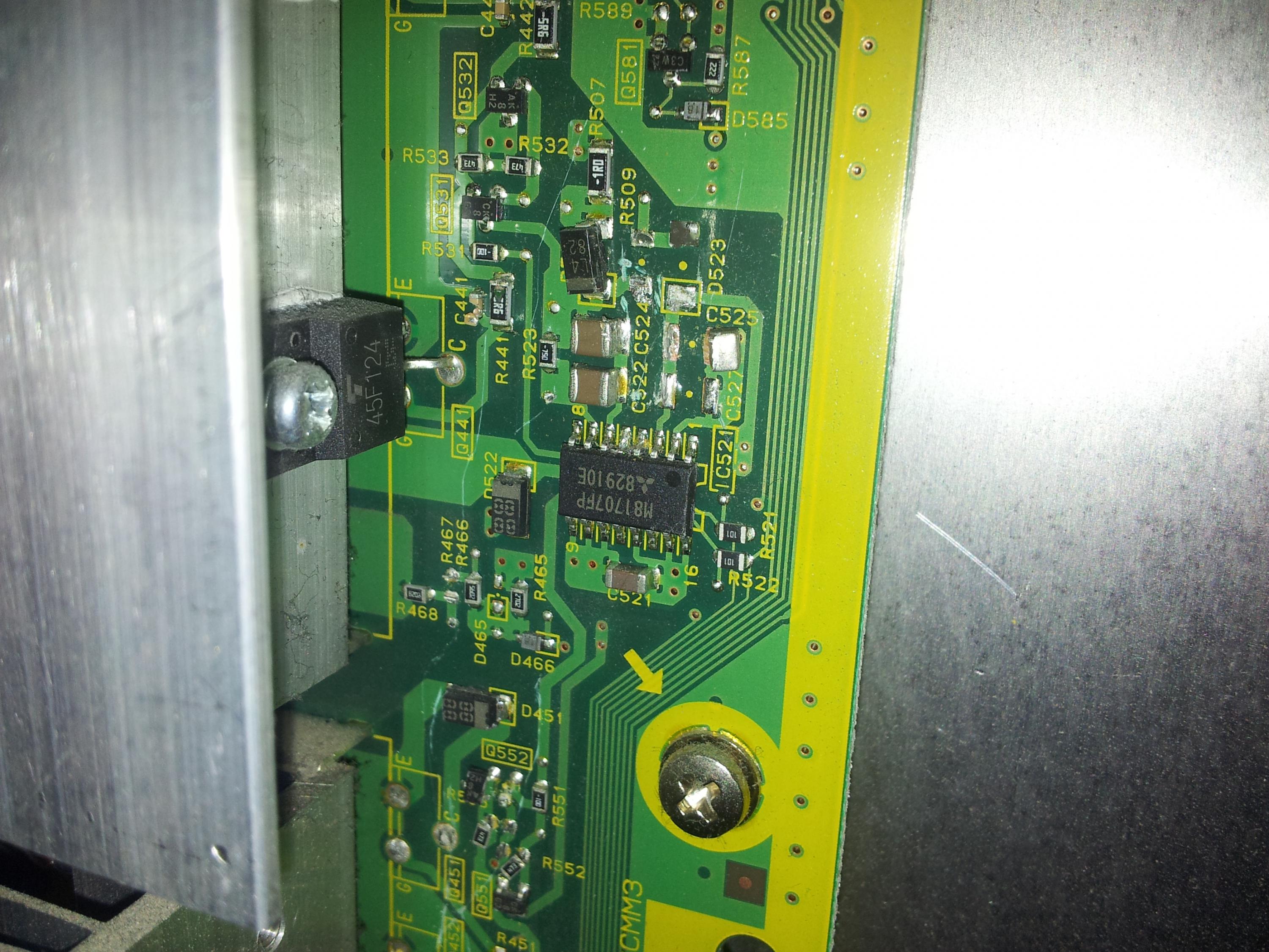

      Unplugged some connectors and found I could get it to click but no prime. Vsus tested OK at 191V for some seconds before shutting down, loaded it with a 100W bulb to be sure and it's nice and steady. So seems the power board is probably OK.
      Then... Ugh. I noticed yet more damage he has done. He's ripped an entire bloody inductor off the SC board!! And lifted a few SMDs and scratched a few traces! His damage does not extend to the SS board thankfully. There are some scratches on SD but none major, and the SU has survived too.
      He is a vandal, but why? Why has he done this? I am worried now, but if he wanted to cover up something, like a bad panel (rare but I suppose possible on a PZ80), he would just have to unplug the mains power connector, or an SC/SS board and it would give a blink code. So I'm still assuming stupidity over malice.
      Possible explanation: He mentioned he tried to claim warranty on it but lost the appropriate papers. Maybe he was trying to break his own TV so the tech would decide it was uneconomical... but any reasonable tech would surely look at this and see it's been fiddled with! And if he had a friend who was a tech who could make the claim for him, he wouldn't need to do it in the first place. So WHY?
      Maybe he just hates Panasonic plasmas!
      He has kids; I think he should be careful. He might accidentally stab them in the night.
