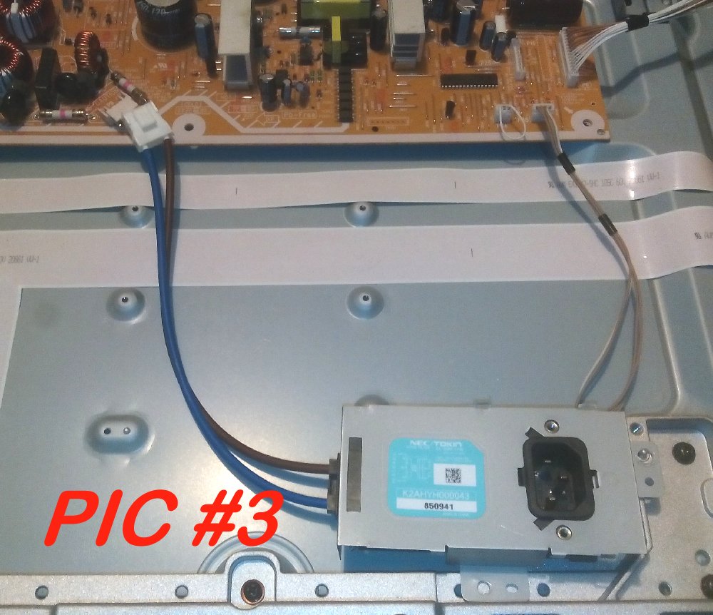

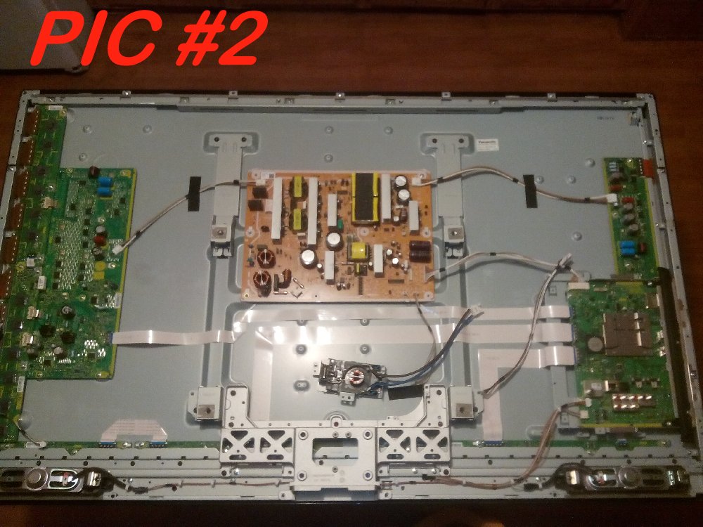

    Got a Panasonic TC-P50S30 Plasma that was a lightning strike casualty..
    Totally dead as a doornail.. No lights, no LED, no power indicator, no nuttin..
    As I have mentioned previously, I am not much of a PCB troubleshooter. Frankly, I am a massive wimp when it comes to fiddling with boards, checking voltages and stuff while the TV is powered on... So, my "expertise" consists of visual inspections and the like...

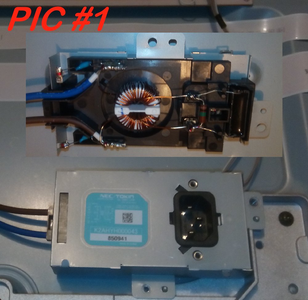

    The TV has a metal box like device as the plug, a NOISE FILTER CIRCUIT. Pic #1
    Inspecting all the boards on the TV (Pic #2) there doesn't appear to be any char marks, no blown caps, no damage whatsoever... I have checked all the fuses on all the boards and they all check out fine. None blown...
    So, my first thought is that the Noise Filter doo-hicky is fried...
    Order a replacement. No luck.. Still as dead as a doornail..
    OK, so I am thinking Power Board... Replace that. No luck... Still dead..

    Another question I have is, what about bypassing the NOISE FILTER doo hickey and hook power directly to the Power PCB...
    Good idea???
    Bad idea???
    Totally frak'in moronic idea???

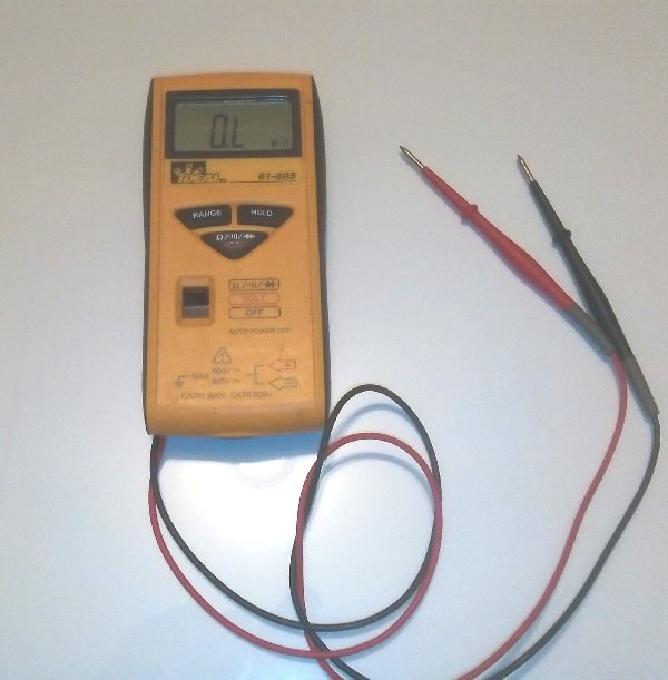

        There is little you can do to ensure total safety use a RCD plu/socket is always a good start and just get into your mind to ask "is ths safe" we also suggest having someone on hand, just in case.
        Fix the dohickey back in place and check the mains socket works as Kevin suggests.
        First test will be to just plug it in and listen for any clicks.
        Next set you meter on 600vAC and put the black lead on the blue mains wire
        at the white connector and with the red probe touch the ends of the fuses.
        Unplug the set and report back.
        It may give you more confidence and get you used to testing if you have a dummy run with the set not plugged in

            looking very much A-board, the front stdby LED is driven via 3.3v from A-board,

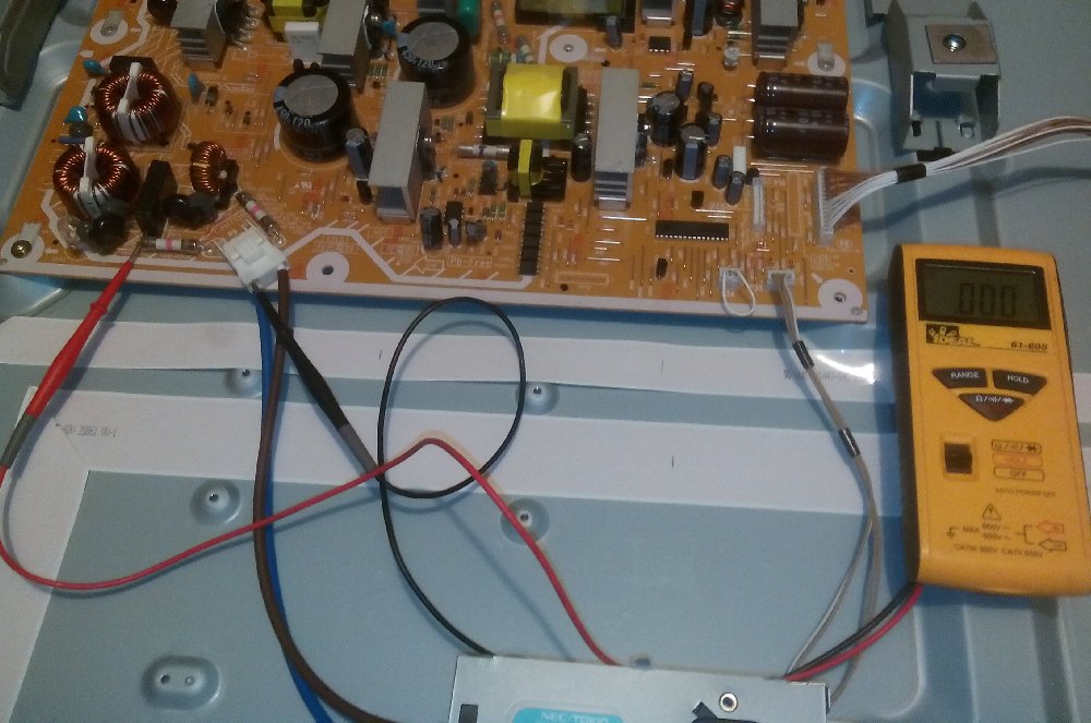

                OK Let's begin....
                My wife is on stand-by. She has the phone in her hand and she has dialed 9-1-
                I have the voltmeter set to DC and the probes are in place as per the pic.. I am still too much of a wimp to actually handle the probes.. Give me time.
                Baby steps..

                  Re: Totally Dead TC-P50S30 Panasonic Plasma
                  Originally posted by Michale32086
                  OK Let's begin....
                  Baby steps..
                  Ah, no. don't do that. you are on the AC mains and looking at it the same point so 0 it will read
                  You need Volts Ac range and assuming you're US, it's 120V I think, I see no location in your profile.
                  backprobe the brown and blue, that is move the probe from the fuse and insert in the other connector in that plug.

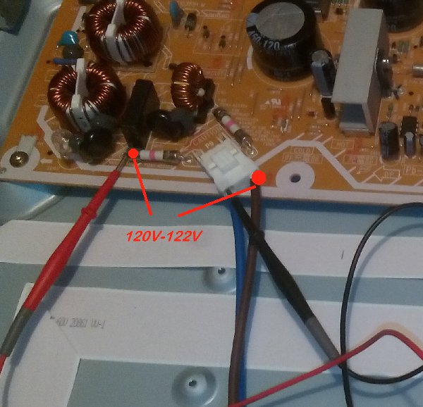

                    Glad I waited..
                    OK I'll set the meter to AC and move the red probe from the fuse to the brown wire..
                    Yea, I am in Florida, so 120V should be the reading...
                    "Hold onto yer butts"
                    -Samual L Jackson, JURASSIC PARK
                    EDIT: Voltage is good. 120.6V

                    • Michale32086
                      • Nov 2011
                      • 1453
                      OK, I checked the voltage from the line (Blue and Brown) to the opposite end of the opposite fuse..
                      120V-122V

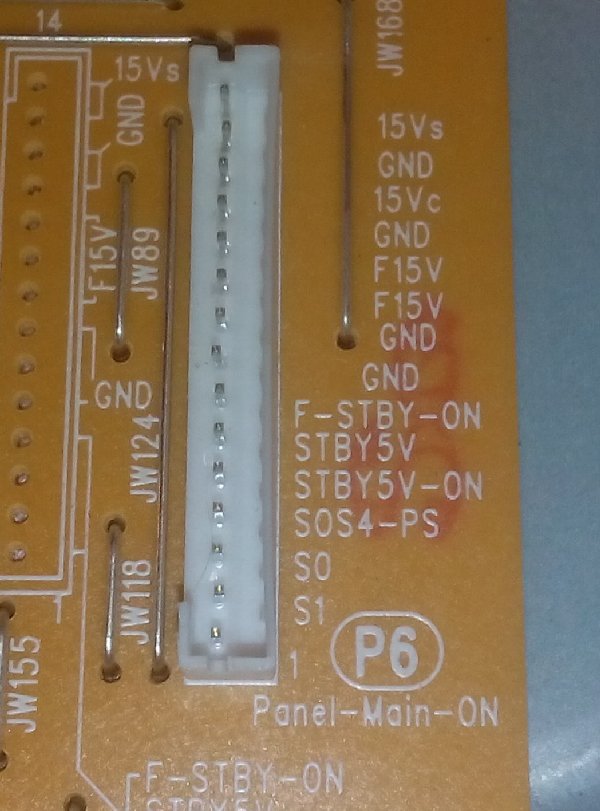

                            There is a connector marked P6.. It's one of only 3 connectors on the board, minus the obvious 2-pin power connectors...
                            • Michale32086
                              • Nov 2011
                              • 1453
                              Also, this power board IS a replacement power board. With the old one in there, I had the exact same symptoms...
                              Just FYI

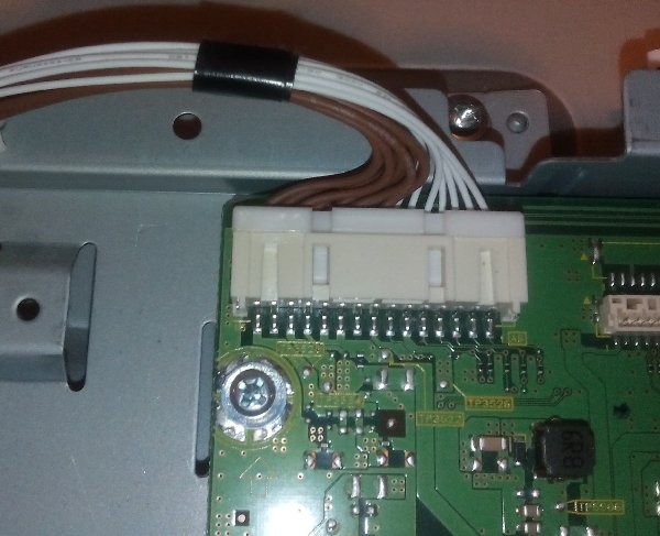

                                Did you remove the lead ? the other end should be on the A board A6
                                  Just FYI
                                  It's going to be A board, that's why the PSu replacement did not work.(what I'm expecting)

                                    • Michale32086
                                      • Nov 2011
                                      • 1453
                                      Ahhh.. OK.. Let me check that.. My bust...
                                      • Michale32086
                                        • Nov 2011
                                        • 1453
                                        Ok, found the A6 connector..
                                        Pin 6, meter on AC, no voltage...
                                        Meter on DC 4.99V
