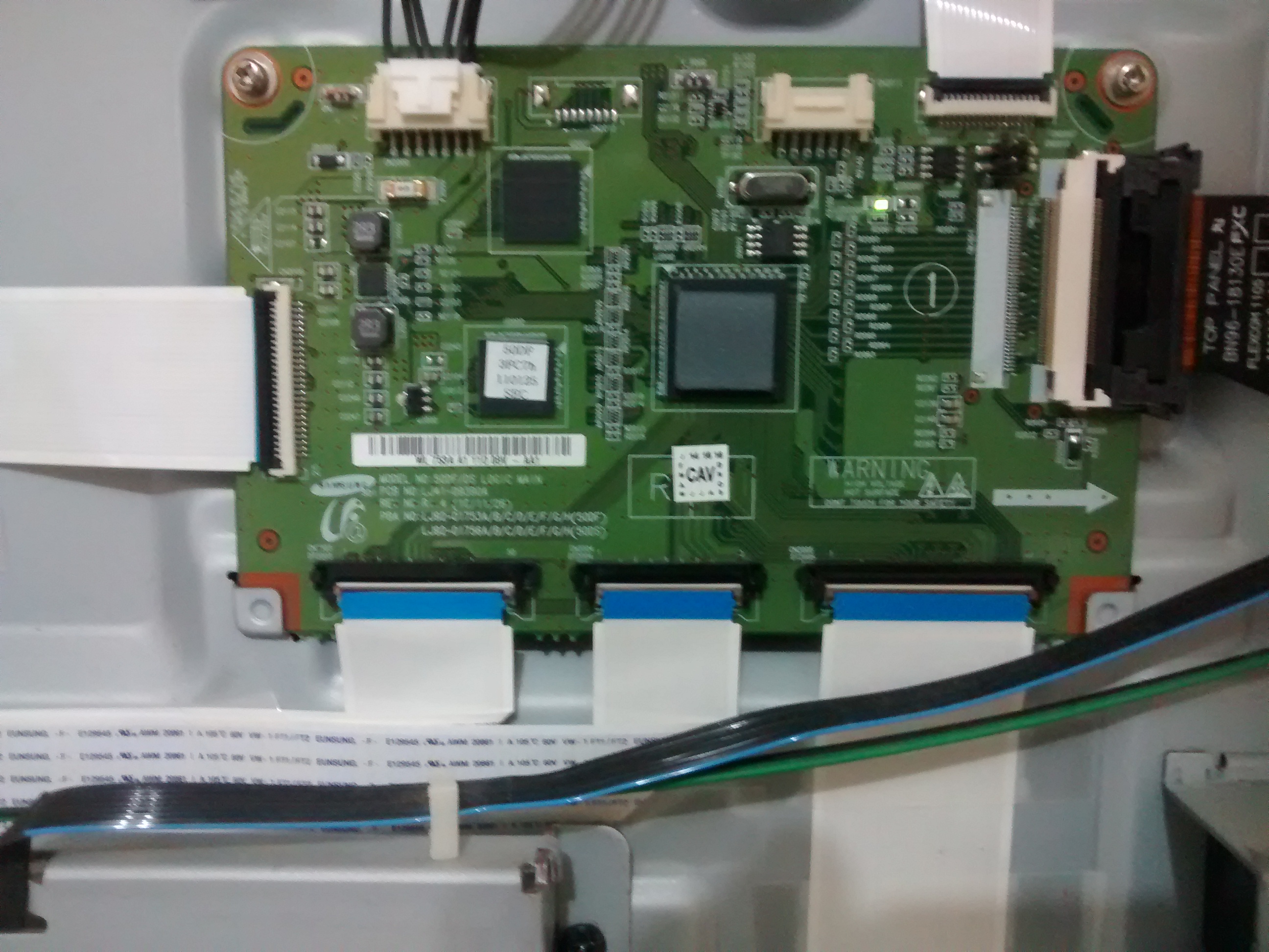

              I did this with both ribbon cables that connect the logic board with X-main and Y-main boards, they are OK.
              I did a few tests too. I disconnected the 3 ribbon cables that connects the logic board with that board in the bottom of the set (I think it is E and F Buffer) and the image on the panel is like this: Click image for larger version
              It could be E&F buffer the problem?

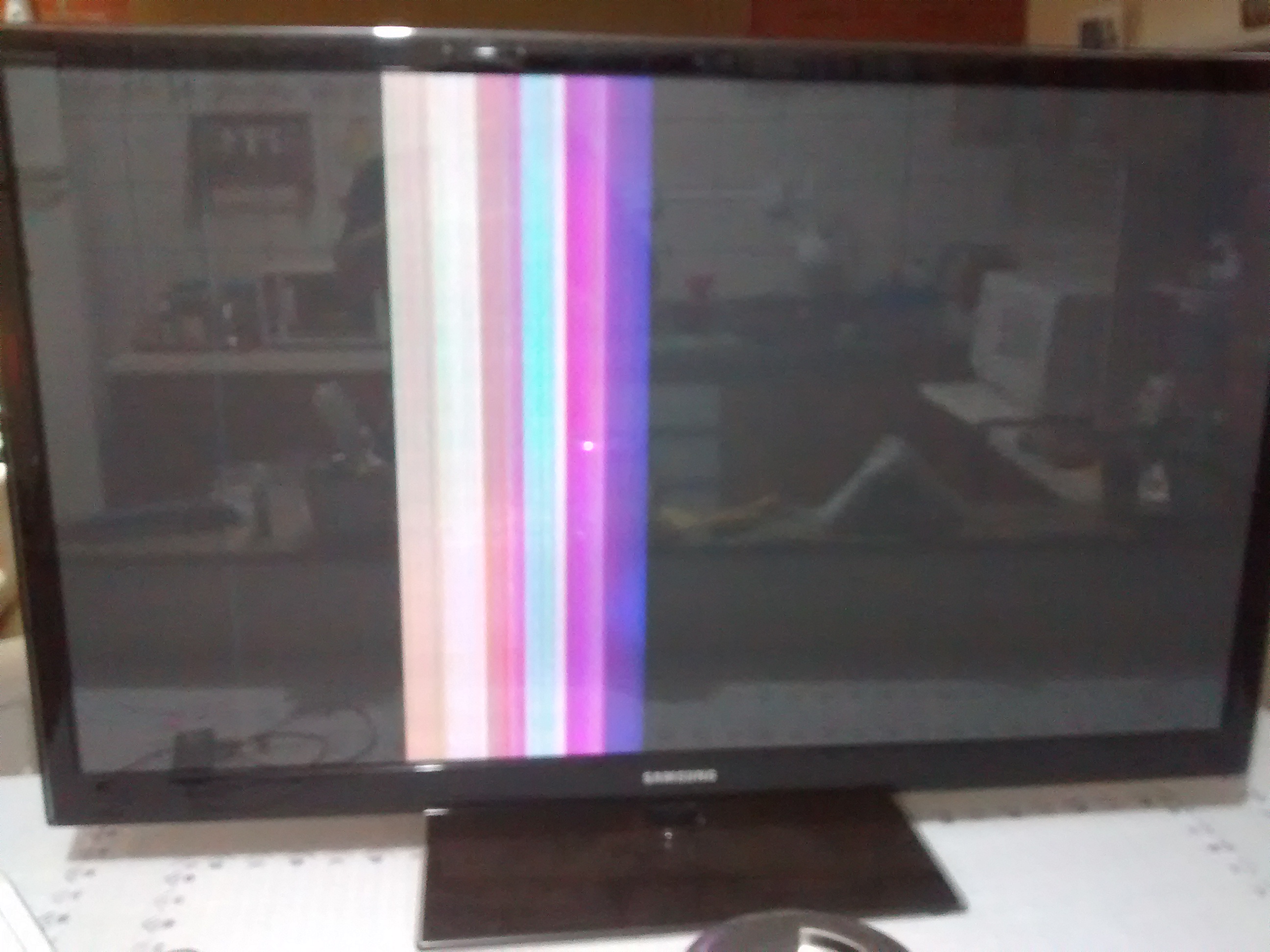

                #107
                Re: PL51D550C1G Plasma Samsung - No picture, but sound is ok
                When all the ribbon cables are connected, the picture on the right part of the panel is a little bit distorted but when I disconnect the 3rd ribbon cable, the right part of the picture on the panel is perfect!
                So, the problem could be the E&F buffer boards?

                  #108
                  Find out if your local TV repair shop can sell u a ribbon cable for the suspected buffer board and see if that will improve the picture quality or if the Buffer is really bad .I have had some experience with bad ribbon cable before in the past
                  good luck
                    #109
                    That is not good. I hope your panel is not shorted.
                    Did you EVER plug in any cable to the bottom buffer while power was connected or shortly afterwards?
                    You should check the ribbon for tears.
                    IIRC, E/F boards cannot be replaced - bonded to the panel.

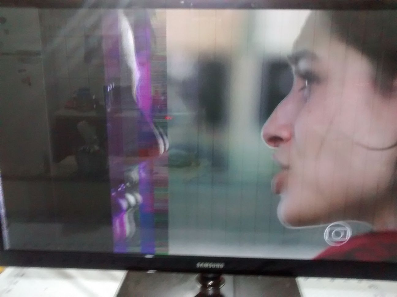

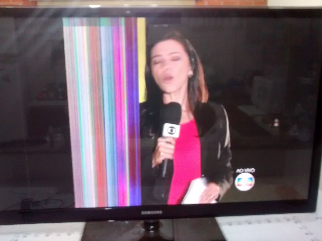

                            #113
                            Here is a picture when all the 3 ribbon cables are connected with E and F buffers: Click image for larger version
                            And here is a picture when I disconnect the ribbon cable from the F buffer: Click image for larger version
                            Also, when I disconnect the ribbon cable and the power cable from the F buffer board, there is no picture on the left side of panel but on the right side the picture is perfect.
                            So, I'm guessing here but I think the problem is some IC on the ribbon cable, like steviewonder mentioned. This is not repaireable, right?
                              #114
                              Yes, it looks like a panel failure sadly.
                              I am really confused though, that looks like more than one IC has failed.
                              This can only happen due to overheating of that part of the panel, or a power transient from making a connection while power is still active.
                              Overheating - if the heatsink for the X-drivers was removed, panel will fail in a couple minutes operation.

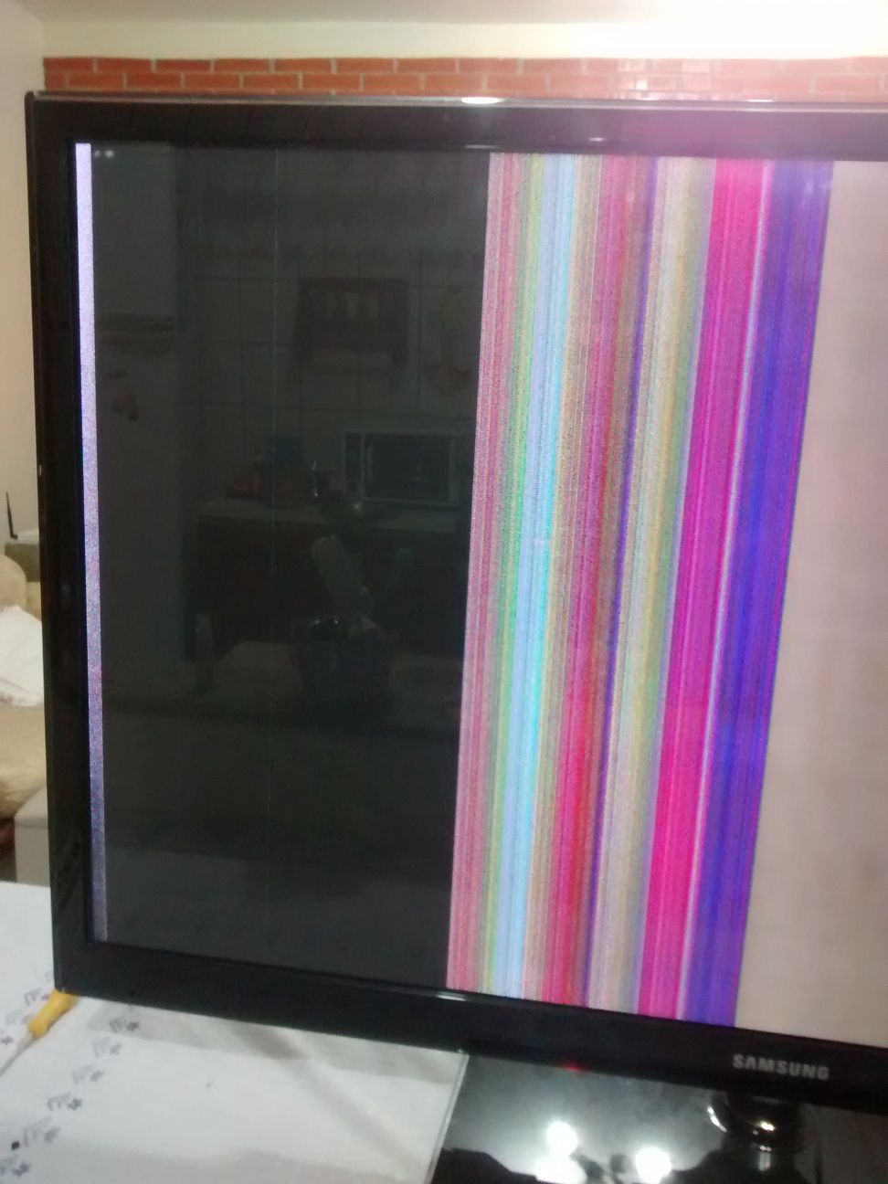

                                        #119
                                        Sorry for bumping this thread, but after months I just checked out my TV again. I realize that when I was trying to solve the first problem (Y-main board failure) I probably removed the heatsink for E-F buffer, and it is lacking 3 "thermal adhesives" for the 3 ICs (COF) under the coloured lines on screen, so the ICs was not touching the heatsink. I didn't notice this, so probably when I put the new Y-main board (first problem) and start to use the TV again it may damaged the IC's due to overheating (it worked for 20 days)
                                        So, to fix this it is probably necessary to change the whole panel. Not worth it.
                                          #120
                                          That is a shame. I am very surprised it worked for 20 days. We have had users on here who have omitted heatsink parts and found the set to last only 10-15 minutes before failure. Ah well, it is a lesson for the rest of us, unfortunately your TV had to die for the cause
                                          Do sell the parts from the TV--it could be at least an organ donor!
