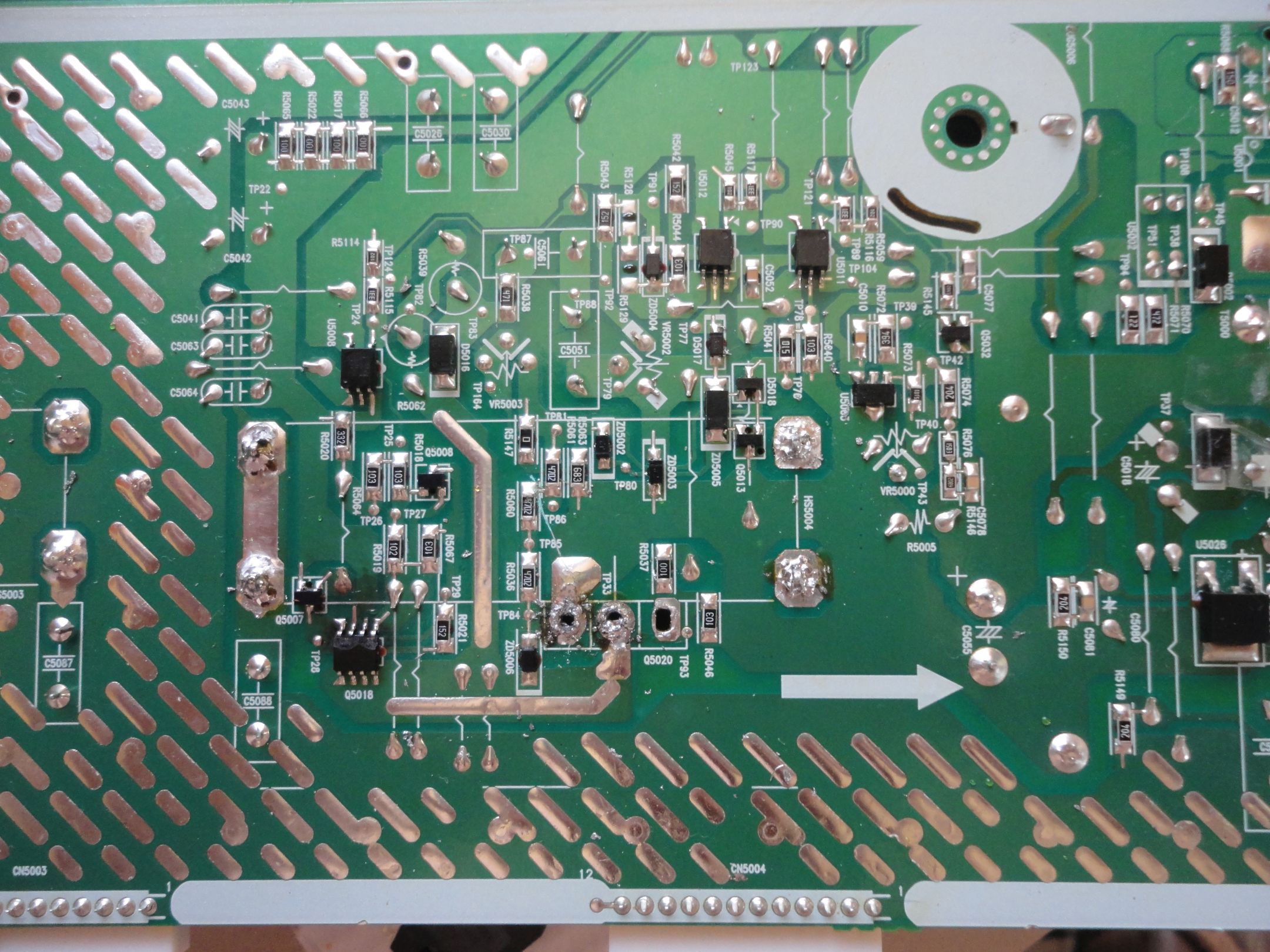

    tom66 could this transistor be the problem?
      #42
      Re: PL51D550C1G Plasma Samsung - No picture, but sound is ok
      Yes that could easily cause your issue.
      That would cause Yfr fault so no or very faint image.

        #43
        Then I will buy another one, replace and see what gonna happen.

          Can you post a picture of the circuit underneath that transistor? It is worth checking the driver components are OK too.

            #45
            Sure... Unfortunatelly, I think I quickly touched the iron on IC Q5028. Hope it didn't fry .
              #46
              Q5018, is that just a mark on it, or is that burnt?

                #47
                It is just a mark, I only noticed when I took the picture. I think I quickly touched the IC (with the iron) when I was trying to take off the transistor, because it was very difficult to do it. :S
                  #48
                  Ok, I'd check U5012 for shorts between pins 3-4, 4-5 and 3-5. That is the most at risk part.

                    #49
                    I just tested it, no shorts.
                    I assumed that these pins are the pins below, right? Like this:
                    1__ 2
                    3 4 5
                      #50
                      1 and 2 are the other way around.
                      Pins are read anticlockwise from pin 1.
                      Try replacing the FET/transistor, and let us know how it goes.
