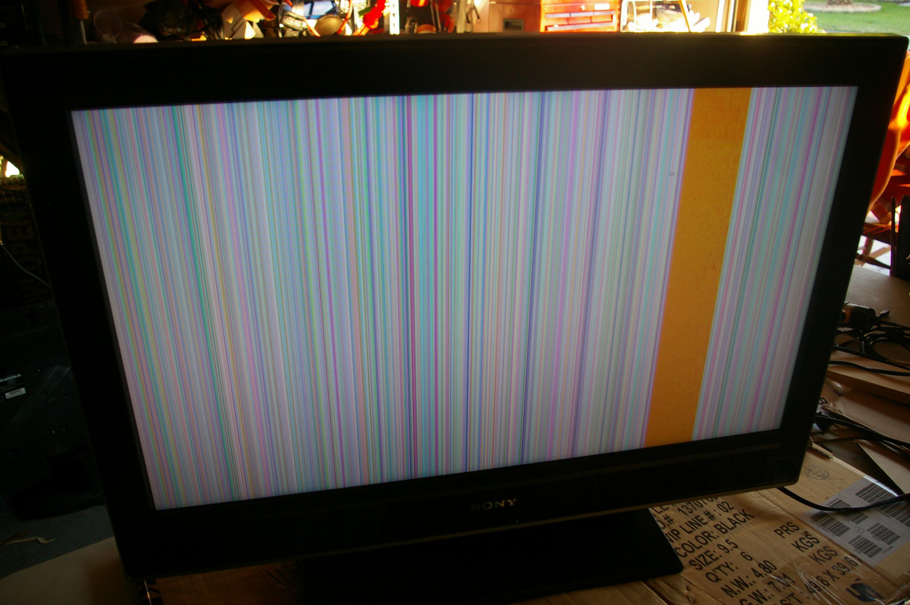

    Sony kdl32xbr4 Vertical Stripes
    Does this look like TCON or panel or other problem? I can see a ghost of the moving image in the brown stripe on the screen. Sound/playback appears to work OK. Thanks.
    Re: Sony kdl32xbr4 Vertical Stripes

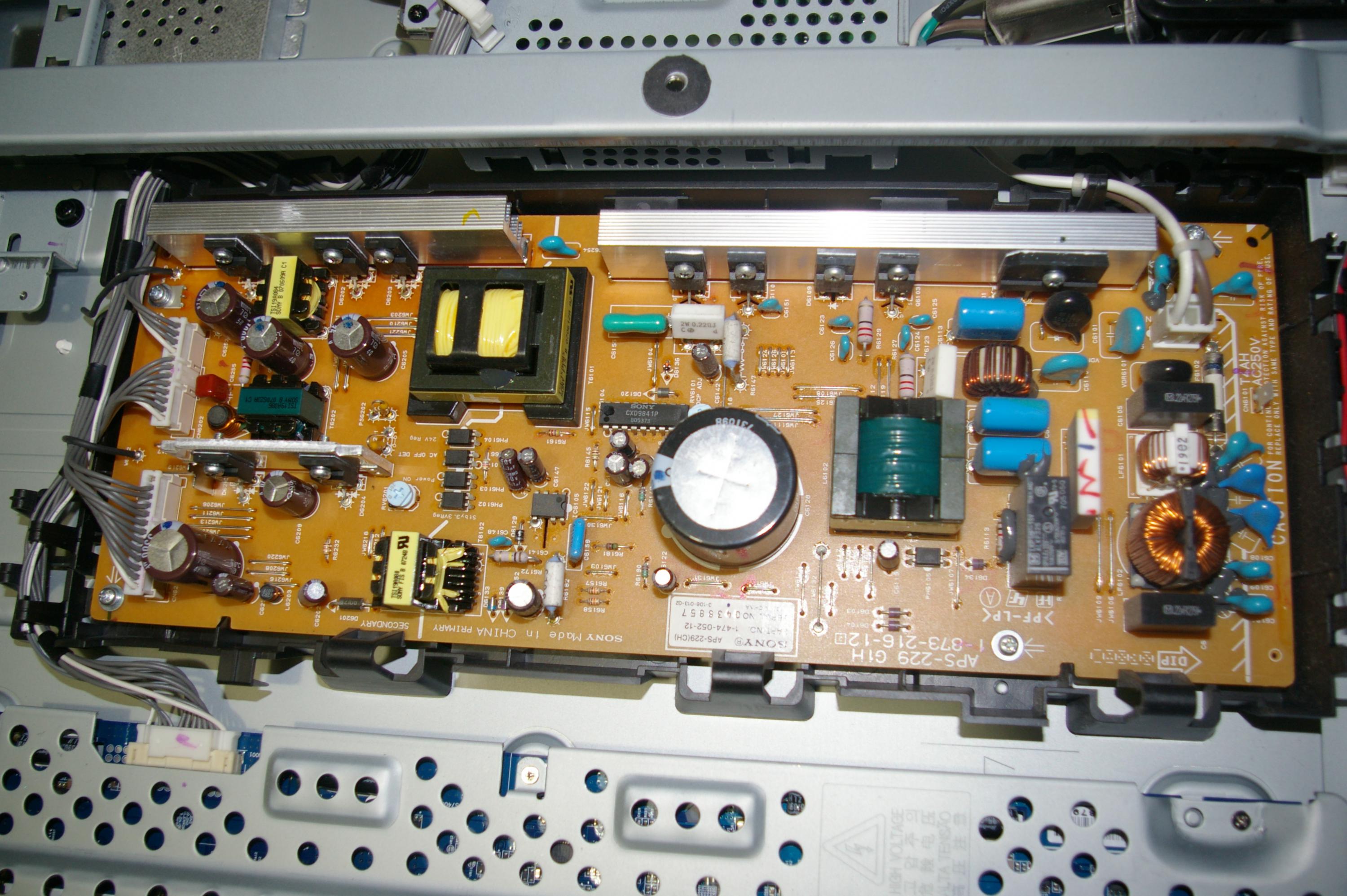

    This one is due to bad caps in the power supply:
      Wow! Did not know the caps in PS could cause stripes on panel. Thanks for the picture. Sounds like I should get the back off and take a close look at the capacitor tops.
        As luck would have it, I can't see any leaking caps Since the set powers on, and stays on, how could I test this PS for problems?
          Just because a cap doesn't look bloated or leaking doesn't mean they are not bad.
          Replace what you can and see what happens!
                This one shows the solid lines immediately. They are opaque and completely block out the picture ... except for the brown band where you can see a shadow of the picture image with lots of static.
                  Took a close look at the caps with reading glasses, and couldn't spot even any bloating.
                  I can actually get a PS for this unit for cheap, but I'm just thinking it probably won't solve the problem. Really wondering if that TCON is at fault. Unfortunately, the TCON is probably going to be a lot more than the PS.
                      You can verify the Voltages on the connectors to see if they are the correct Voltages as shown by the prints next to the connectors.
                      http://assets.shopjimmy.com/media/ca...052-12-top.jpg
                        And check if the T-con board has correct 12V.
                        It can be a panel fault, but it doesn't look like a typical one.
                                  truep: the lines don't move. the brown colored strip on the screen seems to show a monochrome shadow of the picture behind it.

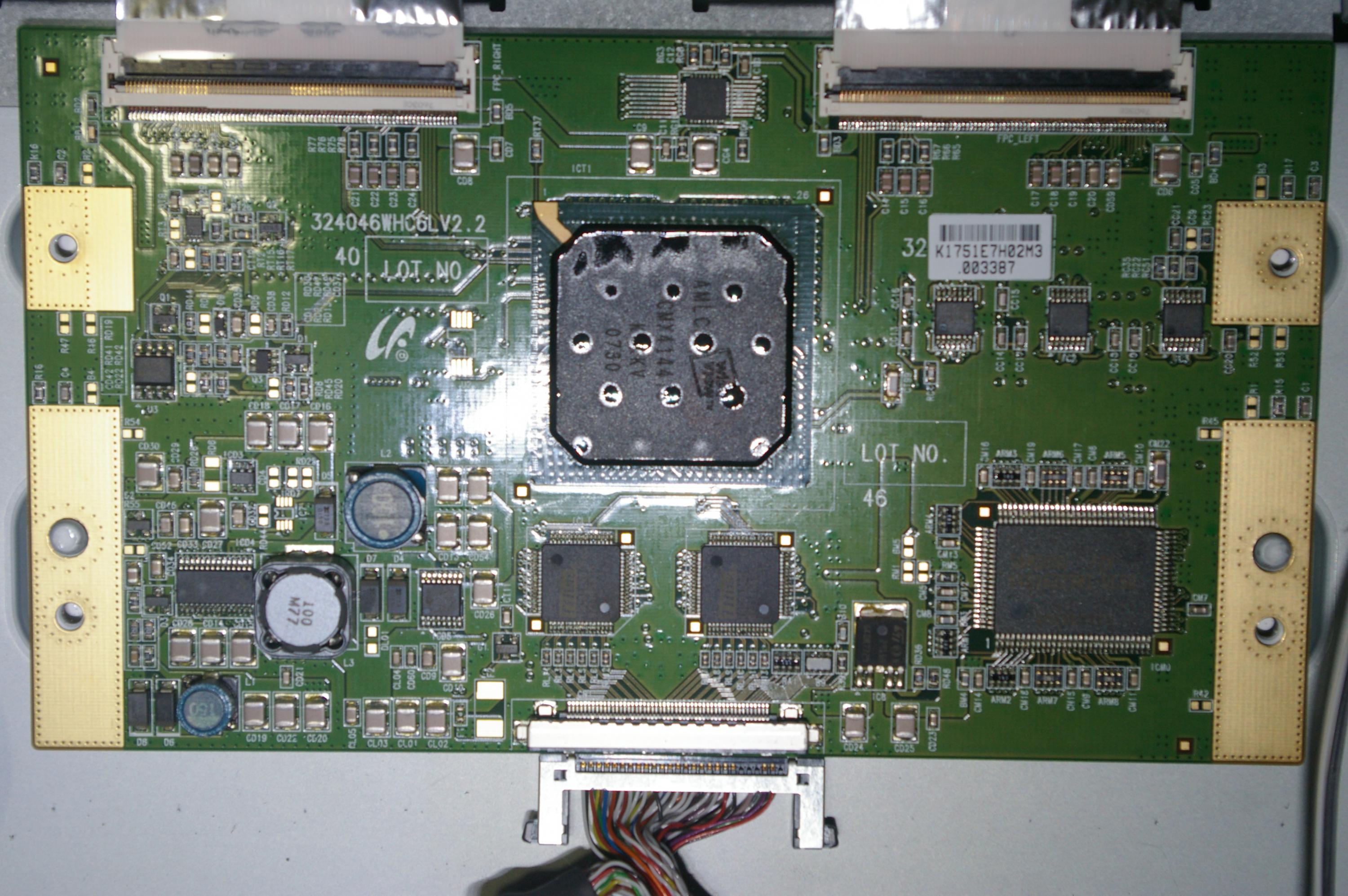

                                    well , with the new meter, I was easily able to test most of those pins while the circuit was live. Didn't test the GND pins, because I wasn't sure how, or if that's important here.
                                    Here is a picture of the TCON. Thanks for any ideas on what I can test there. Would like to be able to confirm bad TCON, because it's expensive whether I'm buying or selling it.
                                        ... and end around on Google, I was brought back to badcaps with this!
                                        https://www.badcaps.net/forum/showthread.php?t=33983
                                        Could it be that simple? If so, I think I need to test that resistor on the board. Not sure I know how to do that with my meter.
