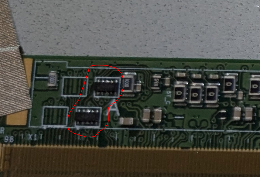

    I have Hisense H55U7B TV with no picture, only big vertical stripes. I did several tests and I'm not sure, where is problem.
    1. Connected tcon to 12V, white, red, green, blue, black picture visible in cycle on full LCD without error
    2. Connected only left side of LCD to tcon, big stripes
    3. Connected only right side of tcon, visible normal picture on the right. Working as expected.
    Where could be problem?

    A common problem with these TVS diode assemblies (they have breakdown or leakage of zener diodes).

                          Part Is littelfuse SP1064E-04UTG (marking 4264H) And I did measurement And looks in good shape. No Ohm shortage to ground. Carefully checked rest of components on driver and nothing found. IT could be defective tcon or it is not possible?

                            you need to put only the bad side at RGB test as you did before , and monitor the Temperature of the ESD diode or zener one.... they read fine. but they are not realy good, so Temprtaure will be rise

                              Yes, I tested it already and temperature is normal, like other components. May I try to replace tcon or it is 100% sure, that tcon is ok? Because half of display switching colors normally, bad half slowly and I cannot find anything bad at all.

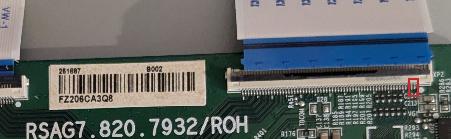

                                  try to mask tape only the pins 1 & 2 far left of the bad side, between temperature rise up by time not immediately

                                    What exactly you mean with it? Isolate first two pins of flex cable? From tcon to driver?

                                      1-2

                                          Yes, I'm able to resolder main bag chip of tcon module. I did isolation of two pins and result is same.
