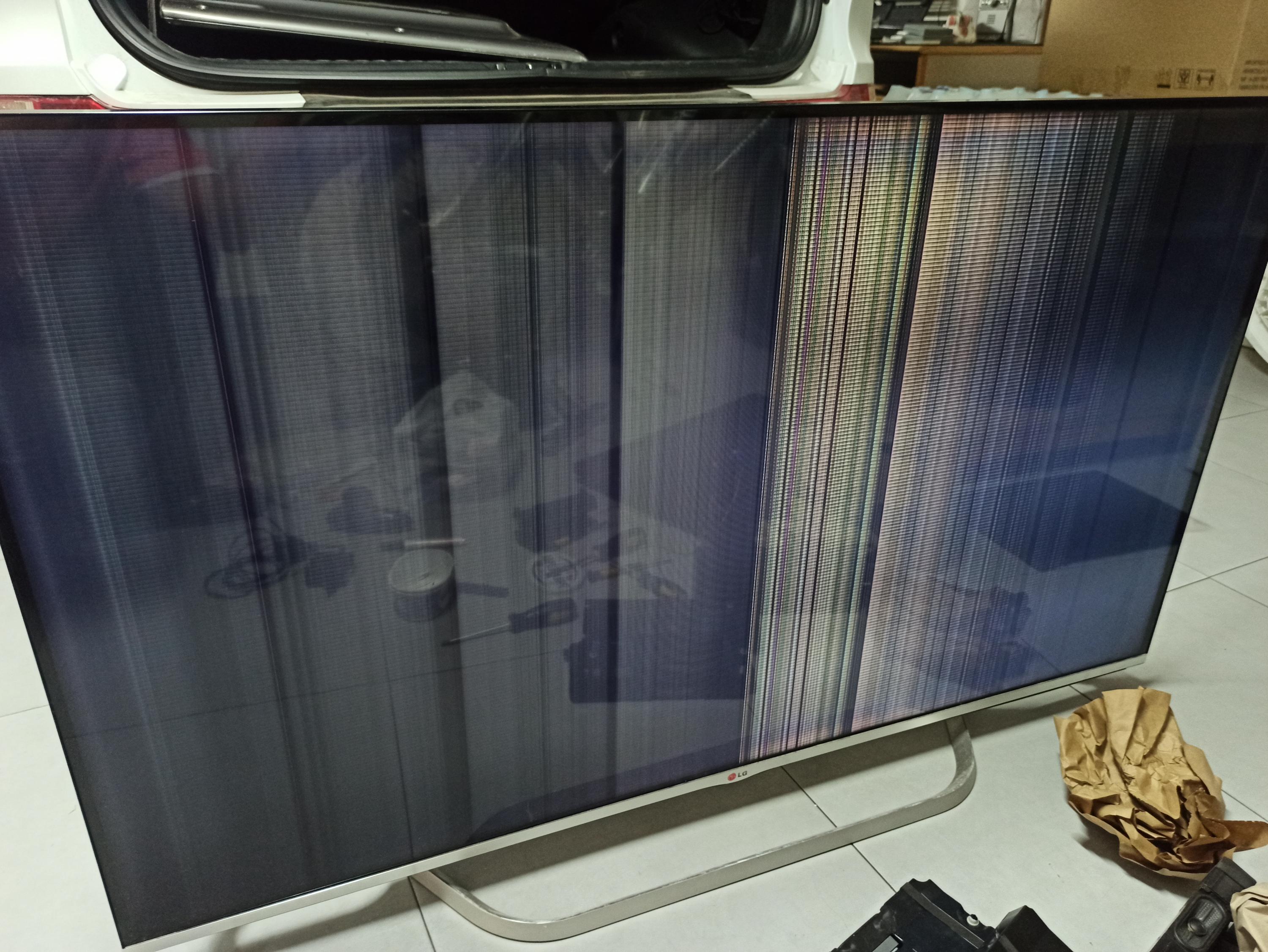

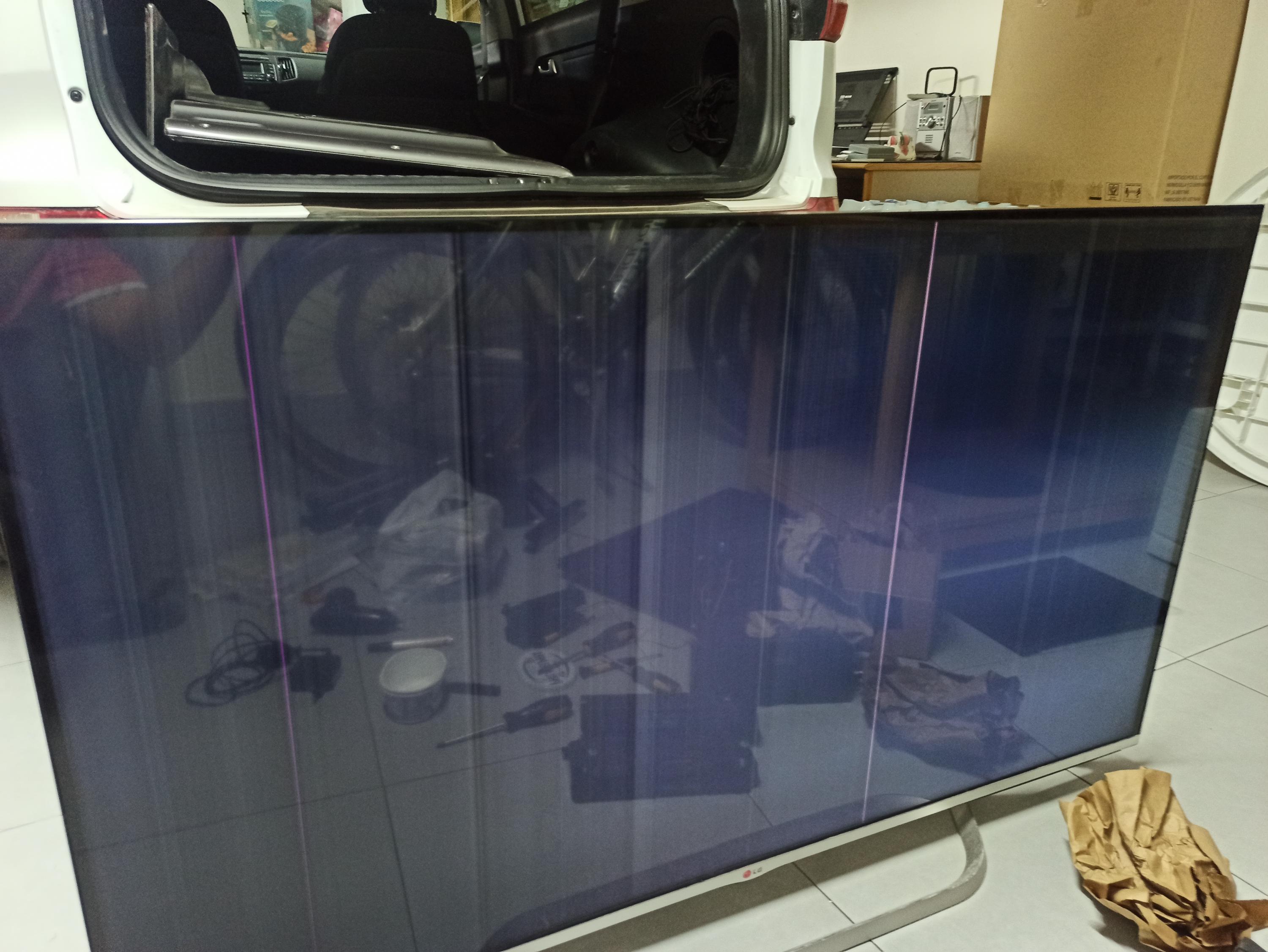

    good night! I pass photos of this tv with vertical stripes. what problem could it be? panel or tcon? the tcon of this model is integrated into the panel. Let's see if they can tell me what to do to see if it can be fixed. the vertical stripes have a certain pattern, because there are some equidistant.

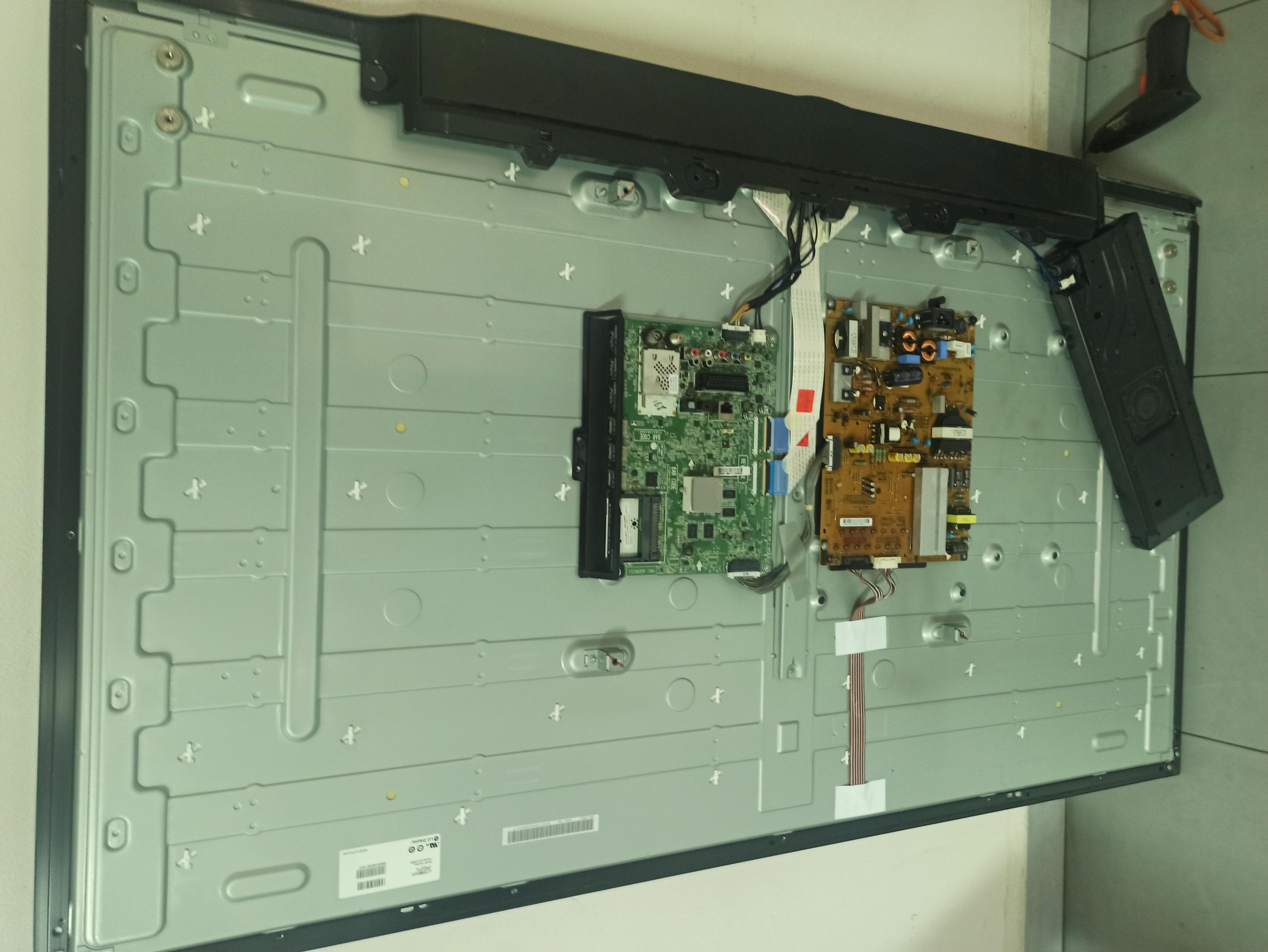

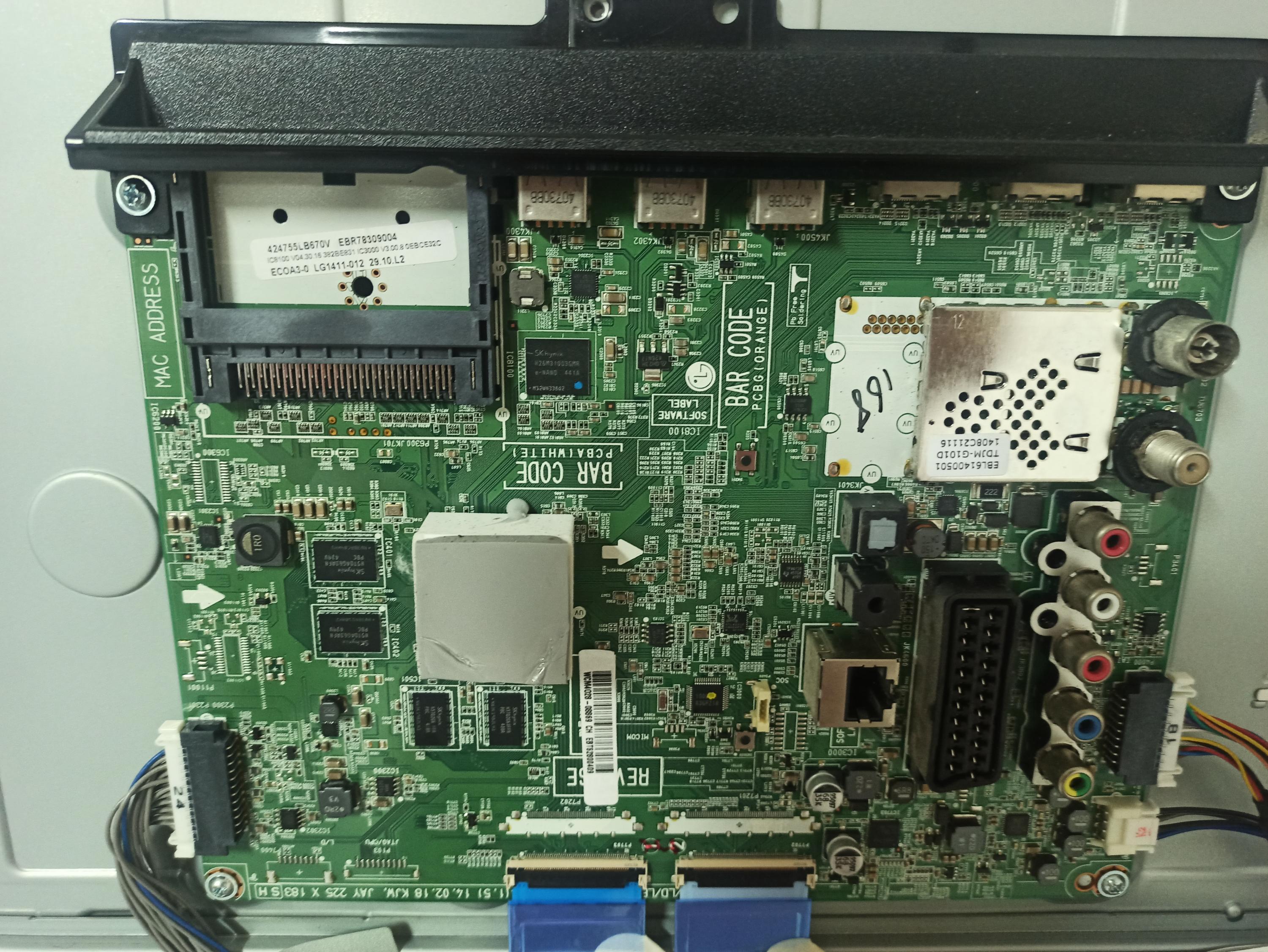

        Good afternoon. Thank you very much for your reply. it may be that I was wrong. I meant that the tcon is on the long boards attached to the panel. However, I am sending you a photo of the main board, because perhaps it is integrated into the mainboard. I hope I have understood your request. It was difficult for me to open it because a screw on the base was destroyed. If you see tcon, indicate the zone, and what tests to do, to see if it is tcon or panel. A greeting and Thanks forward
        If you need more photos, I'll send them to you.

          i asked on panel buffer boards photo not MB lol... see if u have 2 U ribbon on the left and right side.... u need to unplug one at time and see what the screen show u

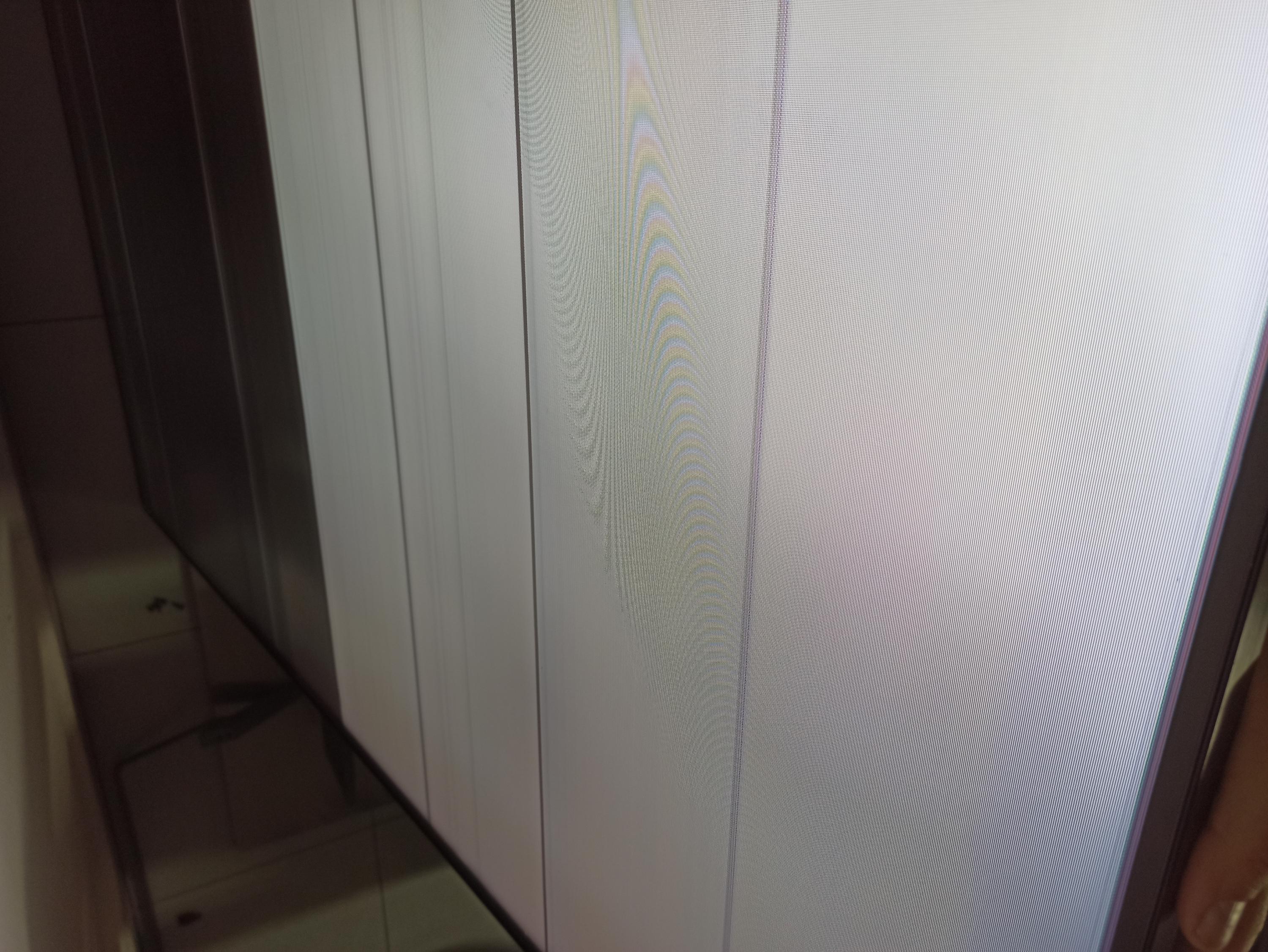

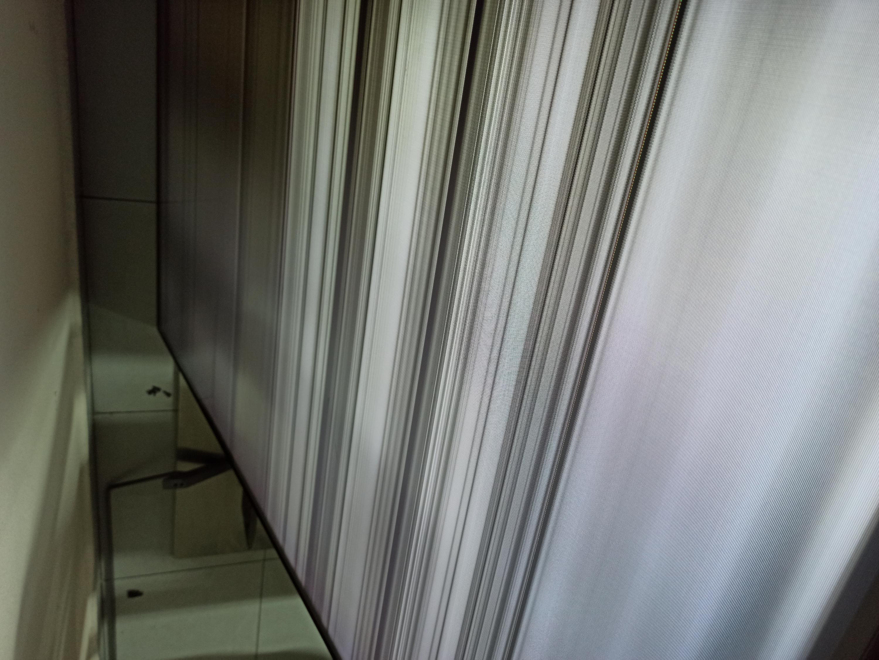

              good morning. in the end there was no rust. I have disconnected a flat cable each time, and the result of the photos comes out. There are stripes in both situations, in one fewer stripes. it has a solution?

                  the panel scrap .. could be it had some kind cleaner liquid / or water damaged the buffer boards of the panel.

                    Ok, so I'll have to throw it away. thanks for your reply. all the best
