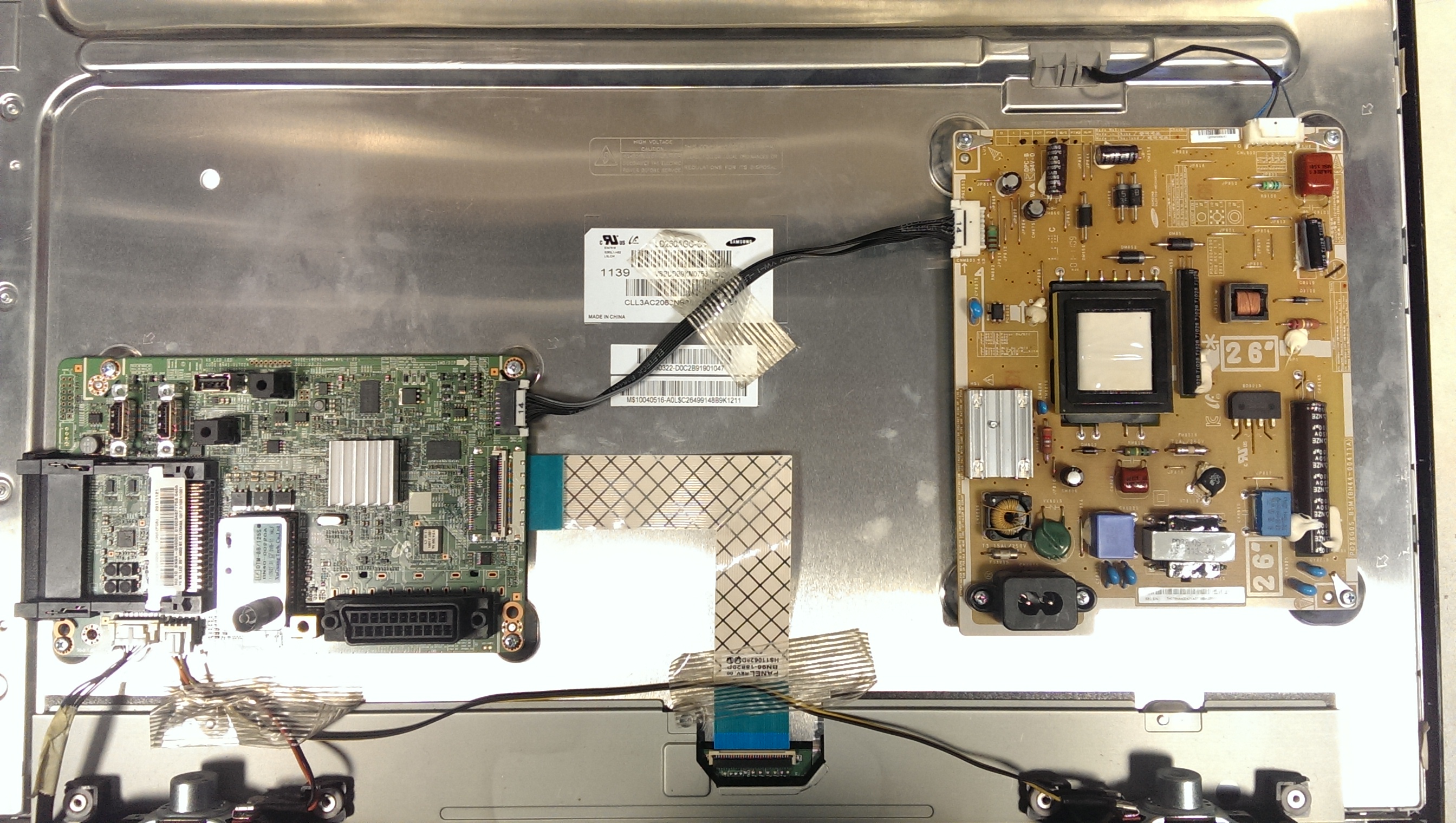

    I've had this TV collecting dust on shelf for a while now, thought i'd give it another look. When i last time worked on it, main board was suspected faulty.
    Thought i'd post this here to be sure.
    The symptoms are: stand-by light flashing 6 times when plugging the TV in. Nothing comes up and no reaction from the buttons. Caps on the SMPS board seem to be ok.
    Also backlight does turn on when mainboard is disconnected.

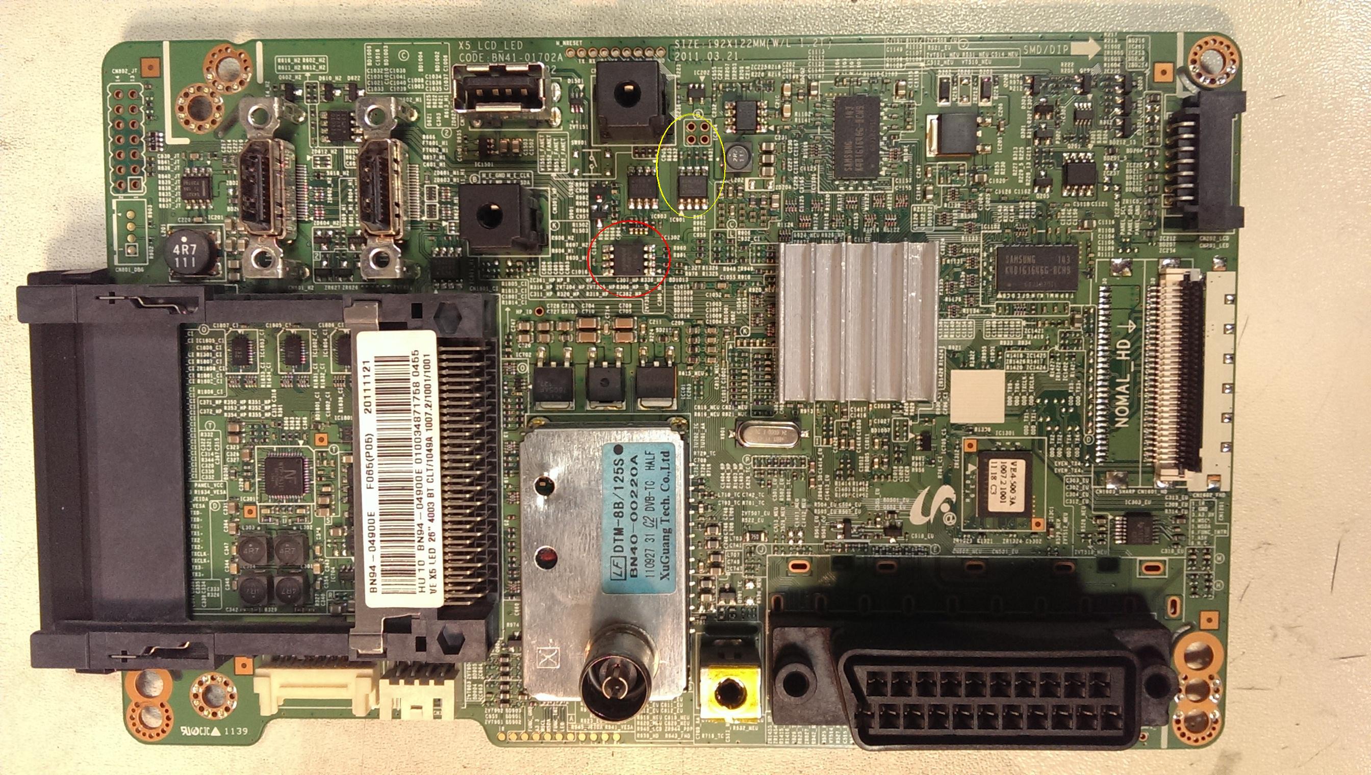

    I want to try resetting the eeprom, but i'm having trouble identifying the eeprom chip, does seem like it's the "Winbond 25X40BVSIG 1143" (marked with red) or the "ATMLH142 2ECL Y 1G8213" that also seems to have 4 debugging connectors on top of it (marked with yellow).
      Re: Samsung UE26D4003BW stand-by light blinking
      That is not an EEPROM, it's an SPI flash. It cannot be "reset"

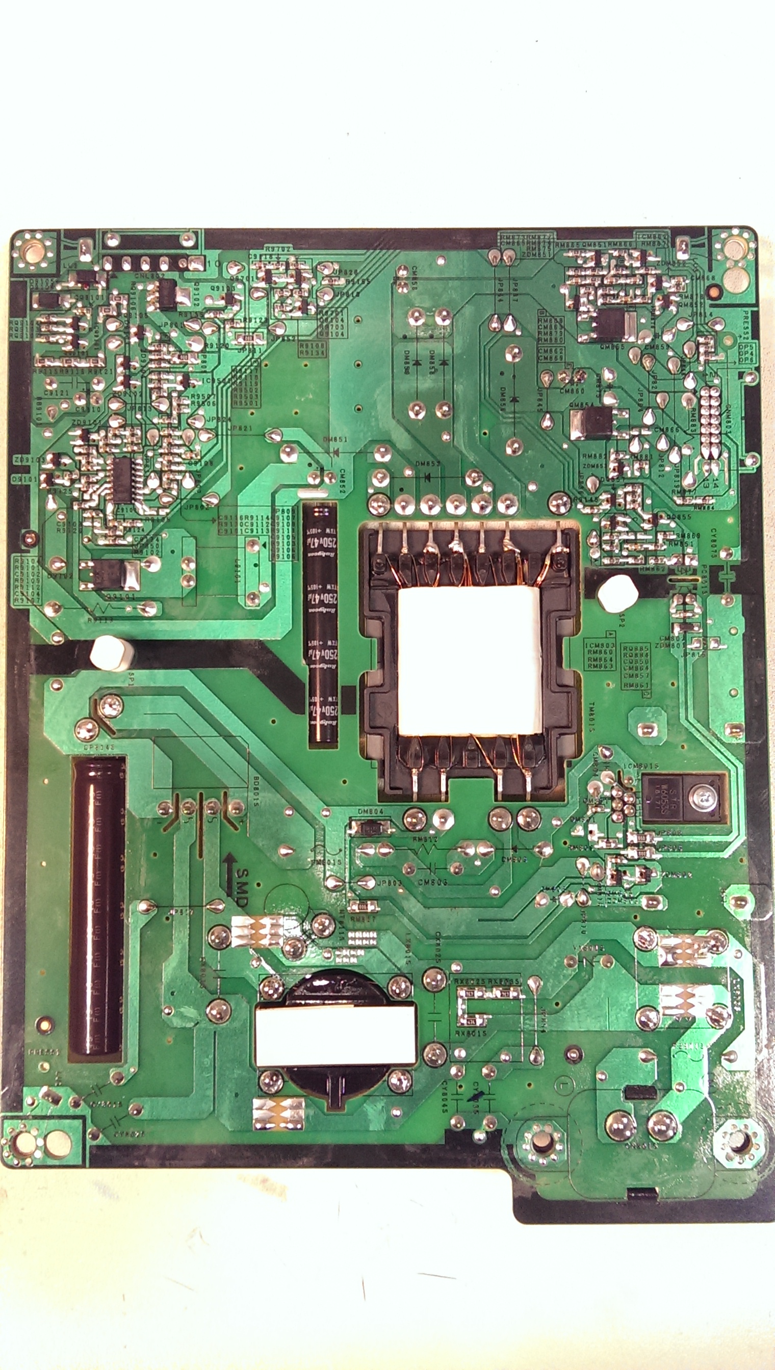

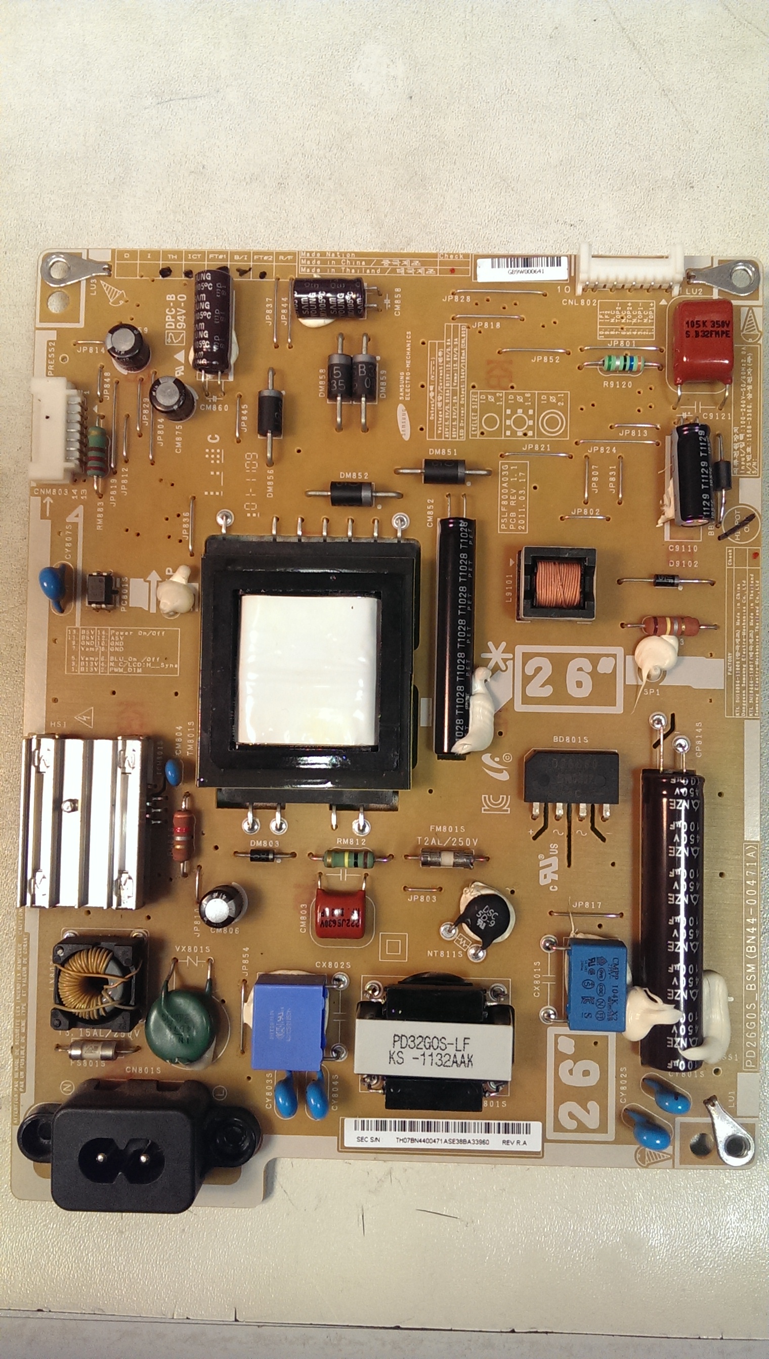

      With main board power cable out, check PSU voltages, all good?

        If you are getting back lights with the main disconnected then its either mainboard or t-con, but this unit looks like the T-con is built into the panel itself so I would bet its a bad mainboard.
        Also blinking power LED on Samsungs means nothing :P

          measured the voltages:
          1. B13V - 12.81V _____ 2. PWM_DIM - 3.01V
          3. B13V - 12.81V _____ 4. N. C/LCD : H -- Sync - 0V
          5. Vamp - 12.81V _____ 6. BLU On/Off - 2.1V
          7. Vamp 12.81V _____ 8. GND
          9. GND _____ 10. GND
          11. B5V - 5.18V _____ 12. A5V - 5.18V
          13. B5V - 5.18V _____ 14. Power On/Off - 3.07V
