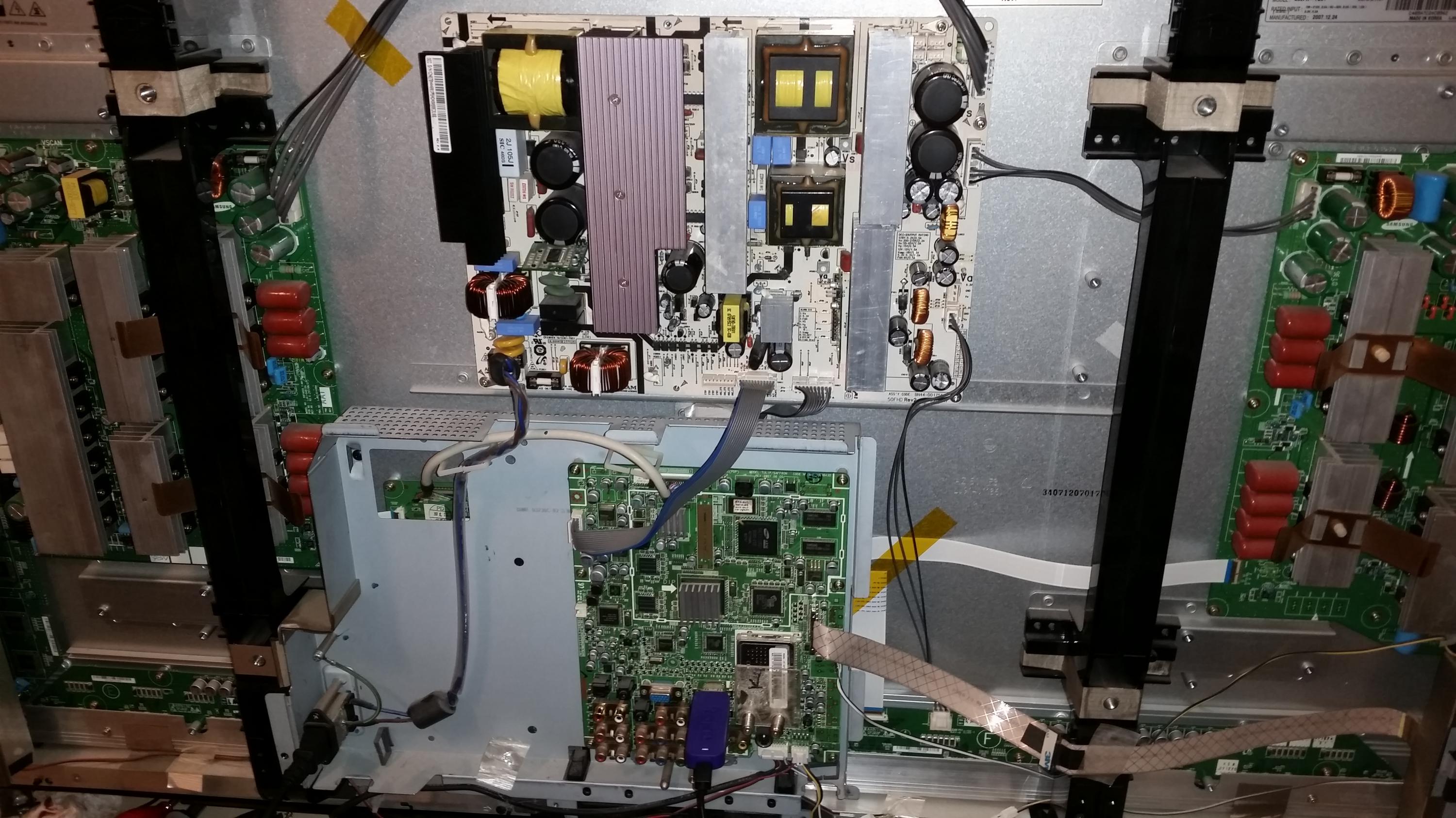

    I well take a look at the cooling the cpu (install a fan), but I don't think its the same issue.
    It click like five times didn't turn the panel at all and a fuse i didn't check the first time was bad.
    After I replaced the fuse the mosfet burned out on the board like the panasonics 50" had a issues with mosfet burning out which blows the fuse's.
    So I'm thinking its the same issue.
    I want to be sure there are no more shorts on the board and replace most of the cap with higher quality caps.
    Maybe I well keep it for me and sell the two panasonics 50" not sure yeah.

                  Re: Samsung FP-5084 Plasma tv Power supply issues
                  Well Got my parts in and board all back together the Samsung fired up. I test all power connections on the board they putting out what they should too. So one bad cap, two bad mosfet and two fuse's then Tv's back to life.:-) I'm learning a lot from this website and from members.
                  Thanks Tom66 and Shinju
