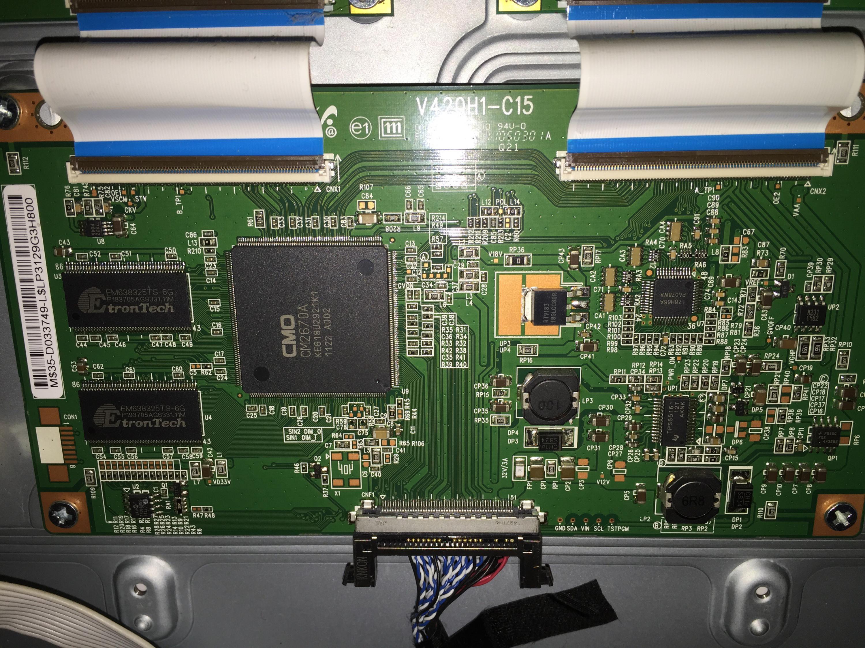

    Re: Seiki SE421TT,Powers on and off. No picture, no backlights.
    Psu
    • johnboy1313
      • Nov 2012
      • 1959
      T-Con

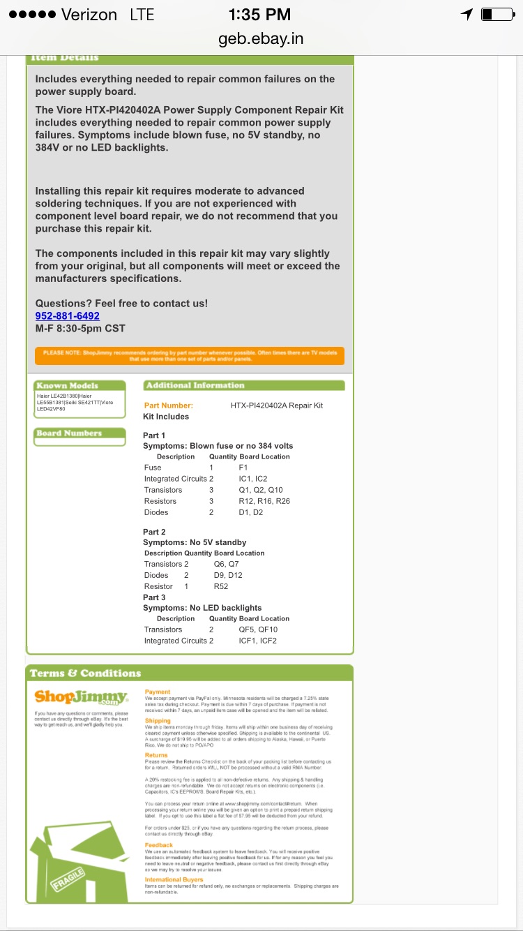

                  I found this while digging around this afternoon. It gives me a starting point anyway. I don't see any mention of the missing12V though.

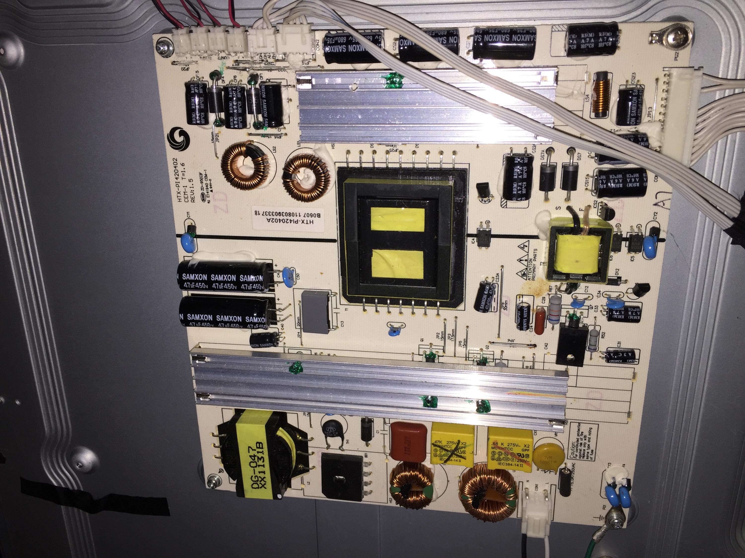

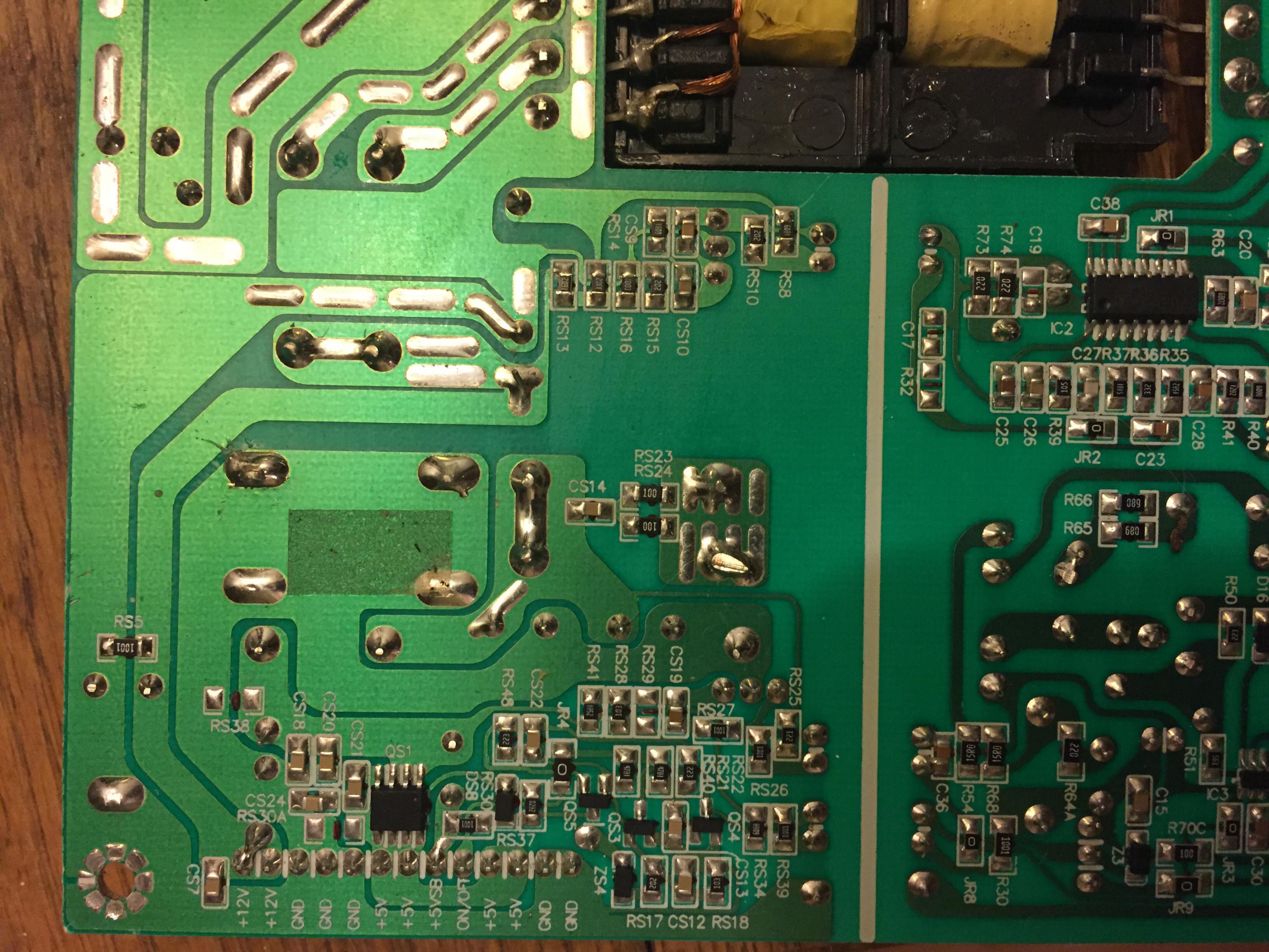

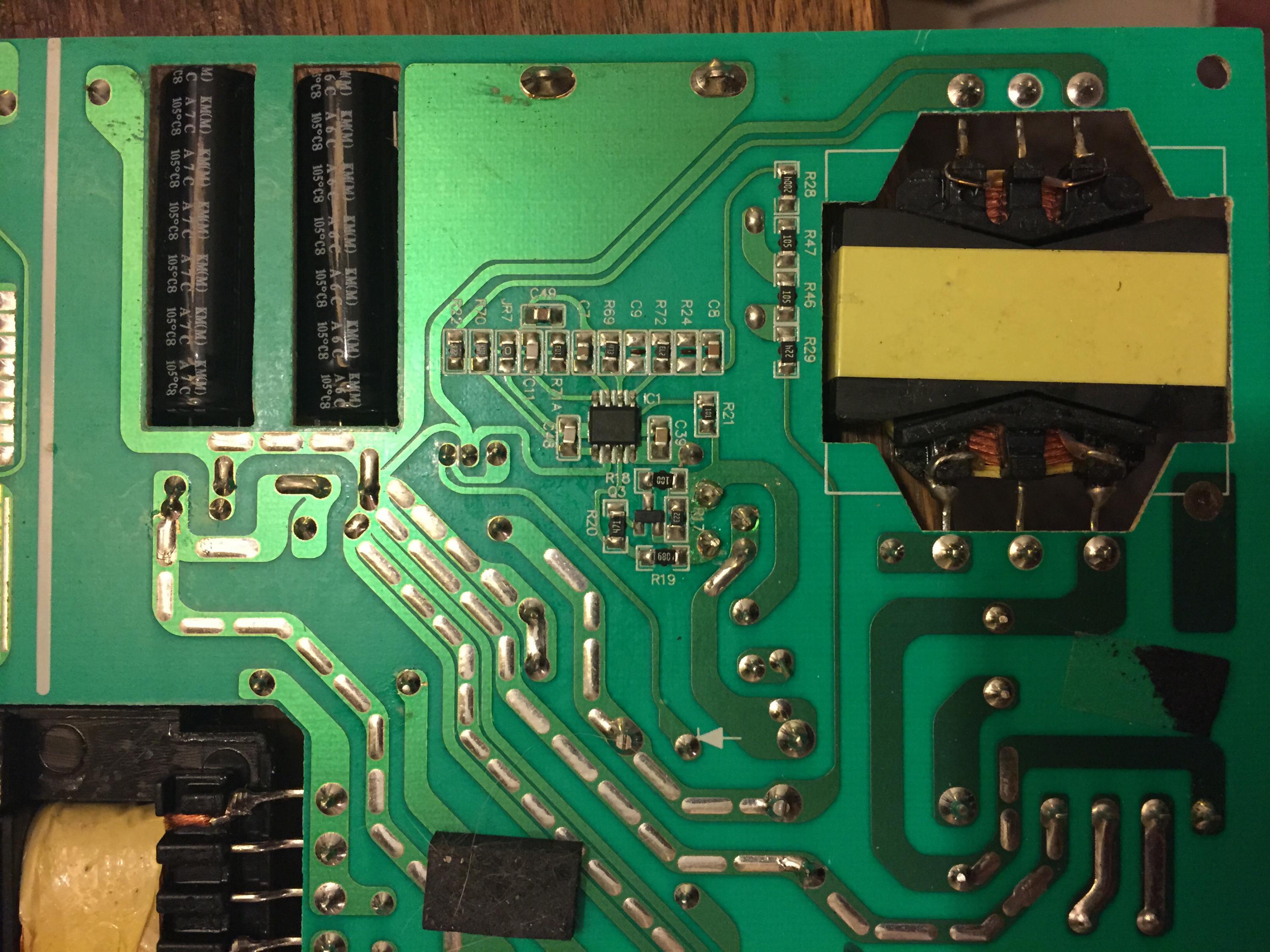

                    It looks like PART3 will be the one in you case since you do have standby and boosted Voltages.
                    SJ does not have the pictures of the bottom side of the board, can you upload your pictures?

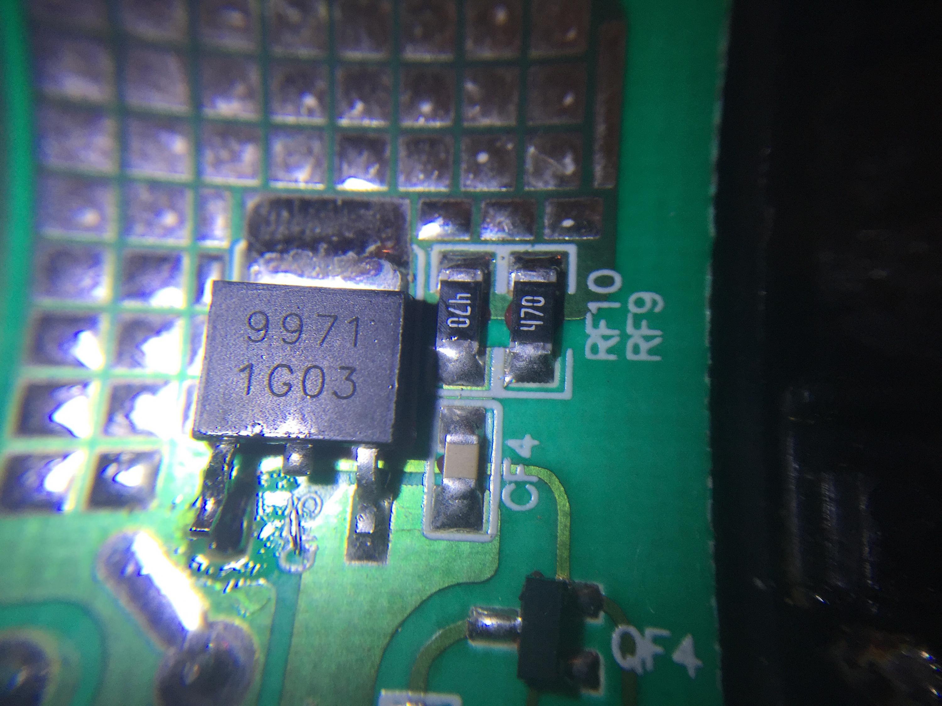

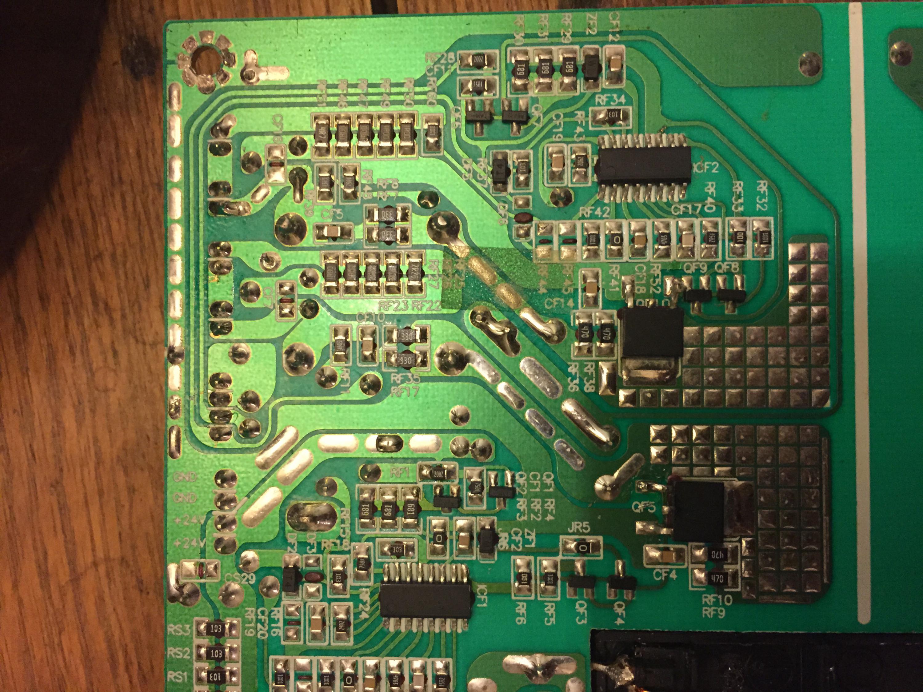

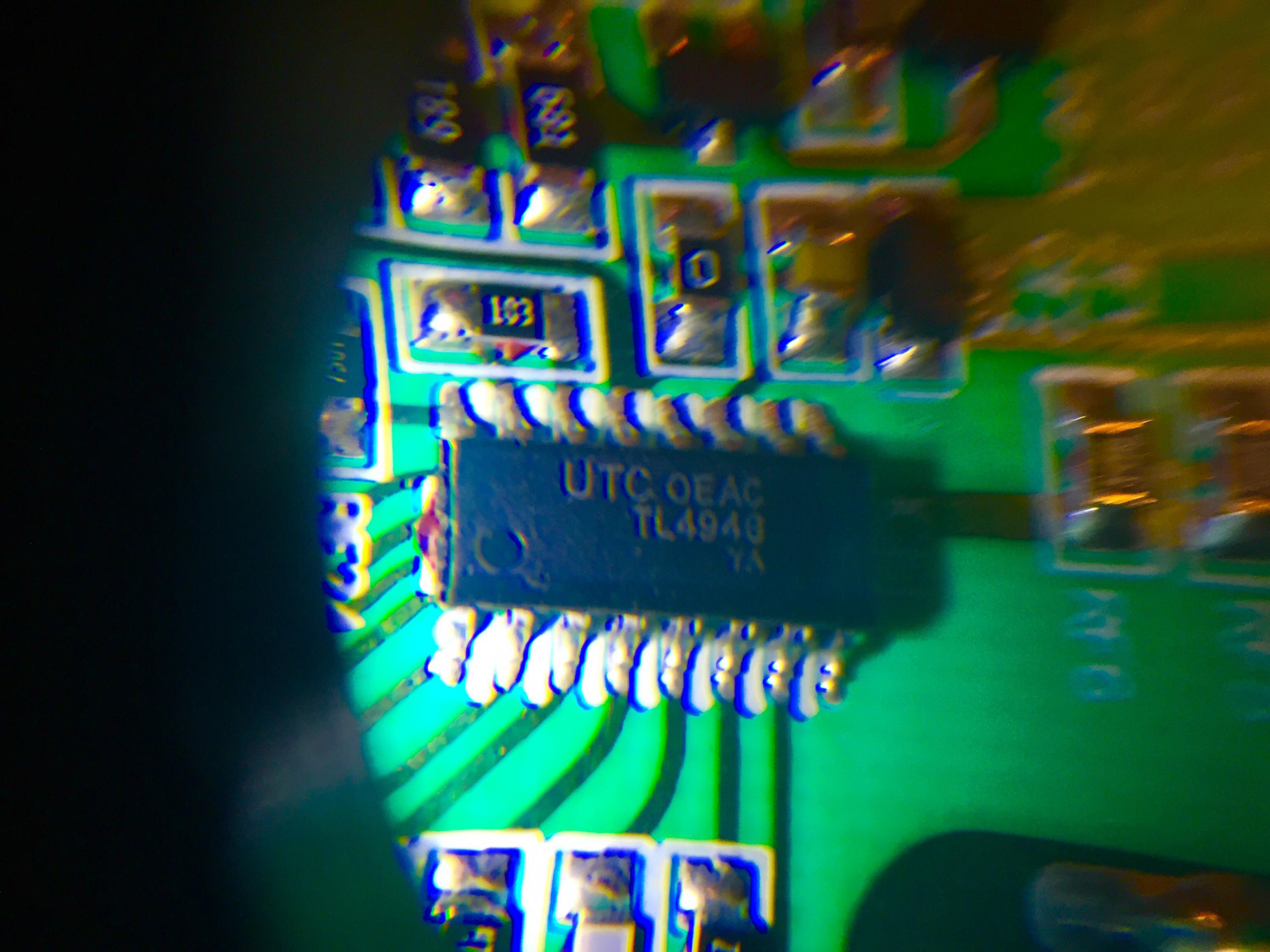

                      So QF5 is failed open both ways in diode mode and QF10 is shorted both ways in diode mode. They are both the same part number. ICF1 and ICF2 are both the same, TL4948. It looks like they're LED drivers but I can't find a data sheet.
                      • johnboy1313
                        • Nov 2012
                        • 1959
                        QF5 and QF10

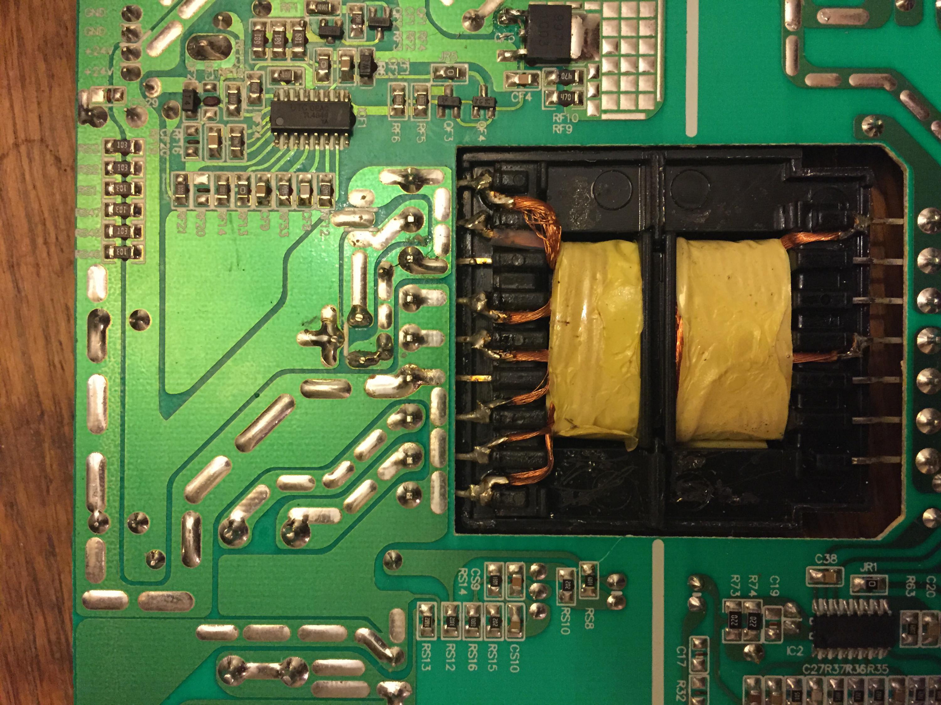

                          Back of PSU, LED section

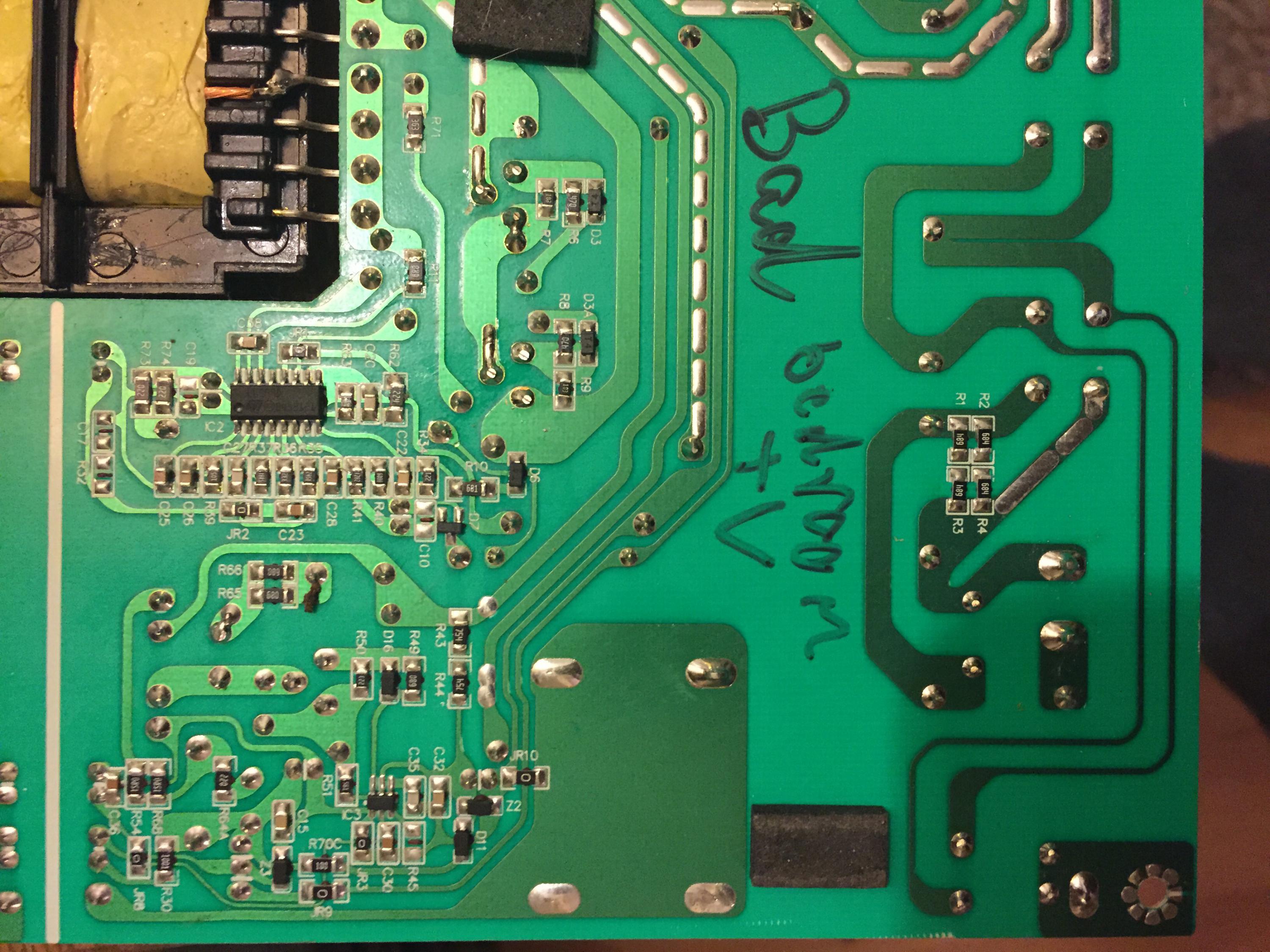

                            Continued, I'm on my phone and it will only let me attach one pic at a time.

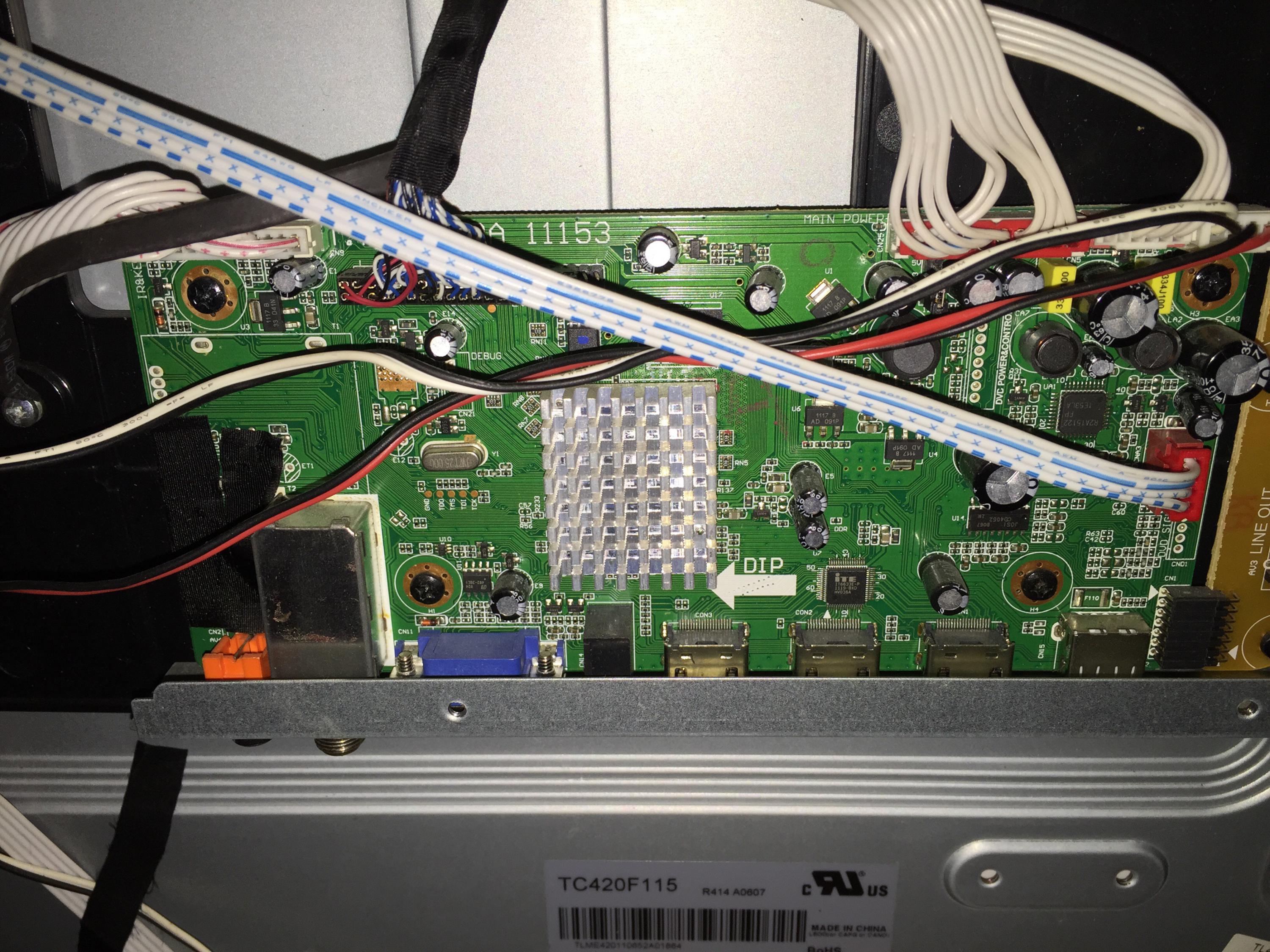

                              Someone's been here before me.
                                Last pic

                                    Replaced QF5, QF10, ICF1, and ICF2. All is good. Thanks to member freakaftr8 for getting me the part numbers for the LED driver ICs from the Shopjimmy kit.
                                    QF5 and QF10 were replaced with FDD5353
                                    ICF1 and ICF2 were replaced with TL494CD
                                    All parts sourced from eBay.
                                    ICF1 and ICF2 were both glued down to the board once all of the pins were lifted. A trace was damaged lifting IC1 from the board.

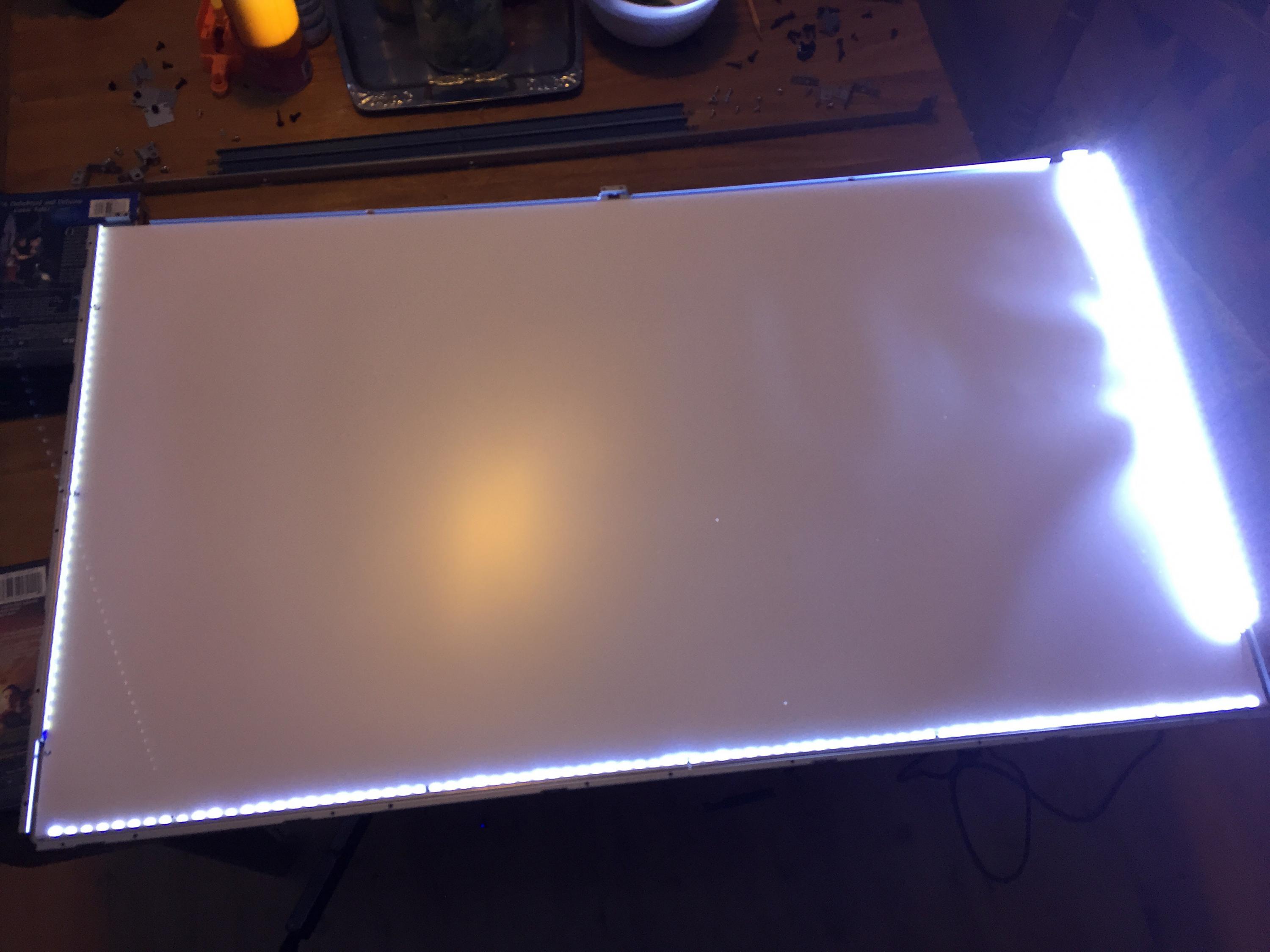

                                      Looks like I spoke too soon. The set works but one side of the screen is considerably darker than the other. This set is a POS. I am done with low cost LEDs.
                                        One of four LED strips lighting.
