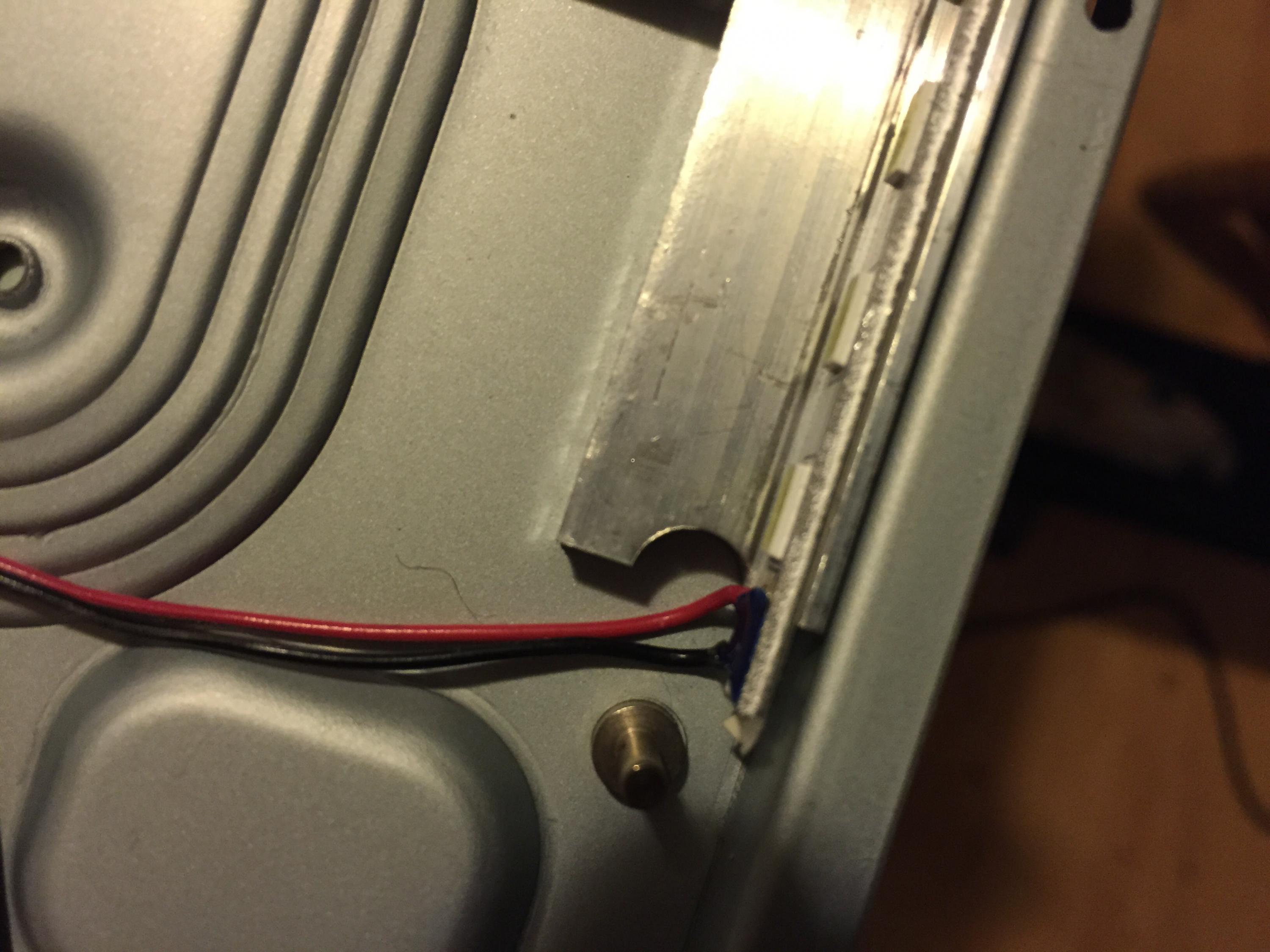

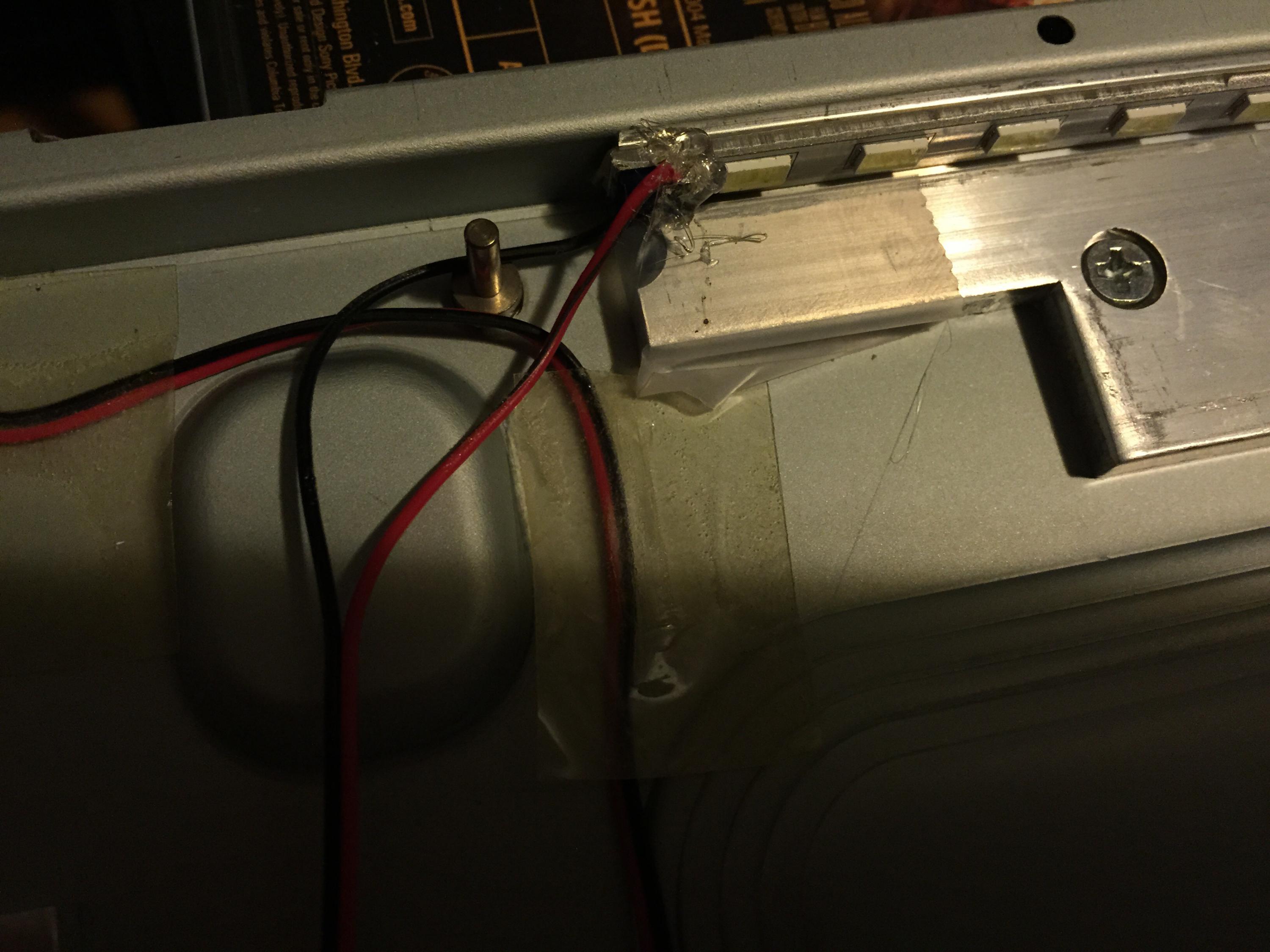

                              #34
                              Re: Seiki SE421TT,Powers on and off. No picture, no backlights.
                              Three of the strips have clearance for the wires. Like this (I'm on my phone and can only post one pic at a time.
                              • johnboy1313
                                • Nov 2012
                                • 1959
                                #35
                                The left side strip doesn't have the same clearance.
                                • johnboy1313
                                  • Nov 2012
                                  • 1959

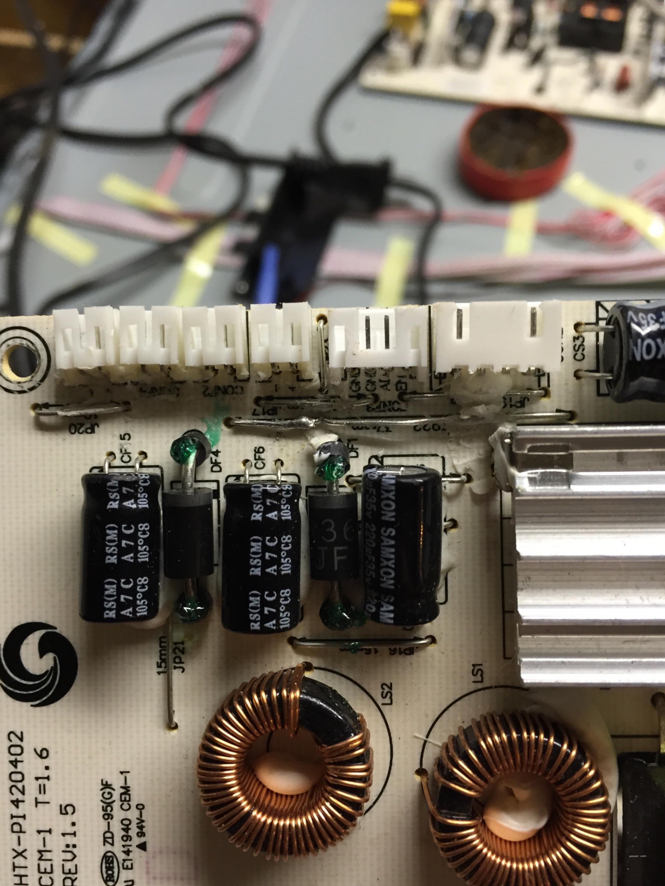

                                  #36
                                  Originally posted by johnboy1313
                                  At the four connectors for the LED strips, I see 12V, 24V, 12V, and 24V. In that order, when looking left to right from the back of the TV. I'm suspecting one of the driver ICs either failed because of the shorted strip or isn't soldered down correctly.
                                  I touched up a bad solder job on one of the LED drivers ICs. Now I see 20V, 40V, 4V (yes 4), and 20V. I'm going to keep playing with it to see if I can figure it out. To be honest, I could live with the backlight as it is if I knew for sure the low voltages wouldn't screw something up in the future.
                                    #37
                                    When I test the Voltage at the output, when you first turn on the TV, the Voltage is at 20V and then seconds later it jumps up to 40V, I guess it is some kind of soft start in case there is shorted circuit so the current draw will not be too high and cause bad damages.
                                    The reading of 4V looks like where the shorted circuit is.
                                    • johnboy1313
                                      • Nov 2012
                                      • 1959
                                      #38
                                      I'll repace that IC and report back.
                                        #39
                                        If you can get the 40V (using chassis as GND ref) at the Cathode of both Diodes without the LED strings attached an the Voltage stays at 40V without going into shutdown, then you will know the circuits are working.

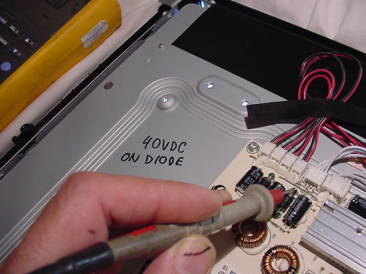

                                          #40
                                          With the LEDs connected or unconnected, I get 40V across the left cap (CF5), 40V at the left diode (DF4), 24V across the center cap (CF6), 24V at the right diode (DF1), and 24V across the right cap (I can't read the label in the pic).
