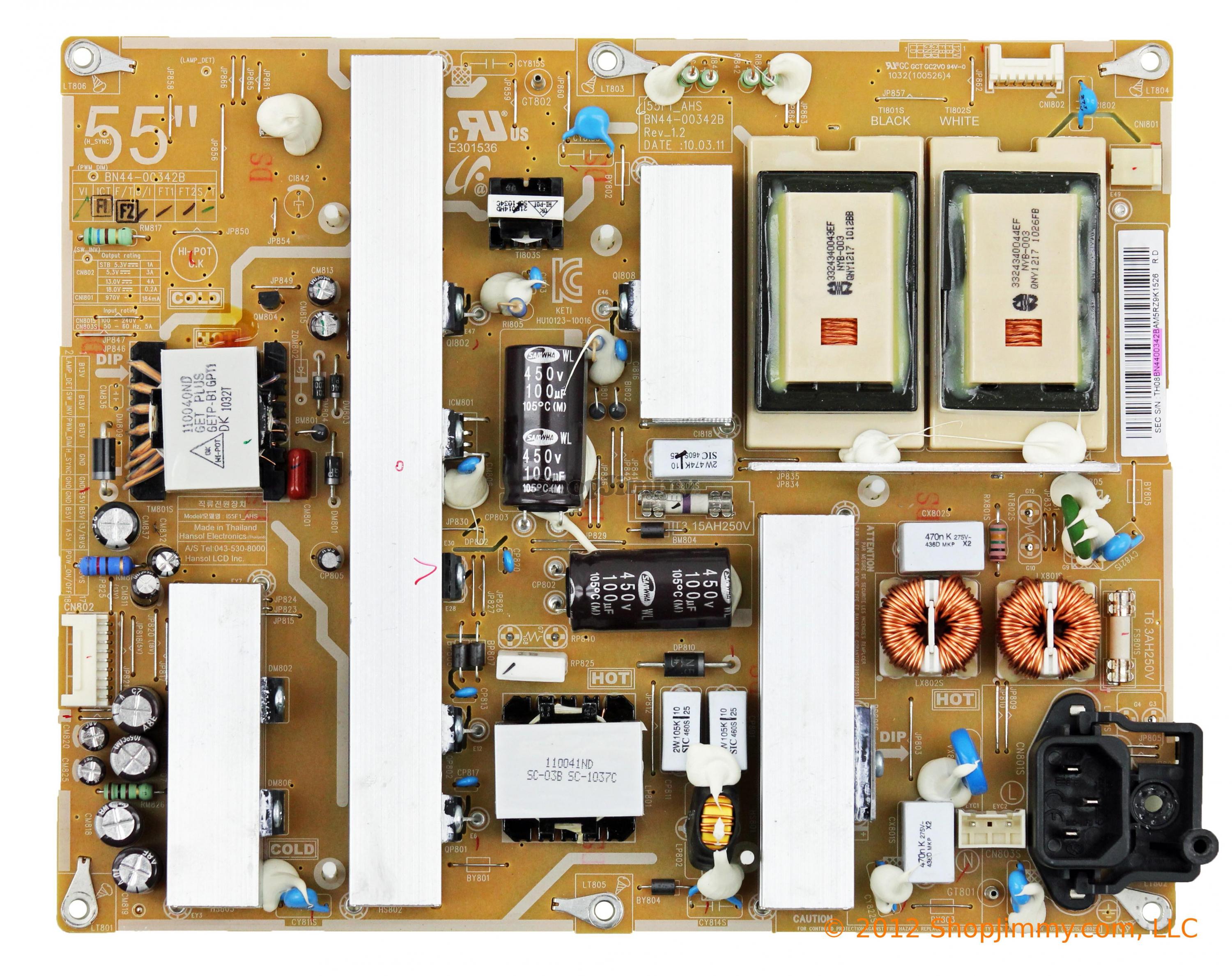

    No backlight but I can see the image when I light up the screen.
    Power Board: BN44-00342B
    Voltage across the 450 capacitor: 163v
    Any help troubleshooting this would be appreciated.
    Thanks guys

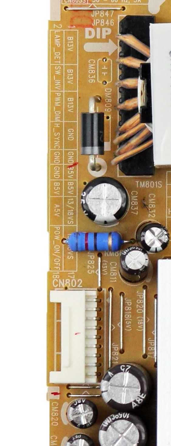

    Re: Samsung LN55C630 Sound ok, No backlight
    https://www.badcaps.net/forum/showthread.php?t=39740
    Report the DC Voltage readings on CN802.
      CN802: 0v
        On every pin....? Are you sure?
          Sorry my mistake
          CN802
          Pin 1: 12.58v
          Last 2 pins: 9v
          0v in the rest of pins
            That is still not right, that connector has double-row of odd and even pins.
              In order to measure CN802, I disconnected CNI801 AND CNI802
              CN802
              1,2,3: 12.62v
              4,5: 0v
              6,7: 5v
              8,9: 18.85v
              10: 0v
              11: 5v
              12: 0.78v
              13,14,15: 0v
              16,17: 5v
              18: 0.8v
                Sorry another mistake in the last post
                this is the right pin out
                1,3,5: 12.62
                7,9: 0
                11,13: 5v
                15,17: 18.85
                2: 0v
                4: 5v
                6: 0.78
                8,10,12: 0v
                14,16: 5v
                18: 0.8v
                    OK, not sure about pin 18 which receives POWER ON/OFF command from the main board, it looks like it is active LO (LO (<1VDC) = ON because all the Voltages are present.
                    The backlights inverter on (pin 4) is present, this voltage should be <1V when TV is turned off, please verify.
                    Also the dc Voltage at the two legs of the main filter caps shouLd jump up to 350~400VDC if the PFC Voltage booster is working, the backlights inverter circuit needs this high voltage to function, if that voltage is staying at 160V, then we will need to look deeper in the PFC CIRCUIT. I hope you do have all the proper tools to work on this board at component level.

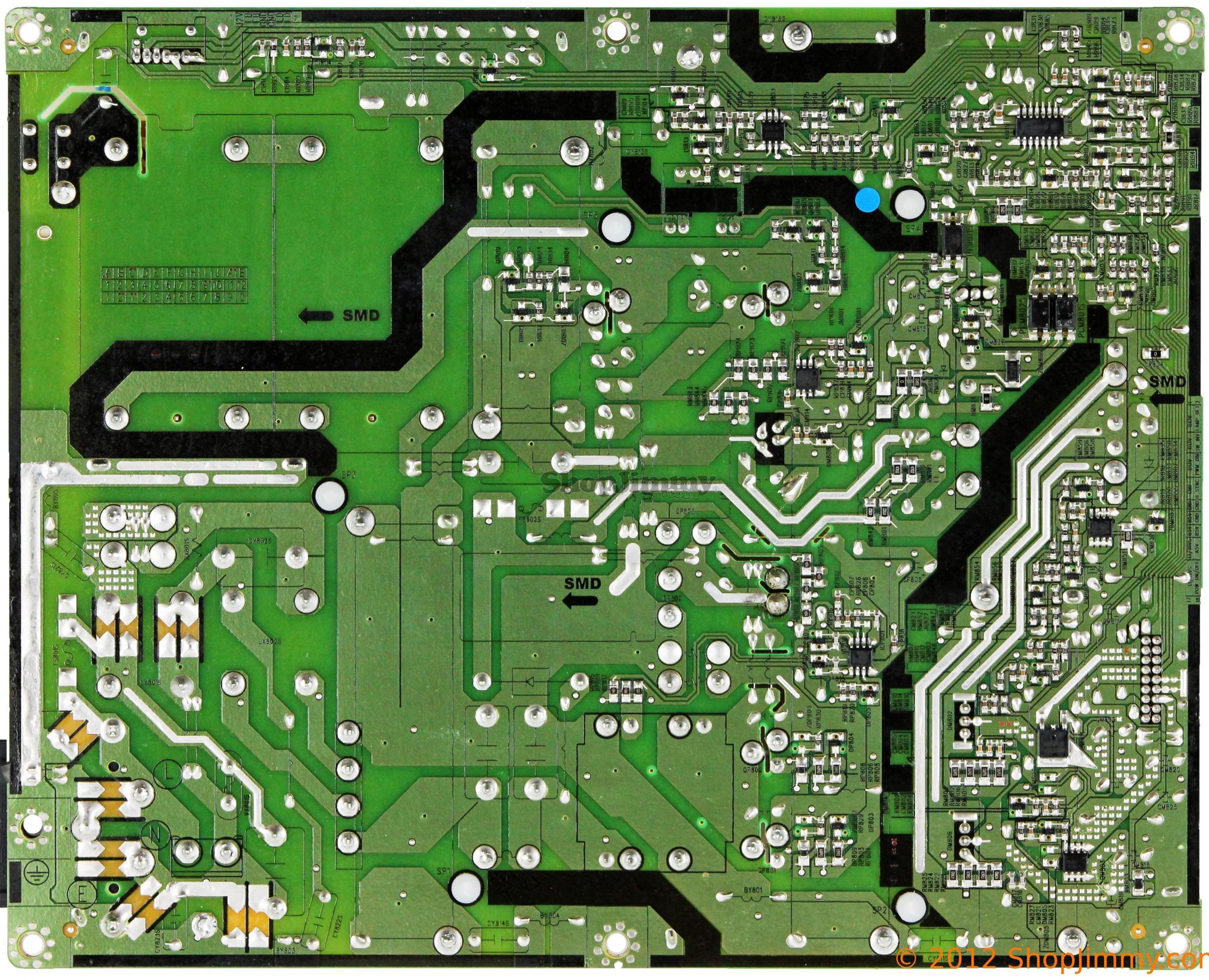

                        So, you did not see the boosted voltage on the main cap, right?
                        Your bottom side of you board matches this picture?
                        • alfredomfr1
                          • Oct 2014
                          • 318
                          • usa
                          No boosted voltage and yes same board
