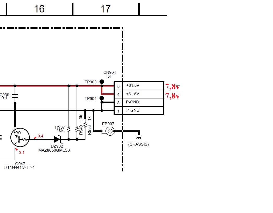

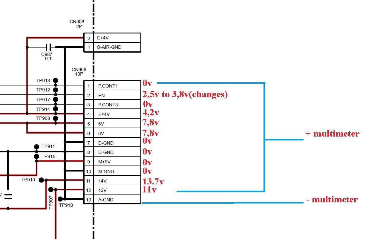

          I am back with new IC MR4020 installed after long and hard soldering of the pins but it is ok and think it is working fine
          Took some measurements of voltage at CN906 and CN908 (PS not in case and only cable to mains is connected)
          At below photos i have the report of all Voltages

            So the 31.5v rail is low, but IC921 was blown, but it does not handle that rail. So maybe whatever is wrong with the other circuit blew IC921 as well?

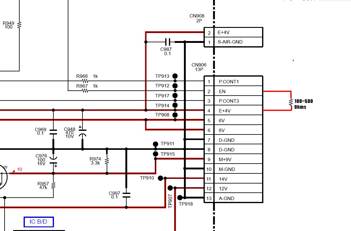

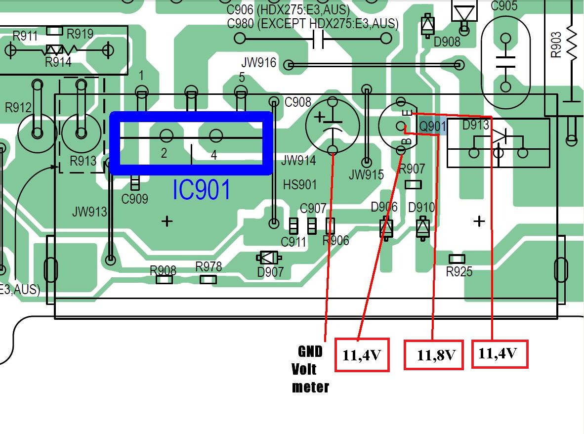

                So what DC Voltage do you have at E, C, B of the Q901 which is switched ON (EN pins goes HI) to pass the 20VDC to supply the VCC to run IC901?
                That EN pin control signal is from the main board should be ON steady. What you can do is to disconnect that wire feeding the EN pin first and then use 100~500 Ohms between the EN pin and the EN 4V to force on the 30V power supply.

                  In picture one i have the DC Voltage E, C, B of the Q901
                  Must i connect 100~500 Ohms resistor as picture two ?
                  Will not do anything until you reply just to be sure

                    OK, something does not make sense here, Q901 is not biased on due to the fact that the E-B junction voltage is the same, it should be ~0.6V difference between E and B.
                    Since Q901 is not biased on then I do not expect any out put Voltage on the Collector pin (transistor is used as a electronics switch to supply VCC to the SMPS IC when EN signal is present). So if you power up the board by itself without other board connected, there should be no voltage on the C of Q901 until force on is applied.
                    I would check the Q901 off the board, it may have leakage resistance between E and C.
                    The input Voltage to the E of Q901 is also low per SCH which should be 20V.
                    The force on resistor connection is correct.
                    BTW, do you have about 20V at the E of Q922?

                      Re: Sony HCD-DZ880W Receiver Dosen't Power ON
                      Voltage at E of Q922 is 11V (With only the cable to mains power pluged)
                        Have also replaced Q901 with new one and voltage at E, C, B is exact like before replacing it...

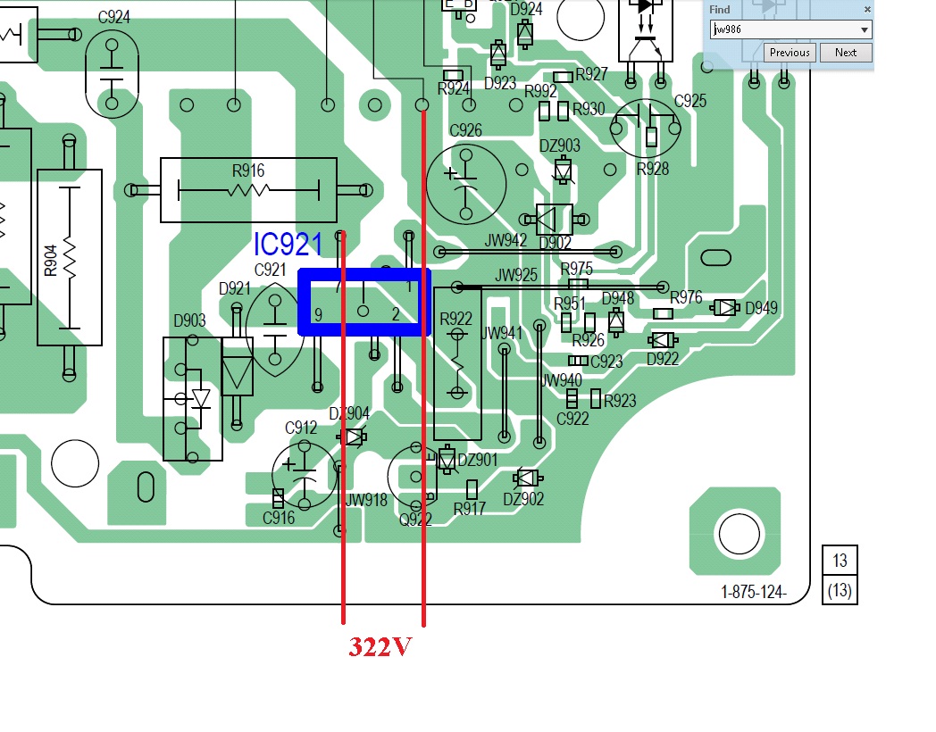

                          Is it normal to have on pin7 of IC921 and GND 322V ?
                          In circuit diagram it says 152 on pin 7 and though maybe i must report this ?
                            Correction, the IC 921 is working because you are getting the always output Voltages, There will be high frequency pulse at the Drain pin 7 of that IC which your meter cannot measure, I do not know how they come up WITH 152V when the feeding Voltage to the transformer is >300vdc.
                                The pulse on that Drain pin 8 will be in 70~100KHz range which is higher than most AC meter can read, and the kick back spike even with snubber R-C circuit (the snubber cap C921 is rated at 2KV for the D to ground through R922) cannot keep it below the supply voltage.
                                PIN 7 is the Vin (it is shown on the SCH as 152) which goes back to the output of the bridge D901 with the red label of 15.2! I think there are many typo on the SCH.
                                BTW, my post 33 should have said pin 8 for the Drain, pin 7 is the Vin from the main bridge rectifier.
