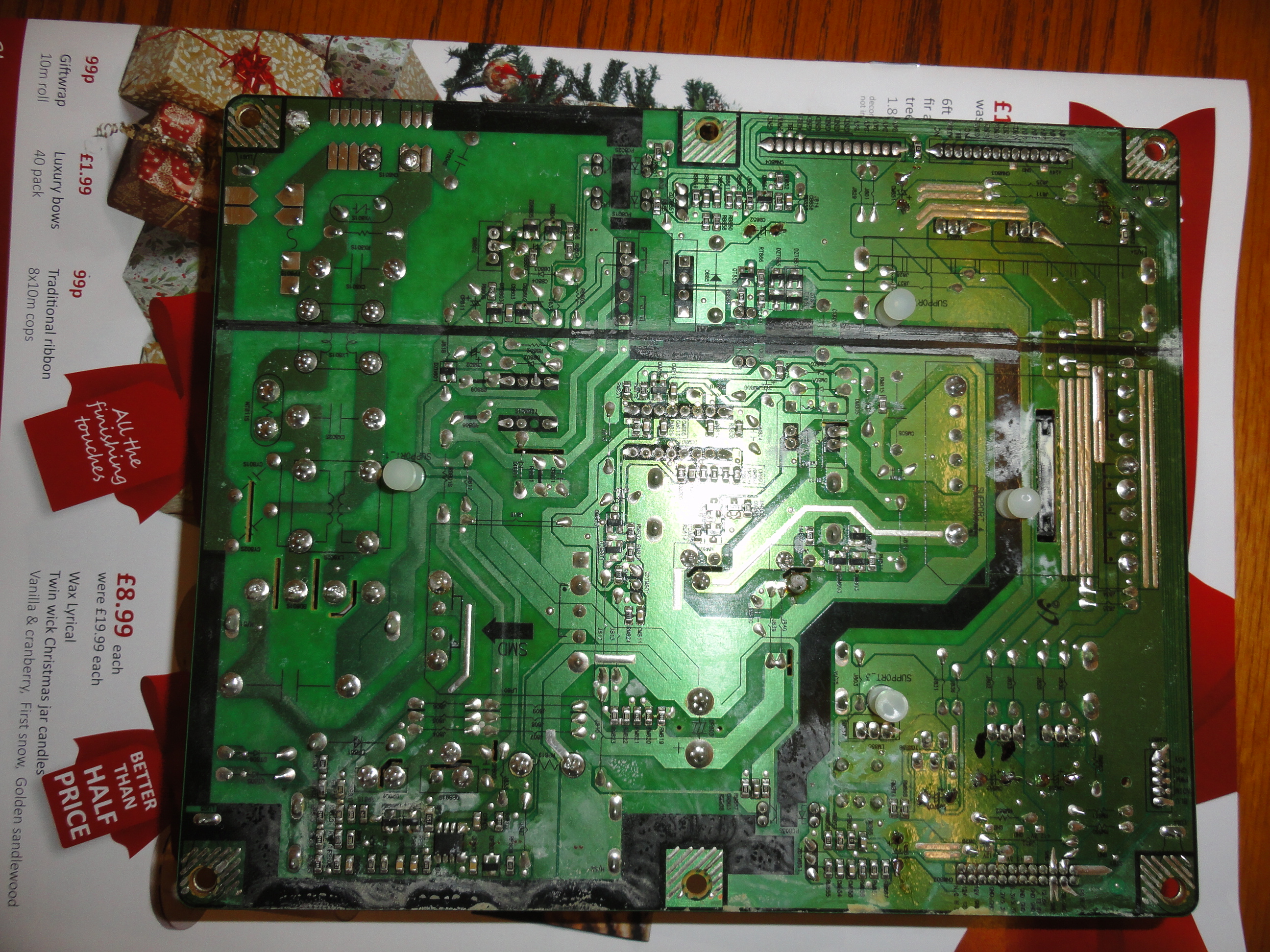

    Did you remove ALL the yellow/brown glue.
    I cant see that you got an answer to why, which is, as it ages, and with heat the glue becomes corrosive and as it turns brown conductive rotting traces and shorting out
    components.
    EDIT

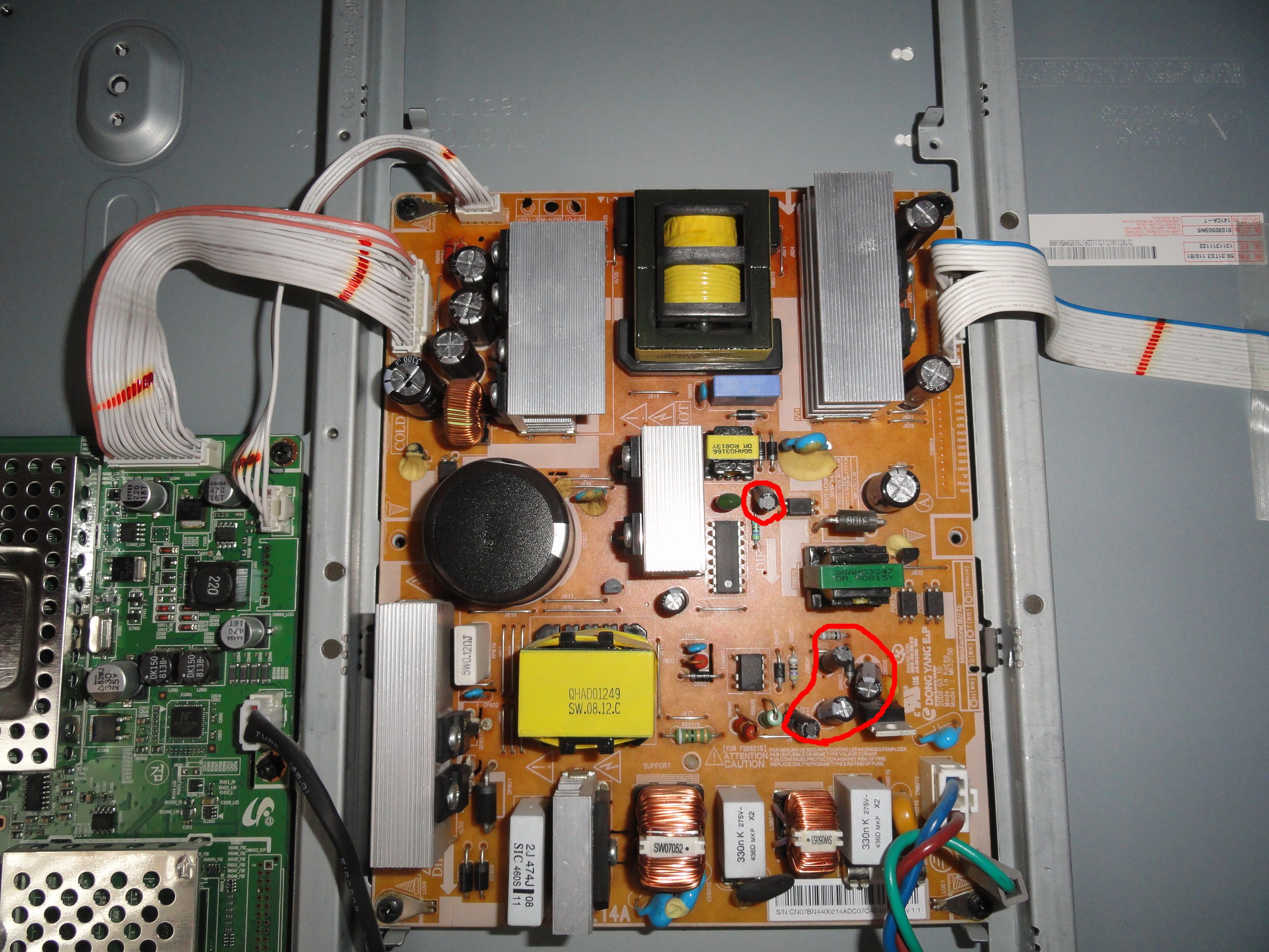

    Did you replace all the caps budm said - there is a group of 4 to the right of the Big yellow transformer, one of which is the startup cap.
    Check over all your soldering and can you post a clear picture of the bottom of the board.

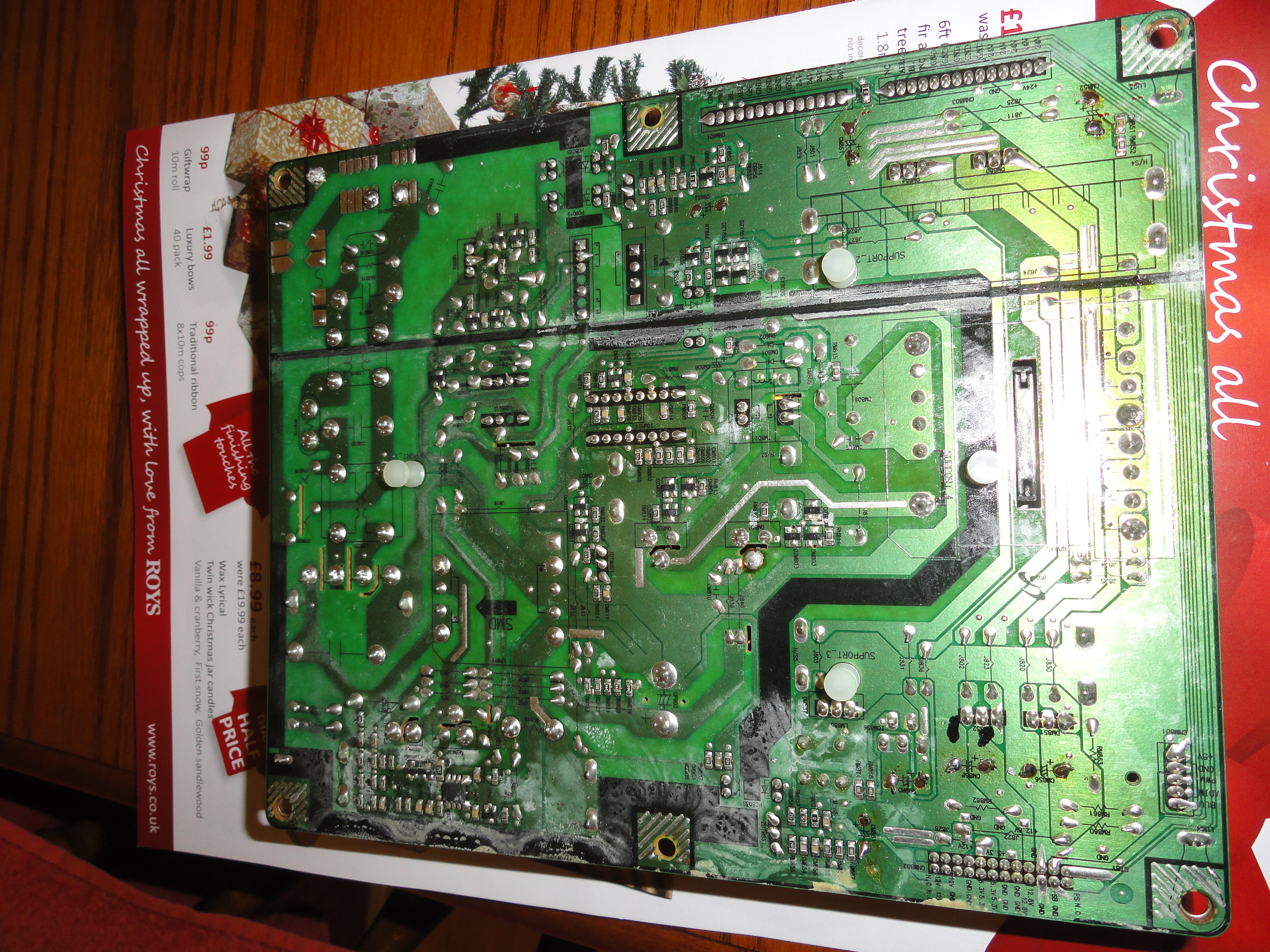

          Re: samsung le32a457 bad cap symtoms but look okay
          heres 2 pics
          looks a bit shabby to my untrained eyes , lots of residue etc?? its never been wet or mistreated owned sinse new
          sometimes trys and trys to come on , flicks on then trys again and eventualy comes on
            How to remove the glue: with great care , not to damage traces or components. It is not easy people have their own favourite tool.
            Dental pick, awl, sharpened toothbrush handle (chisel tip or point)
            Sometimes the glue can be softened a little with IPA.
            Do a bit at a time so you dont loose concentration.

              The Trys and Trys to come on could be the startup cap what values are the 4 small ones.
              it is often a 50v 68uf
                the 4 are
                all 105 deg
                470uf 25v
                680uf 25v (35v now fitted)
                680uf 35v
                3300 uf 10v
                would it also make the tv turn off
                edit - during the off and wont come on , the led can either be off or on

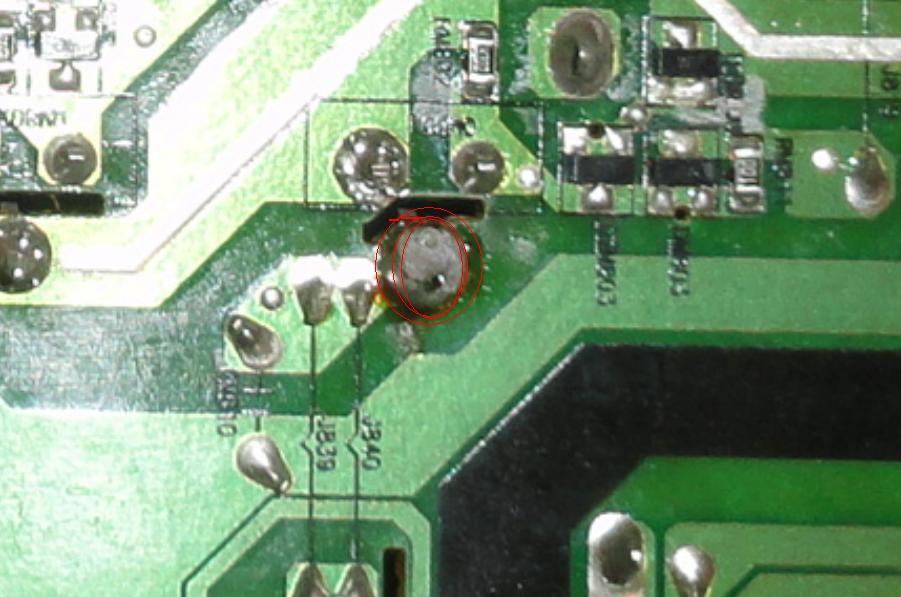

                        Probably not I have been looking at the back of the boards as it may be a
                        bad joint or crack in the solder. Best way is to go over it all with a magnifying glass. I felt one or two were a bit iffy but can you have a look at this one.
                        I recommend removing the old solder and applying fresh.
                          i think thats one ive already reheated ..it did sizzle though is that normal?
                          i can go back and remove and replace the solder
                            #33
                            If a solder joint is sizzling, your soldering iron is probably far too hot.
                              just that one in the pic sizzled ..none of the others did
                              just a little antex 20w iron
