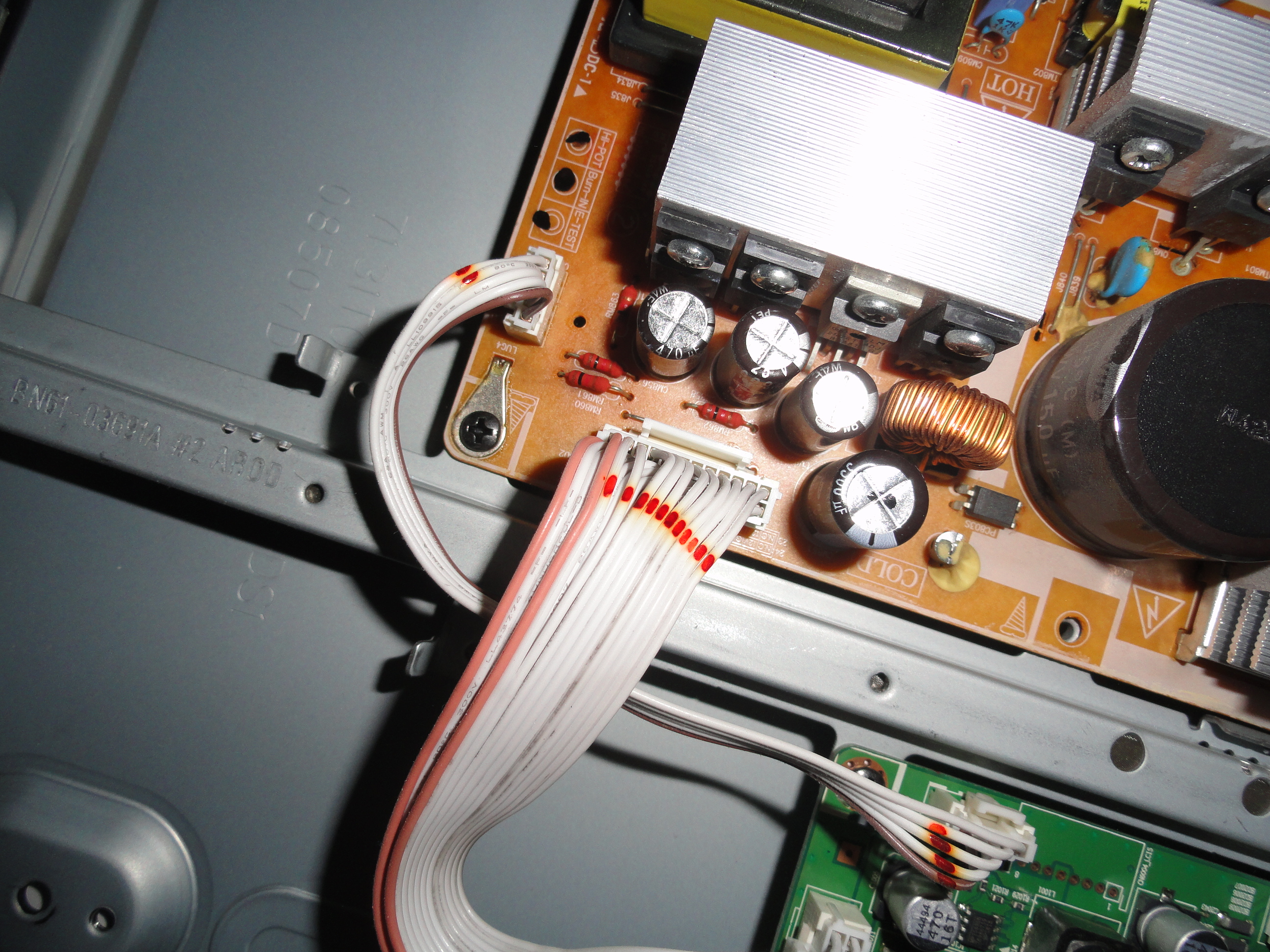

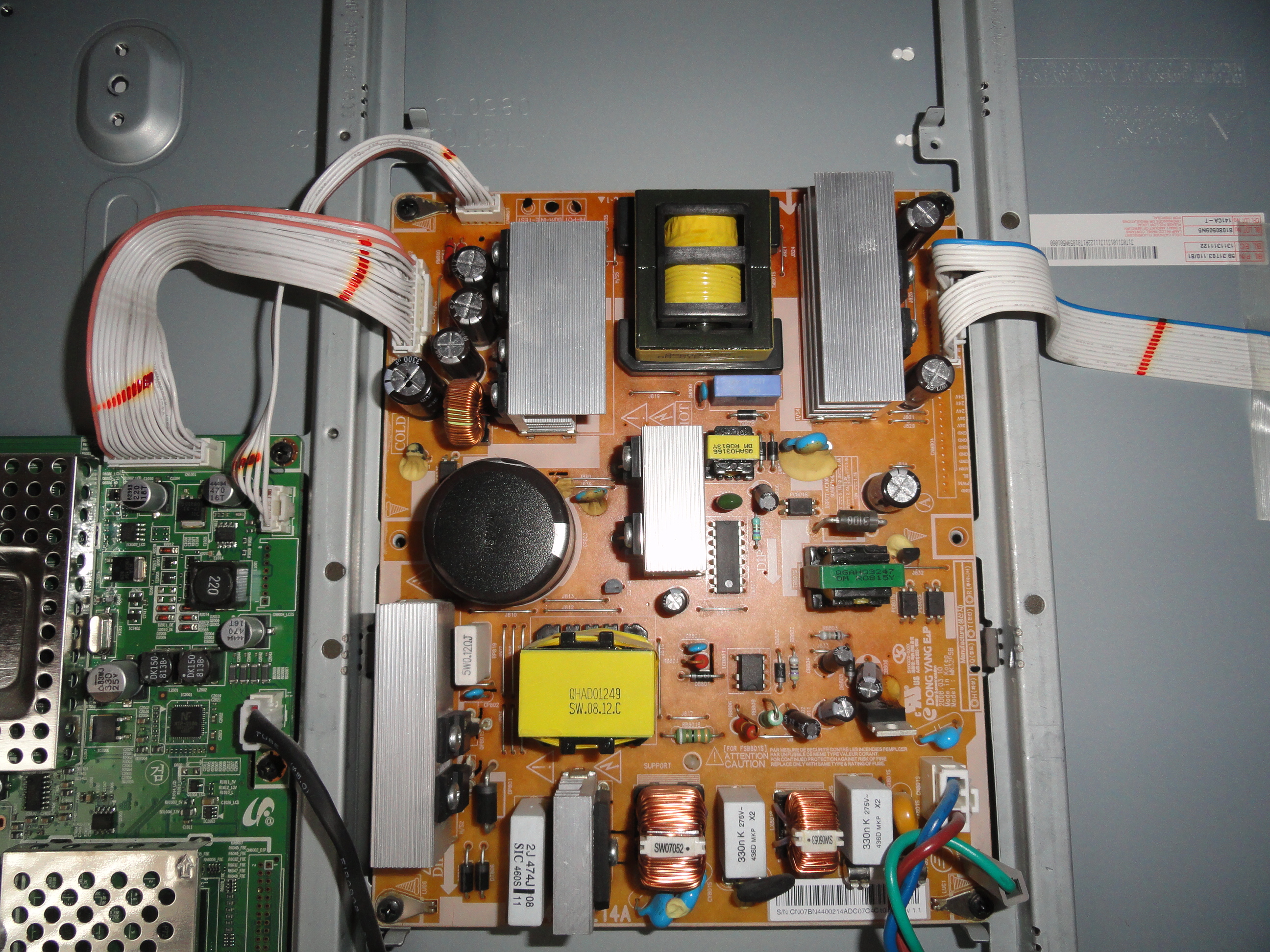

    found this site from googling how to repair my samsung le32a457 tv , its started to turn itself off and now sometimes takes a while to turn on again
    many sites suggest its blown caps

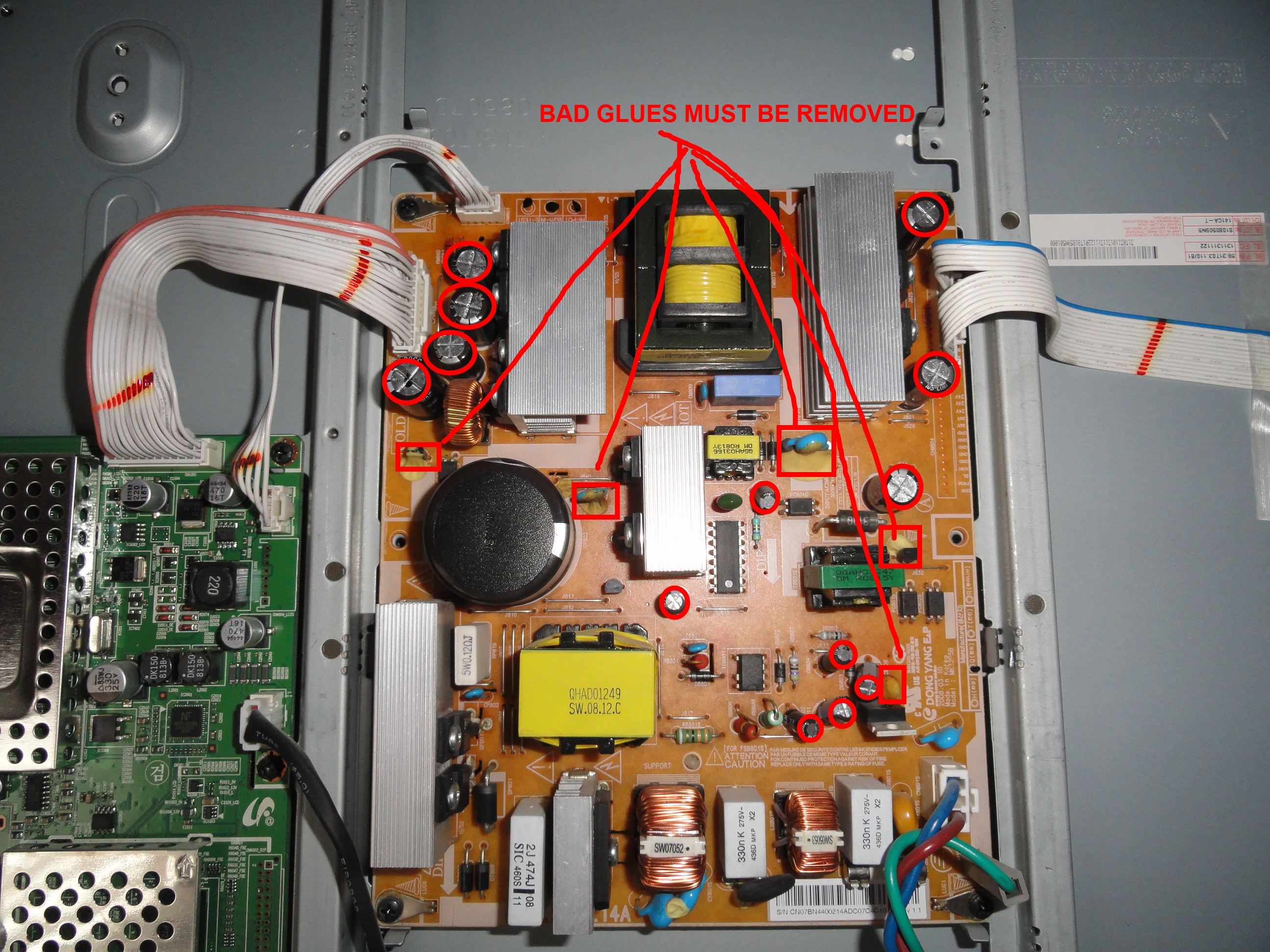

    ive taken it apart and i have no swollen caps , no leakage apart from one dot that looks like sharpie ?
    is it possible theyre starting to fail and havent swollen yet? if so could someone please help identify which ones i should replace please
    i can get all the pics you need ..just tell me what to take pics of
    Re: samsung le32a457 bad cap symtoms but look okay
    See attached picture, those caps in circles should be replaced, those bad glues should be removed.
    Unplug the TV from the AC outlet, then try heating the power supply board with hair dryer for a few minutes to see if the TV will start up.

      ebay kits only include 4 caps..so im best to take down the ratings and replace them all
      you say bad glues? can you explain further on what you mean please , ive never repaired a tv before
        Bud, I seem to remember that the blue poly cap below the transformer has been a problem with this PSU before? Or am I getting mixed up with another PSU?
          Yes, that is also another common failure cap for the 24V power supply. I wonder now if he is talking about the backlights that do not always come on or the whole TV does not always turns on.

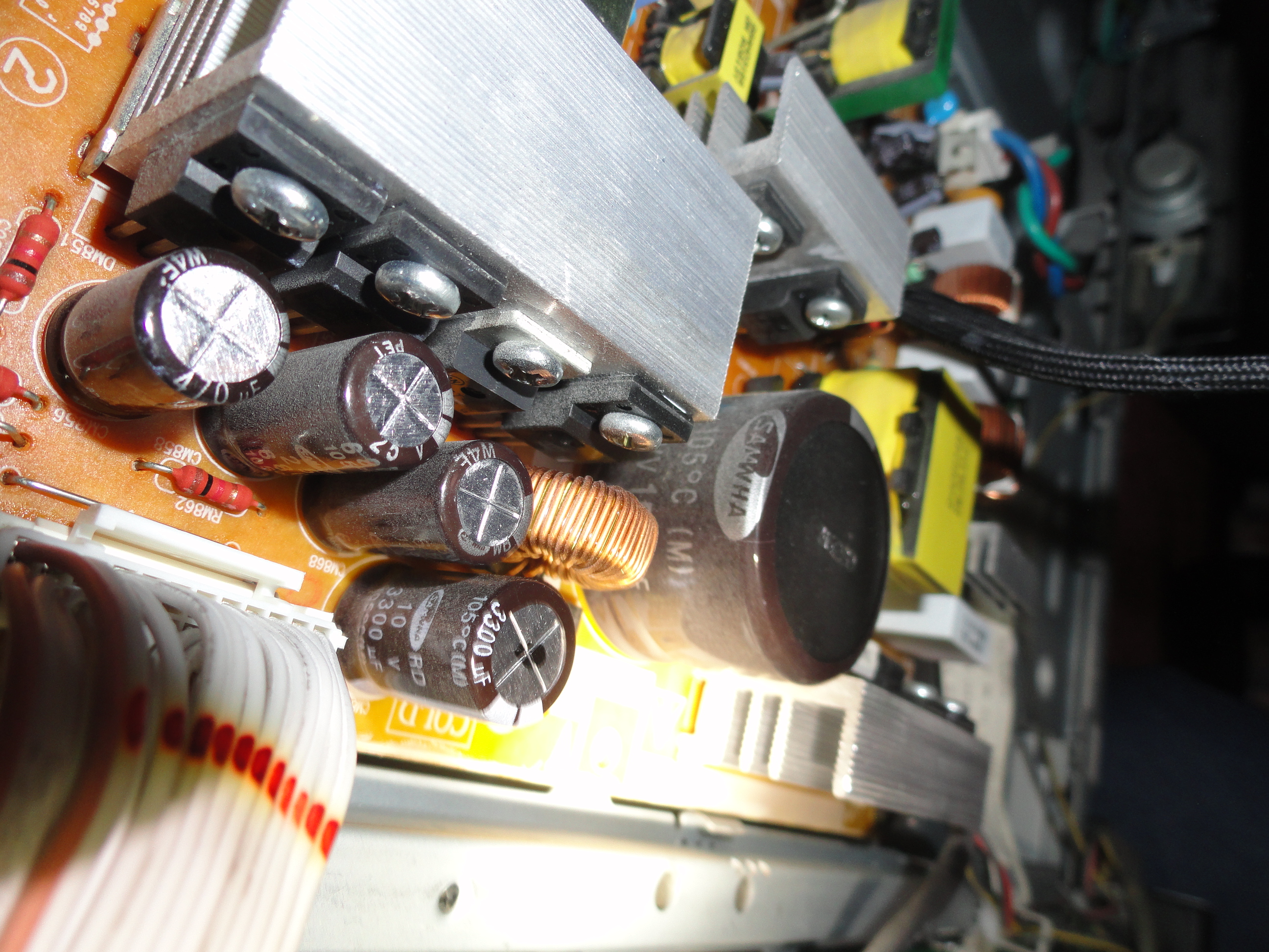

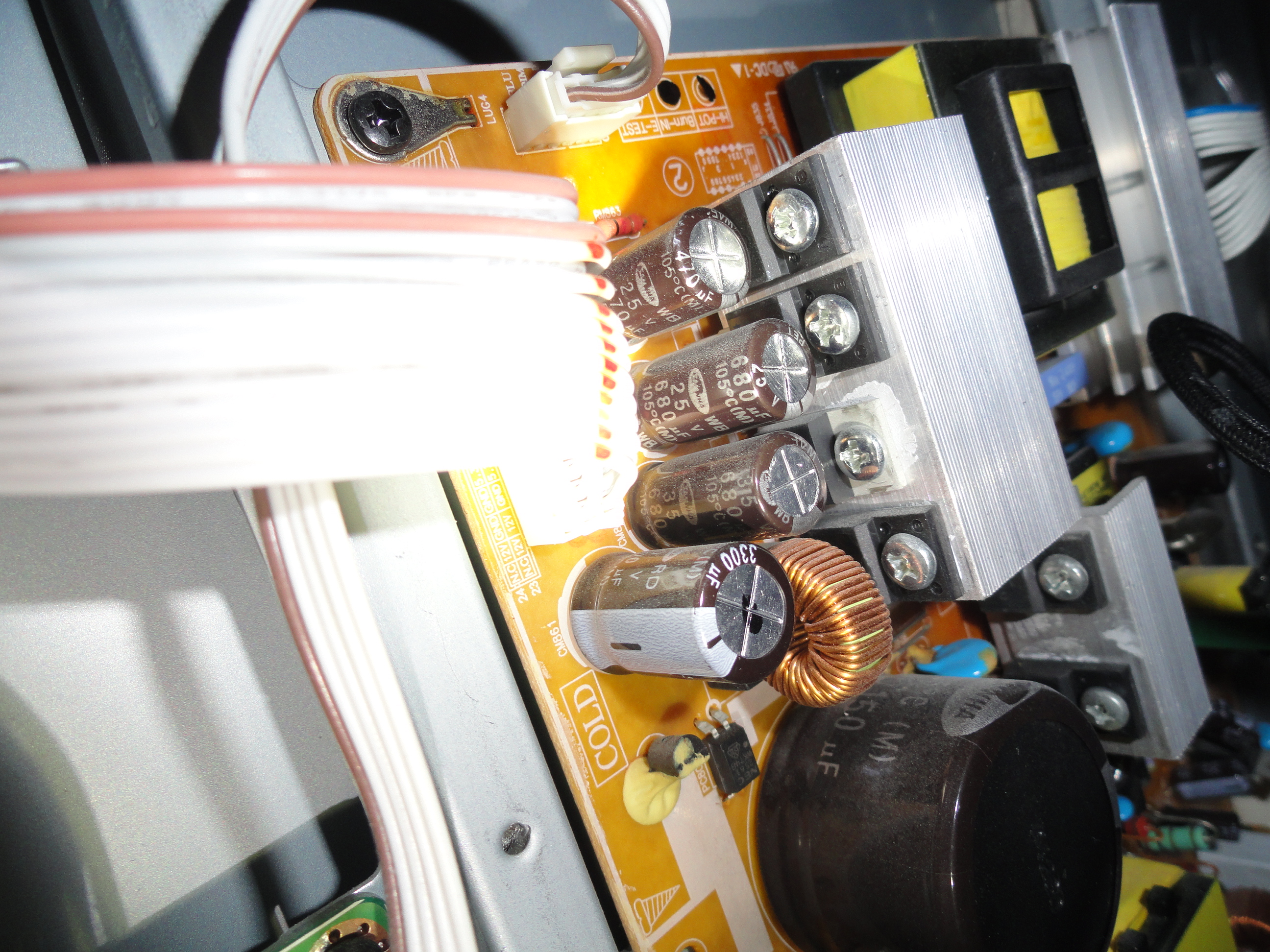

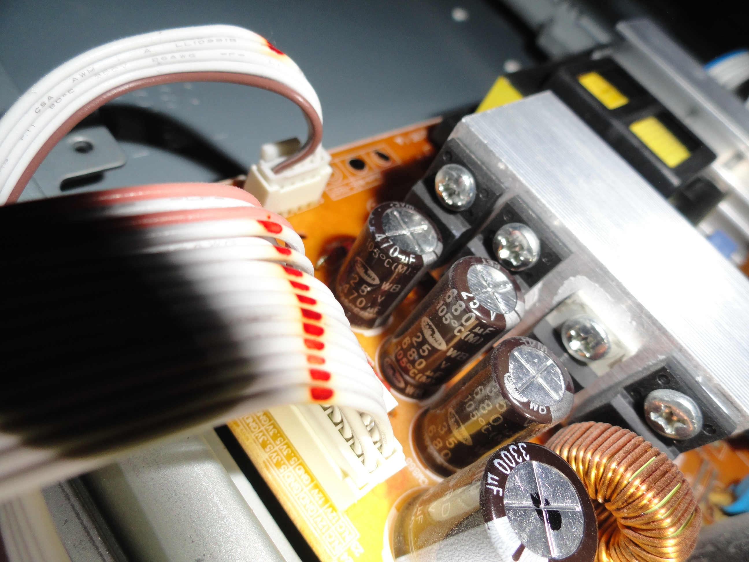

                      so ive replaced the 7 big caps , tv works still
                      after approx 1 hour it turned off but came back on straight away by itself , before i replaced the caps you always had to manualy press the remote
                      so it feels ive done some good ..does the above point toward anything obvious an ametuer could look at ?
                              it said panasonic in the auction but theres no branding on them at all ..so assume no name jobbies
                              this is what it had
                              all 105deg
                              470uf 25v
                              680uf 25v
                              680uf 35v x 3
                              3300 10v
                              2200 10v
                              should i make the 680 25v a 35v to simplify things
                              if you get a min would you link me some correct part numbers , i dont want to get the wrong bits twice
                              many thanks
