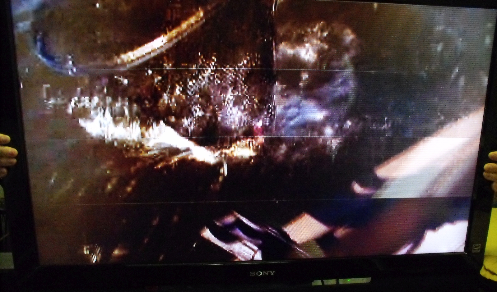

    Sony KDL-46S4100 I know the KDL's are not the best to begin with but I have a TV that works but I just get a lot of horizontal lines or sections and wondering if this is TCON related or a screen going bad like ribbon cables?? Opinions??

    Looks like a panel problem to me. Try running the tv with a towel, or the like on top to heat up the cabinet, and see if it clears up... I know sounds stupid, but if its a tab bond problem it will fix it self , but only until it cools down.
      Re: Sony KDL-46S4100 TCon or Panel?
      Definitely panel, IMHO.
