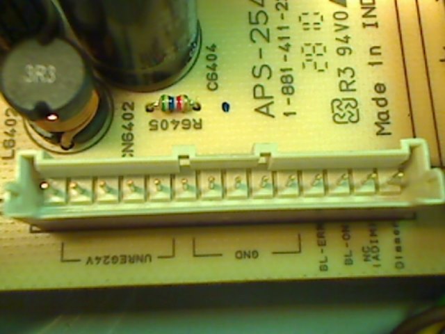

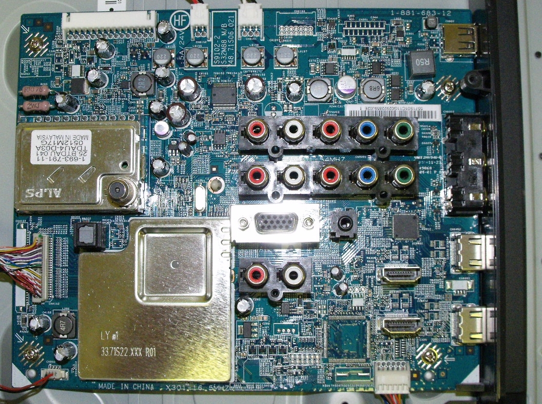

    Let me state first that I have read all the other posts on this forum about this model and problem. Sony Bravia KDL-40EX400 dead with no lights or sound. I ran into this one other time and had good luck with a PS repair kit from shopjimmy.com so I ordered it and installed it and get the same. The kit included:
    Fuses 1 F6101
    Transistors 4 Q6301, 6302, 6303, 6304
    Integrated Circuits 2 IC6101, 6301
    Resistors 3 R6107, 6342, 6348
    Diodes 1 D6308
    No noticeably bad caps were seen.
    So with that all changed I still get only 3v standby so next I put a 100ohm resistor between bl_on and standby and another between standby and PS_on this made the backlight flash on for less than a second then back off. and it would not do it again unless I waited a while like I needed to wait for a cap to discharge then I could get it to do it again. so now I'm not sure if I still have problems in the PS or inverter??

            Re: Sony Bravia KDL-40EX400 Dead totally
            OK, can you take good closed up pictures of the two white connectors with multi-wire on them so we can read the labeling of each pin.
            Take the DC Voltage readings of each pin when TV power switch is NOT activated and when the power switch is activated.
            Please list all the readings of each pin so we can see what are missing on which pin.

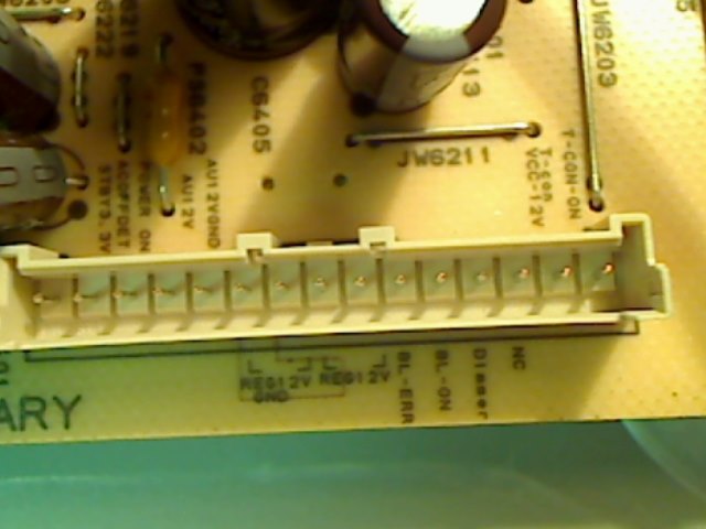

                  3.29v stby
                  2.7v ACOFFDET
                  3.2v Pwr_on
                  3.2v BL_ERR
                  Those are the only ones with power and no difference when pushing the power switch.

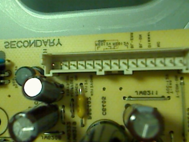

                    Why are your pictures mirrored image? Brighter pictures? I cannot read the labels.
                    "3.29v stby
                    2.7v ACOFFDET
                    3.2v Pwr_on
                    3.2v BL_ERR"
                    There are two connectors so which one are those readings are from?
                      The readings are all off the plug in the first pic.

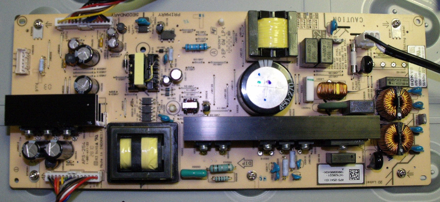

                        https://www.badcaps.net/forum/attach...9&d=1415330345
                        Did you check that yellow fuse next to the connector?
                        Also what DC voltage do you get right at the two legs of the main filter cap in the primary side? It should be around 160VDC then jumps up to >350V when power switch is activated.
                        Does the voltage on the PWR_ON pin go down to <1V when is OFF?
                          Yes fuse is ok and the main cap is at 390 volts for a second when I plug the set in then slowly drops until about 167 volts it makes no difference pushing the switch it just stays at that until unplugged. Same with PWR_ON always stays at that 3volts and switch does nothing.
                            At this point, it is pointing to problem on the main board since that PWR_ON/OFF should toggle, at the same time there is error signal that are generated some where to kill the PWR_ON signal after the resistor R6223.
                            Also there is no any error code showing either. In other thread I saw that they fix it by updating the firmware but in their case there are error codes.
                            Training manual:
                            https://www.badcaps.net/forum/showpo...36&postcount=2
                            Also try disconnecting the cable to the T-CON board.
                              I'm thinking I would have taken the main board out of the equation since I disconnected it when I went to try to get the backlight to turn on.
                                So those readings are not when all the boards are connected?
                                Hook all the board back up but try leaving the T-CON out.
                                • CraigR
                                  • Dec 2013
                                  • 959
                                  Those reading are with everything connected.
                                    So did you try without the T-CON connected?
                                    • CraigR
                                      • Dec 2013
                                      • 959
                                      Yes, like in my first post the main was disconnected so that would mean the TCON was also disconnected.
                                        But the T-CON board is the board by itself which is connected to the Main board, we need to have main board connected to the power suppl board but the white connector on the bottom left where the T-CON is attached to is to be removed.
                                        https://www.badcaps.net/forum/attach...5&d=1414697633
