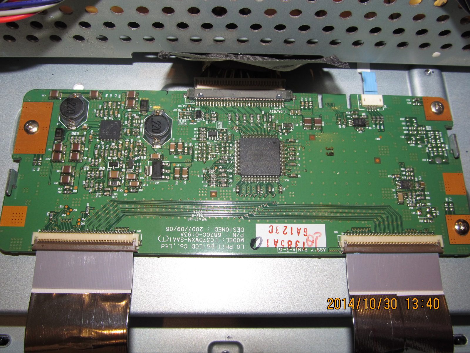

                  #68
                  Re: Vizio VO37L power problem
                  Is this picture good enough for your purpose? I tried several settings and this was best of the lot. Also, what points on the board should I be probing for voltage? In a previous post we tested the only fuse I could find (F1) and it showed 12v.

                    #69
                    Here are some voltage readings from around the board. Label on the left is what was on the board, voltage reading on the right.

                      #70
                      I believe VGL should be in the -10V range, I will have to let TOM66 gives you the info on that.

                                #75
                                from a post from tom
                                T-con points AVDD, VGH, VGL, etc. (AVDD=14~18V, VGH=20~30V, VGL=-5~-10V)

                                  #76
                                  vinceroger69....thanks for your input on my problem. It appears the voltages I have (listed below) are OK based on your input above.

                                  One thing I'm still a bit confused about is the result of my diagnosis in Post 61. Given I get a dim blue/grey screen whether of not I have the LVDS cable connected or not, makes wonder about the T-con board. Any thoughts on that? Thanks.

                                        #79
                                        Ugh!! I ordered a replacement T-con board and installed it, in hopes that was the problem. Unfortunately, I get the same results. So now I have replaced all 4 boards (PS, Main, T-Con, and Inverter) with supposedly good working boards, and still get no video.
