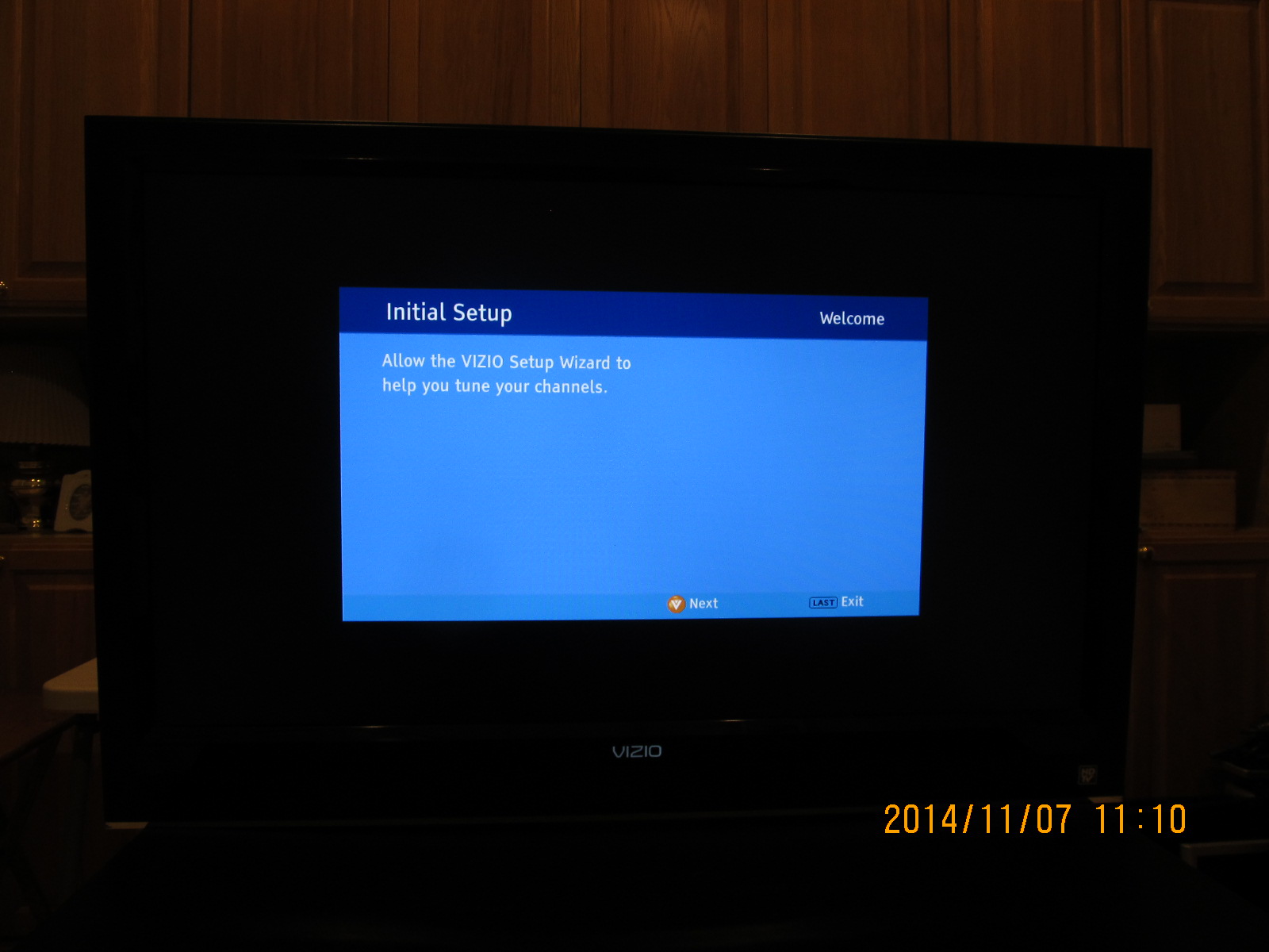

                      Grooooan!!!! I guess I declared victory too soon. Yesterday afternoon after installing the new Main Board, I didn't have time to check it out thoroughly, just saw the setup screen and assumed all was working, the left for the evening. This morning, I turned on the set and got the Setup screen, but can not get anything else. The only button on the right side of the set that does anything is the power button, it does turn the set on and off. Picture attached. I do not have a remote control, but would expect to be able to do whatever is needed from the buttons. Am I missing something?

                        #91
                        Re: Vizio VO37L power problem
                        Oops! I forgot to attach the picture of the Setup screen that I'm getting.
                          Guess I'm getting Vizio crazy, working on this thing. I found a way to get past the Initial Setup screen by pressing the power button, then pressing and holding the Menu button until a blank blue screen appeared stating No Signal. That allowed me to skip the Setup screen and access the Menu. From there, I completed the setup and channel scan, and now all appears to be working A-OK. When I power it on, it goes to the last used Input device as it should. So, I'm closing this thread, and again appreciate the help from everyone.

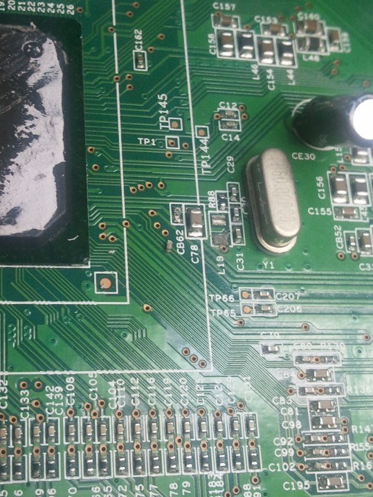

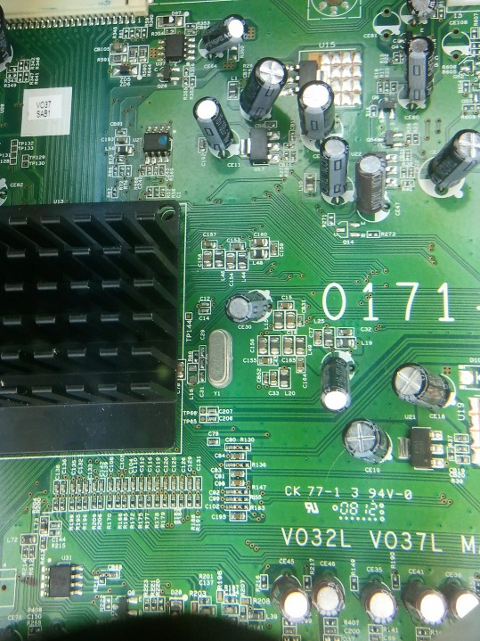

                              Hi. I don't know if I should start a new thread, but since the symptoms are similar I though it was OK to post here. I'm not a tv technician. I'm a diy'er with some experience repairing desktop and laptop computers for friends an family, so when a friend was going to get rid of a Vizio VO37LHDTV10A I decided it was a good opportunity to learn more about electronics. Before doing anything else, I did a visual inspection and found the capacitors in the inverter board blown. So I replaced the board. The tv shows the same symptoms that led me to this thread; no picture or sound, and the logo lights amber, but nothing else. I checked and found 5v present in connector J1 of the main board. Voltage is present in some ICs, but not in others. So following the path in the thread I start to inspect the inductors and found evidence that one was also blown. The board number is 3637-0242-0150(3B) and the inductor is the L18 at the right (positioning the tuner at the lower right) of the big heat sink. I found some service manuals, but the ones for this model don't have the part list. I just need some help identifying this component to see if I'm lucky and get this tv fixed. Thank you.

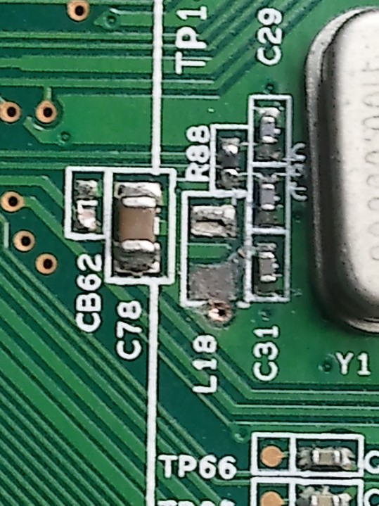

                                I decided to carefully remove the heat sink, to see if there are any more components below it, and found a CB62 also blown...
                                  How did the inductor L18 fail? Was it burnt up? That typically indicates that something has gone shorted. I can't see from the photos, but does L18 supply power to CB62? It could be that CB62 went shorted and caused L18 to burn.
                                    L18 and CB62 do not seem to be connected directly. The top of L18 is connected to R88 and the piece of the board where the lower end of L18 is supposed to be connected is damaged, but it seems to connect to C31 at the right. I think C31 is open. It shows infinity even at the highest setting of the multimeter. It is possible the damage was caused by the caps that where blown on the inverter?
                                      Small value capacitors will read open-circuit, that is normal.
                                      The damaged pad for L18 also goes to a VIA, check resistance from that VIA to each pad of C78 and CB62?
