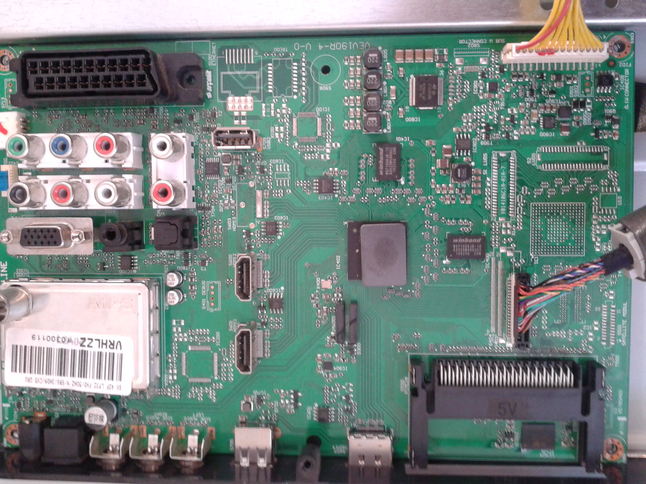

                      the main board is VEV190R-4 v-0.. seems to be LG manufactured though it comes up in searches as Beko, Grundig or Lg like all the boards on this one ..

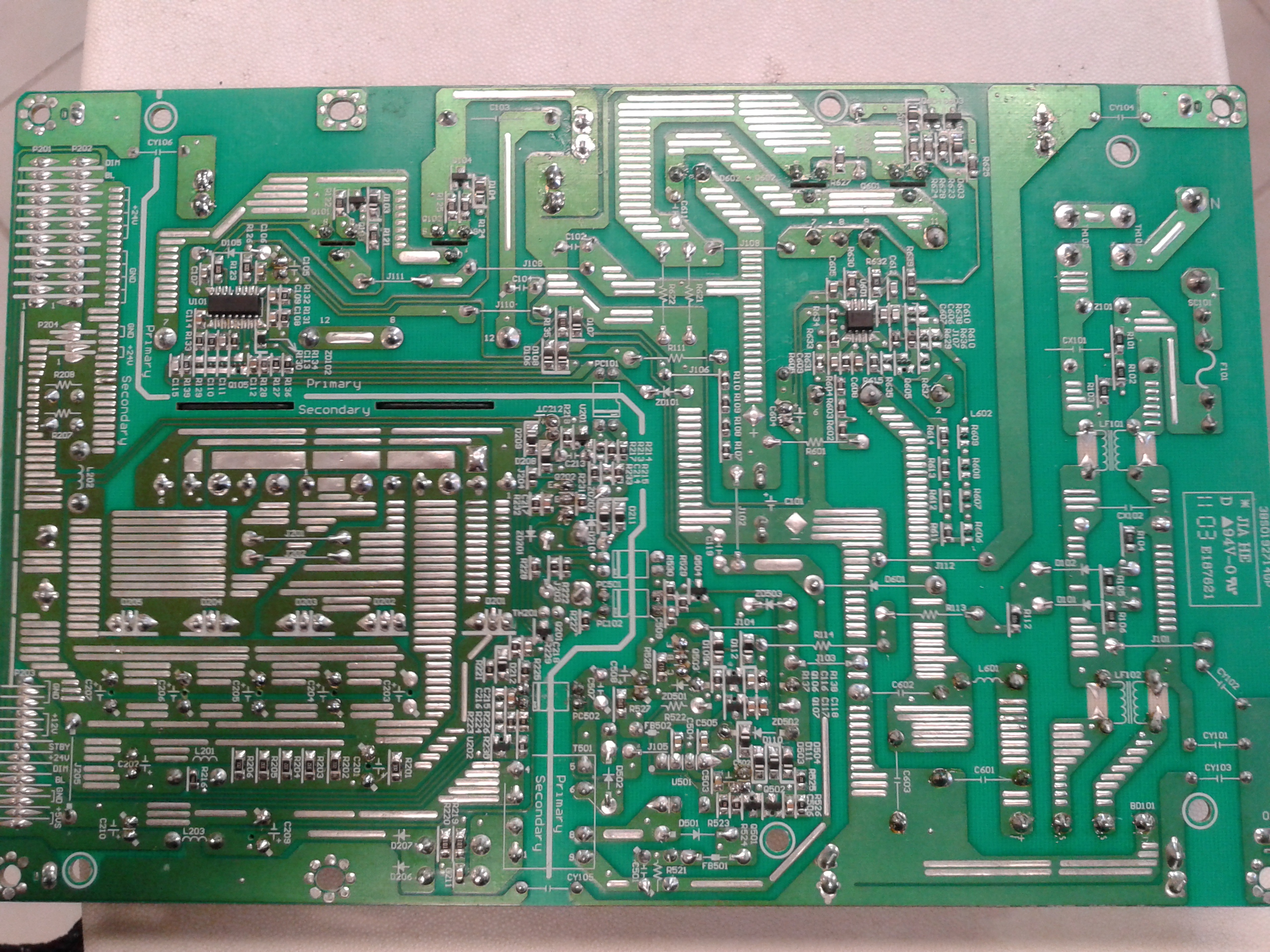

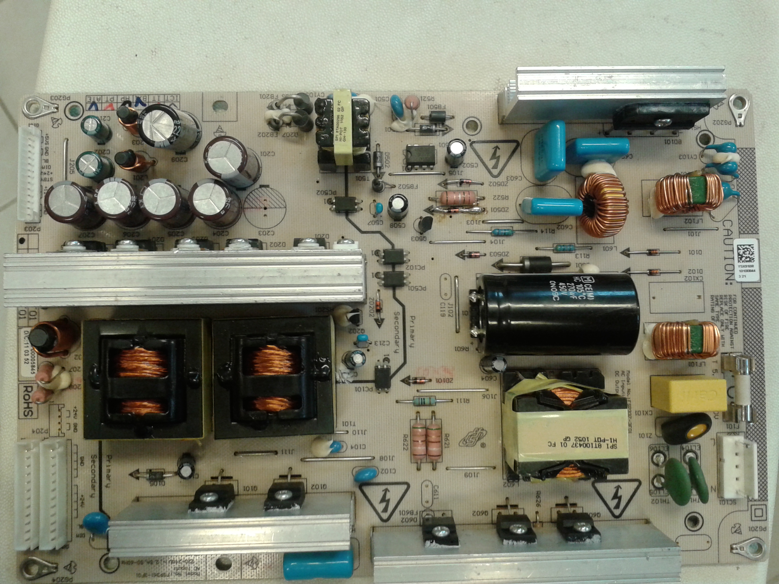

                          • ERICSSON89
                            • Oct 2014
                            • 46
                            • NIGERIA
                            Re: grundig vlc4120 c .. does not turn on ..
                            please can u upload pictures of the psu board, main board and TCON board? both front and back please

                              • Hjolli.hardar
                                • Oct 2014
                                • 12
                                • Iceland
                                pics
