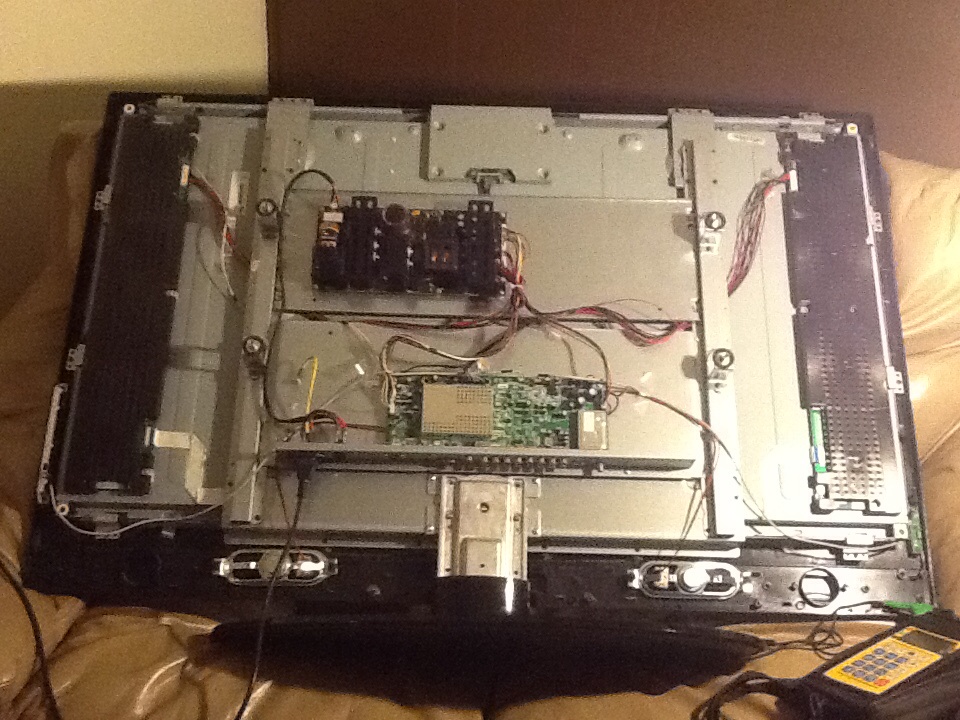

    Hey I have a fluid 46" lcd tv about 4 years old model number 1602103, tv worked one night went to turn it on and nothing. So when I first plug it in the wall i hear a click and the small indicator light turns on blue bottom corner of tv, (this light is usually red when powers off) now indicator light is always solid blue. So I hear no sound or lights on my tv, screen is black no glowing, I opened up the back of it, couldn't see any blown or leaking caps, I ordered a new power supply board pArt#mlt199tl, didn't fix any thing same thing, so when I do a voltage test I get the right voltage for all the pins except 1 pin- +5vsb, when I test that pin on the power supply board I get 2.4 volts, all the rest of the pins give me the correct volts, so what could be going on here , any one got any ideas, I bought a multimeter in case I need to do testing, I bought the power supply board form shop Jimmy's on ebay , could it be a bad board

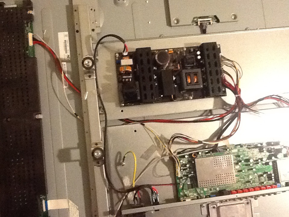

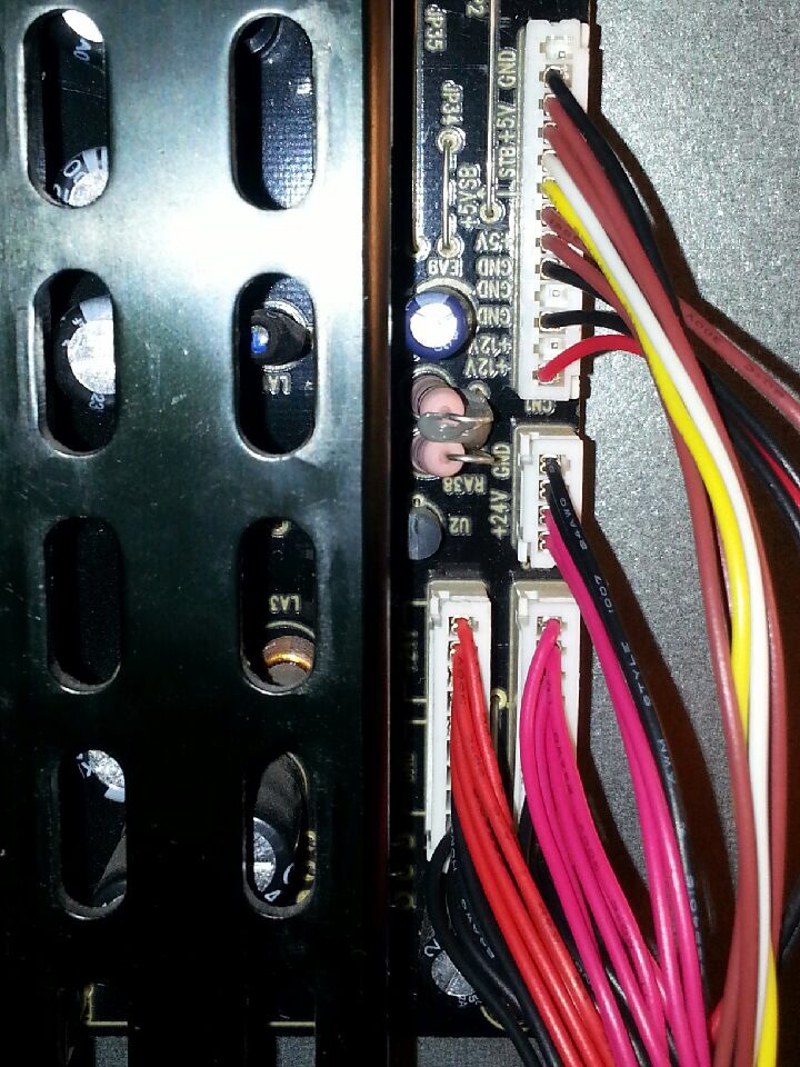

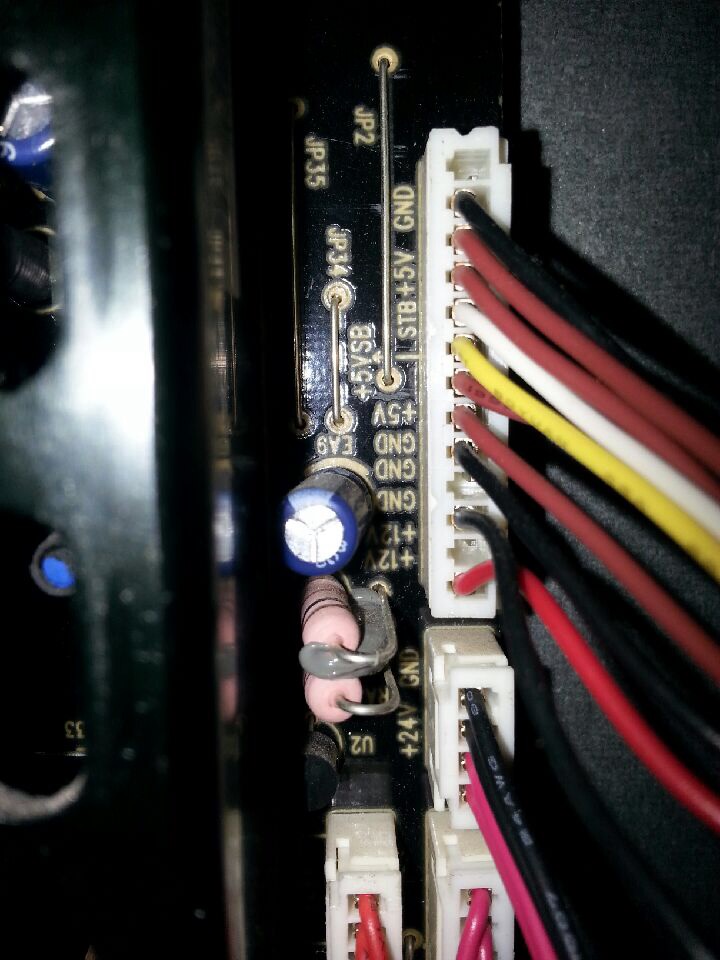

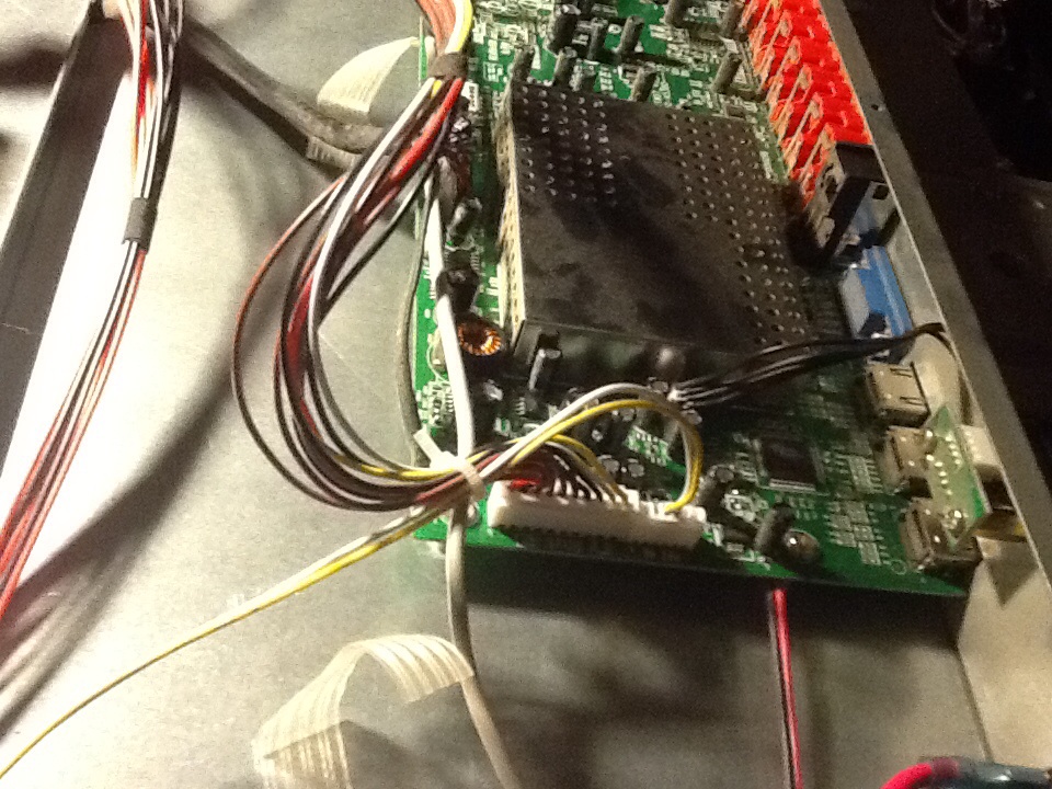

        Here's a couple pics of what I'm dealing with, the white wire is only reading 2.4volts, the yellow wire beside below it is 5 volts

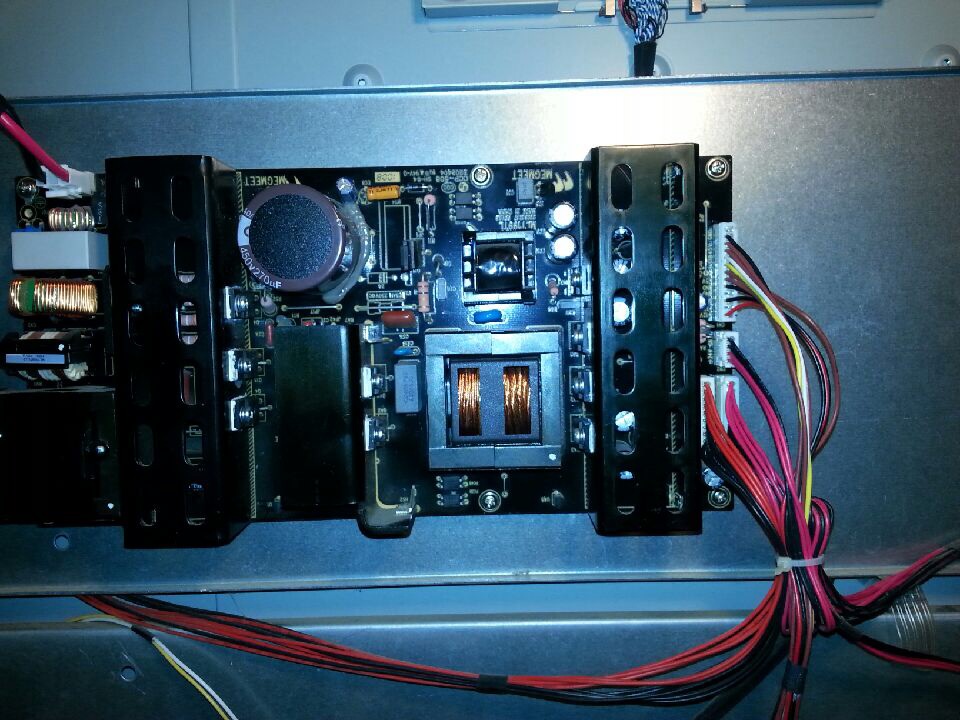

          Power supply

            White and yellow wire run to this board, then they run up to the boards on the side of tv, yes I'm sorry Im not sure on the names of parts

              Pic of the entire back of tv

                      Re: Fluid tv model#1602103
                      EDIT: Sorry, I completely misinterpreted your post and the photo! I thought the 5v Standby rail was only at 2.4v
                      But now I read again and realised the 5v Standby rail is on Yellow wire, this is at 5v, that's OK.
                      White wire - I am not sure what that should be. 2.4v does seem wrong, though. I suspect it should be either 0v or 5v.
                      -David VanHorn

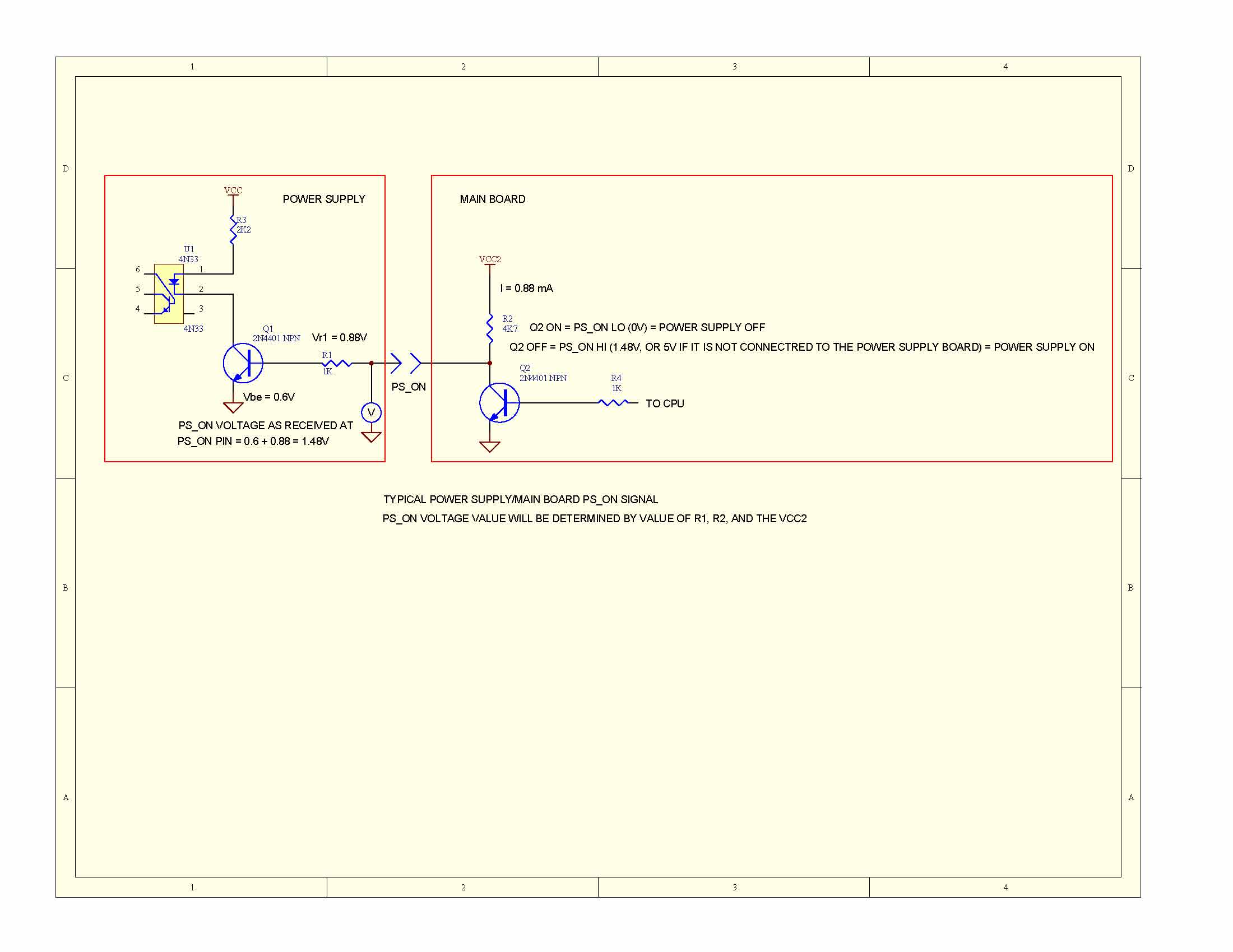

                        The White wire is STBY (PS_ON) signal pin from the main board feeding this power supply to turn on the PFC Voltage booster, 12V, and the 24V.
                        2.4V is OK, it is high enough. BTW: +5VSB is the standby 5V, other Voltages are swithced.
                        And please post brighter pictures of both top and bottom side of the power supply board, pictures in post 5 is dark. I am trying to read the model number on the power supply board. It looks like MEGMEET MLT??????
                        So what you need to do is to report all the Voltage as marked by all 3 connectors when the TV is OFF and when the TV is ON.
                          I was going to ask what the minimum was, as I am used to ATX PSUs getting around 5v on PS_ON pin from motherboard, then I looked up ATX spec sheet and it says they use TTL logic levels for that line, so anything above 2 volts is good. I assume it's the same for these TV PSUs then?
                          -David VanHorn
                            Roughly, yes. There's no standard but typically they drive the base of an NPN transistor which turns on an optocoupler. More than about 1V is usually enough to turn them on.
                              This may help explaining how it works.

                                Ok power supply model# is megmeet mlt199tl, I've already replaced the power supply. I'm going to check all voltages when tv is on/off and I'll report back,
