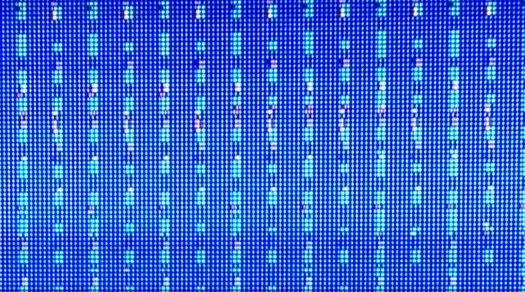

    50" Plama vertical lines - repairable??
    I've been using my Maxent 50" monitor/TV (no tuner) as my computer monitor for about 3 years using an HDMI input.
    It's about about 7 years old.
    Never had any issues - until yesterday.

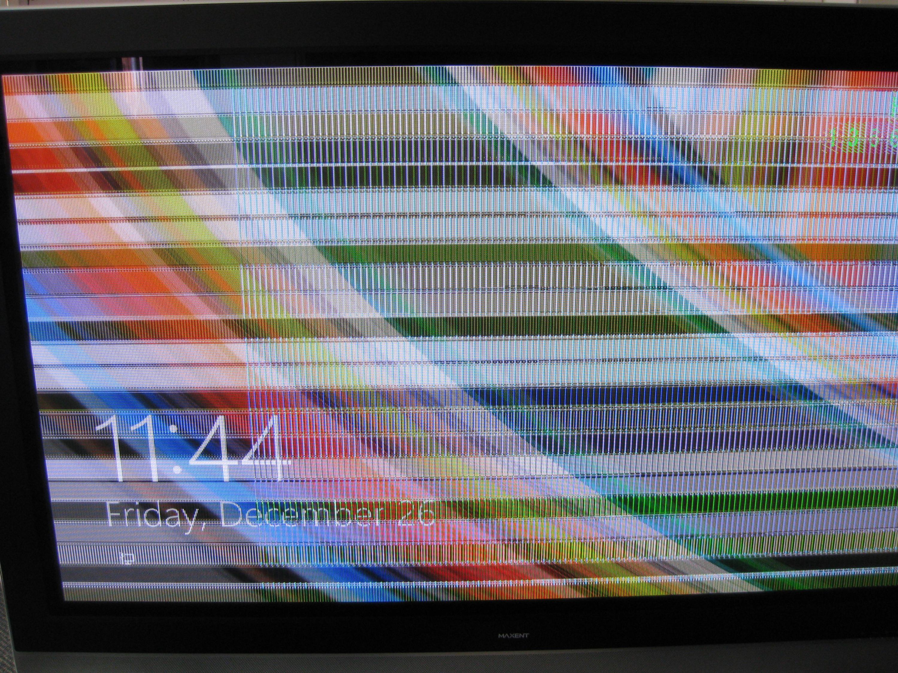

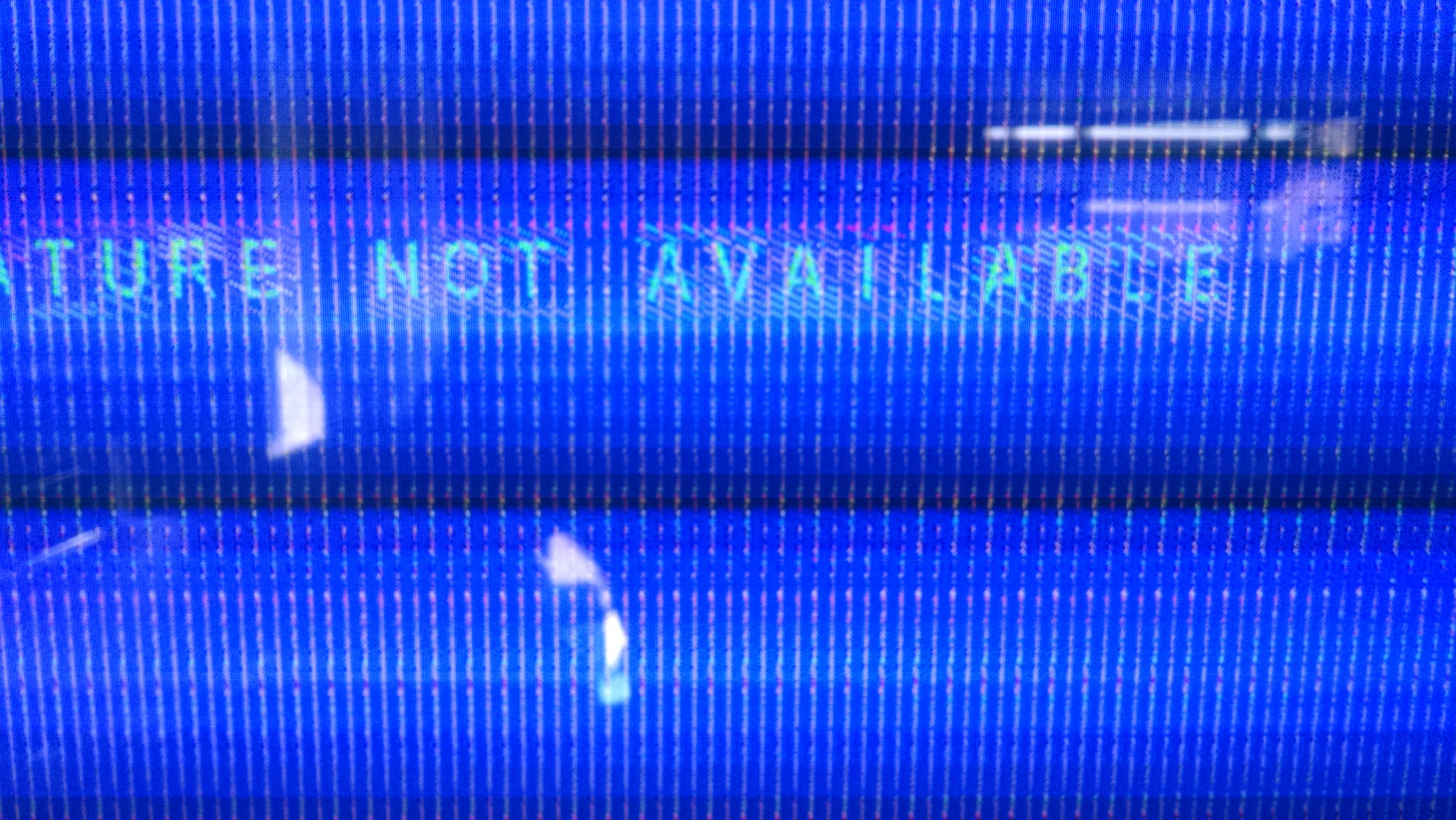

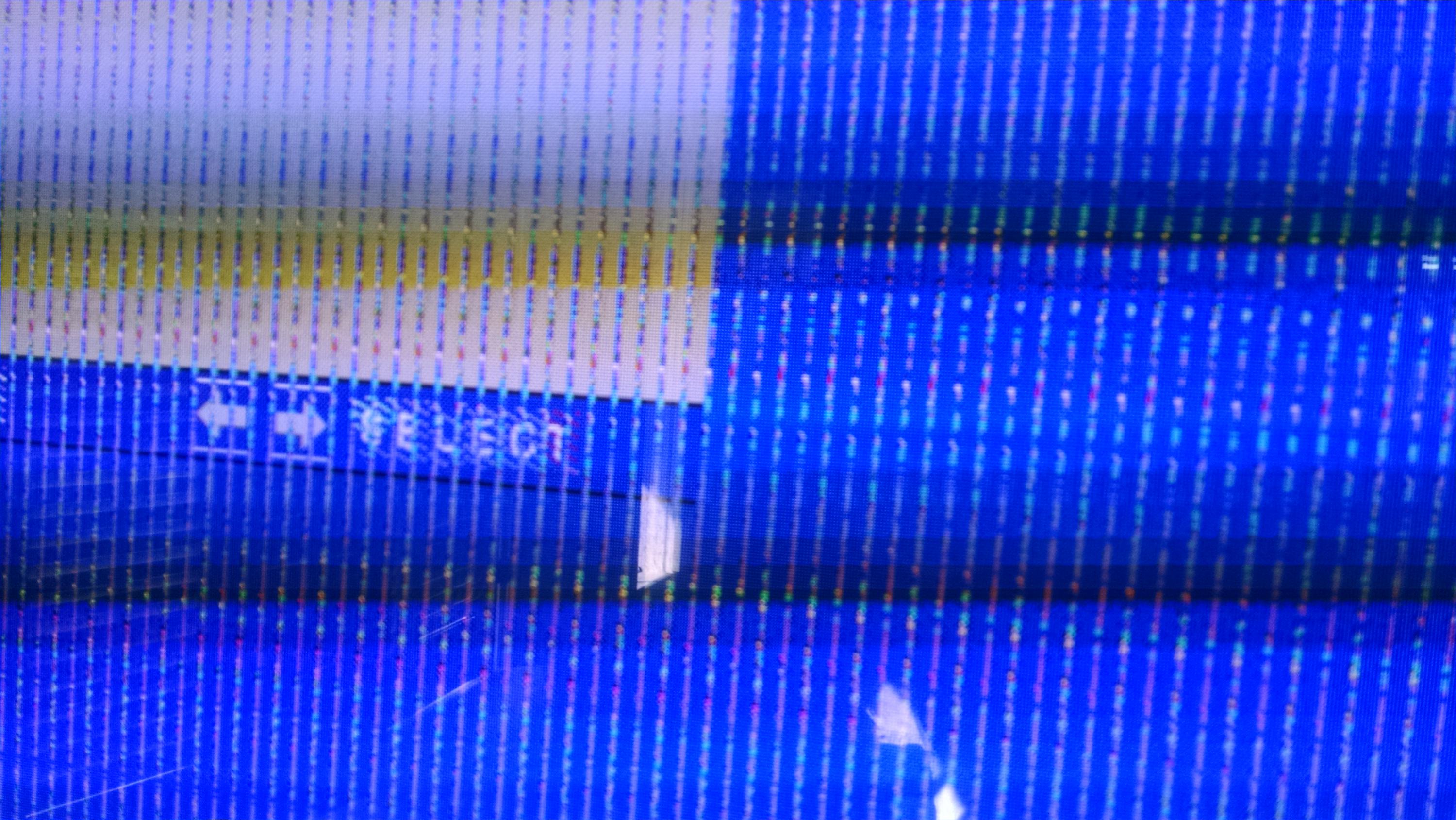

    I had it on for about 30 minutes (working fine), and it suddenly displayed with multicolored vertical lines across the entire screen, top to bottom.
    I heard no noise when it occurred.
    Same problem exists on all inputs and menu function display.
    The lines are stationary but seem to vary depending on what image is being displayed.
    They are sometimes 2 or 3 or up to 5? pixels wide.
    There appears to be other colored artifacts around certain displays.
    There are no other types of lines.
    The TV has some kind of input selection thing that when no signal is detected it displays solid blue. This still shows up with a solid blue without those lines.
    So I'm thinking it's not the panel???
    Has anyone had experience with this specific issue?
    I'll try and attached a couple of pictures.
    (The horizontal black bars are from the camera phone synch, not visible in real life)
    I've never dealt with TV repair - only tube amplifiers - but now I'm very interested in learning about this stuff
    Any help is appreciated.

    Not panel, looks like digital board. Who made the panel in the TV? Pictures of boards and chassis would help.

        Here is a close up of the lines...

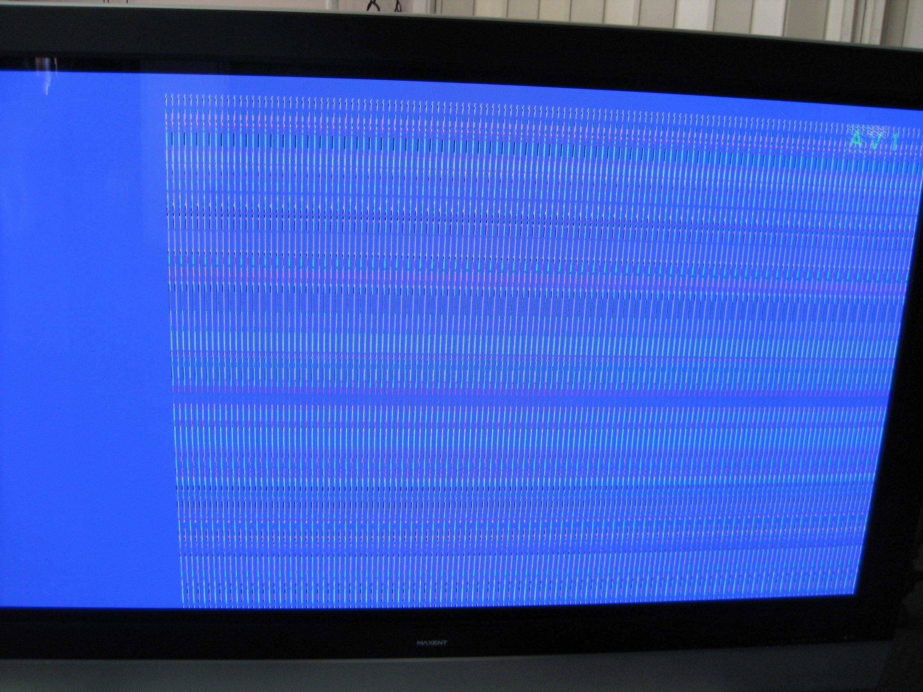

                    Re: 50" Plama vertical lines - repairable??

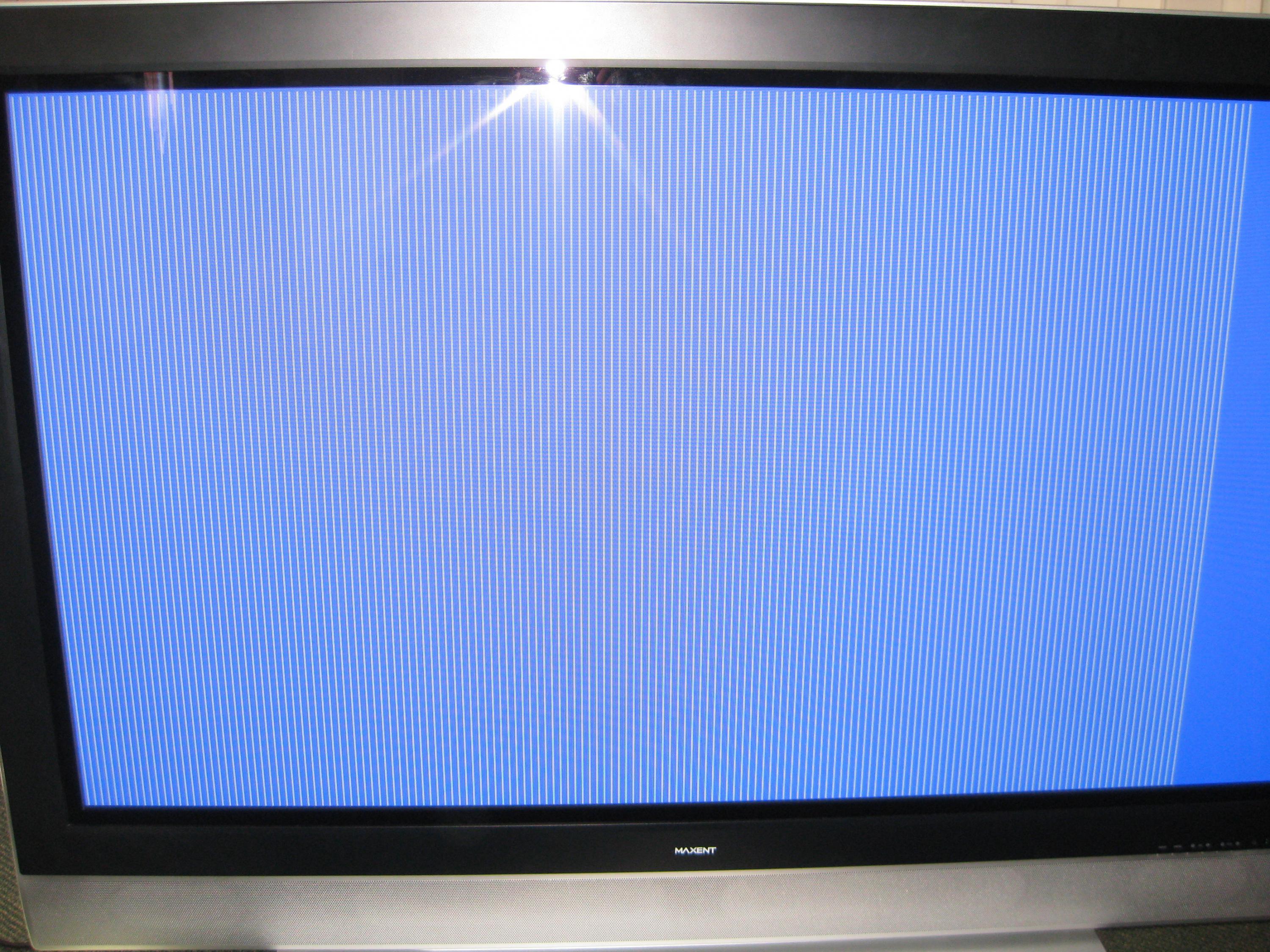

                    There is a definite pattern in one section of the screen that does not extend all the way to the left
                    • Stevie B
                      • Oct 2014
                      • 32
                      But that pattern temporarily shows up on the right side at start up too...
                      • Stevie B
                        • Oct 2014
                        • 32
                        With an input, the picture has the "noise" across the screen but also has that additional peculiar pattern on the right - and stays there on the right.
                        (I just realized I have my left and right backwards n the previous posts)

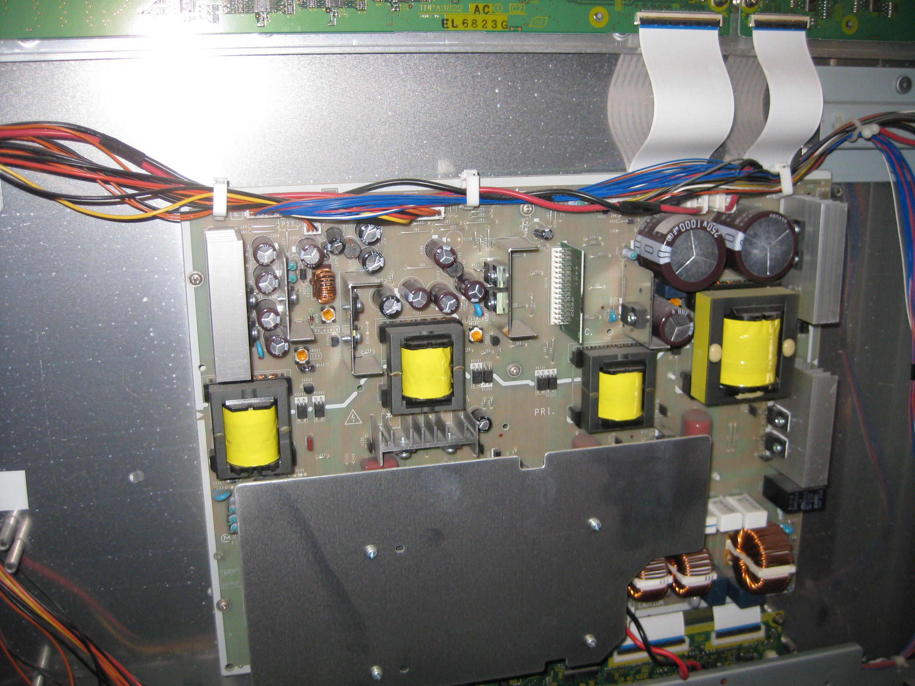

                          Power supply looks fine...

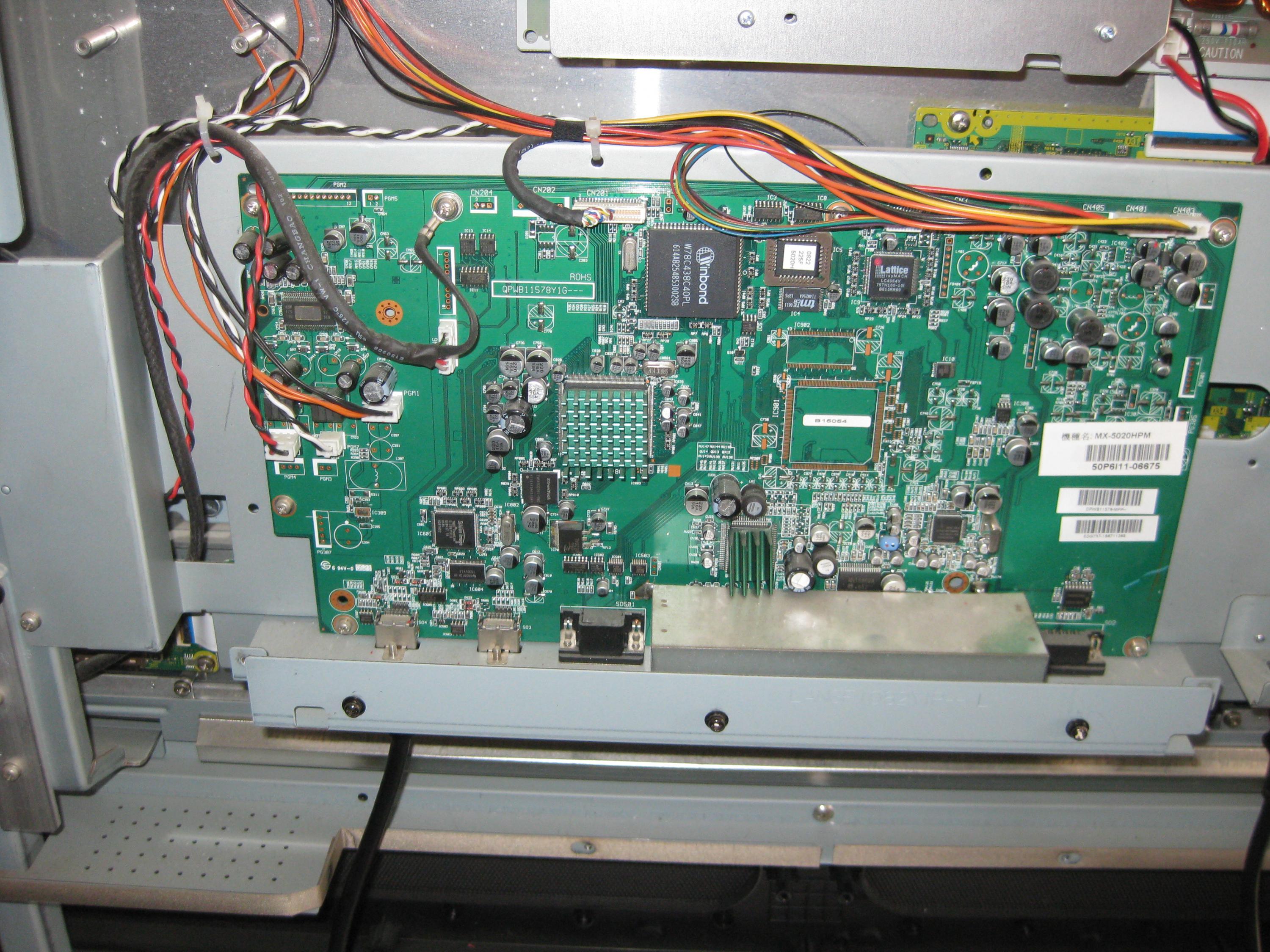

                            Main board looks fine...

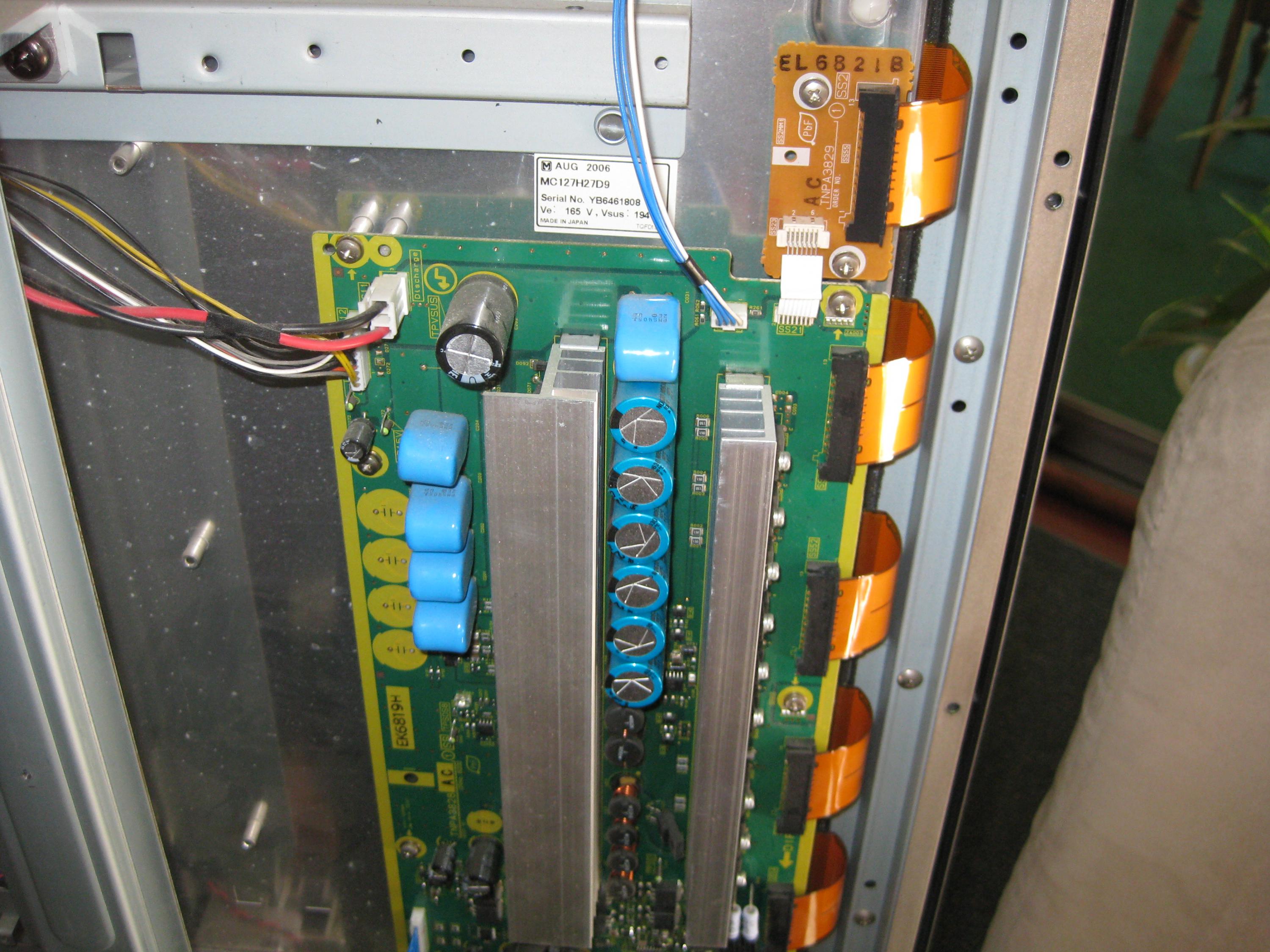

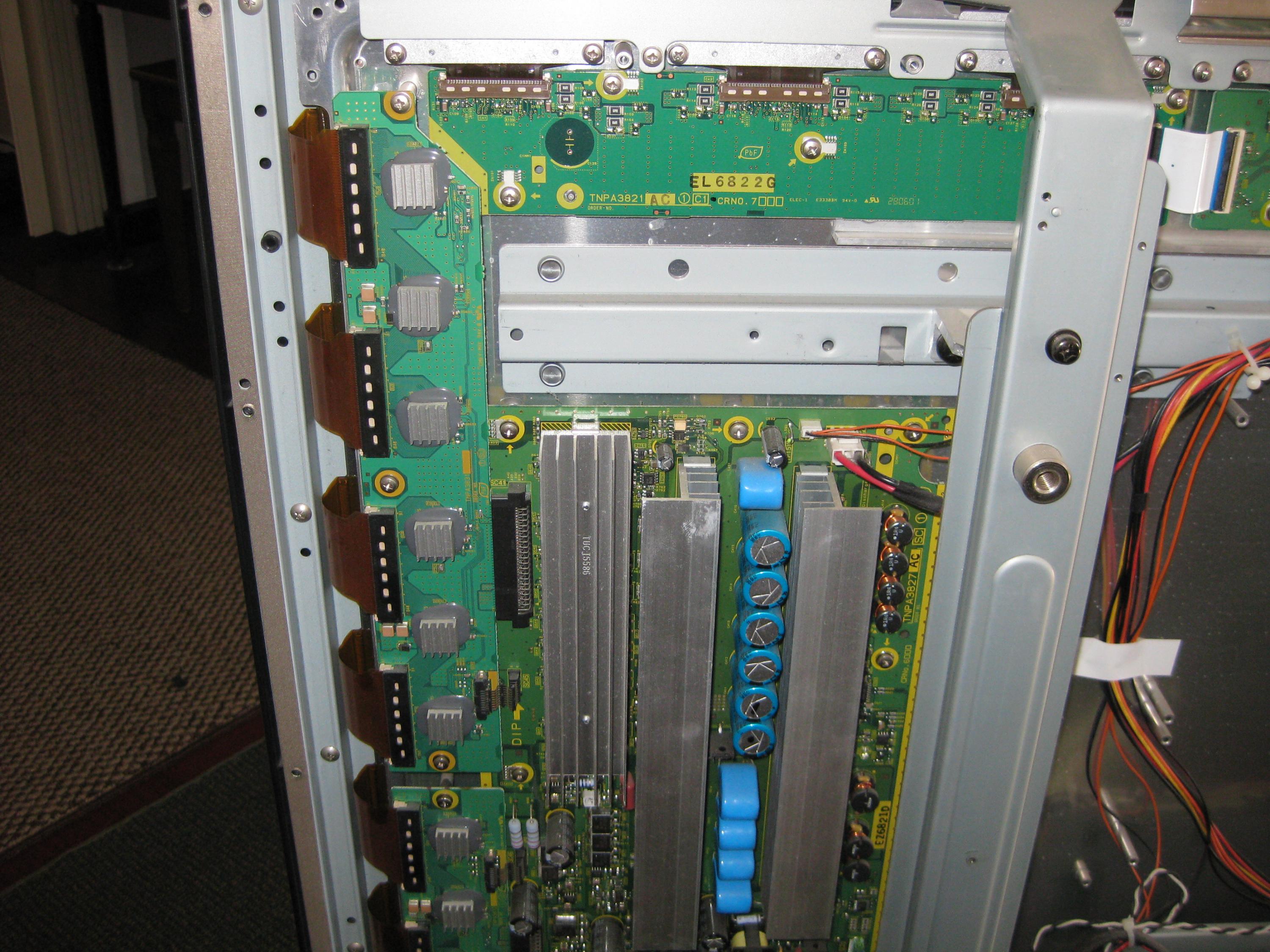

                              Left and right sus boards look fine
                              • Stevie B
                                • Oct 2014
                                • 32

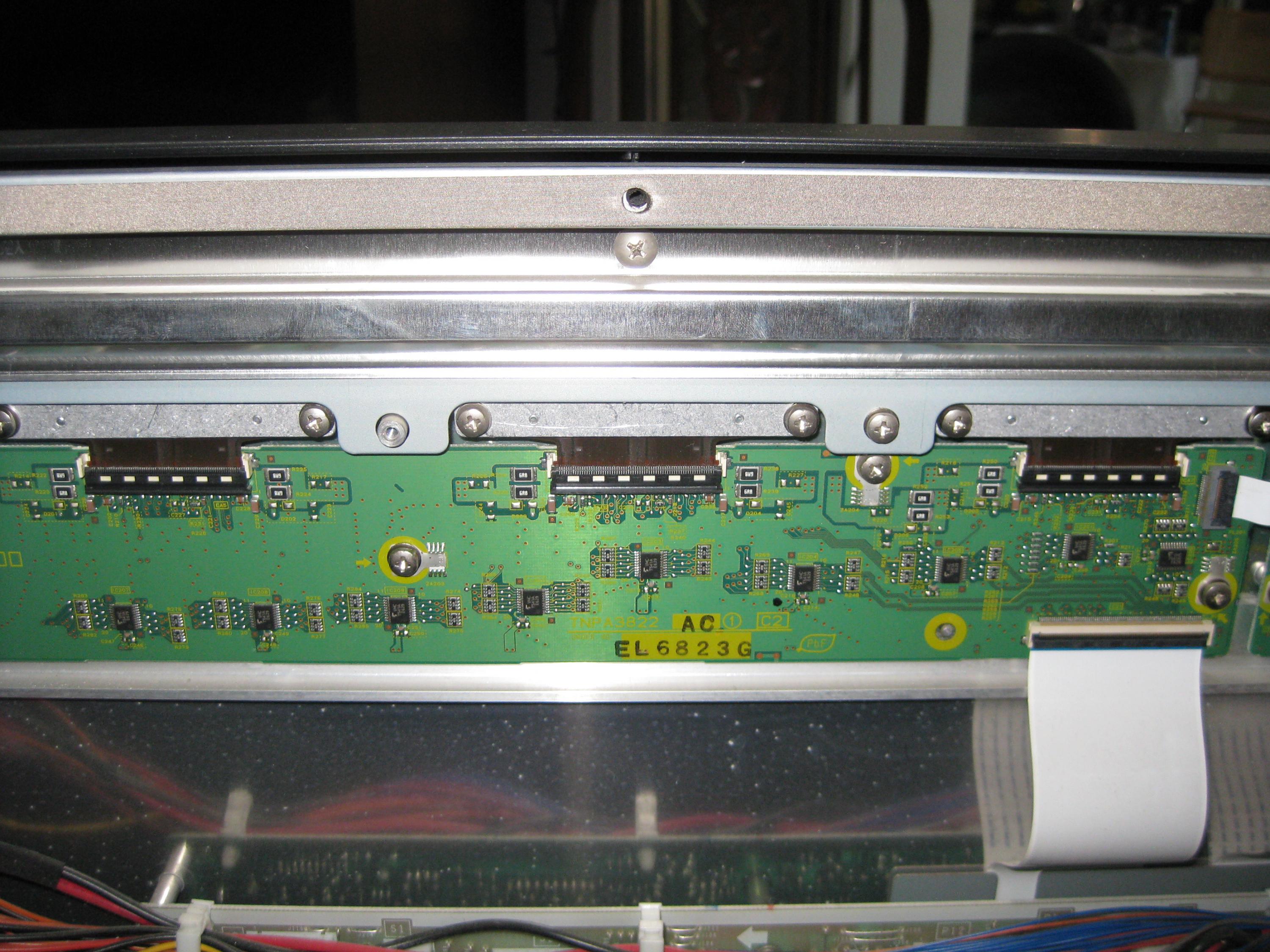

                                Top and bottom look good

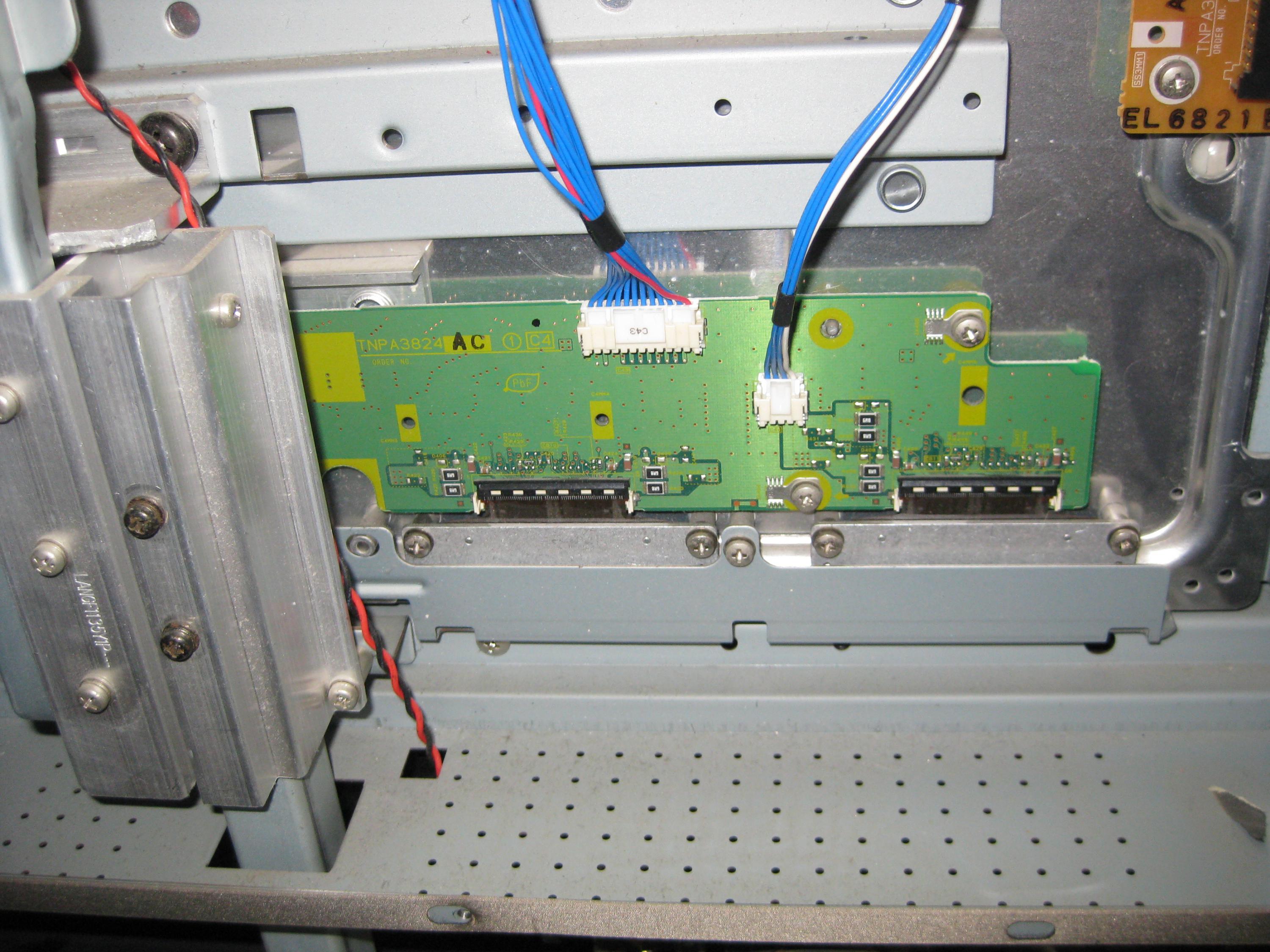

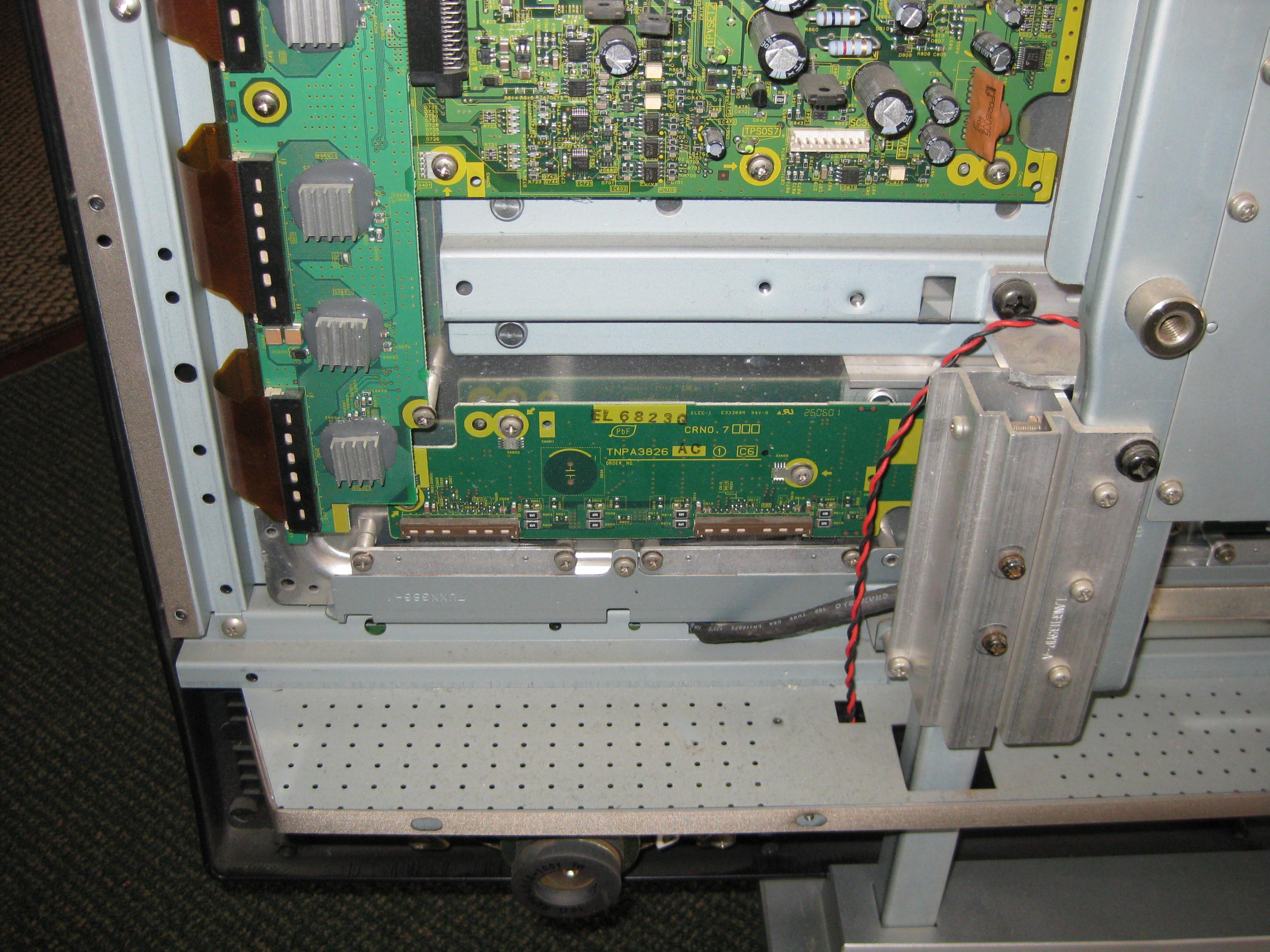

                                  bottom left

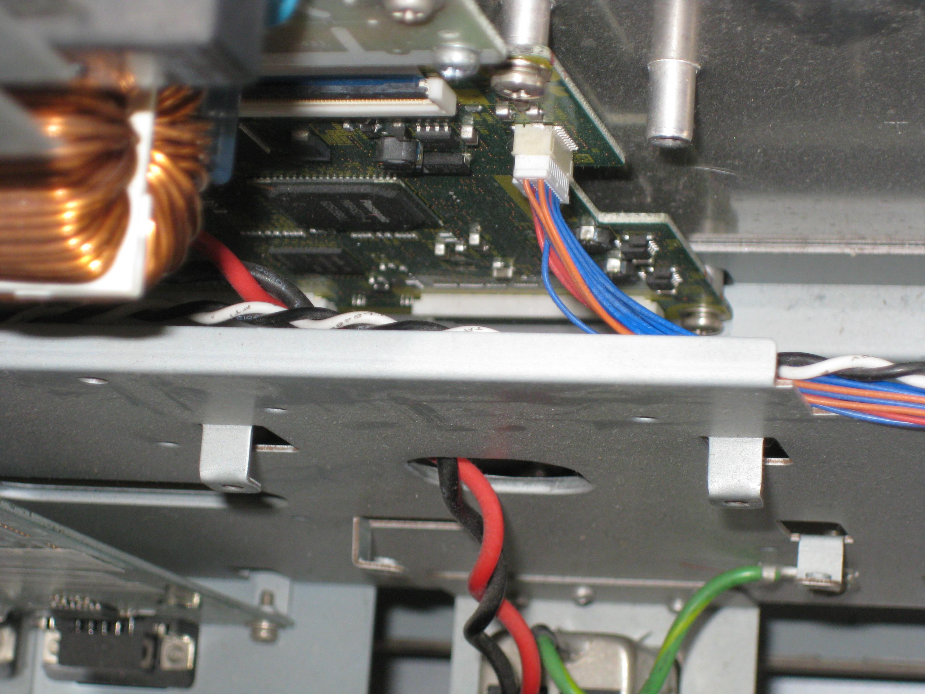

                                    There's a small board behind the main board that I didn't get to see without disassembly
                                      I'm looking for someone who can suggest which boards to replace - or let me know that it may be cheaper to buy a new 50".
                                      • mmartell
                                        • Oct 2013
                                        • 3189
                                        The last board you uncovered is the digital board and the one tom66 is referring to. I would heed his advice and replace it. I had a similar "interference" problem in a Pioneer plasma which he suggested I replace and it was the problem.
                                        Who makes this tv ? You need to get the part number from the control board.
