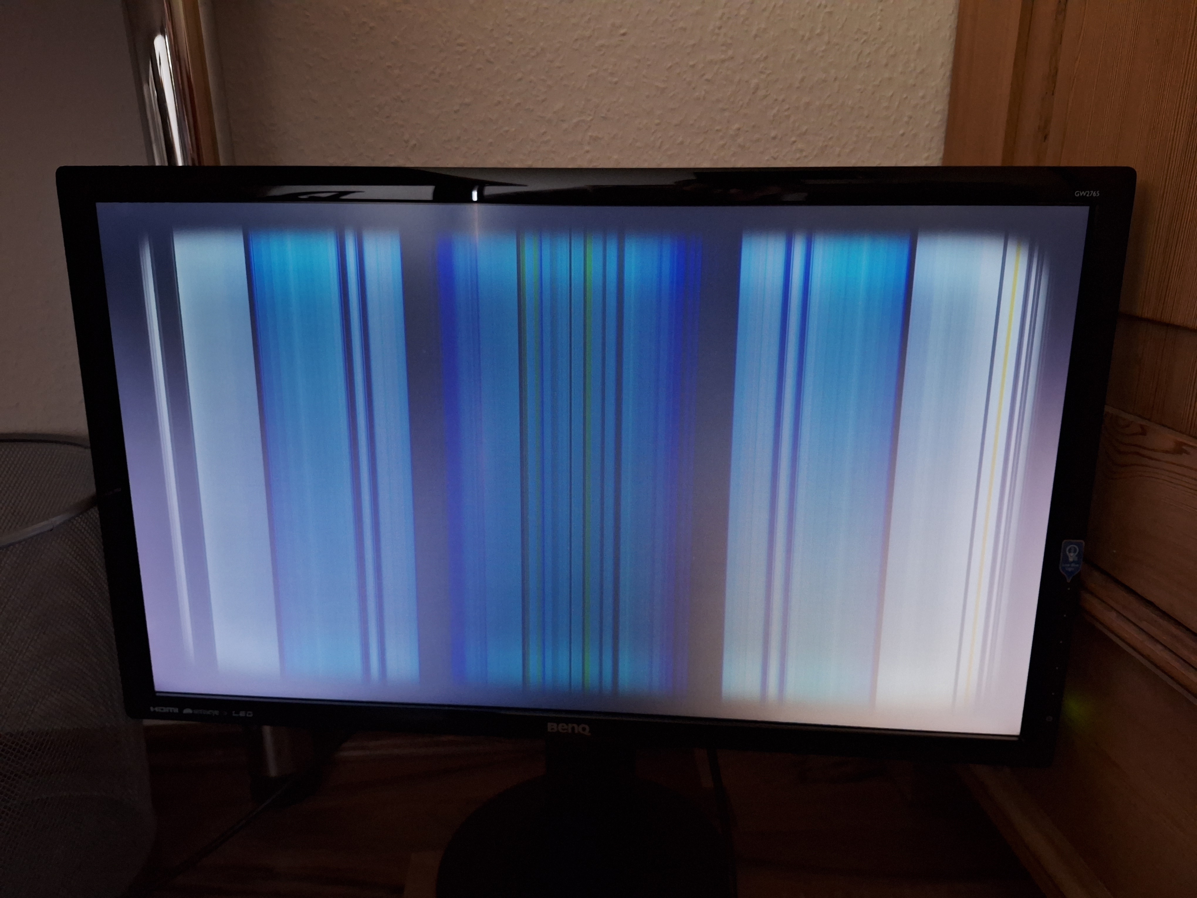

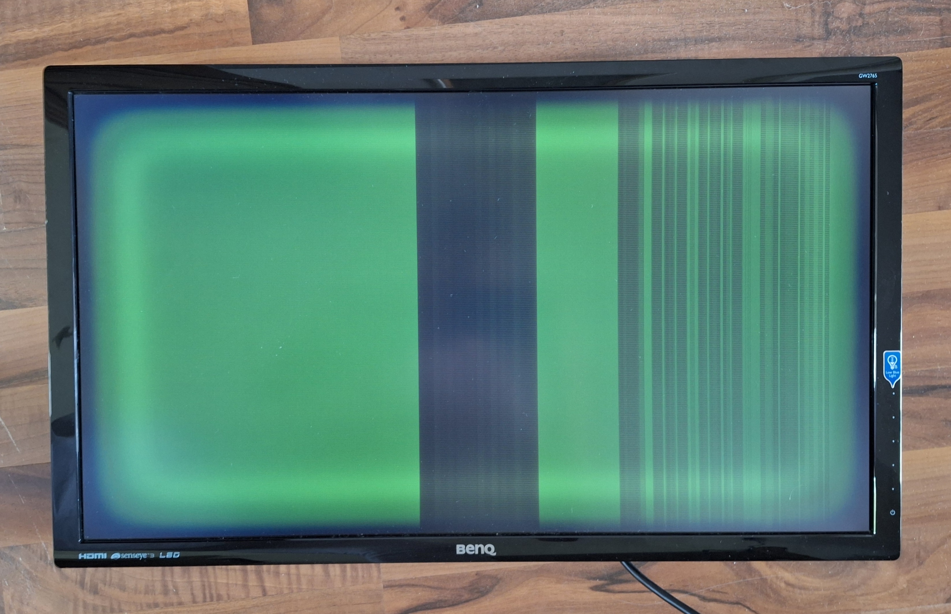

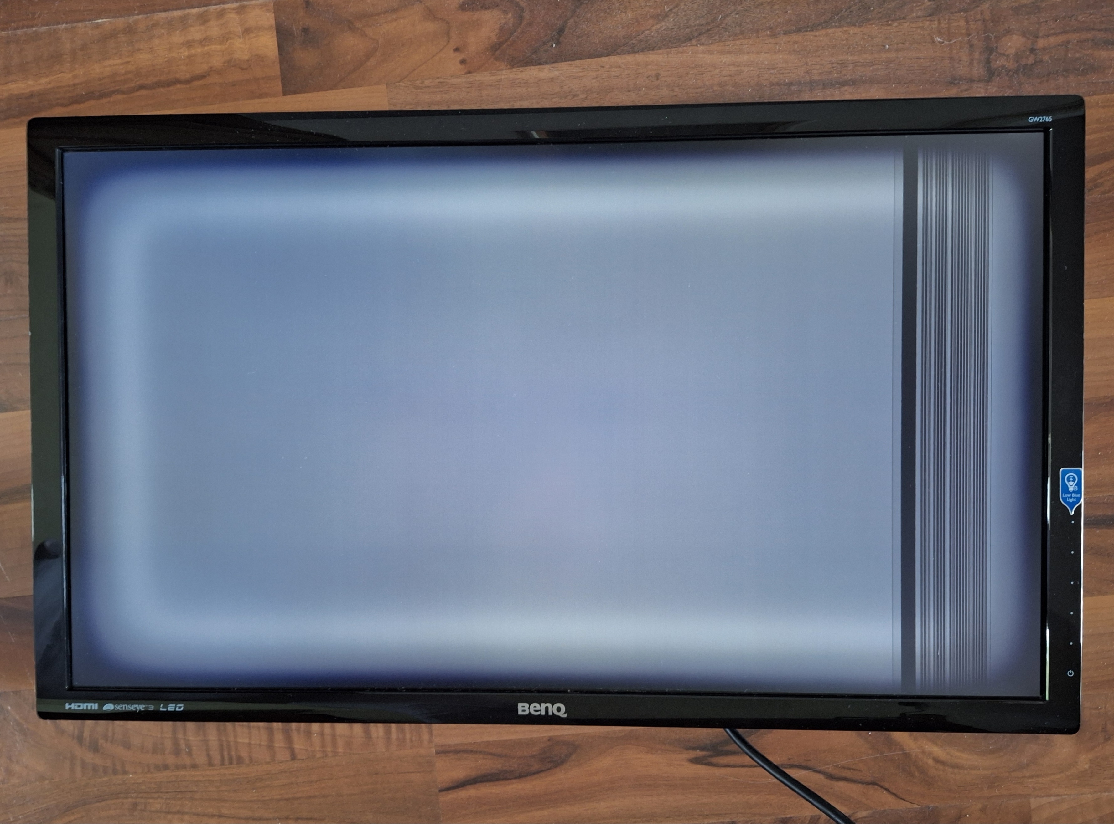

    I was trying to fix the monitor, which was giving me the following pictures:
    Click image for larger version  Name:	20250906_151913.jpg Views:	0 Size:	1.67 MB ID:	3721619 Click image for larger version  Name:	20250909_103800 1.jpg Views:	0 Size:	2.64 MB ID:	3721620
    It was somehow reactive, such that if I pressed the buttons, the lines changed in positions or if i moved e.g. a task window, it would somehow change the patter, too.

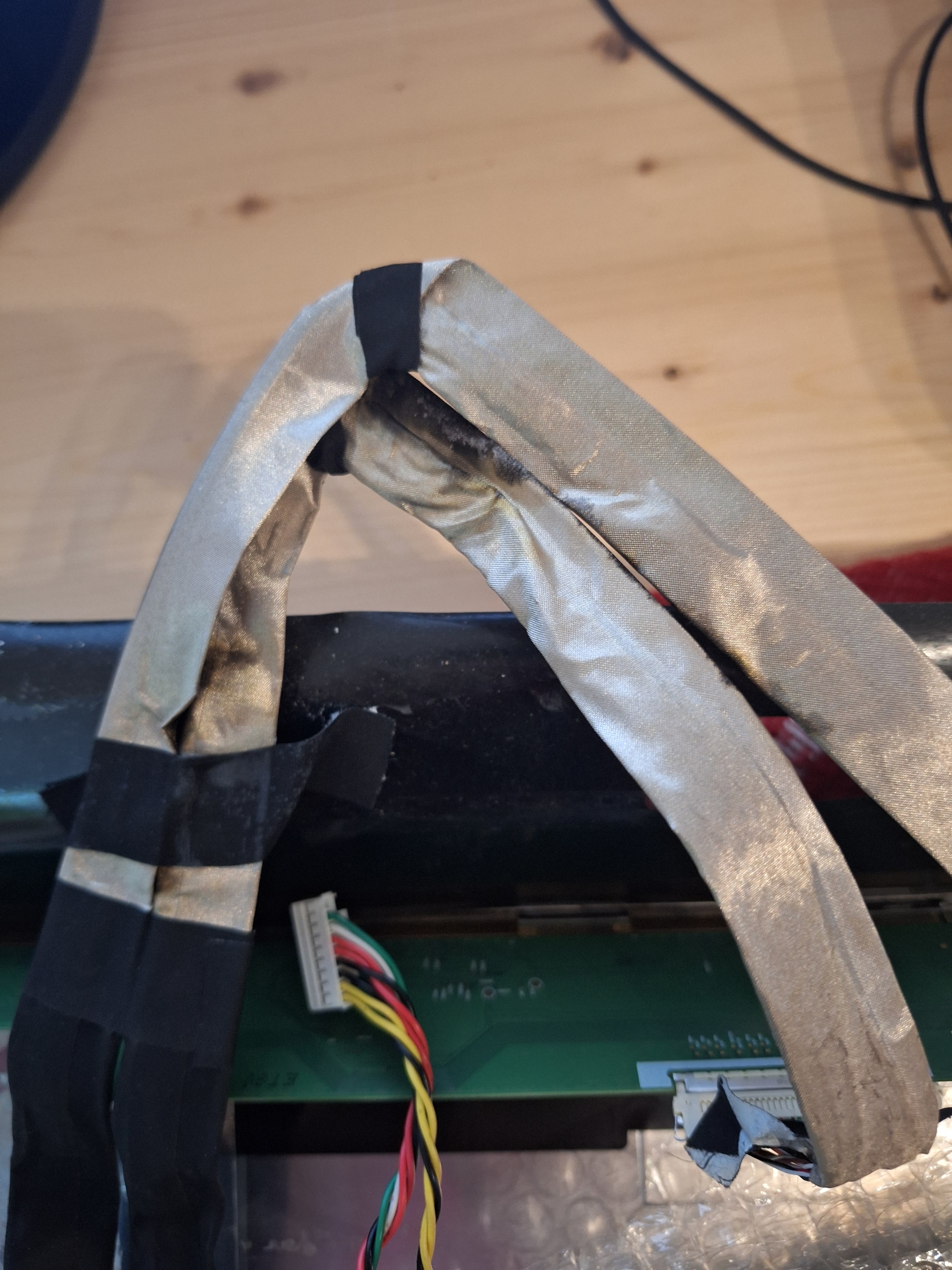

    I swapped out the mainboard without any luck. So I thought that it has to be an issue with the panel itself and was trying to assess whats wrong on the control board of the panel.

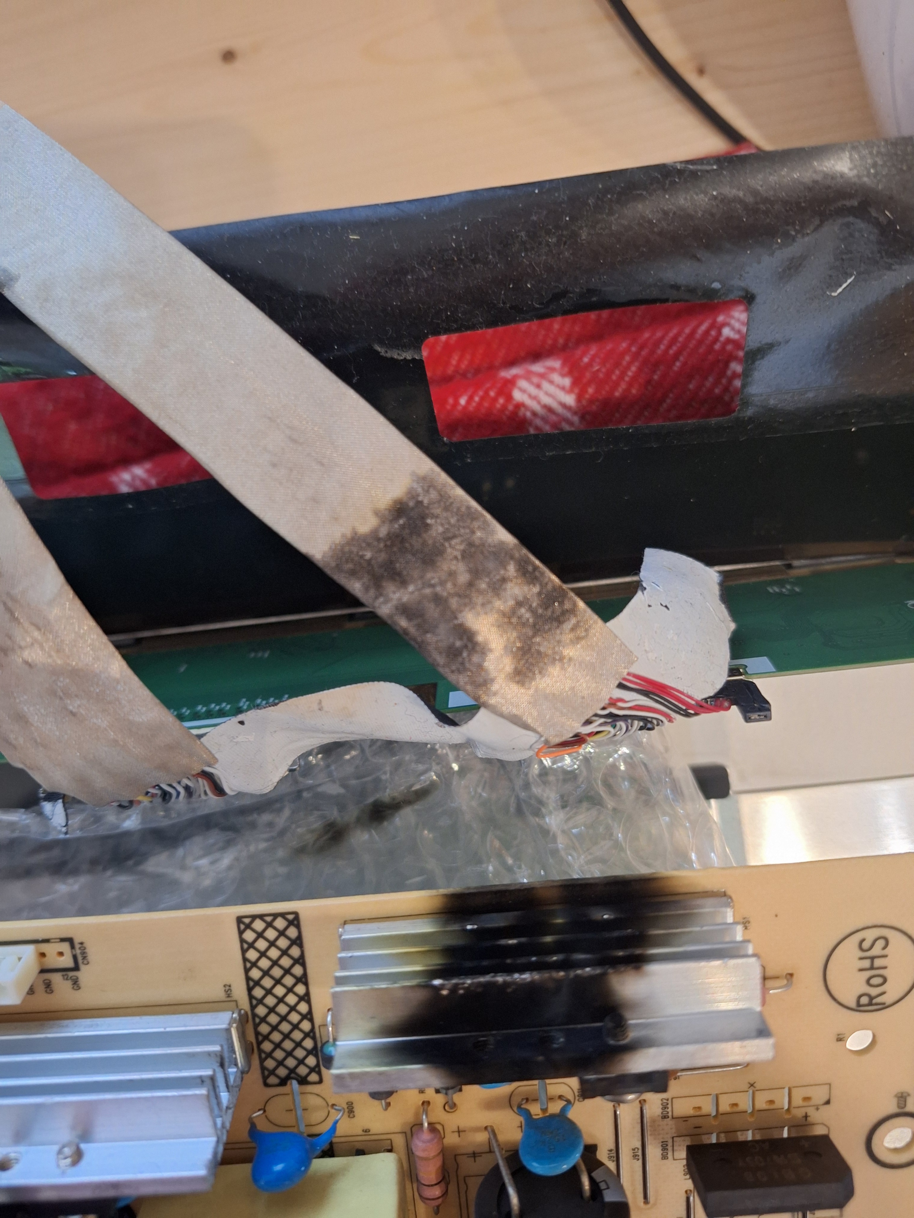

    Somehow, I managed to short the LVDS protection with a MOSFETS cooler on the PCB.
    Click image for larger version  Name:	20250909_155813.jpg Views:	0 Size:	2.13 MB ID:	3721621 Click image for larger version  Name:	20250909_155828.jpg Views:	2 Size:	2.28 MB ID:	3721625

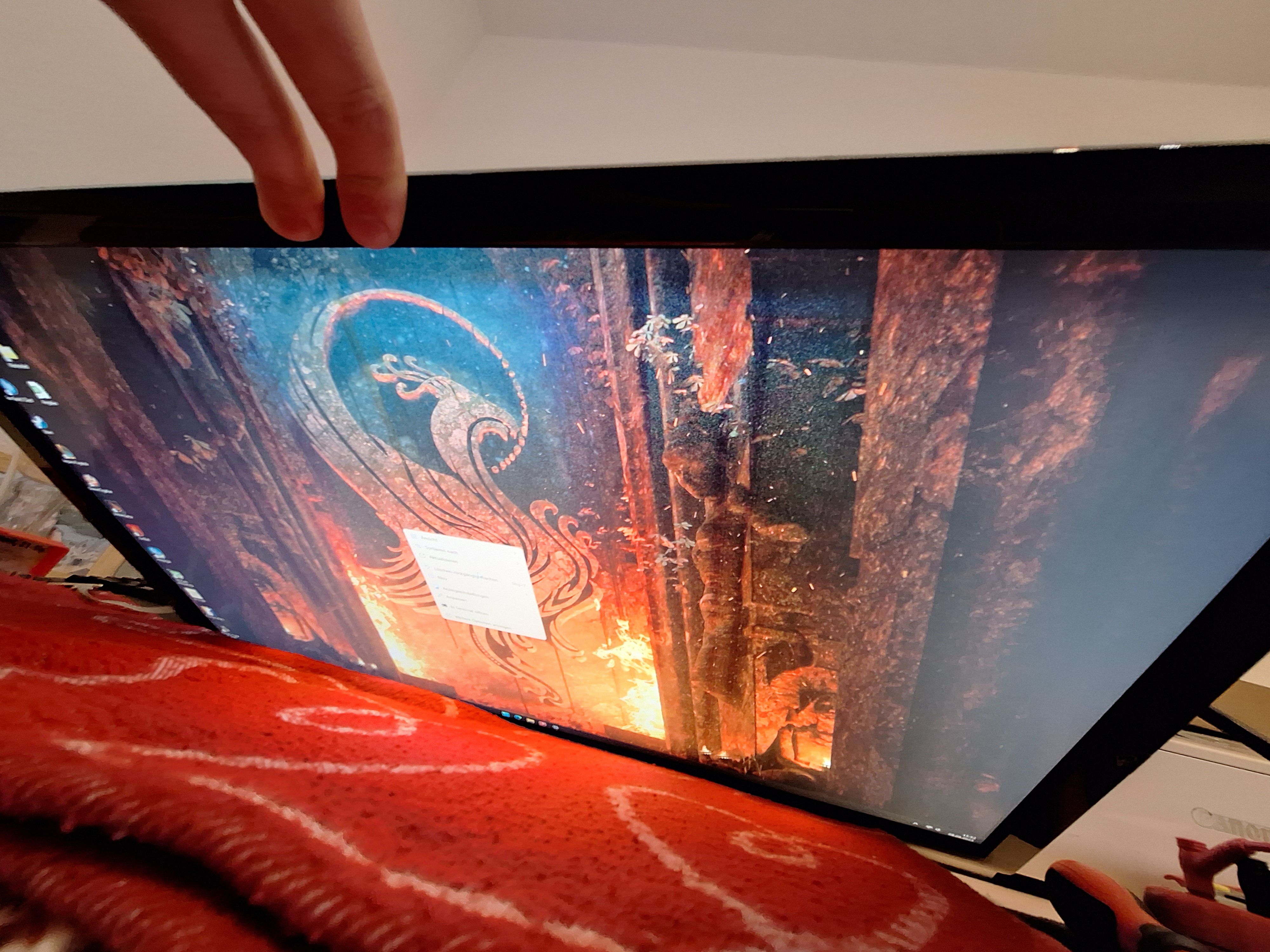

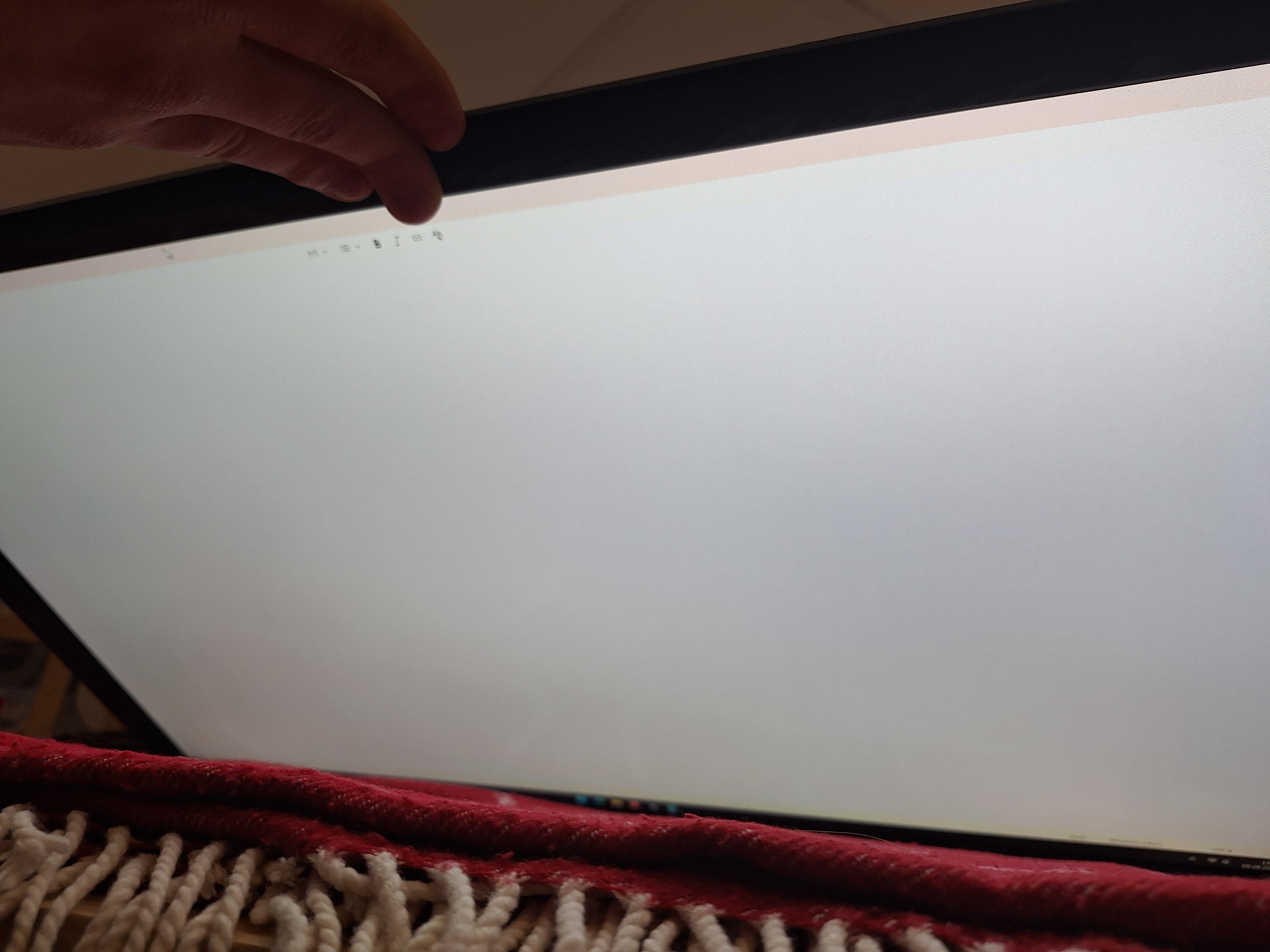

    I turned around to see, if the panel was completely perished now but somehow, the screen was WORKING now.
    Click image for larger version  Name:	20250909_155249.jpg Views:	0 Size:	2.26 MB ID:	3721623 Click image for larger version  Name:	20250909_155420.jpg Views:	2 Size:	2.14 MB ID:	3721624
    No lines anymore, nothing. I suppose, some capacitors have charged due to the short?
    Still, I don't believe this has fixed the issue in the long run, so what do you think is broken?
    IMO, only a component on the panel control board is possible.
