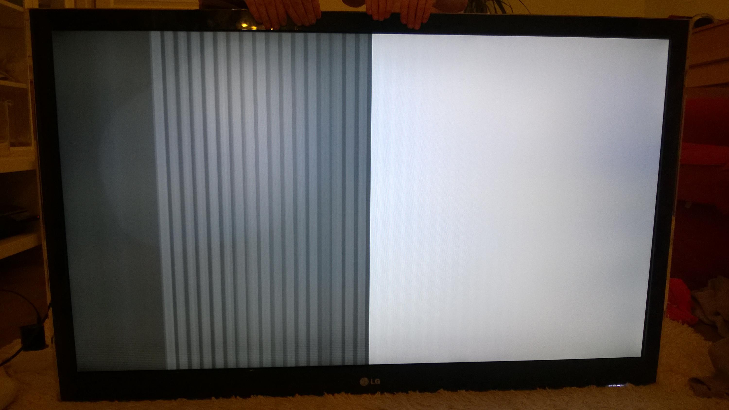

                                Here's a short video with no input plugged in: http://1drv.ms/1tu9SDP , I think there's some kind of "screen saver"/no input detected type of thing moving.
                                Also plugged computer to it and playing video makes lines move and shift the, seems like depending on how much contrast difference there is (you cant really see it properly in the video): http://1drv.ms/1sQAI88

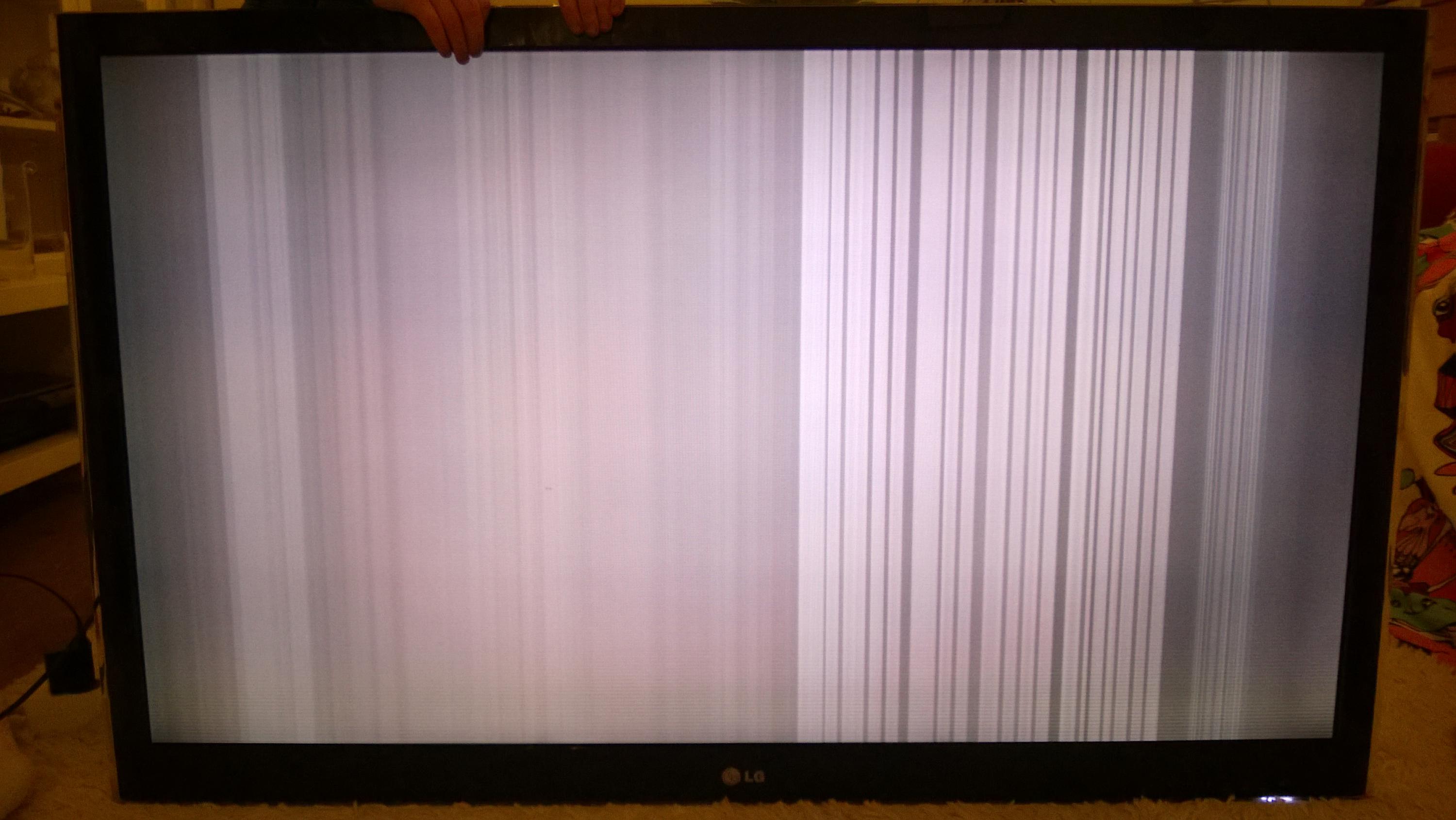

                                  Here's another video where you might see abit better; http://1drv.ms/1sQE7DO

                                    Re: LG 47LV550W audio and back light works / no picture
                                    Those readings look good.
                                    I personally, I would take the screen apart, at least to see the tabs, to see if anything looks bad there.
                                    I'm thinking Windex damage(corrosion).
                                    Only after that, I would order other boards.
