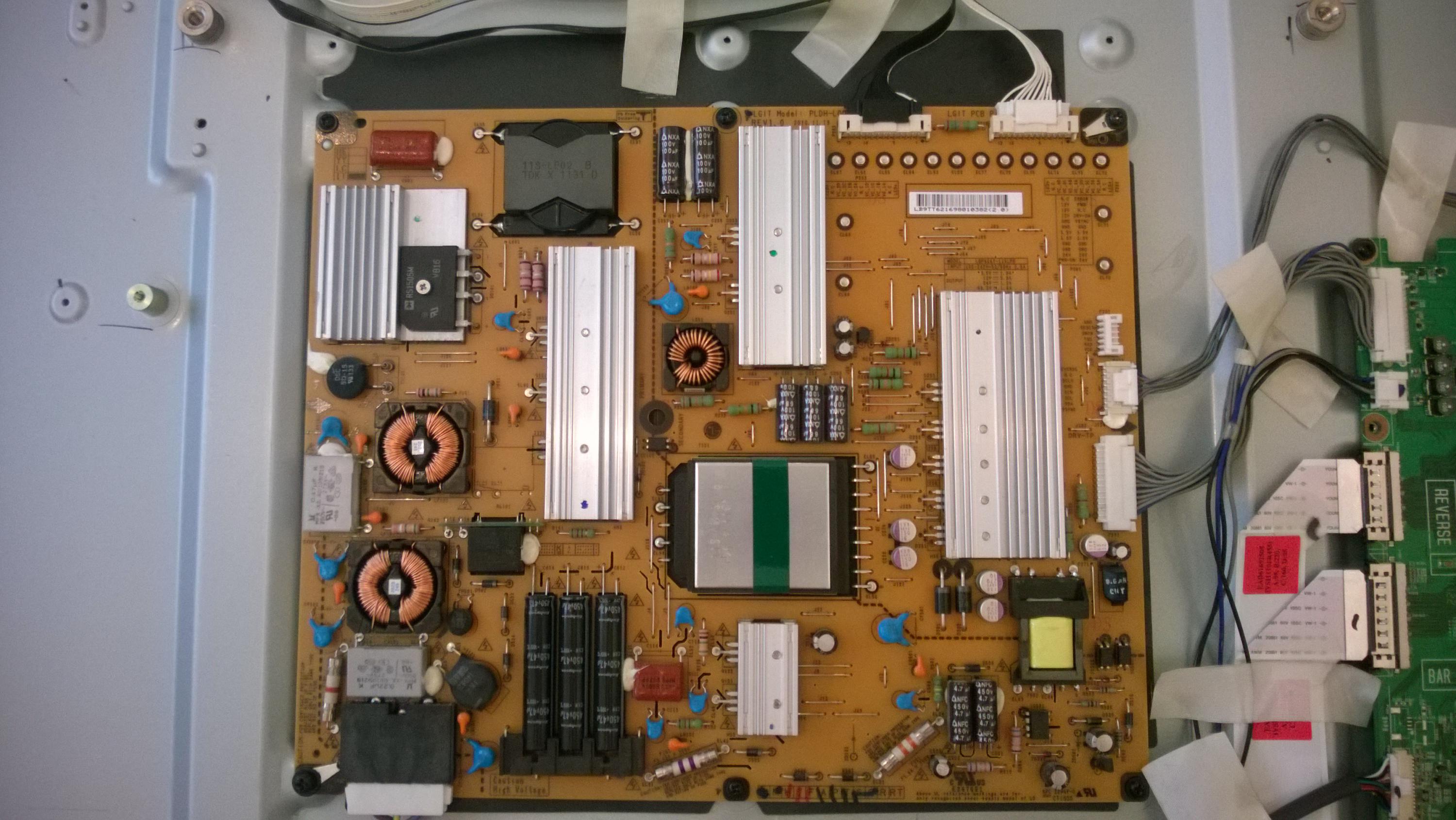

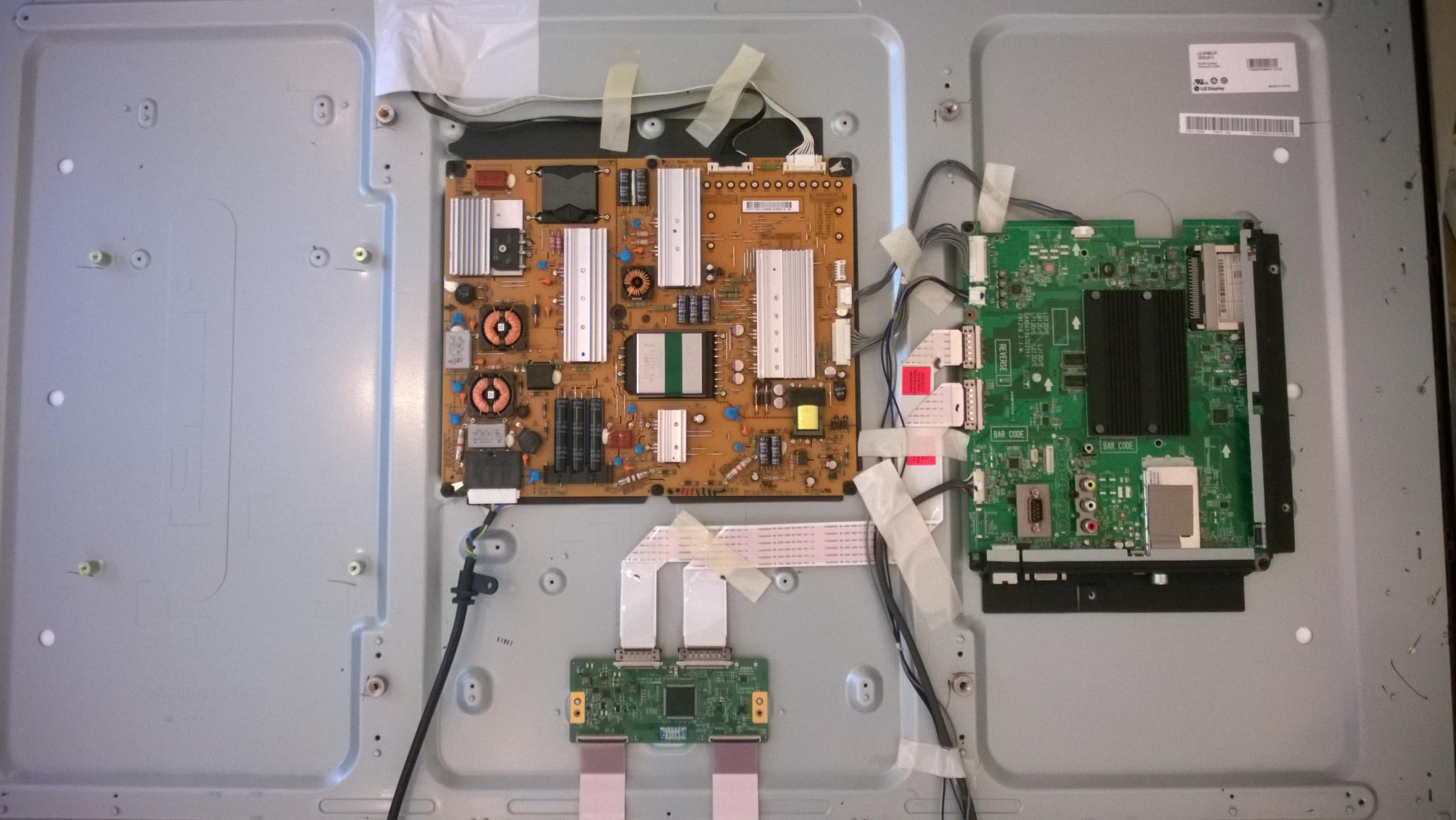

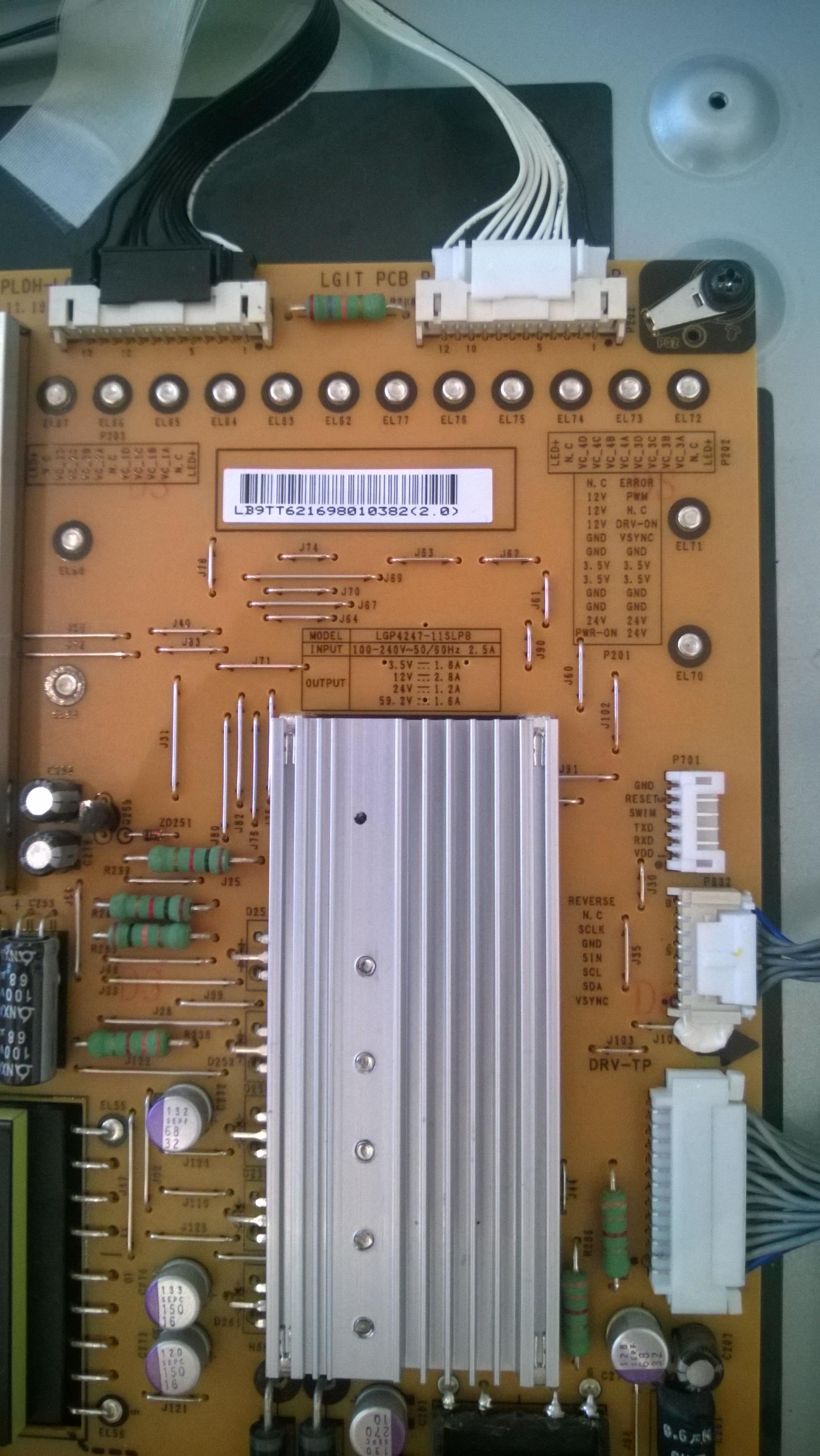

    Hi, decided to start a own thread on this one.
    Things I've measured this far:
    Voltages from power board (first picture) TV on:
    Upper left connector:
    LED+: 54v
    N.C: 0v
    VC_2A...2D: 11.5v - 13.3v
    N.C: 0v
    VC_1A...1D: 10.9v - 11.2v
    N.C: 0v
    LED+: 53.3v
    Upper right connector:
    LED+: 53.7v
    N.C: 0v
    VC_4A...4D: 10.9v - 11.6v
    VC_3A...3D: 13.6v - 18.8v
    N.C: 0v
    LED+: 53.7v
    Middle right connector:
    REVERSE: 0v
    N.C: 0v
    SCLK: 0,08v
    GND: 0v
    SIN: 0,15v
    SCL: 3,2v
    SDA: 3,2v
    VSYNC: 0,02v
    Bottom right connector:
    N.C: 0v | ERROR: 0,01v
    12v: 12,04v | PWM: 1,2v
    12v: 12,04v | N.C: 0v
    12v: 12,04v | DRV-ON: 3,3v
    GND: 0v | VSYNC: 0v
    GND: 0v | GND: 0v
    3,5v: 3,54v | 3,5v: 3,54v
    GND: 0v | GND: 0v
    GND: 0v | GND: 0v
    24v: 24,1v | 24v: 24,1v
    PWR-ON: 3,3v | 24v: 24,1v

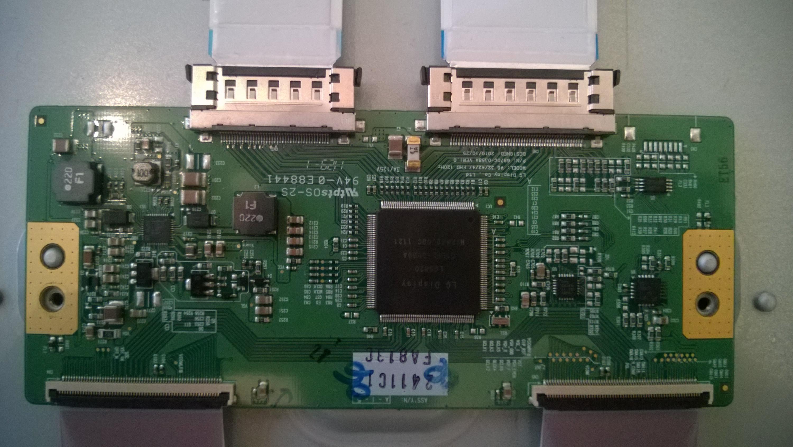

    Next moving to TCON board (second picture). First I measured the fuse when TV off, it gave 1 ohm and 9,9v at both ends. Then I turned TV on and measured 9,72v at both ends of fuse and following from testpoints:
    P_VDD: 0v
    GMA1...9: 0,02v
    GMA10...18: 0v
    VCC: 3,28v
    VDD: 0v
    VGL: -1,55v
    UC1: 0v
    VGH: 0v
    VST: -1,55v
    VGH_EVEN: -1,55v
    VGH_F: -1,55v
    GCLK1...6: -1,55v
    VCOM: 0,26v
    Z_OUT: 0v
    VCOMRFB: 0,26v
    GIP_RST: -1,55v
    VGL_1: -1,55v
    VGH_ODD: -1,55v
    VGH_R: -1,55v
    E0: 0v
    GST: 0v
    MCLK: 0v
    GCLK: 0v
    VCORE: 0,99v
    VIN: 9,72v
    HVDD: 0v
    SOE: 0v
    VST_IN: 0v
    OPT_N: 0v
    VCOMLFB: 0,26v
    PDL: 0,04v
    H_CONV: 0v

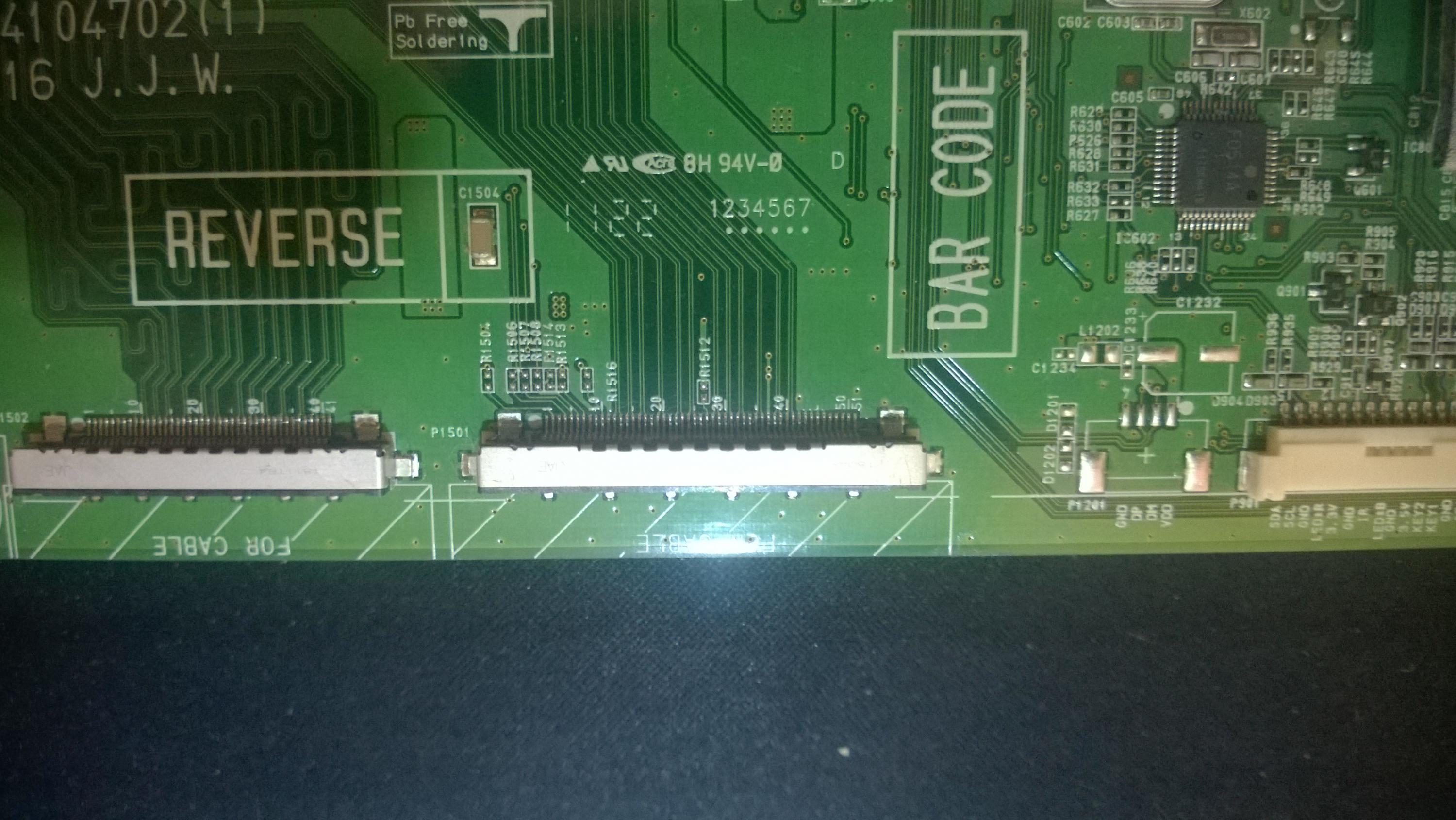

    Then as Caleb suggested in other thread I tried pulling the connectors while TV was on but didnt see any reaction on screen.
    Last thing I tried was hooking it up with computer and changing images on screen. When I put up black image the back lights would dim and likewise on white image back lights amped up.
    Earlier owner tried changing TCON board without success. Could it be that he had bad luck and the new part was DOA? Or could some other part be busted?

    All heatsinks warm up after awhile. TCON makes faint buzzing sound the minute I plug in mains, hearable under 10cm. No component warm up in TCON.

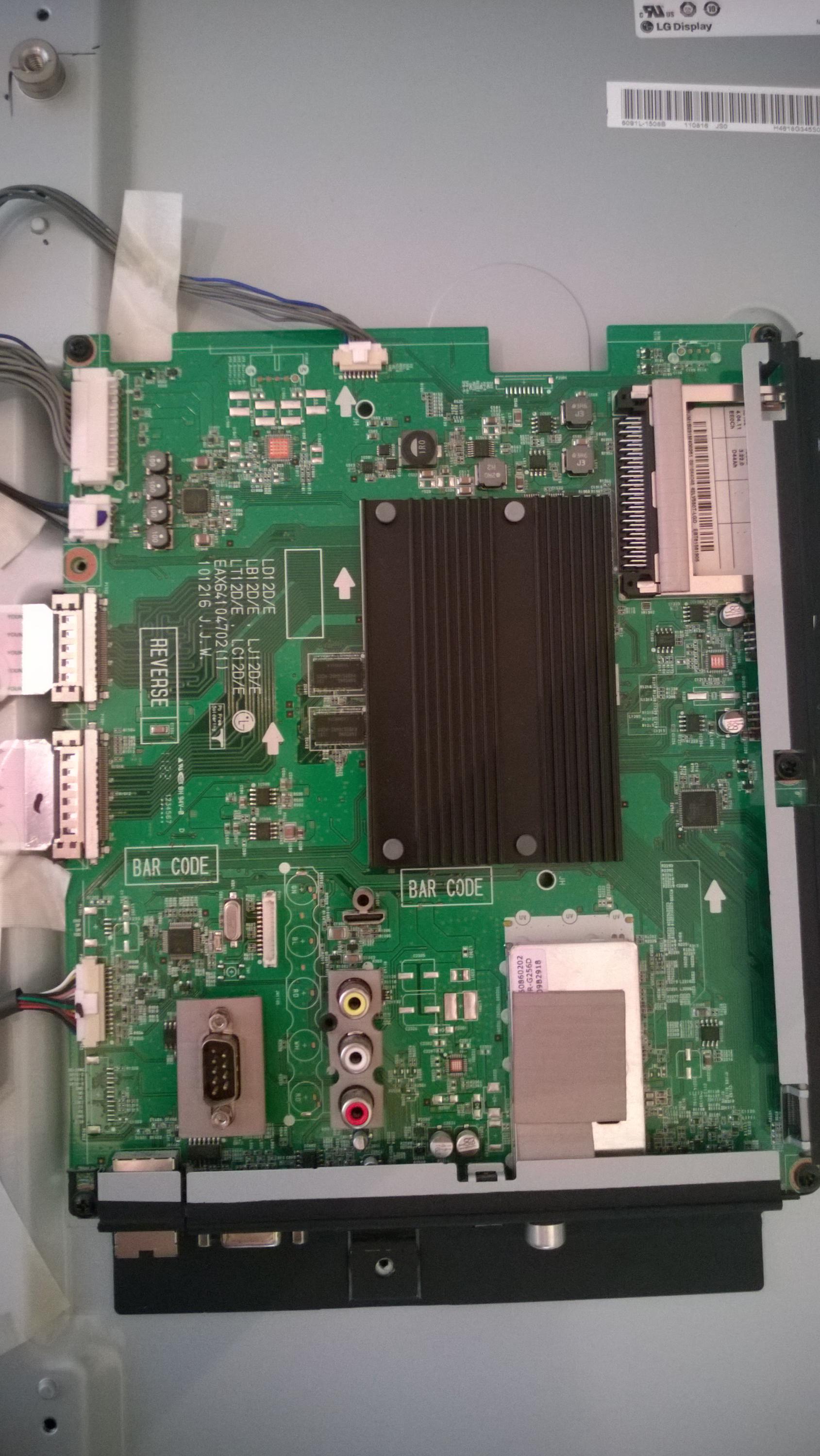

      Quess I'll order new TCON and main board just to rule out dead panel...

        What DC voltage do you have at either end of the SMD white fuse on the T-CON board?
        "VIN: 9,72v" I expect it to be 12VDC.

          TV off: 9,9v at both ends. TV on: 9,7v both ends.
            Re: LG 47LV550W audio and back light works / no picture
            The dc voltage feeding the T-CON is through a switched MOSFET which is turned on when the TV is on , and turned off when the TV is turned off.
            9V does not sound right for the voltage for running the T-CON.
            Can you see the LCD panel model number? We need to look up the spec. I see the LG DISPLAY sticker in the picture. At this point it sounds like the main board is not working properly.
            Did you try disconnecting those two flat cables yet?

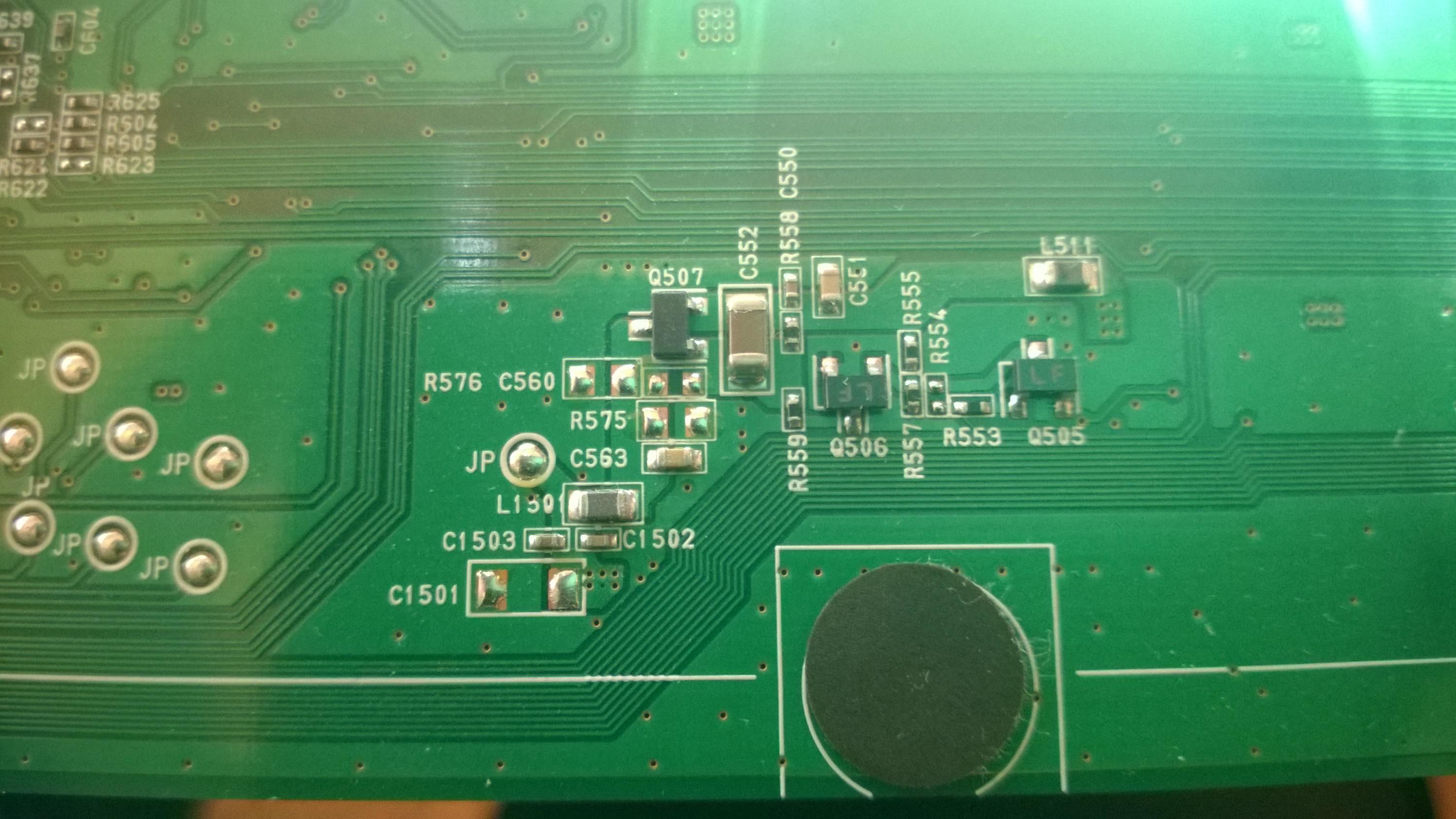

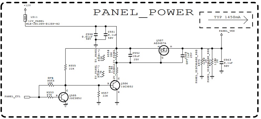

                      According to datasheet pins 48-51 are Power supply +12v to TCON. I toke main board off, here are pictures above and under the mentioned pins. Could the mosfet be one of those in the second picture? Any way to measure them?
                      BTW, I appreciate you all who spend your time helping strangers in distress!
                        I cannot tell from the pictures, the 4 pins on the T-CON board are where the 12V is fed into, I cannot see well enough what they are connected to on the main board side. Can you see or mark it for me? you will have to sue the Ohm meter to check for <1 Ohms on one end of the furs to the other end of the connector on the main board to see where it goes.
                        • Masba
                          • Sep 2014
                          • 36
                          • Finland
                          They connect to pins 48-51, marked with red circle. Tried measuring those four pins and got same results from all as from the fuse. That is 9,72v TV on, 9,9v TV off and 10,2v ribbon cables in TCON detached.

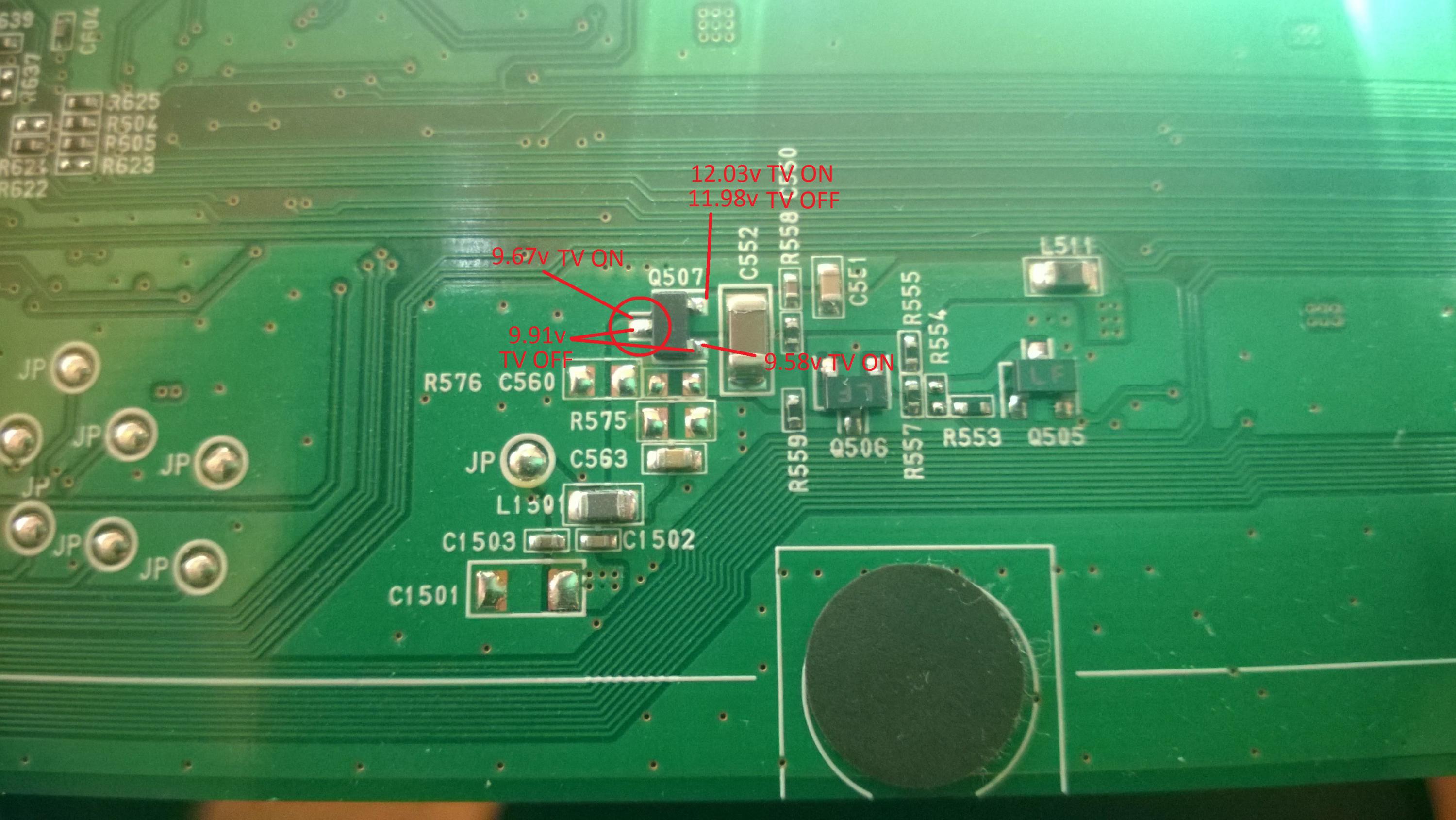

                            OK, then there should be 3-PIN MOSFET close by that one of its pin will be connected to the pins on the connector, just start looking for <1 Ohm from those pins to the device.
                            • Masba
                              • Sep 2014
                              • 36
                              • Finland
                              Part # Q507 gives 0,8 ohms. Marked in the picture. There are markings X72A and 21 on the part.
                              • Masba
                                • Sep 2014
                                • 36
                                • Finland
                                Apparently it is this one if I read the schematics of SM right: https://cdn.badcaps-static.com/pdfs/...fa1ec3aa2d.pdf
                                  OK, lets take the DC Voltage readings on all 3 pins, at least one of them should have 12VDC.
                                  • Masba
                                    • Sep 2014
                                    • 36
                                    • Finland
                                    Yeah marked values in picture.
                                    Top right: TV ON 12.03v/11.98v TV OFF
                                    Bottom right: TV ON 9.58v/9.91v TV OFF
                                    Middle left: TV ON 9.67v/9.91v TV OFF
                                      OK, looking at the picture of Q507, this is a P-CH MOSFET, the top pin is SOURCE (S) pin, the middle pin (on the left of the body) is the Drain (D) pin, the bottom pin is the GATE (G) pin.
                                      So lets check the resistance between S and D, S and G, D and G.
                                      • Masba
                                        • Sep 2014
                                        • 36
                                        • Finland
                                        S-D: 101ohms
                                        S-G: 120ohms
                                        D-G: 20ohms
