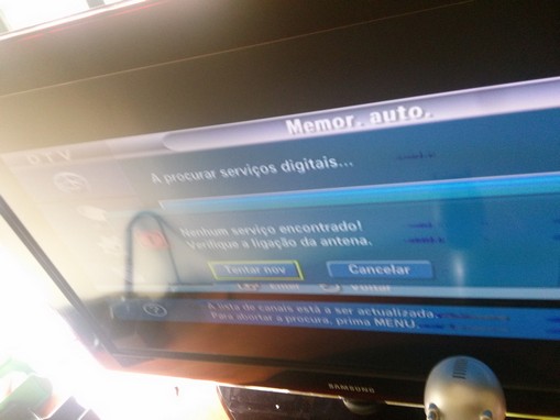

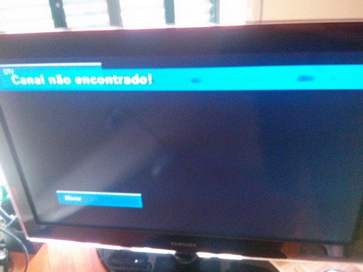

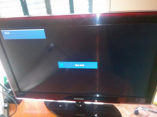

    Hello!
    Got this set from a friend and it has image issues.
    Opened it, checked PowerBoard voltages, all OK.
    Inverter 24V OK. 5V OK.
    All voltages present Ok.

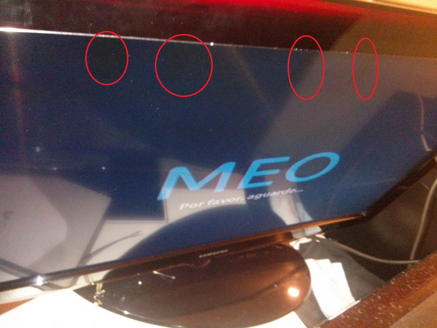

    In some input's I got a normal image, but in antenna I've got a messed up image.
    First picture, when in EXT1, menu image OK.
    2nd one, when in EXT2, menu image OK.
    3rd one, when in antenna, image NOK.
    4th and 5th one, when scanning antenna signals, some "blurr" appears in the menu image.
    Share your thoughts guys!
    Thanks!

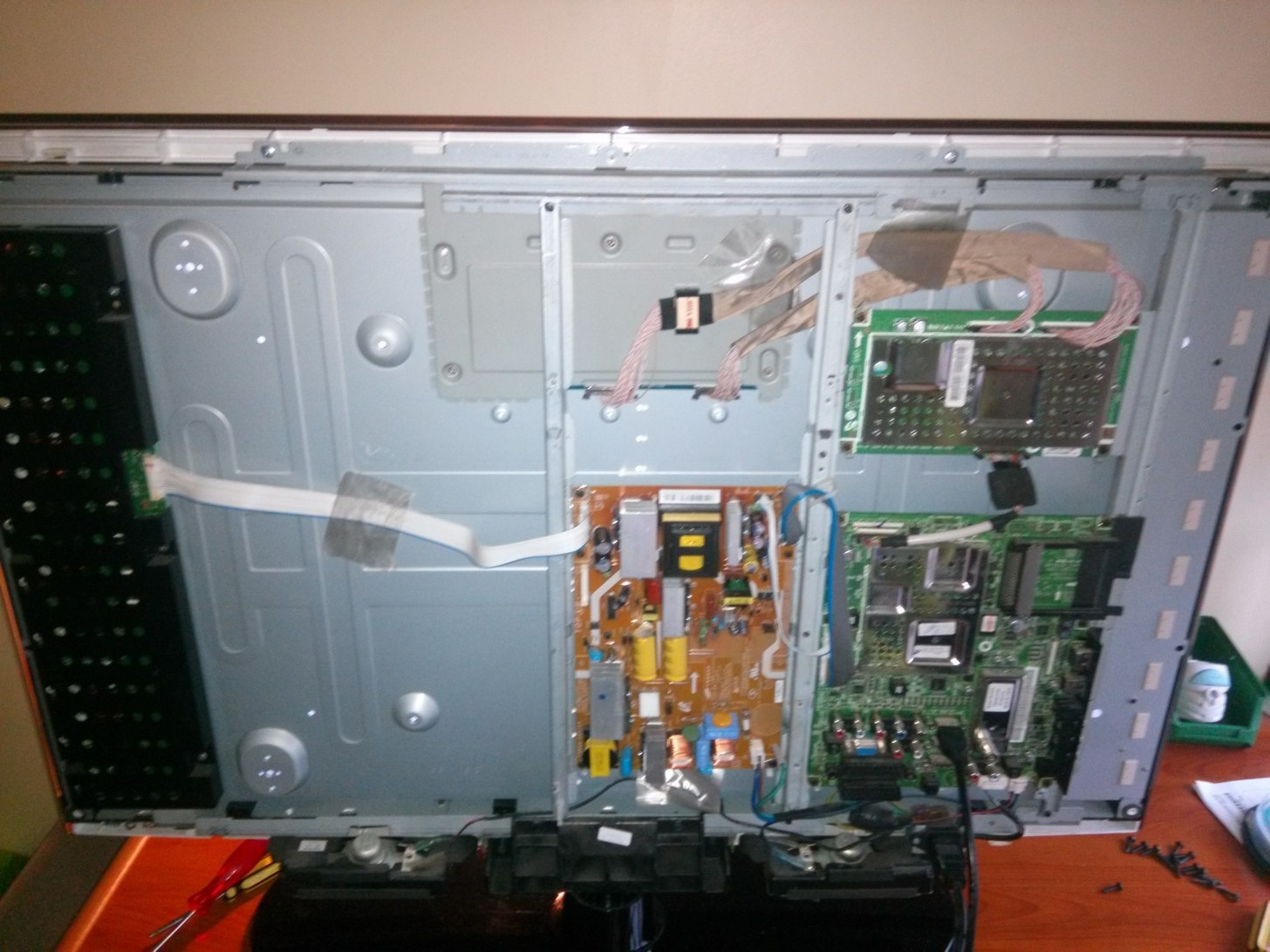

            This TV has a Power Board, i/O board, 100hz board and tCon board.
            The culprit should be one of them...excluding the Power b0ard since all tensions presented OK...
            Gonna update later!

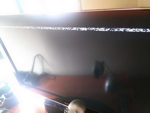

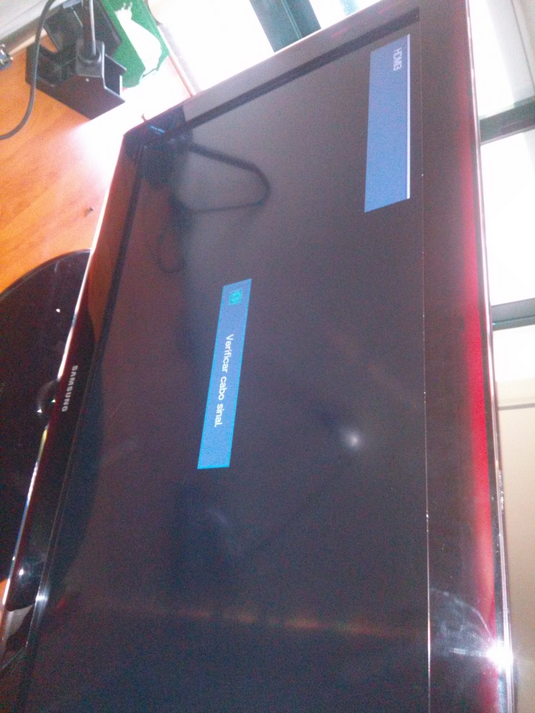

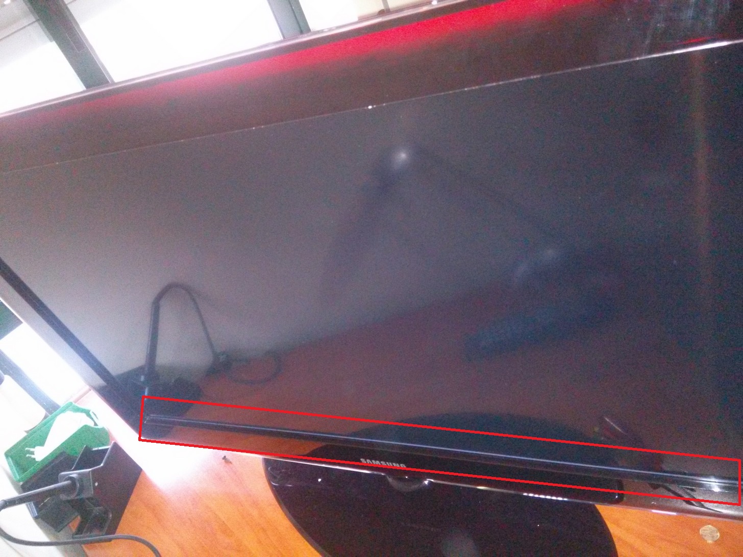

              Re: Samsung LE37A656A1FXXC bad panel?
              Hello!
              Well, I've got some inputs available and here are the results .
              picture1- back of the lcd
              picture2- hdmi input menu
              picture3 - hdmi connected, no image just one line in the bottom.
              When I select identify monitors on my laptop, I can see the 2 on the
              LCD but no image, just that blurry line on the bottom

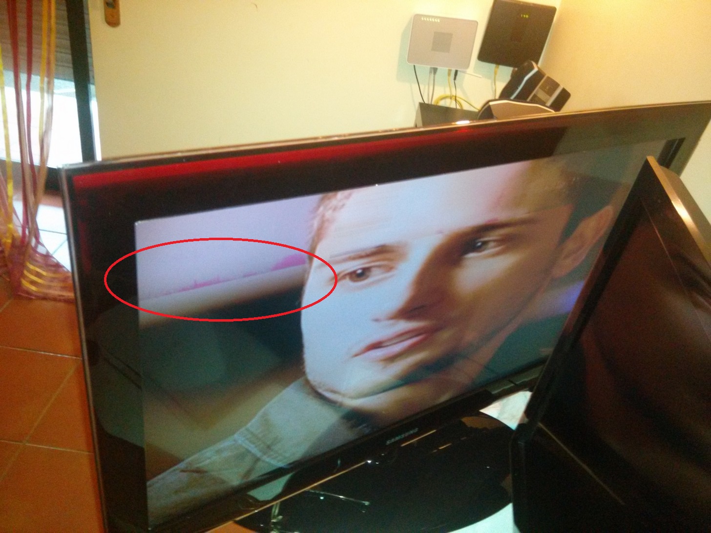

              picture4 - ext1 by SCART connected in cable box TV. on the image of the start up of the cable box I can see some defects on the top of the image
              (some weird black stripes)
              picture5 - image on the cable box and I can see the image flickering and some blurry defects
              Exluding power board and inverter, the culprit could be 100hz board or main...
              Is it possible to troubleshoot these boards with MM?

                          • triplefour
                            • May 2014
                            • 1747
                            not that i have experience here but that single line of static across the screen doesnt look too comforting :/
                            is there any input that it does look fine on?

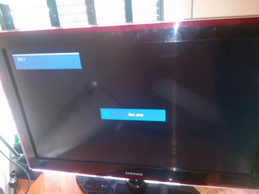

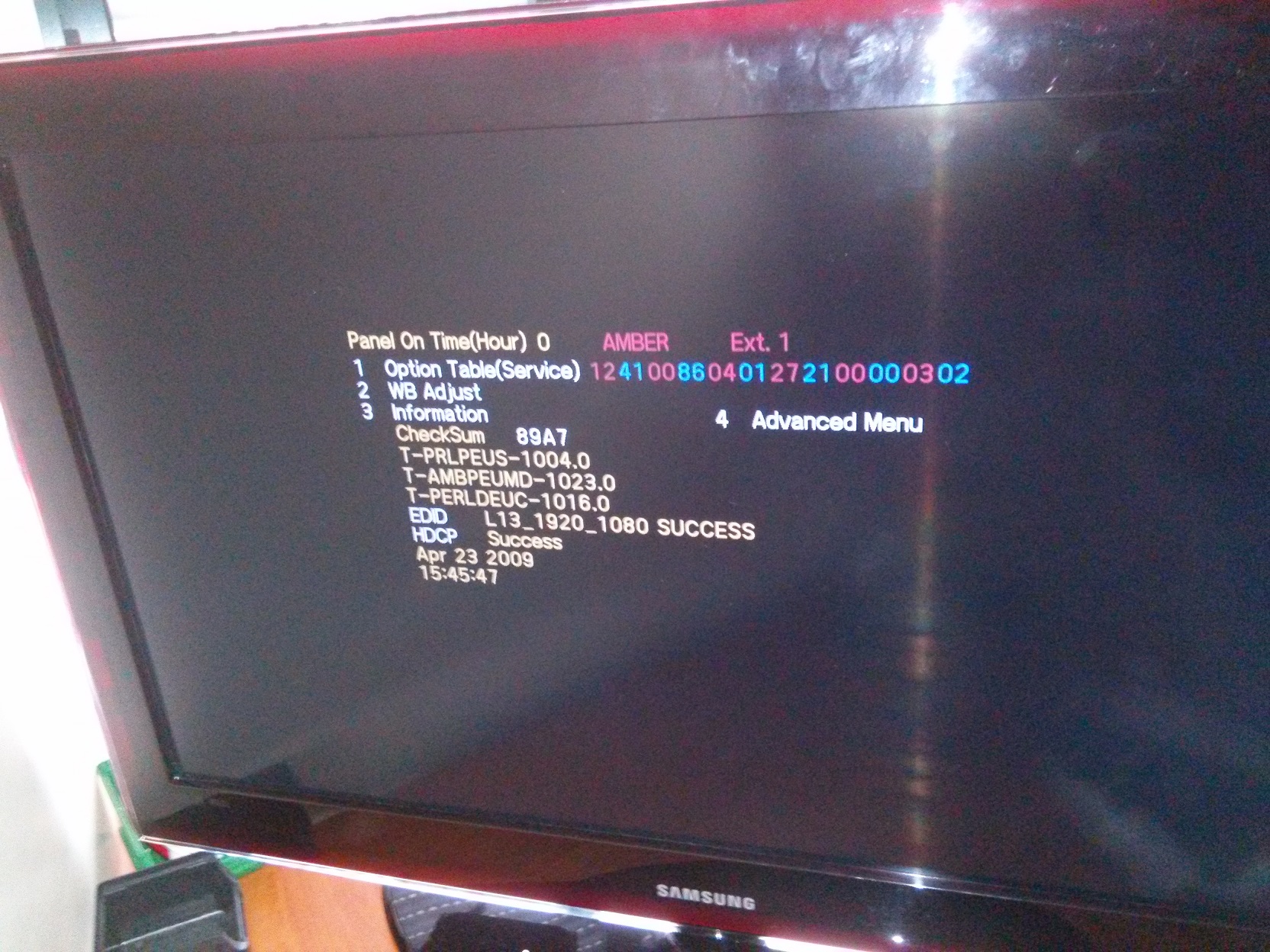

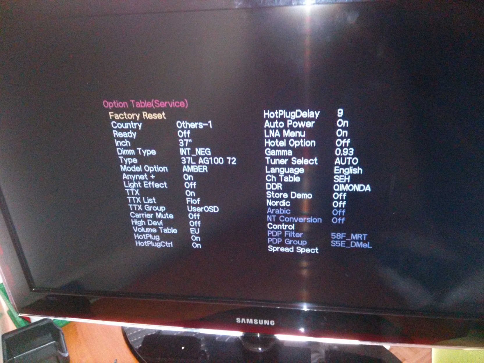

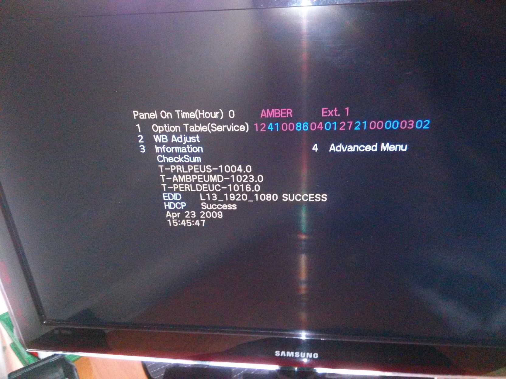

                              Hello!
                              Well I've found out that there's only 1 input where I cant access the service menu after all.
                              If I'm on AV,HDMI,EXT or AV , I can see the menu!
                              I made a factory reset and no changes, as expected.
                              I cant find those test pattern DR pre/post, FRC pre/post Shinju talked about.
                              Here are some pics of the options I get.
                              1rst picture - menu
                              2nd picture - option table (service)´
                              3rd picture - checksum
                              Could it stil be a bad pannel? Or should I order the Mainboard and test?
                              Thanks!

                                What was in the advance menu? BTW I think the menu system for Samsung outside of the US is not the same, as I have never seen a SM like yours before.
                                  On option 4 Advanced menu I cant get into any options.
                                  If I go to 1 I get into menu of picture 2.
                                  In option 4 I press OK but I cant get any options beyond.
                                  Cheers
                                    Any thoughts why I cant enter any options on option4?
                                    Should I try another Mainboard?
                                      Press 0 four times on remote to access menu 4. Nothing much interesting there though.
