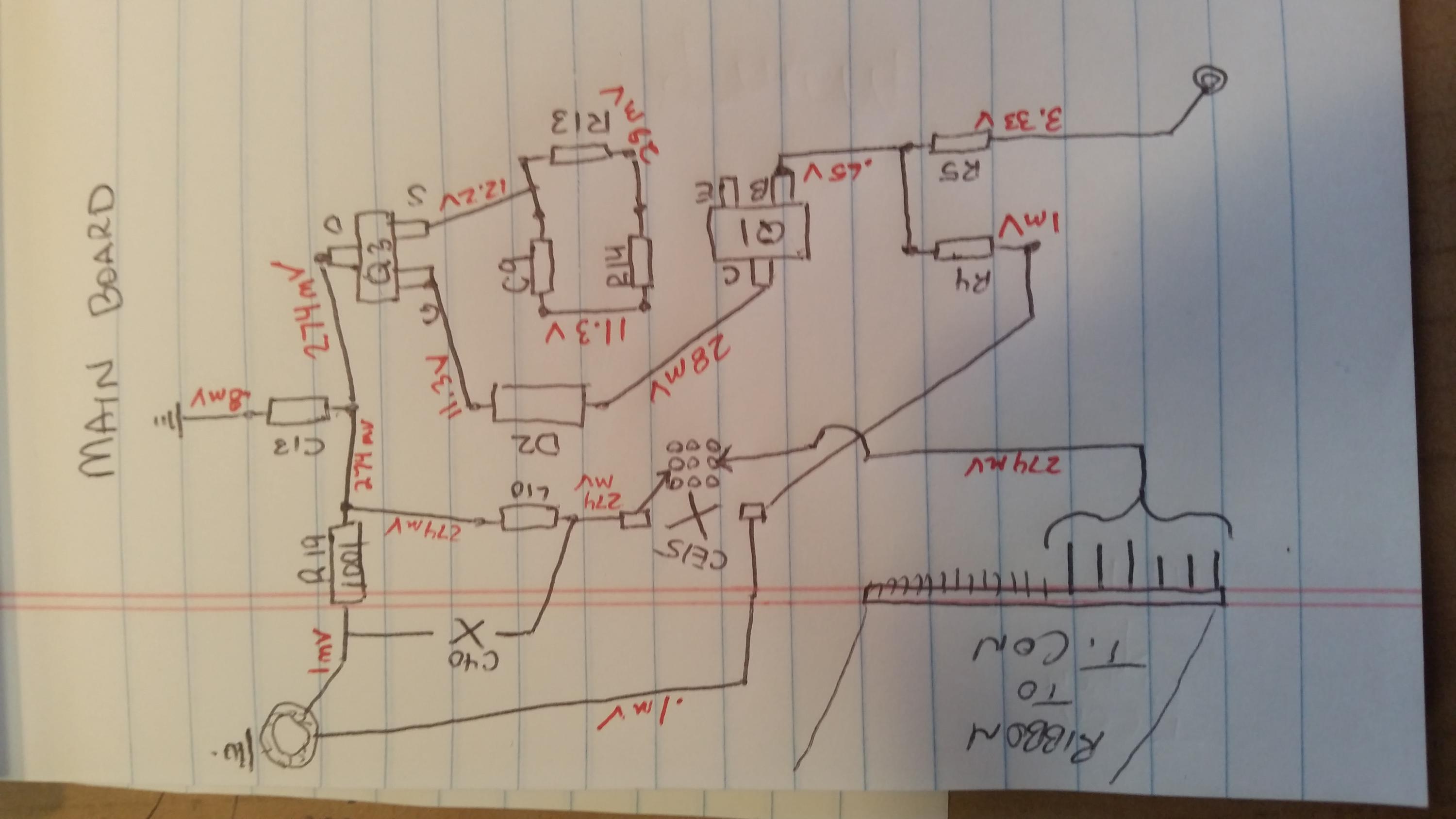

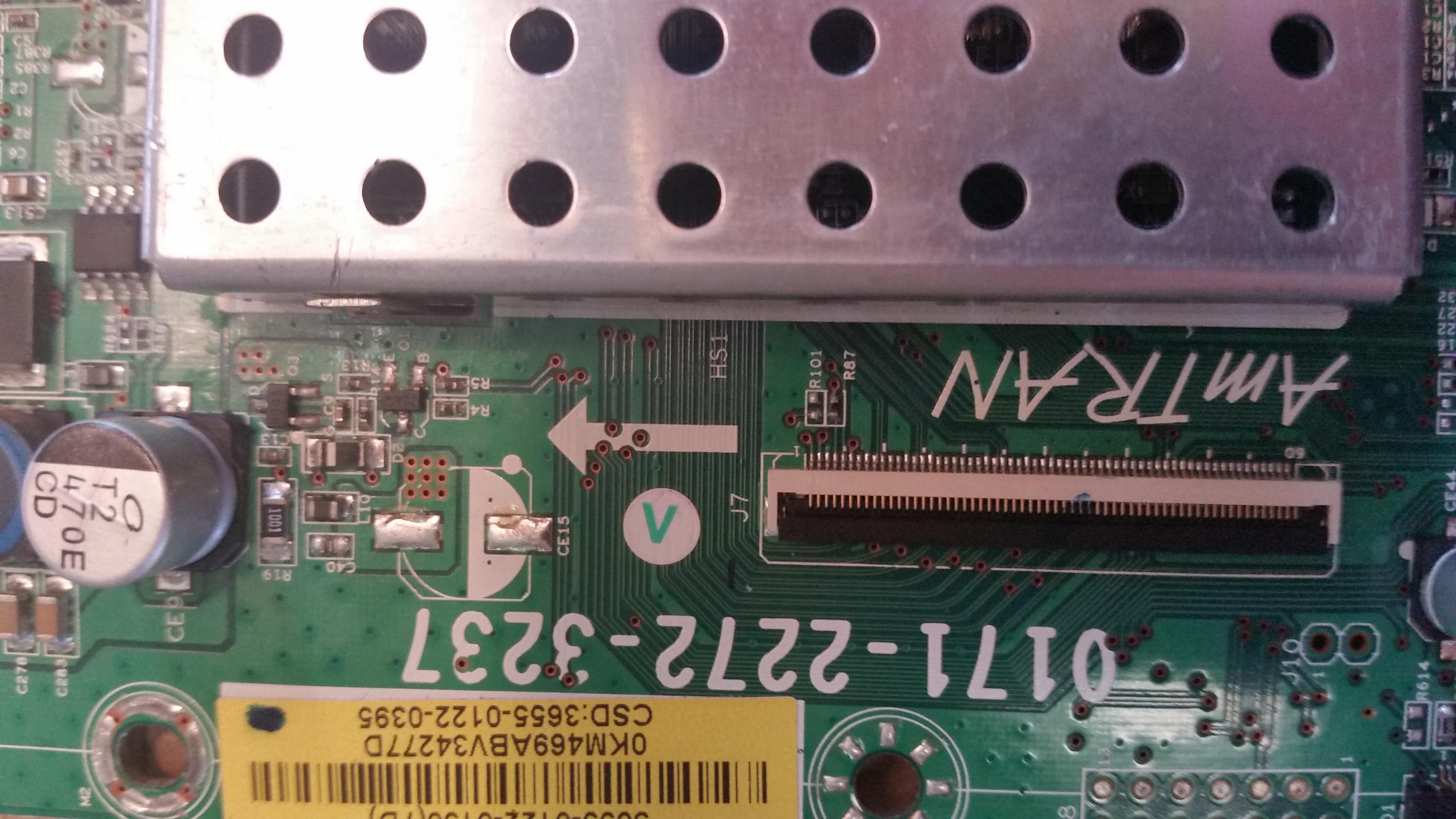

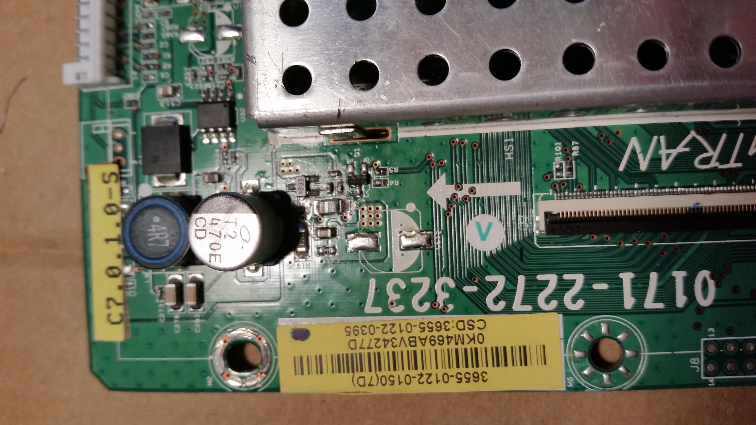

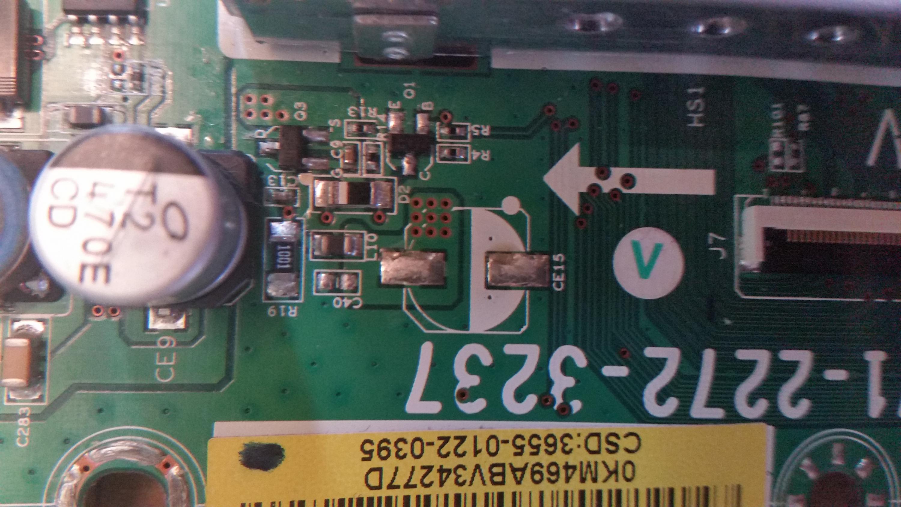

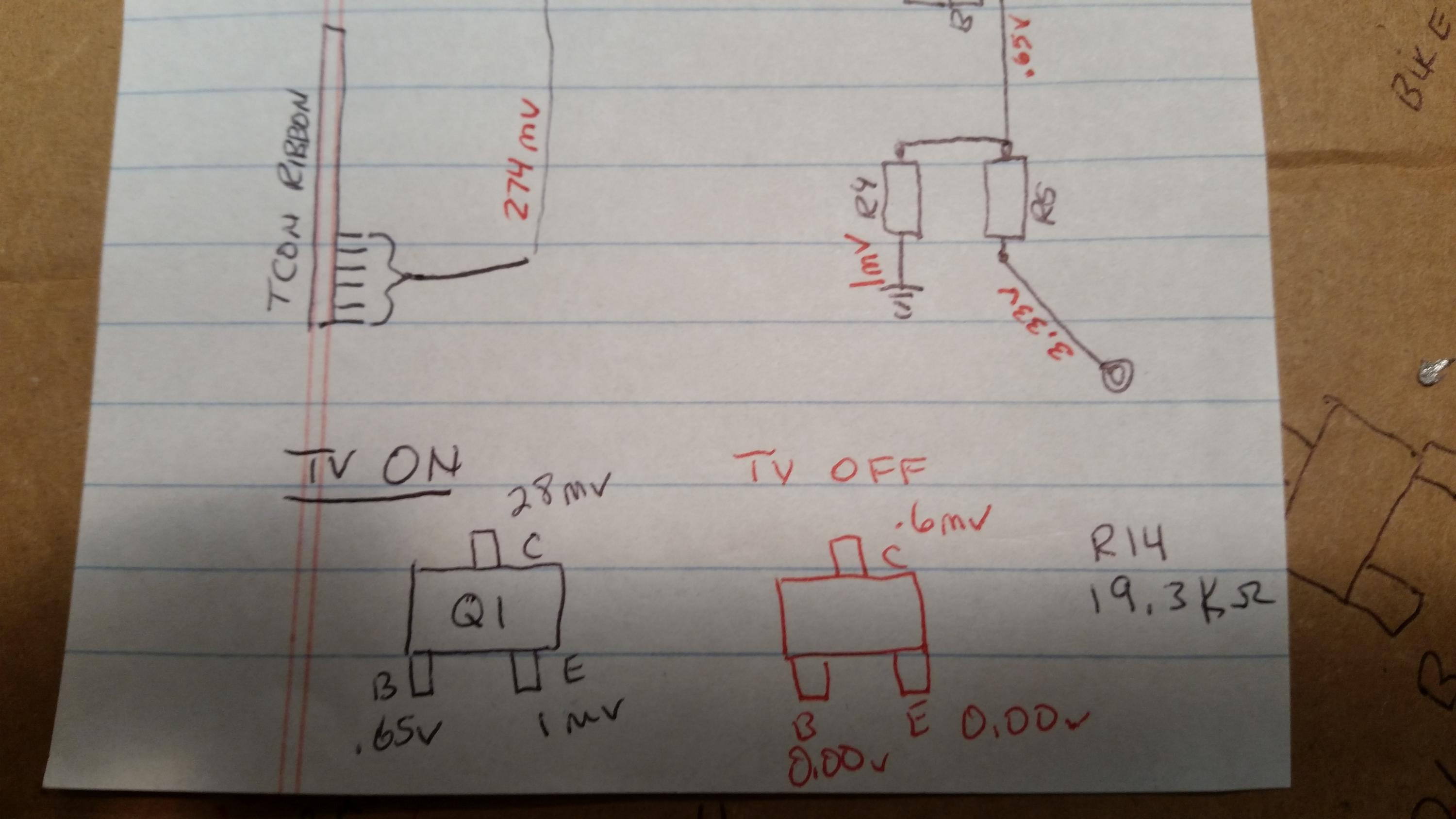

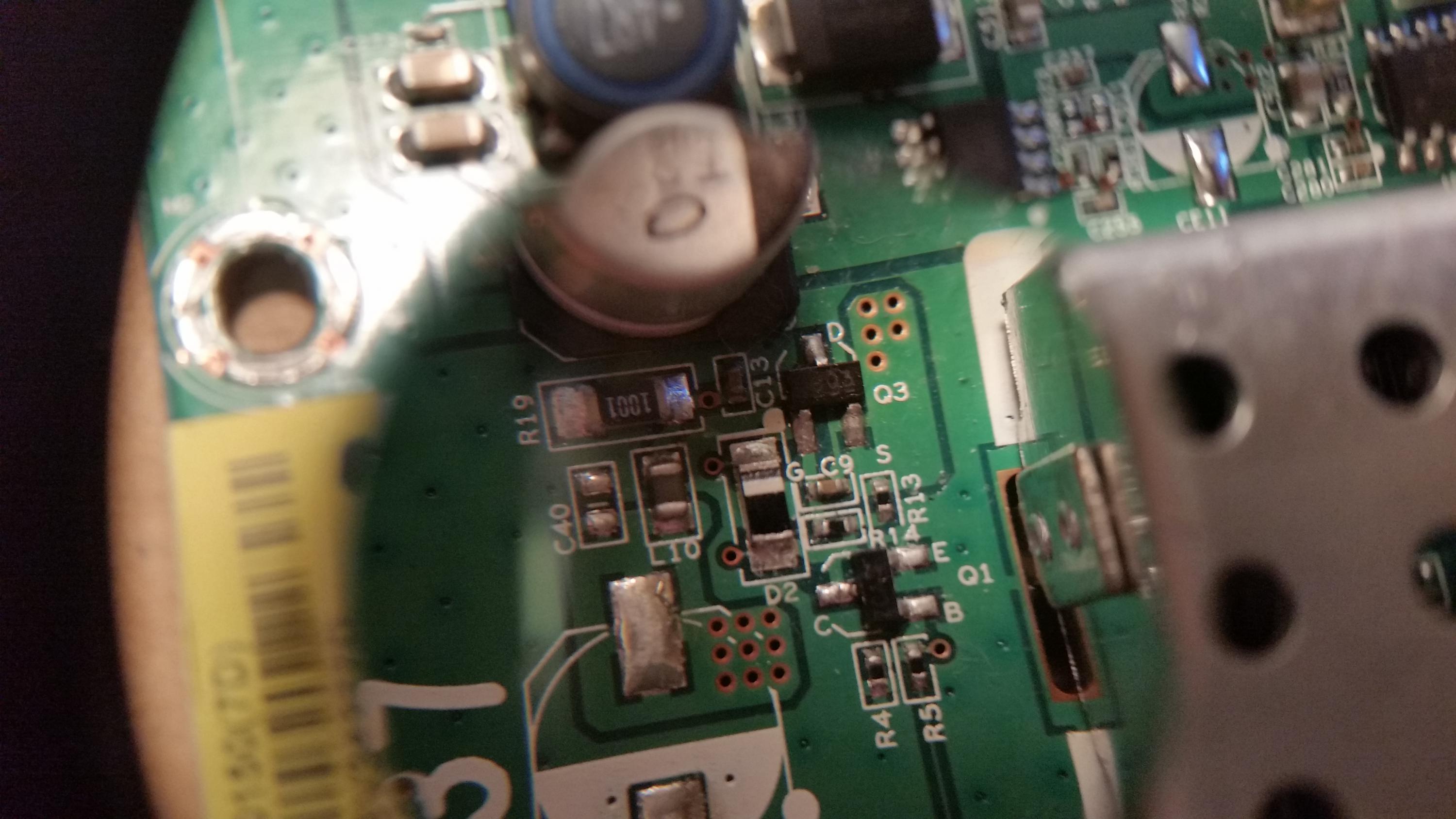

Here are the components I traced from the Tcon ribbon. First pic is normal second pic is under a magnifying glass. Leaves the ribbon and hit R5 first. The left side of R19 and bottom R4 and emitter on Q1 is ground.
