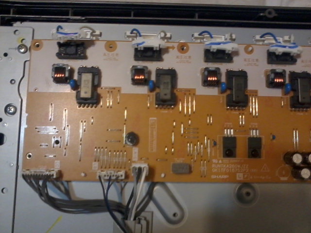

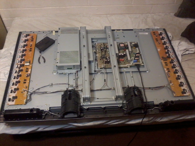

    I found out the steady flashing power led is a fault shutdown and can be reset by pressing the volume down and input buttons while plugging the power cord. The tv powers up with no backlight and then shuts down again.

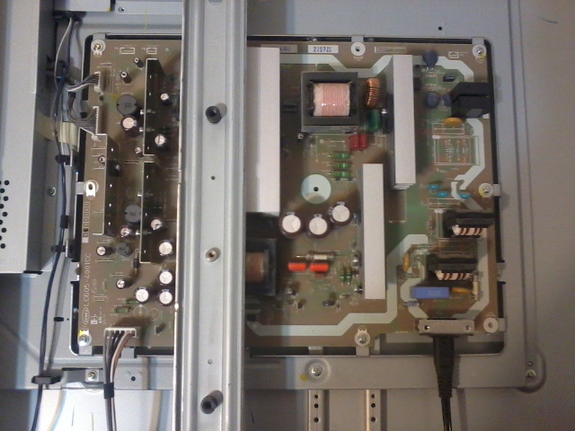

    I found 2 voltages 10 volts gray wires and 42 volts white and beige wires that go from the power supply to both sets of inverters.
    And I think I have the necessary control voltages coming from the logic (main board) on the harness coming from the logic board I have a white wire with 3.2 volts and a gray wire with 3.1 volts.
    I searched here for other posts on this tv and found nothing related to my problem... Anybody got any Ideas I think I have a bad #2 inverter it has the master control circuit on it... I checked all the fuses on the inverters and all four are good.

    I have recently repaired a LC65D64U and it was the master inverter. Same symptom.
