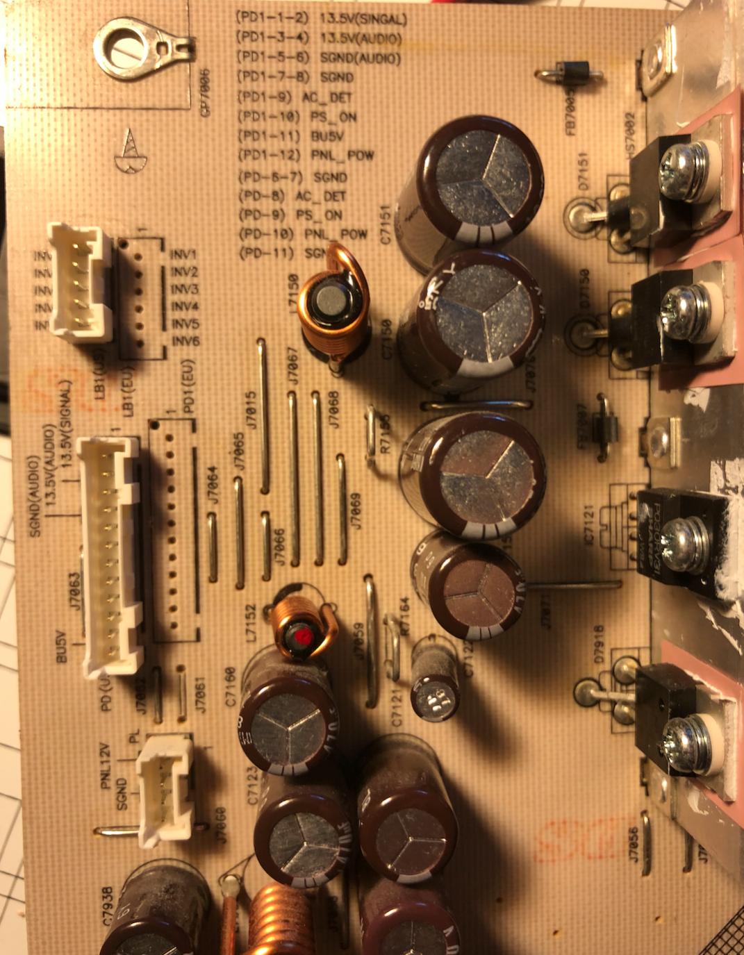

    Not sure the pin 10(PNL_POW) of PD should have any voltage?
    Do I have bad power board or main board?
    The power board is DPS-277BP, RDENCA295WJQZ.
    Please help. Many thanks.

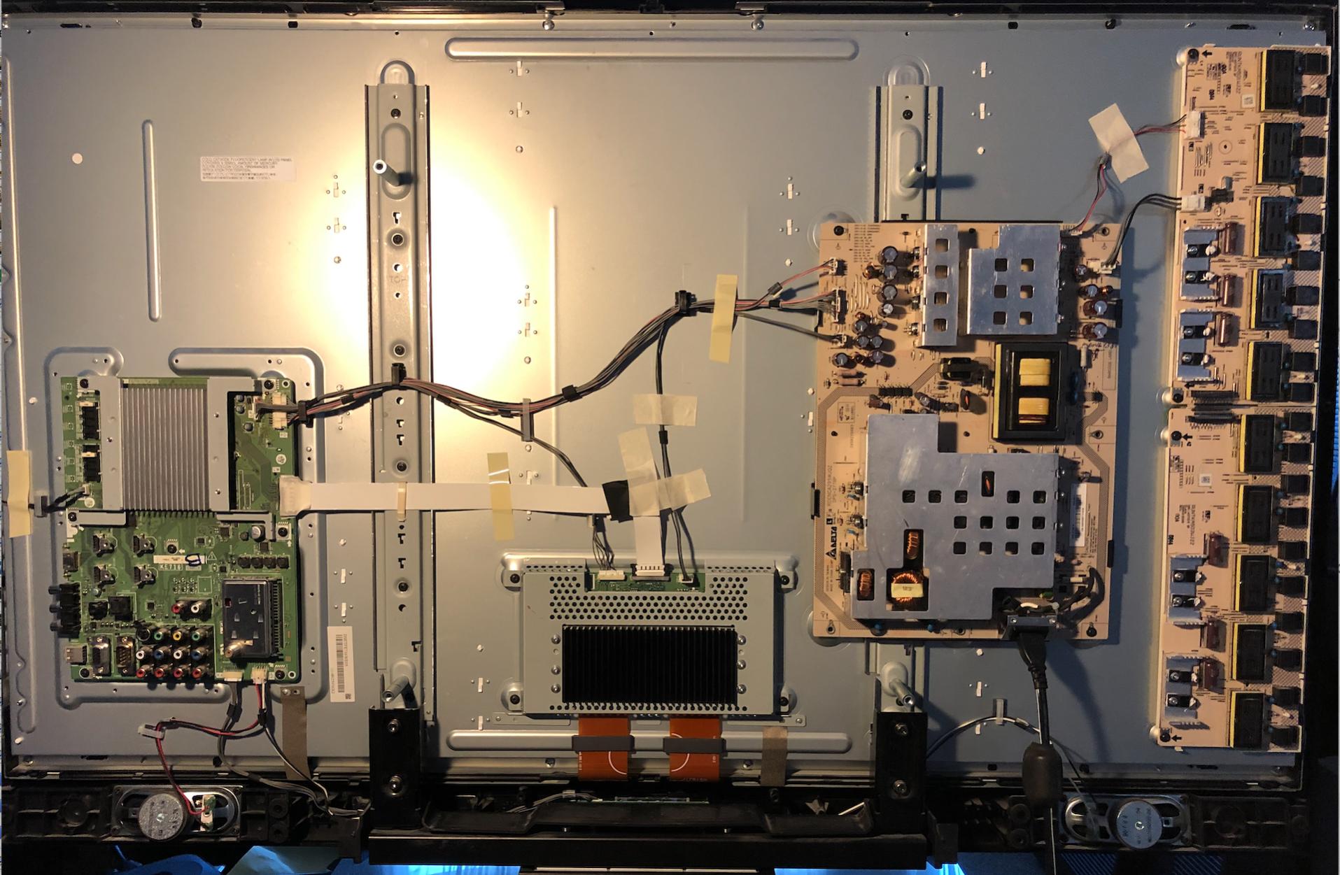

      Re: Sharp LC-46D85U green power light & OPC flashing

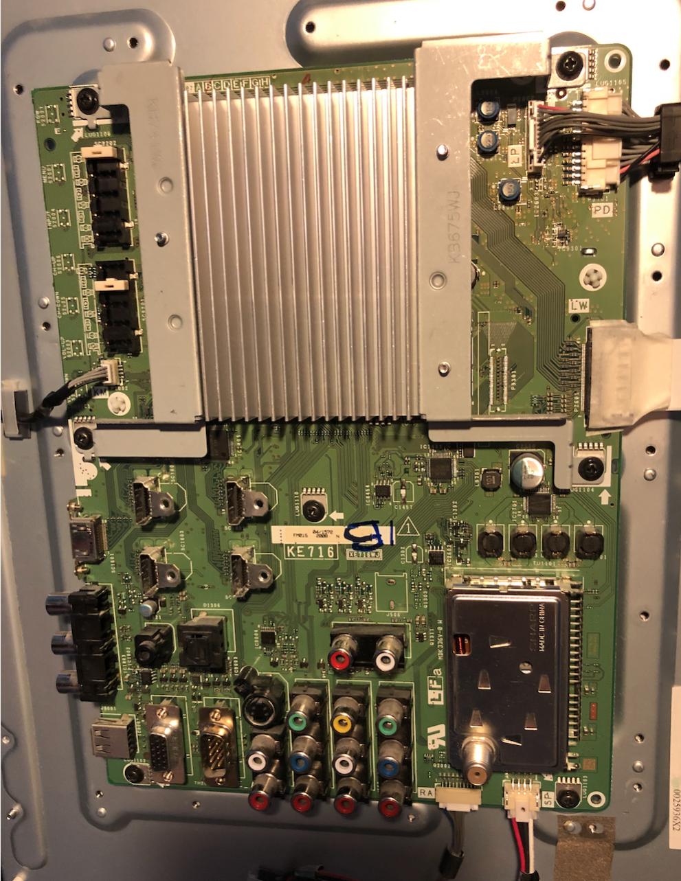

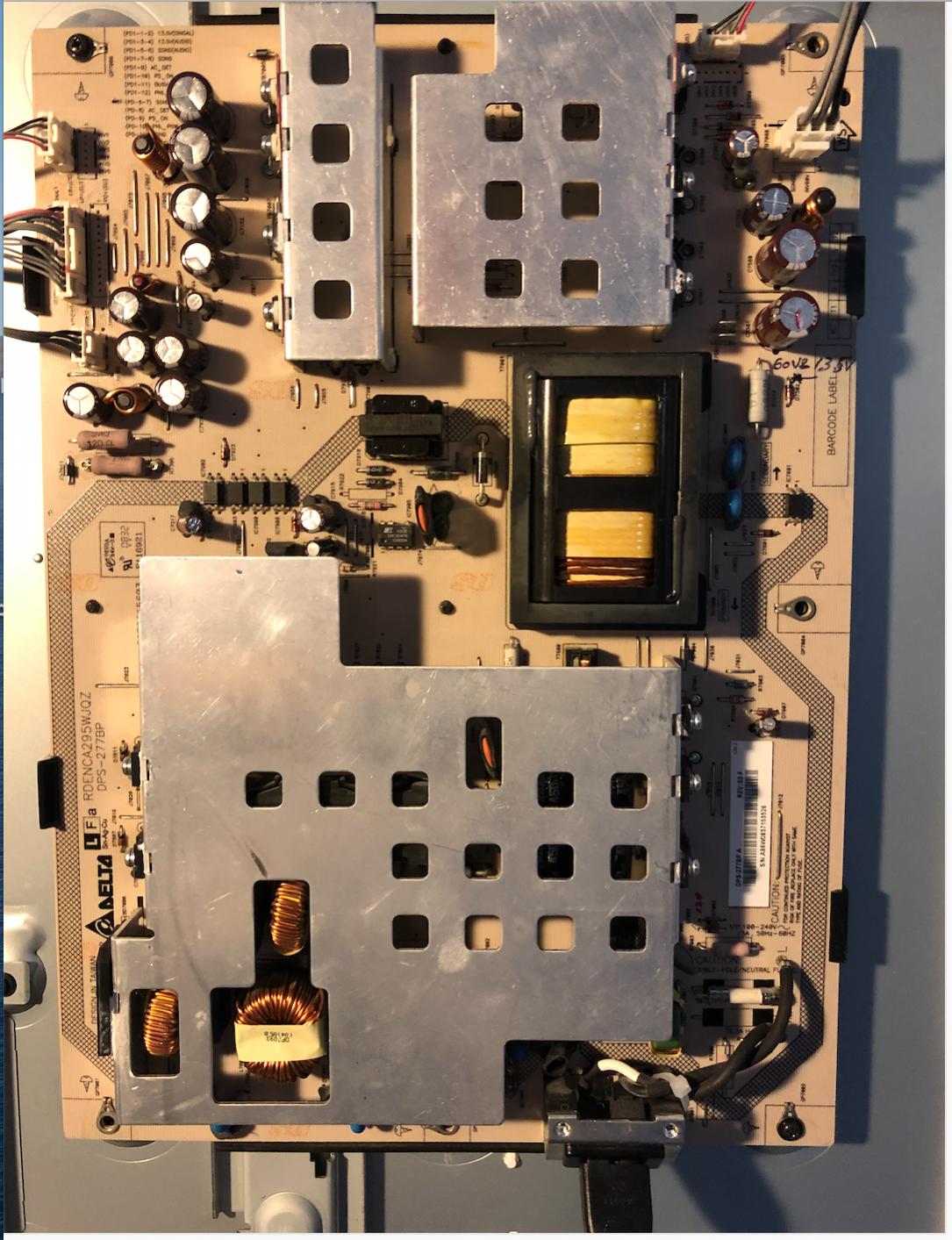

      I shoot couple pictures of the TV, I can upload 3 pictures in one time.
      one is the full back view of the Tv, one is the power supply unit and main unit.

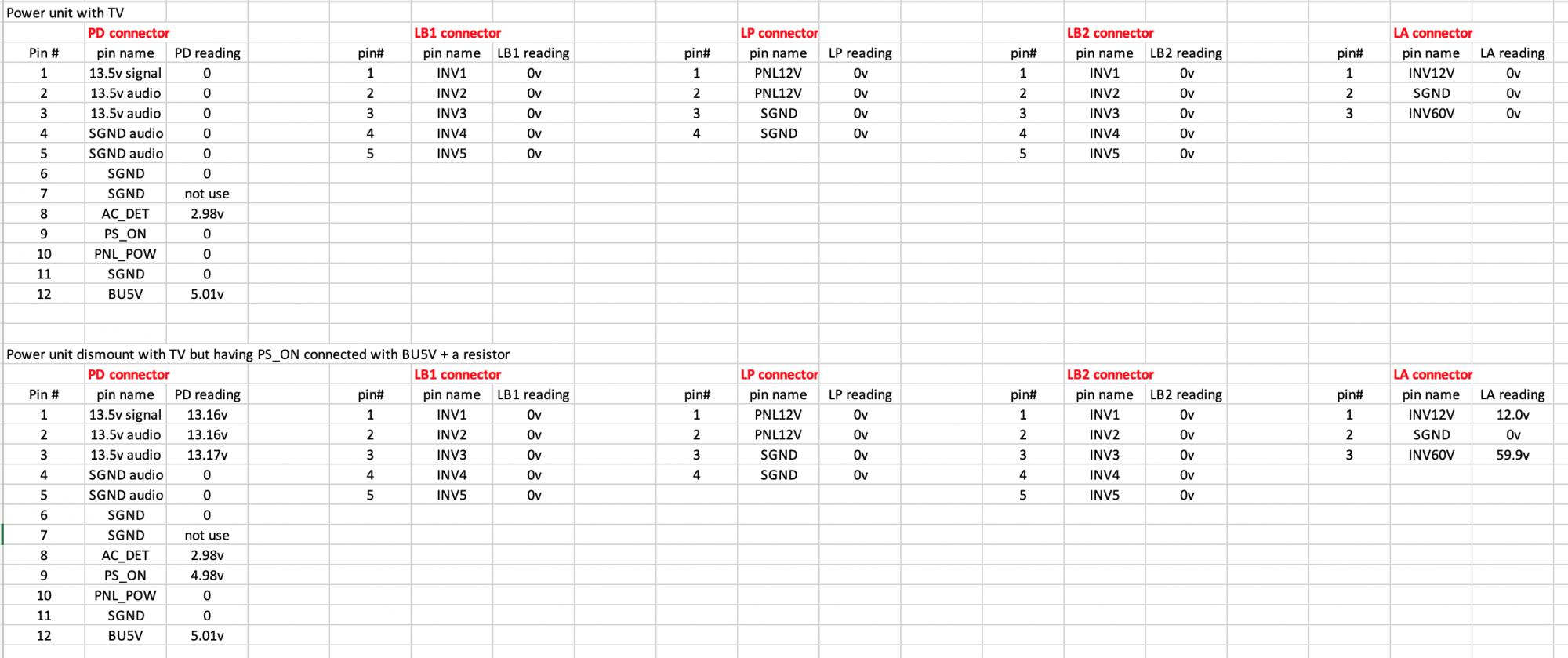

        another 1 pictures and reading of all connector.
        The volt reading is taking 3 different ways:
        1. The power supply unit is with TV
        2. The power supply unit is not with TV.
        3. The power supply unit is not with TV but pin 9 (PS_ON) and pin 12(BU5V) are connected with a 490ohm resistor.

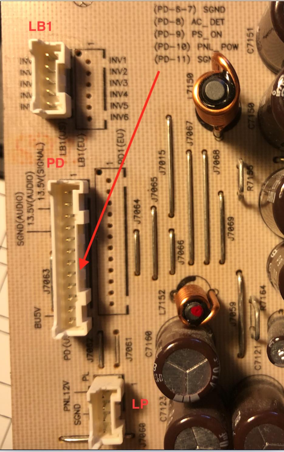

          Please look at this picture of the PD Voltage readings:
          https://www.badcaps.net/forum/attach...6&d=1597628463
          And then this picture (https://www.badcaps.net/forum/attach...4&d=1597628463) of the PD pin names and number as printed on the board, you can see that pin 1,2, 3, 4 should have 13V when PS-ON is present, you show pin 4 as Zero Volt.
          GND pin 8, , your report shows as AC-DET.
          AC-DET pin is pin 9, your report shows as PS-ON.
          PS-ON is pin 10, your report shows as PNL-POW.
          BU5V is pin 11, your report shows as GND.
          PNL_PWR are pin 10 and pin 12, your report shows as BU5V.
          I suggest you put down pin names and pin numbers on your paper and then verify them with what is printed on the board.
          I also need close up pictures of LB2 and LA connectors so I can see what the pin names are.

            I re-write the voltage reading in excel and also enlarge the picture so the printed name can be seen. Just head up, beside the power & OPC light flashing, the power relay clicks on and off when the AC power plugs. And also there has same voltage readings on either the power supply unit with TV or dismounted with TV.
            Is this power unit having 12 volt and 5 volt when the TV is on standby.
            Thank you for helping me.

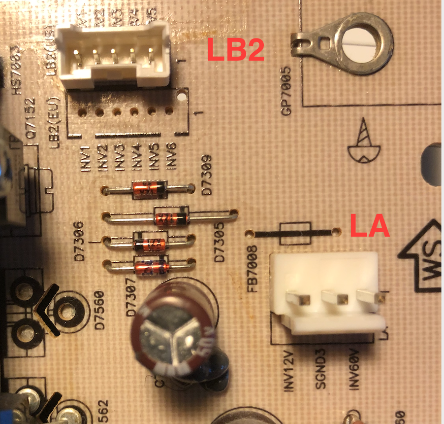

                    I still need to find out what the 'INV' pins of the LB1 connector are for.
                    "I will test the voltage at pin1(INV12v) of LA connector as the pin 10 (PNL_POW) connects with pin12 (BU5v)."
                    You will look for 12V at PNL12V pin of the PL connector when you jump PNL_POW to BU5V

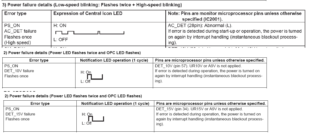

                                  Press Vol (-) + Input and plugs-in AC, then Vol (-) + CH (dn) for awhile to enter Service Mode but nothing happen on Service Mode, still has flashing error code.
                                  Press Vol (+) + CH (DN) and plugs in AC, only the power light on, no flashing error code.
                                  Tried different combinations ( input, menu, CH, Vol) suggest from Sharp's service menu, but nothing is working except the error code flashing.
                                  I traced the INV1 to INV5 on LB1 and LB2, both LB1 and LB2 are passing through power unit, nothing to do with the PSU.
                                  I checked the meaning of error code 2 power + 1 OPC, it indicates that PS_ON failure because of AC_DET : abnormal.
                                  Right now, I am trying to confirm the problem on PSU then I will order PSU replacement.

                                    Can I see close up pictures of the inverter board when the LA connector form the power supply board is connected too? I can see the pinout names on the inverter board.
                                    Right now we know that the simulate PS-ON can turn on the power supply but some how when all the cables are back in place, the PS-ON does not go high.
                                    AC - DET signal at this point we do not know if normal incoming AC Voltage AC DET should be HIGH or LOW. The AC-DET is used for checking the incoming AC Voltage level, if the Voltage get too low the TV will draw to much current so it tells main board to stop sending the PS-ON to the power supply.
                                    We can try grounding the AC-DET line on the main board side by disconnecting the AC-DET wire form the connector first then use 100 Ohms resistor to ground the AC-DET pin receiving side of the main board to simulate AC-DET LOW and see if the error code goes away or not.

                                    Where did you get that PS-ON AC-DET error description from for this TV model?
                                    The reason I ask because the same blink codes are not the same for all models
