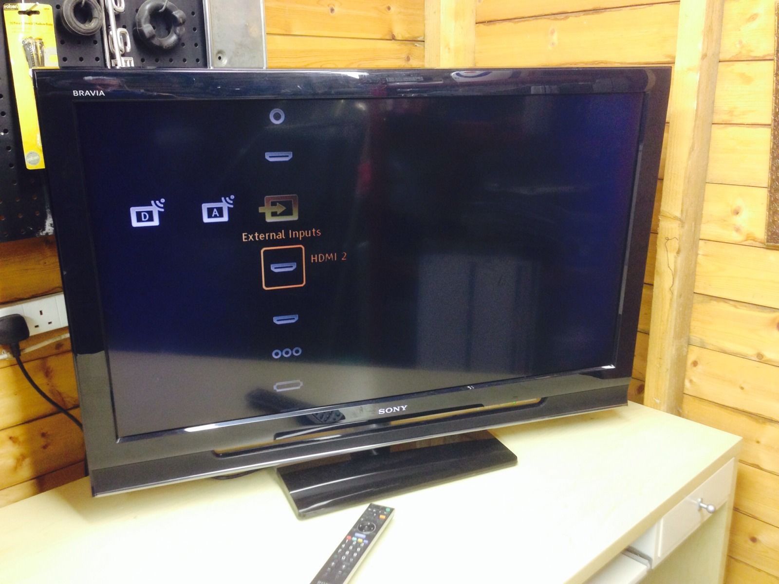

    hi all
    im thinking this one is a bad tcon / lvds however it looks as if the picture comes back again towards the edge of the right hand side can i ask what you think ?
    ta

    Re: Sony 40" bad panel or tcon
    Originally posted by noledud
    hi all
    ta
    bad panel most likely tab bond fault
      Yep, as above. With some DIY it could be fixed albeit temporarily.
