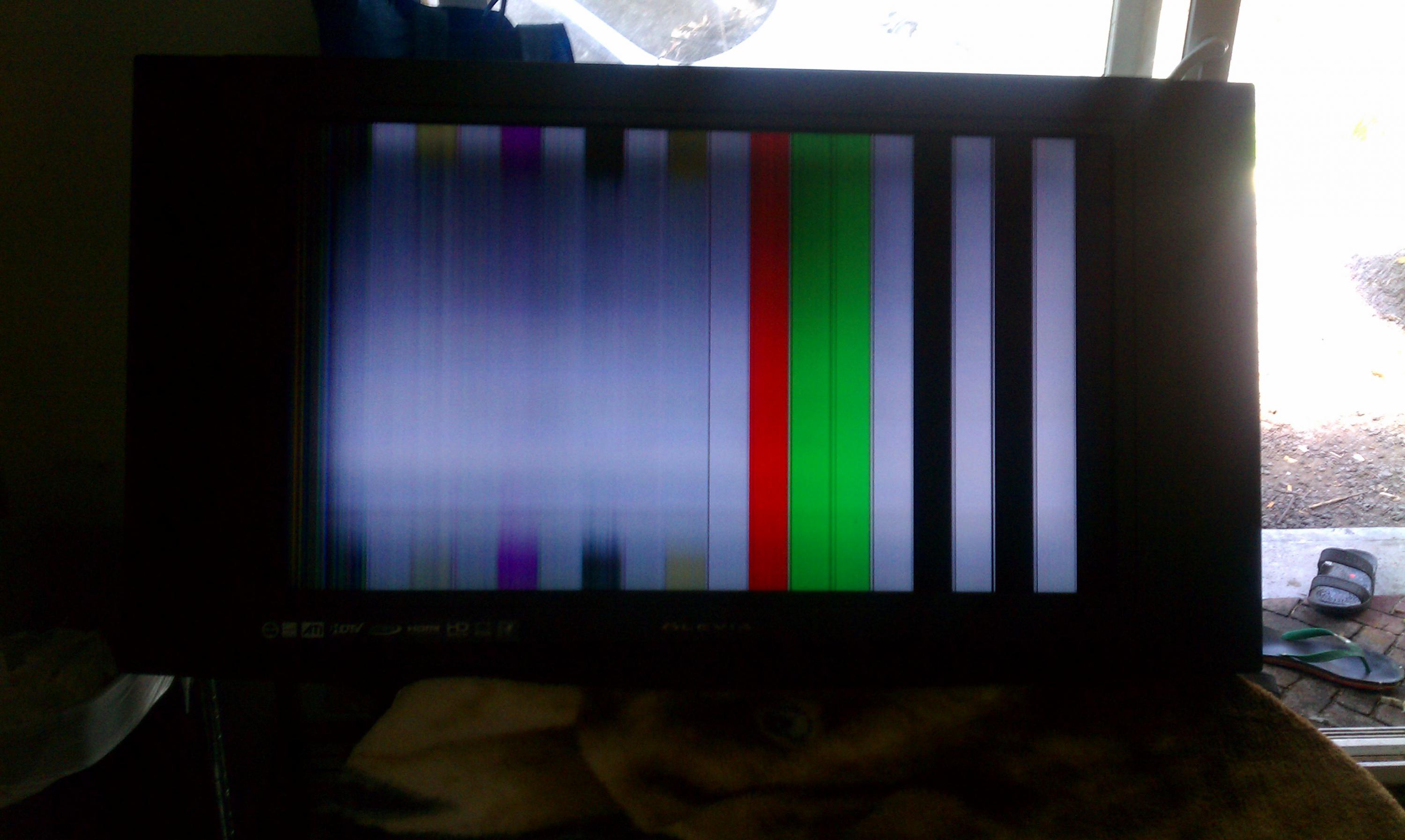

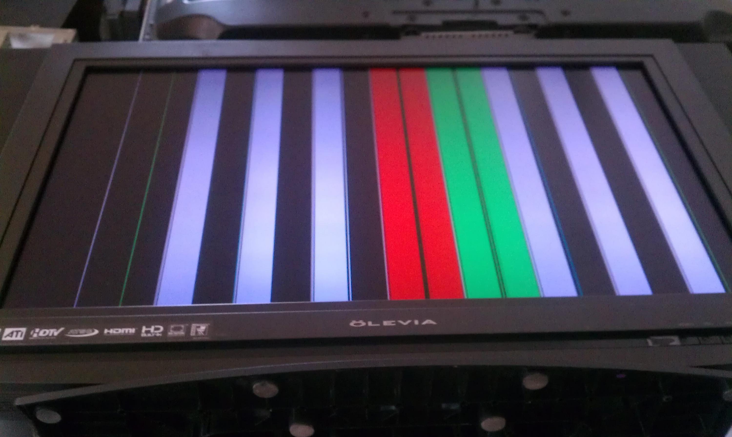

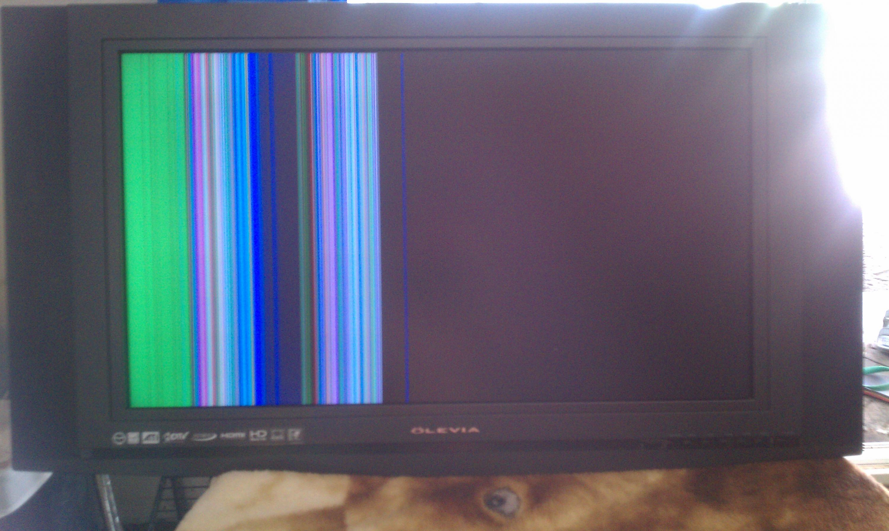

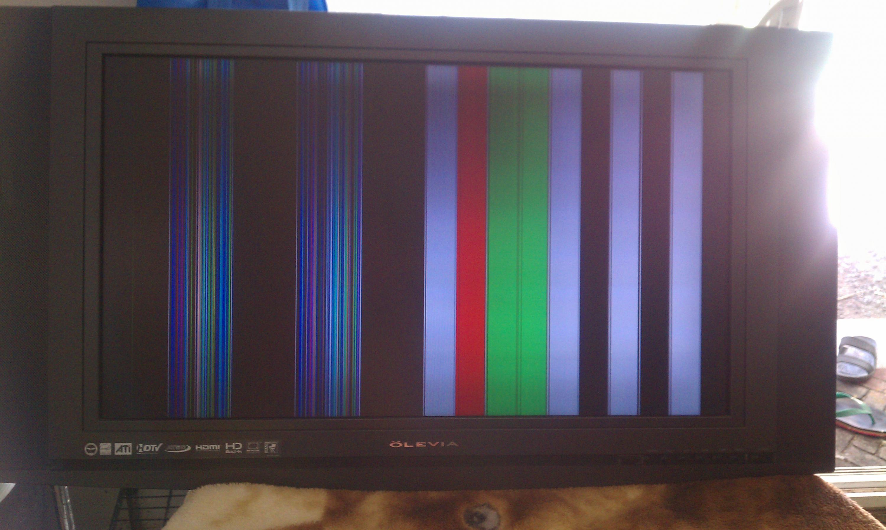

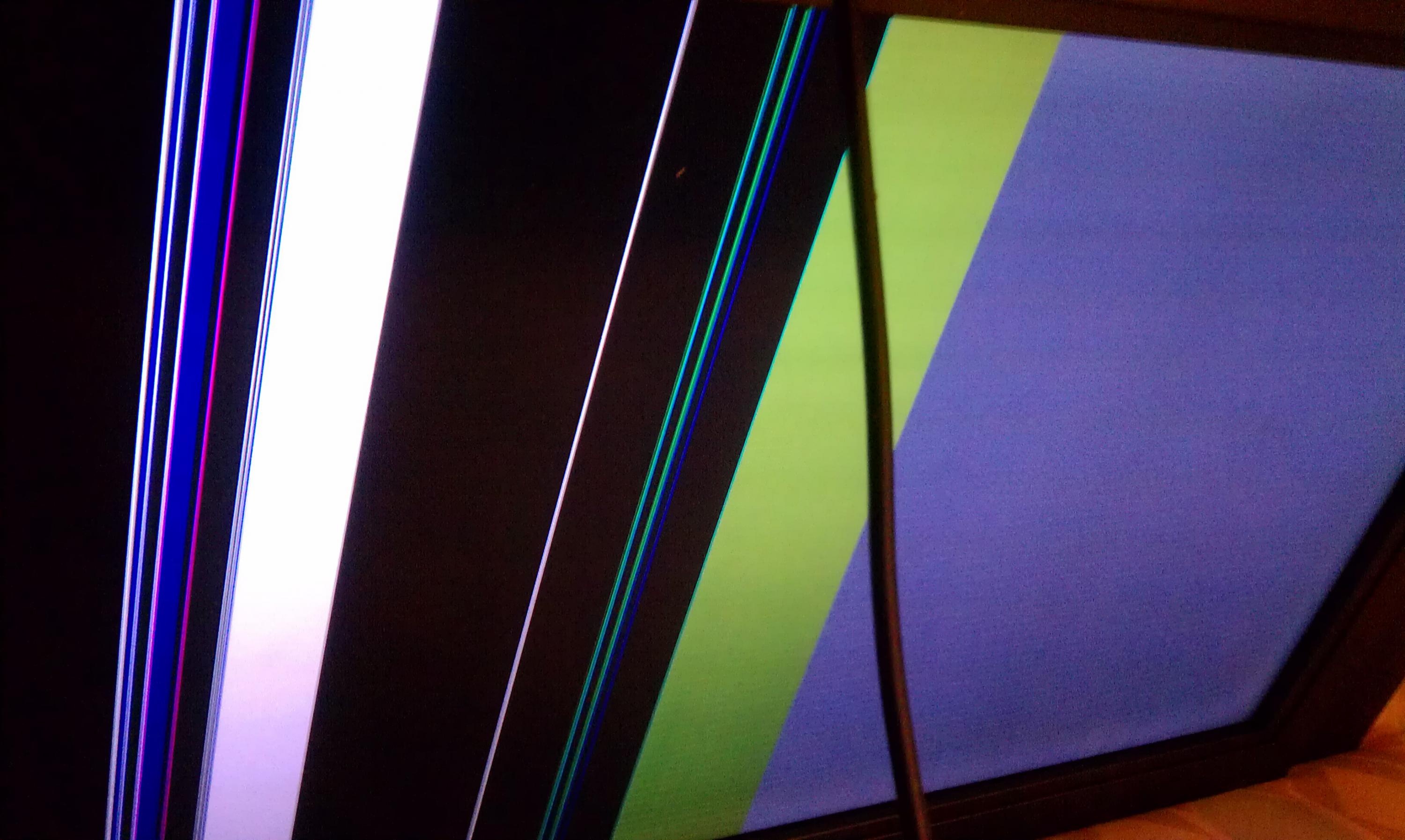

                  Re: OLEVIA 232-S13 black screen slowly fades to vertical colored bars
                  ok i tried disconnecting one side of the tcon at a time...
                  pictures of what it looked like:
                  Don't fear the repair...
                  • Shinju
                    • Mar 2014
                    • 1239
                    Hard to see whats going on as the picture is so close, but the first one looks like a possible bad panel.
                    Can you get a distance shot?

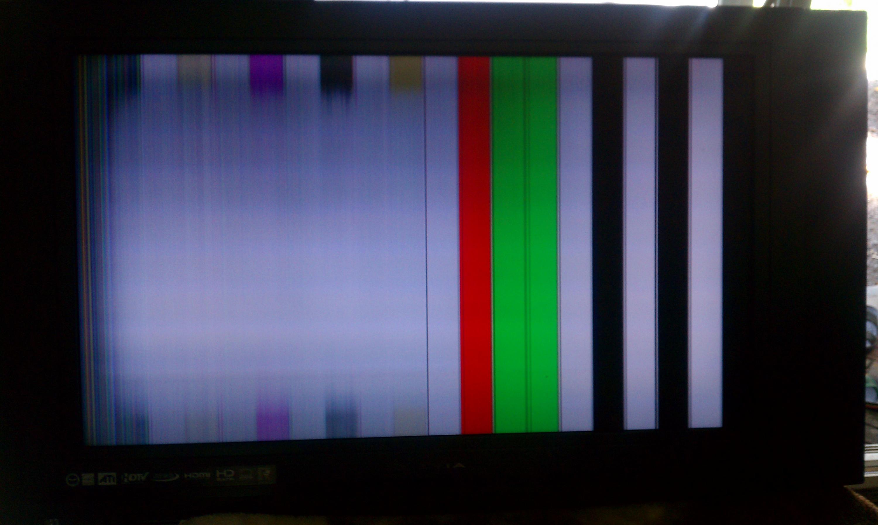

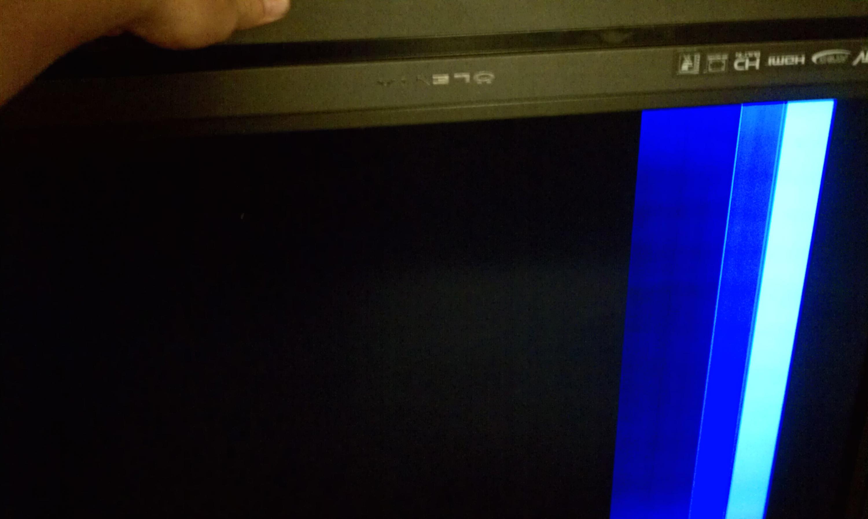

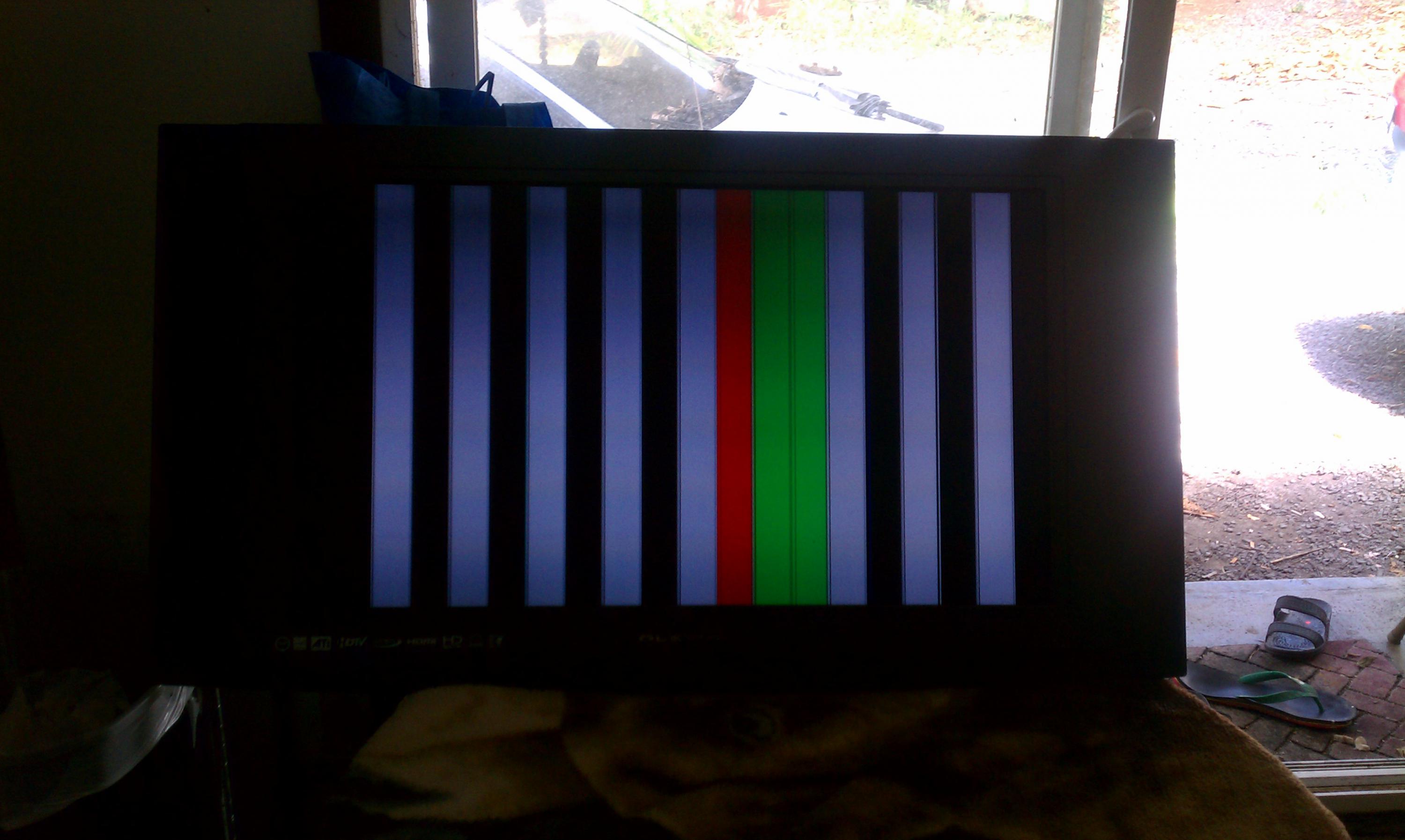

                      ok heres the pictures
                      1. both cables connected
                      2. left side disconnected
                      3. left side disconnected
                      4. both cables connected again (left side looks different than in pic 1?)
                      5. right side disconnected, left side is also "moving slightly"
                      so whats it look like? i already know i have a motherboard problem because i cant get any sound to come out when i switch sources...
                      starting to feel like i got a lemon on my hands here

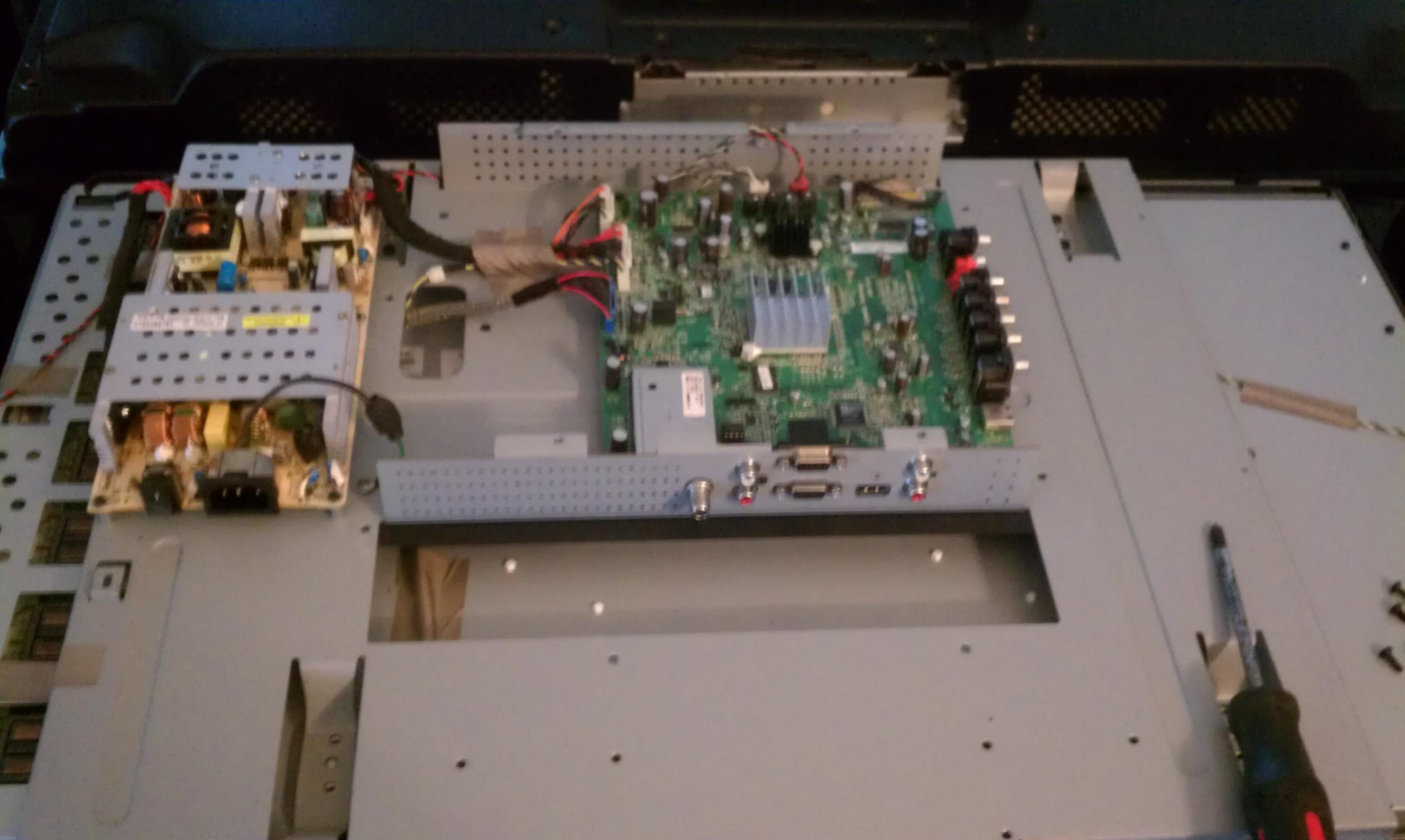

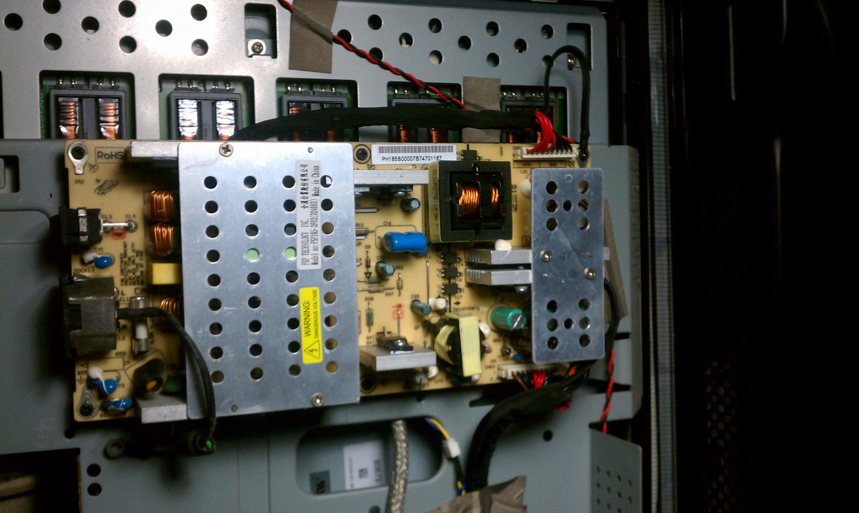

                            Good luck - mainboards are notoriously hard to fix. Check the voltage regulators if any and fuses if any then try heating the main ic with a hairdryer see if anything changes. Beyond that if nothing is visibly wrong then there isn't much you can do.

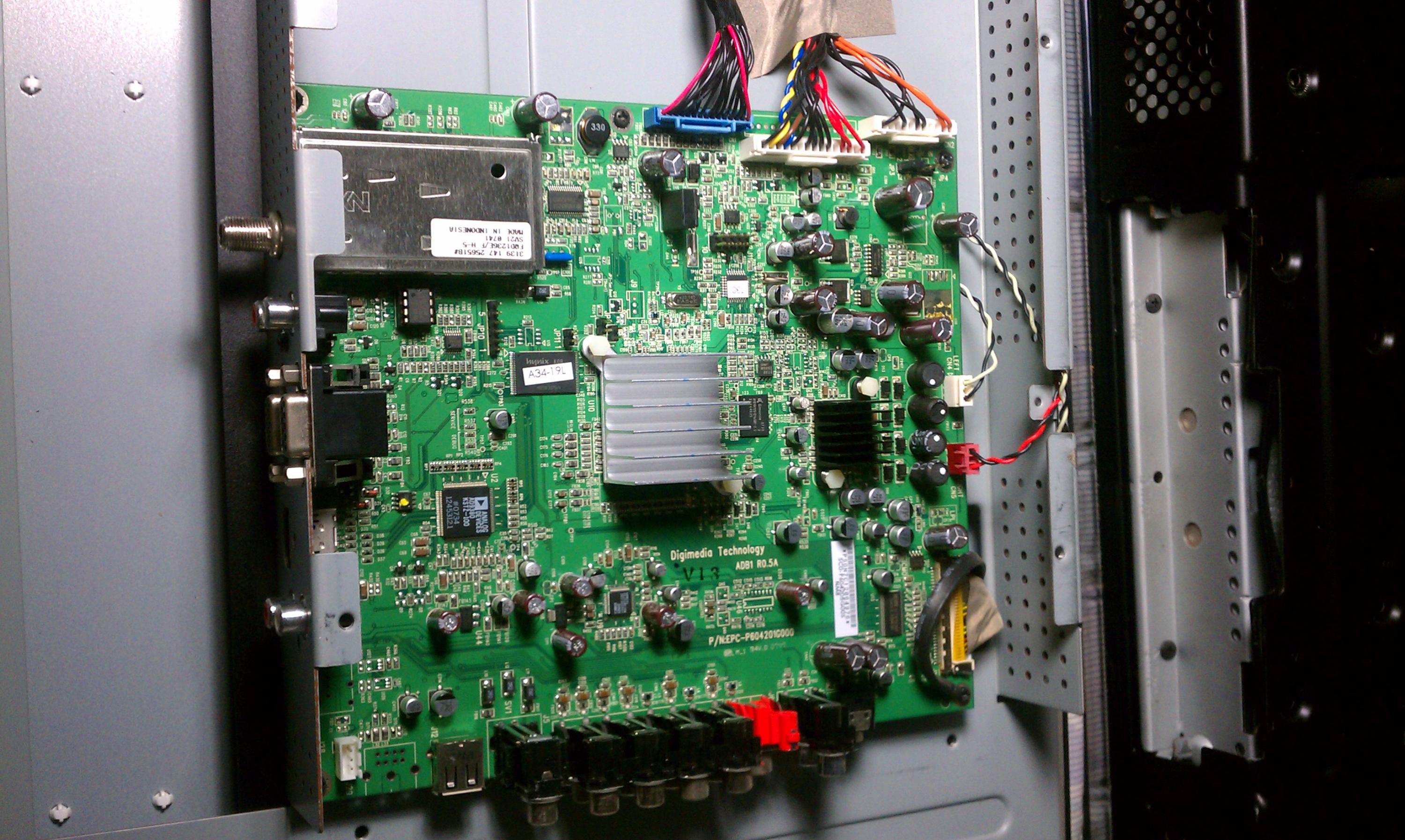

                              • triplefour
                                • May 2014
                                • 1747
                                i decided to buy the mainboard anyway since it was cheap ... now i get sound when i change source but i just get a completely black backlit screen....
                                is it possible i had a bad motherboard AND tcon?
                                or is it possible that this motherboard is bad...
                                how do i tell? because if its bad i only have 14 days to return it

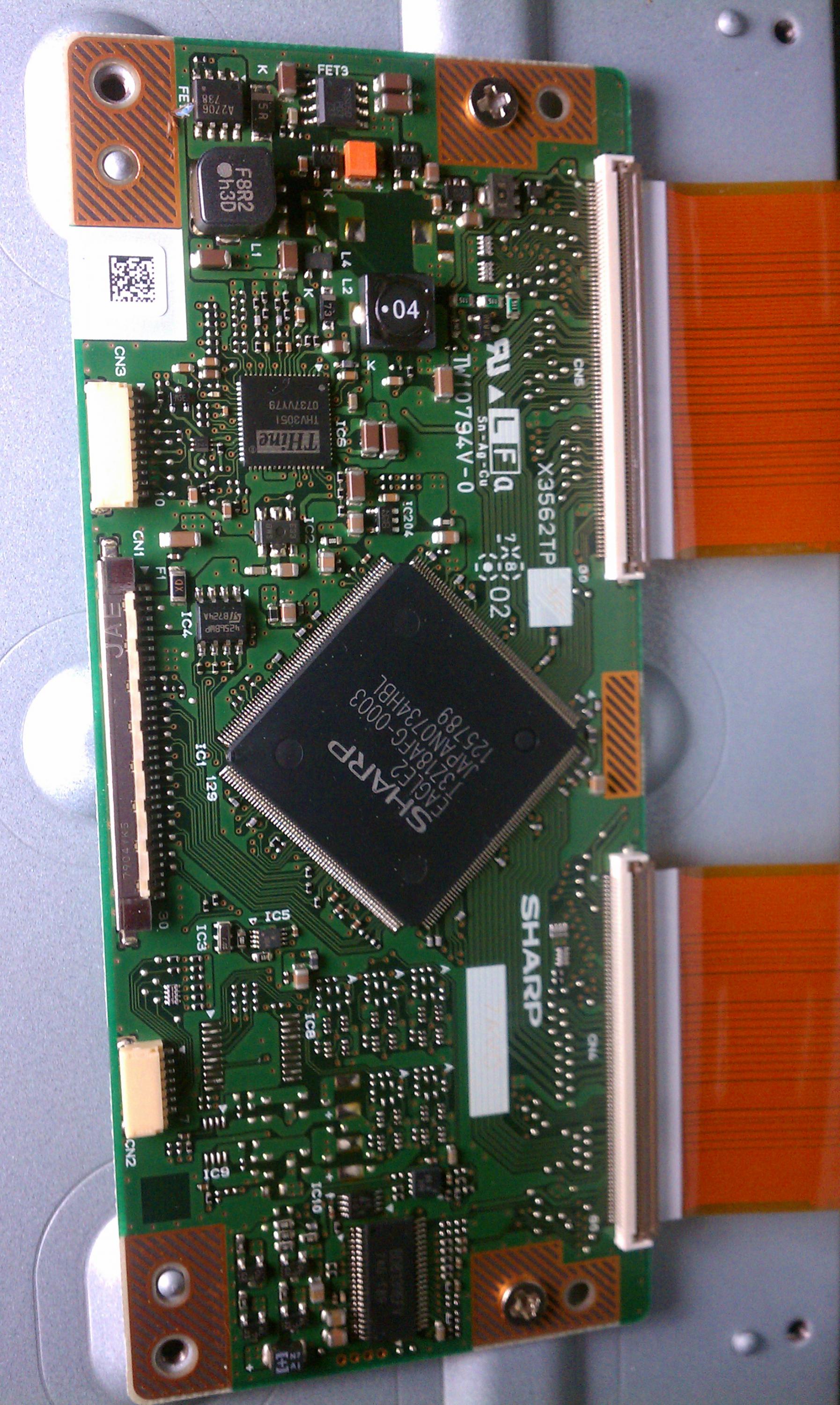

                                  any ideas on a quick way to determine whether its TCON or Mainboard?
                                    I put a bet on panel fault.
                                    • triplefour
                                      • May 2014
                                      • 1747
                                      well i found a TCON for 9 bux so we'll know soon enough. care to wager any money on that bet?
                                      • Shinju
                                        • Mar 2014
                                        • 1239
                                        Sure! if I win you ship me one of your Vizio 32" Plasmas! /wink
                                        My bet is panel.
