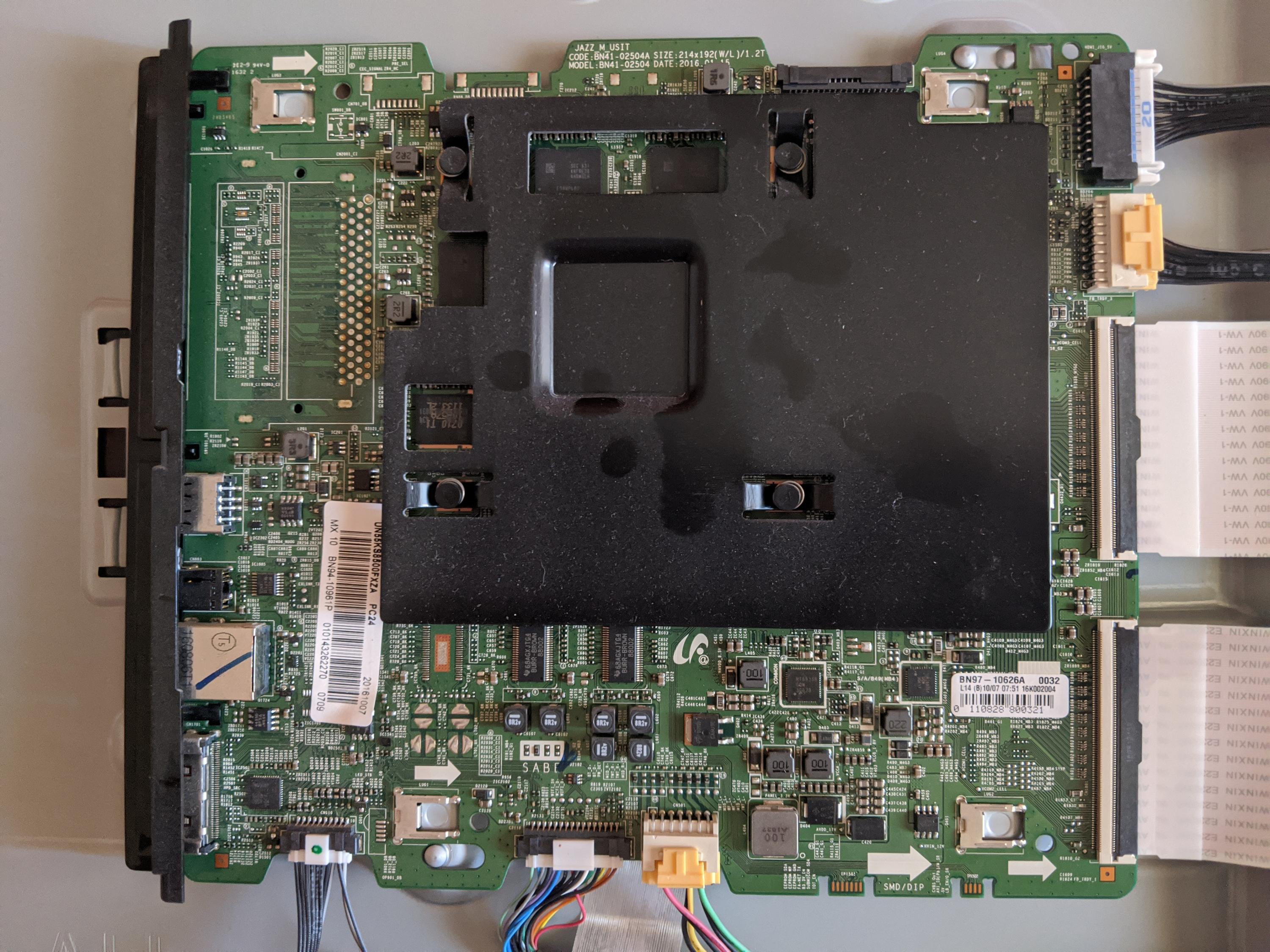

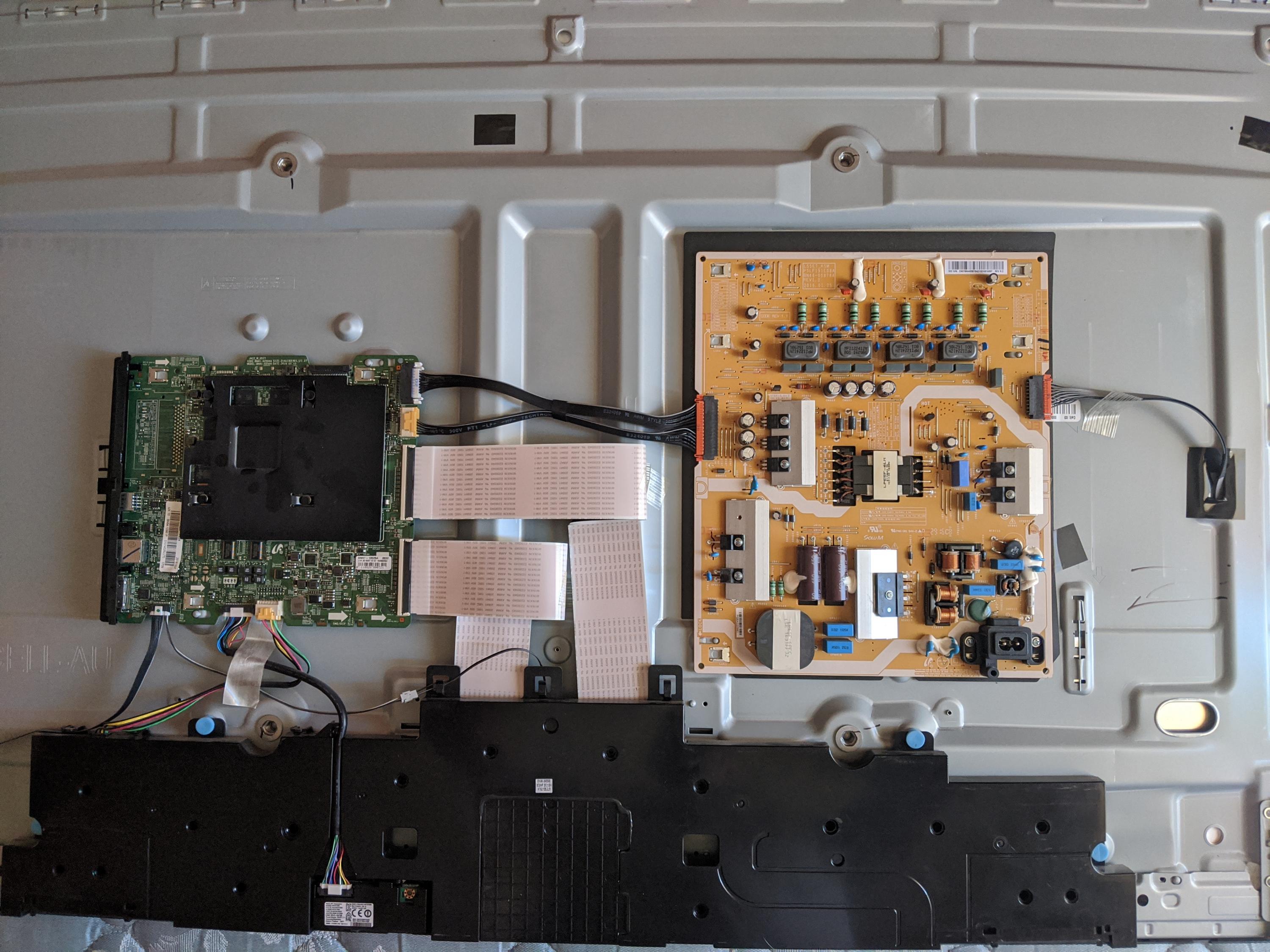

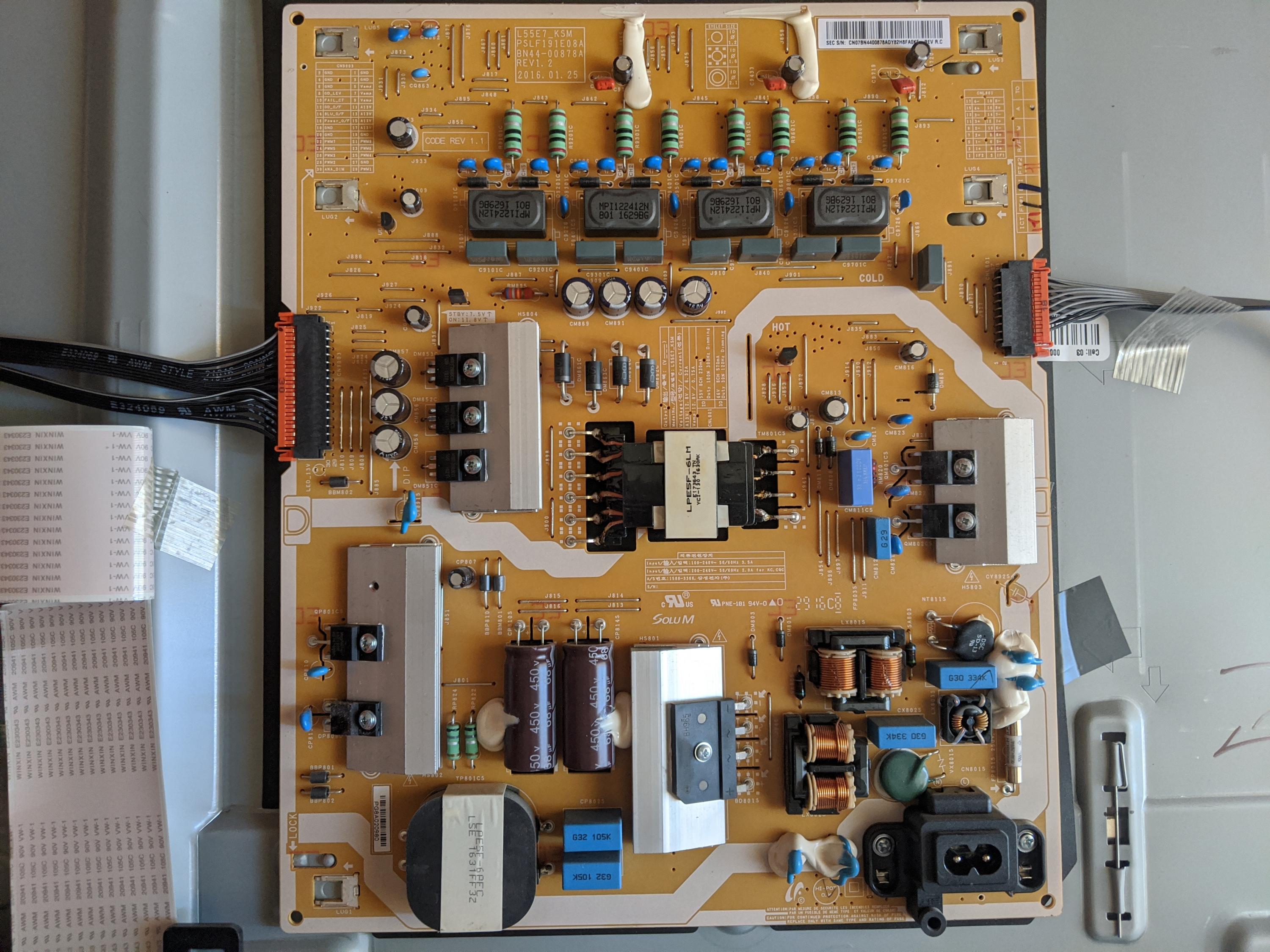

    First, can you remove the back cover and take pictures of the TV set, the power supply and the main board!
    • morinb
      • Jul 2020
      • 4
      Re: Samsung UN55KS8500 - previously power-cycling, now vertical colored bars
      Hi, thanks for the reply! I've attached some pics to this post - let me know if any others might help.
        you still have shorted ceramic caps on the boards you repaired before or burned PCB printing line. need to inspect it and other half side too carefully
