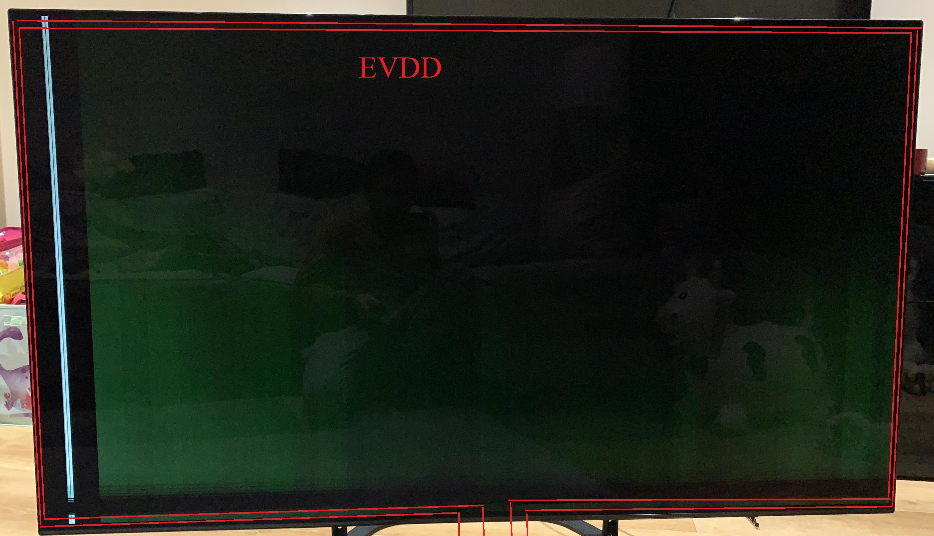

      Summary (correct me if I'm wrong): Problem either with TCON (it's getting the proper voltages - and replacement is on the way) or Panel (not fixable) - The best course of action is to replace the TCON and if not fixed, then it's panel. Nothing more can be done on the panel beyond the capacitors checks.
      Now when I received the TCON, I'd appreciate the help on the "pairing process" as what was mentioned with green / blue lights don't seems to correlate with my TV
      i mean the Caps area which have low R. need to measure V on them
      well even the service manual say t-con or panel.. and i think its panel.

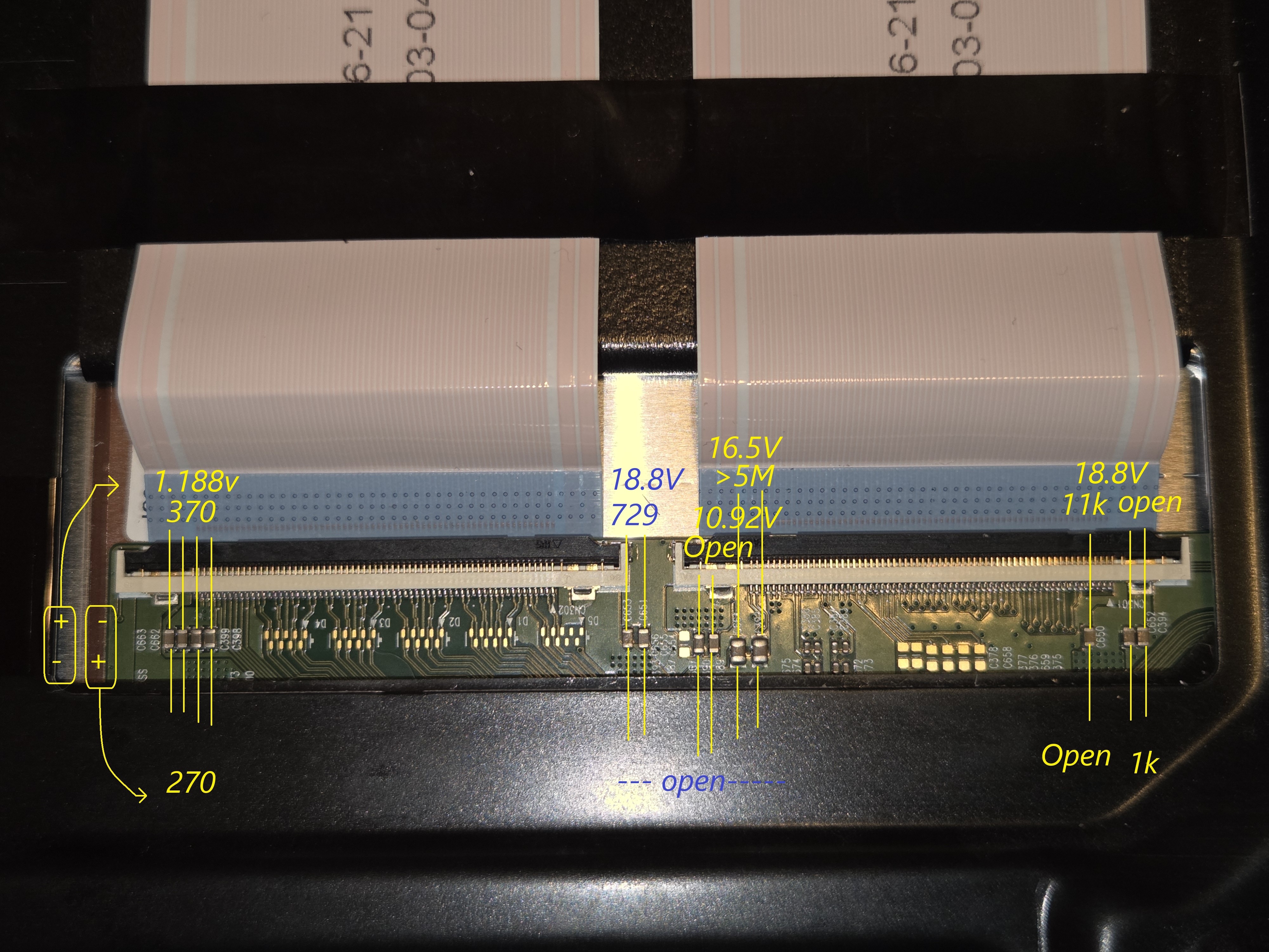

          So say 19v evdd, the resistance of ~200ohm that's less than 100mA... that seems reasonable. Why would you think they're too low?
          Voltage at black connector is roughly 19v, but at the caps that are low, voltage is 1.2v or so... not sure if tcon is limiting power, or if that's expected? Without schematic I guess it's tough for me to assess?
              you have another 3 EVSS on buffer boards.. compare them then you know why i said panel

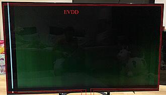

                      for you and other maybe... on Buffer boards there are COFs and EPROM with VCC 3.3V.. EVSS which we called are belong to EVDD which PSU supply it.. they are running round the panel .. any break or short at cell raw T-CON driver boards will register it as error.. we talked on this before..
                      Display lit dim white this is first time i saw over OLED.. but it could EPROM damaged or its VCC.. if you try other T-CON and the issue same... don't trash it.. just cut the metal over buffer boards we will fix it.

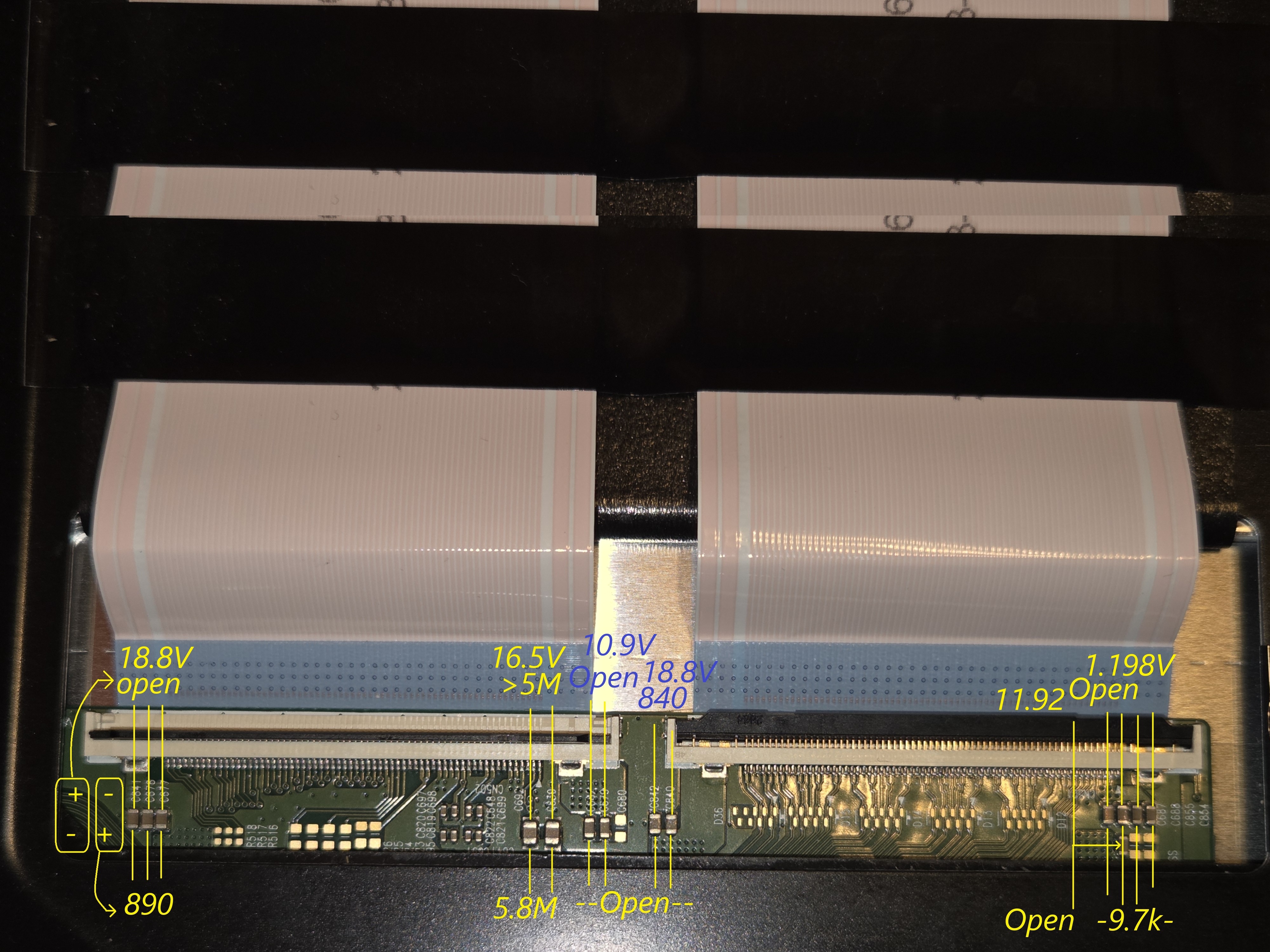

                                So out of curiosity, I measured the voltage across the exposed capacitors on the panel. Help me understand the result. I'm getting almost an exact mirror from the left 2 to the right 2. So if there is a short, I would expect to see something different? What in these results tells you it's a panel problem? Again, just trying to understand your reasoning
                                • Diah
                                  • Feb 2013
                                  • 6497
                                  #96
                                  its may mean many things, buffer boards ( could be fixed ) or gate Transistor shorted inside the glass (rubbish)
                                        But not tcon... right?
                                        And what in the reading is telling you something is indeed wrong in the panel? What should the reading be? You said compare and you'll see it's panel. Trying to understand that statement
                                        before going to answer..i read your first post measurement, so i would like to be sure, if you only the PSU test it as stand alone with out the T-CON and Panel or MB... did the EVDD rail go higher than 18.8V when t-con connected
                                          No, with the TCON & Panel connected, I get 18.84 /18.85V (fluctuating) on EVDD. Disconnecting Tcon board and Panel- no change to EVDD.
