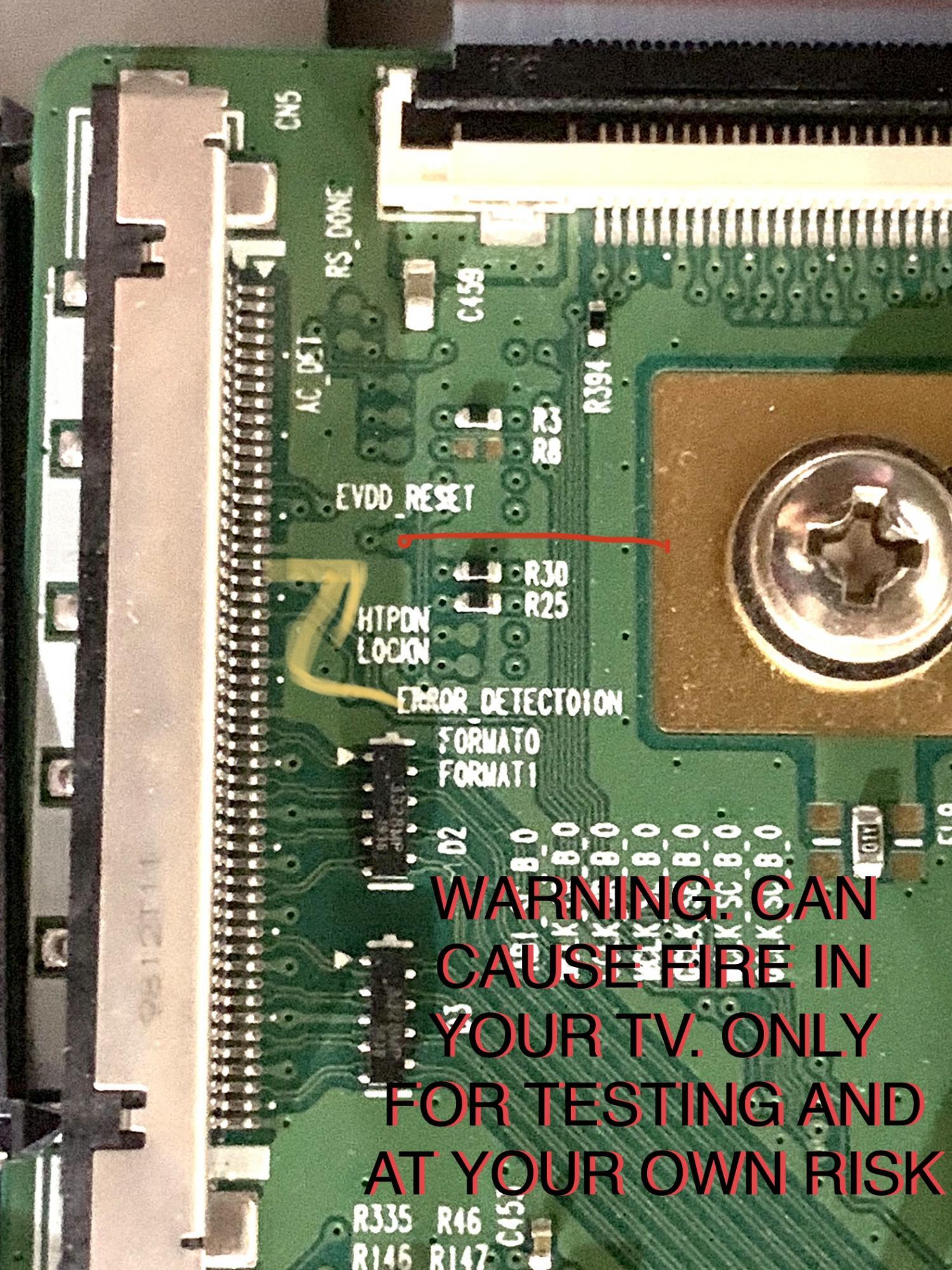

    Originally posted by lotas
    Actually, the "ERROR DETECTION" pin is in a completely different place, don't burn the T-CON.
    So add a jumper (short) the error detection test point to mounting screw? What was the first test point you had a triangle on in post #38 ?
    • Diah
      • Feb 2013
      • 6484

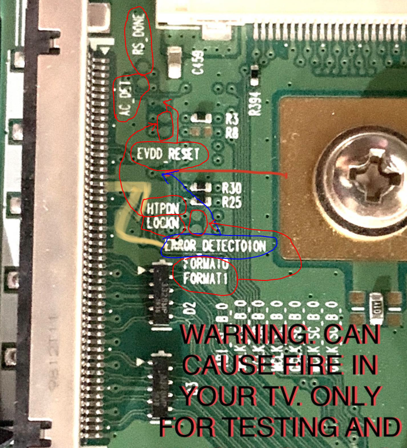

      #42
      hahaha now Lotas... you are wrong the points are no 12 after the ESD Diode... we have threat on it..
      this is original threat photo look with glasses and compare. other wise keep silent as other.

            #45
            Click image for larger version  Name:	3C97CAAC-C441-4FBA-8EC1-64D7E56A0AED.jpg Views:	0 Size:	497.0 KB ID:	3755852
            If you don't understand the checkpoints, then we'll wait for your experiment!

                              #54
                              And following this advice (photo), you short-circuited the "EVDD RESET" to ground!

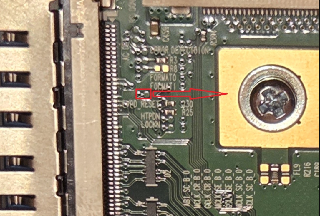

                                #55
                                And according to this photo, everything is correct, "E.D." matches.

                                      #58
                                      you are stupid person at OLED ..like others from Italian
