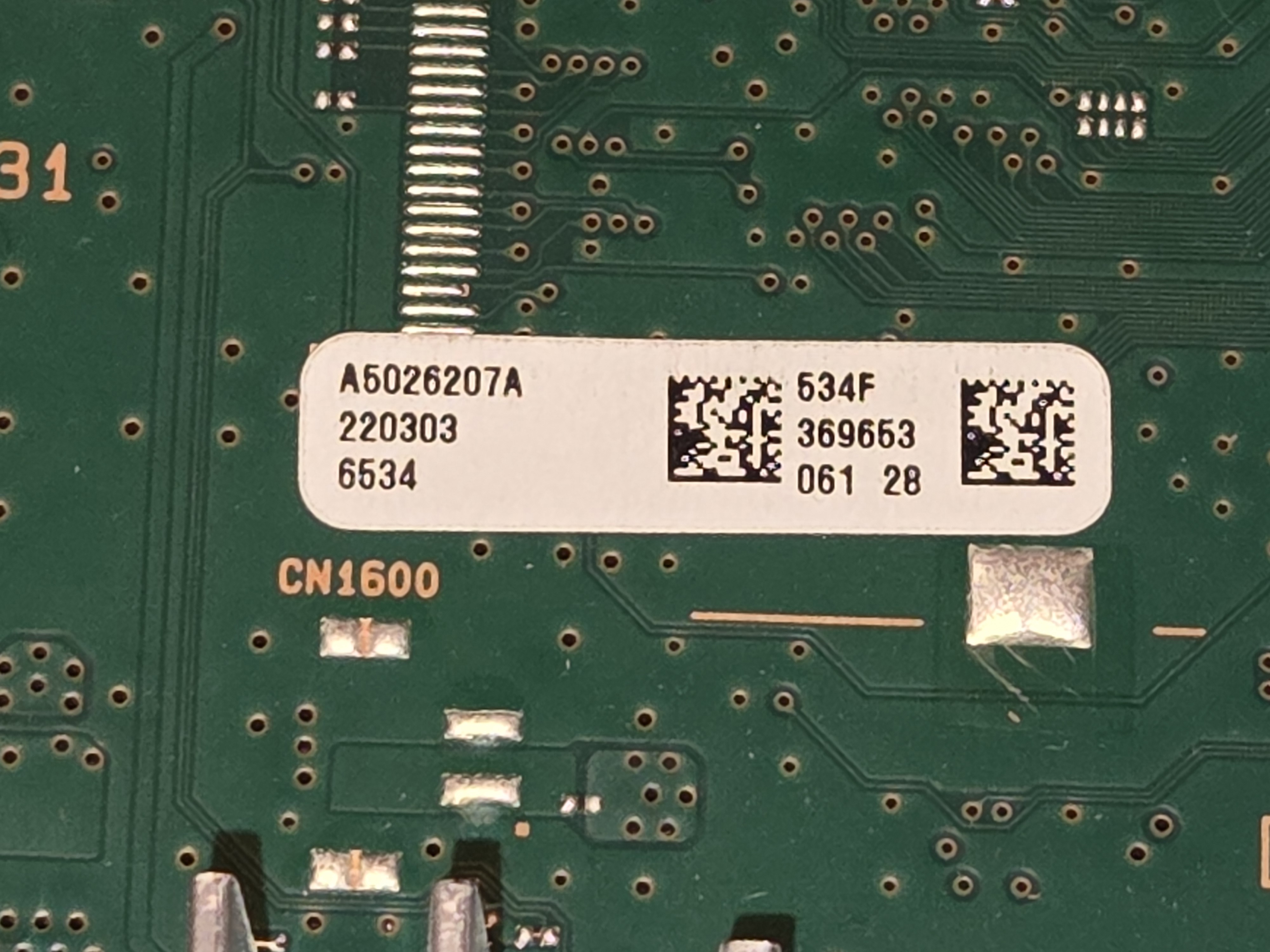

    so you returned both main boardL/tcon? Are you sure it was the rigut one and not the original one?
    • jason123
      • Oct 2015
      • 1111
      #62
      I am not sure. The previous owner bought these cards and he said they didn't work. I don't really know what he did. But I can't imagine he returned the wrong card and still he got his money back.

        i suggest a service manual search to try to get information on correct part numbers of the boards..
        • jason123
          • Oct 2015
          • 1111
          #64
          Unfortunately, the service manual is no help. https://research.encompass.com/SON/rr/XR55A80J.pdf
          Looking at SJ, it lists the correct main board (A5026207A) matching mine, but for TCON, they list 6380E while the one in my set is 6380F - But I'm not sure if this is a later model or if 6380E is the only compatible (all other numbers on the TCON - LE550PQL(HP)(A4), 6870C-0848C ... match)

            I took a look at shop jimmy, for the main board sticker there are more letters than what you write on an example picture, and also so in the SJ item page title..

                Can you post your main board sticker?
