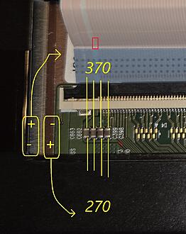

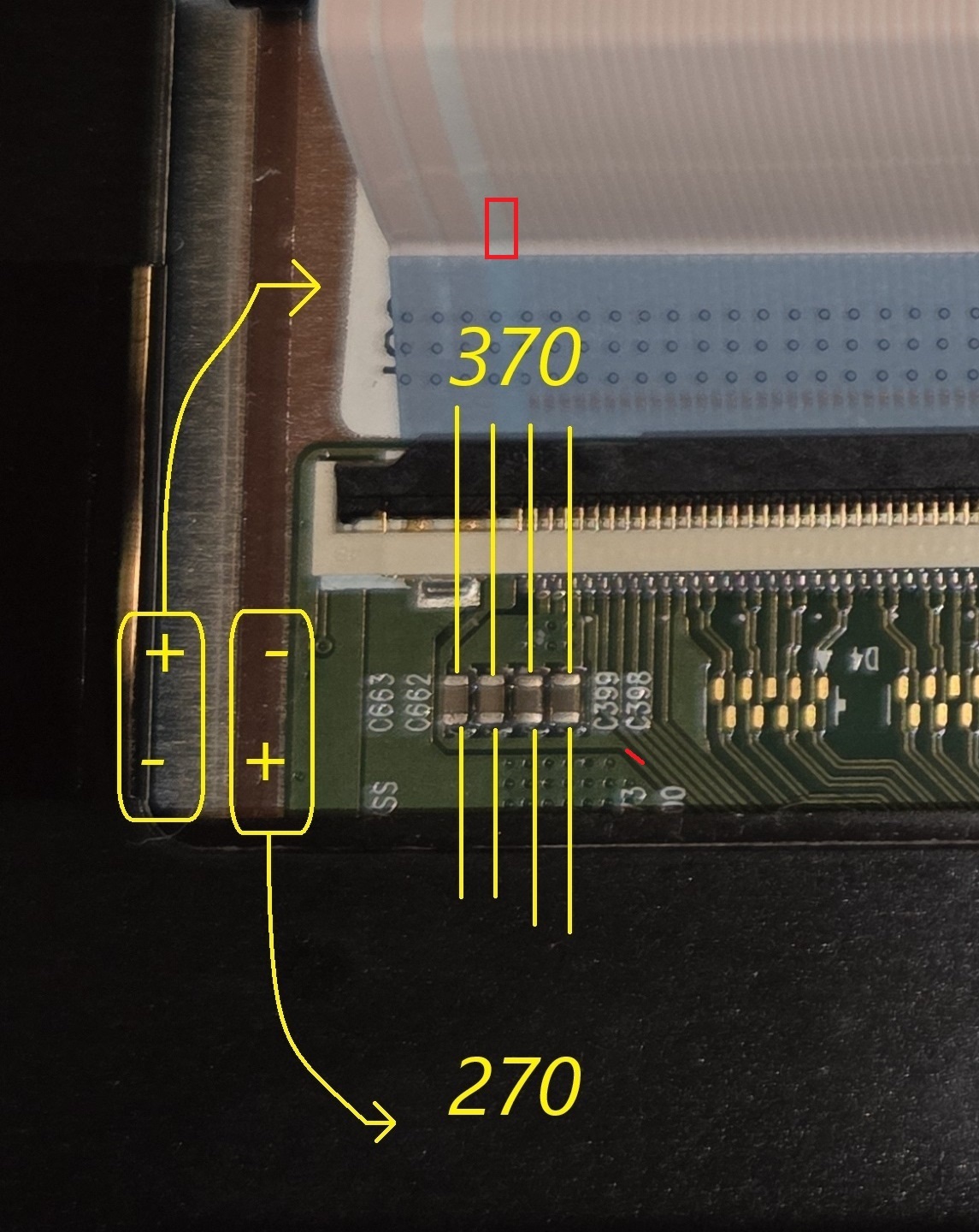

      Originally posted by jason123
      Unfortunately, all these 4 caps are good. High impedance when removed and board still has low impedance.
      you need to cut the black plastic inorder to explorer the rest of this EVSS part on this side.. about OLED Module Tester will work on yours set.. i think any repair shop should have one under his hand.. its cheap, however it can be SIY to make one
      also you can try the hard reset i explained before after you disconnect only the lower LVDS., so yours set will remain on
      Align T-CON will generate white green LED blinking ..
          Alight T-CON will generate green LED blinking ..
          Seems the material is aluminum not plastic on this model ?
          Unfortunately, no TV repair shops in my area within 50 mile radius at the end of the day, the "Jig" will force a signal to be sent to panel. so if I don't get a signal, I'm still unsure if it's OLED panel or TCON issue? TCON is only $40-$50 and I can buy one and try it out?
          As I noted in the previous comment, I was not able to get "Blinking Green" on any other color on the front LED - now I only get 5 red blinks after doing test in #10.

            the fault are clear at Panel... you have same Caps position at other side and you did compare them.. the hard reset i suggested just to clear error at MB and T-CON
            unplug the lower LVDS only turn on the Optik will lit red and remain on.... plug the set from wall, do the pressing on Power then plug in wall remove until white change green... give time
