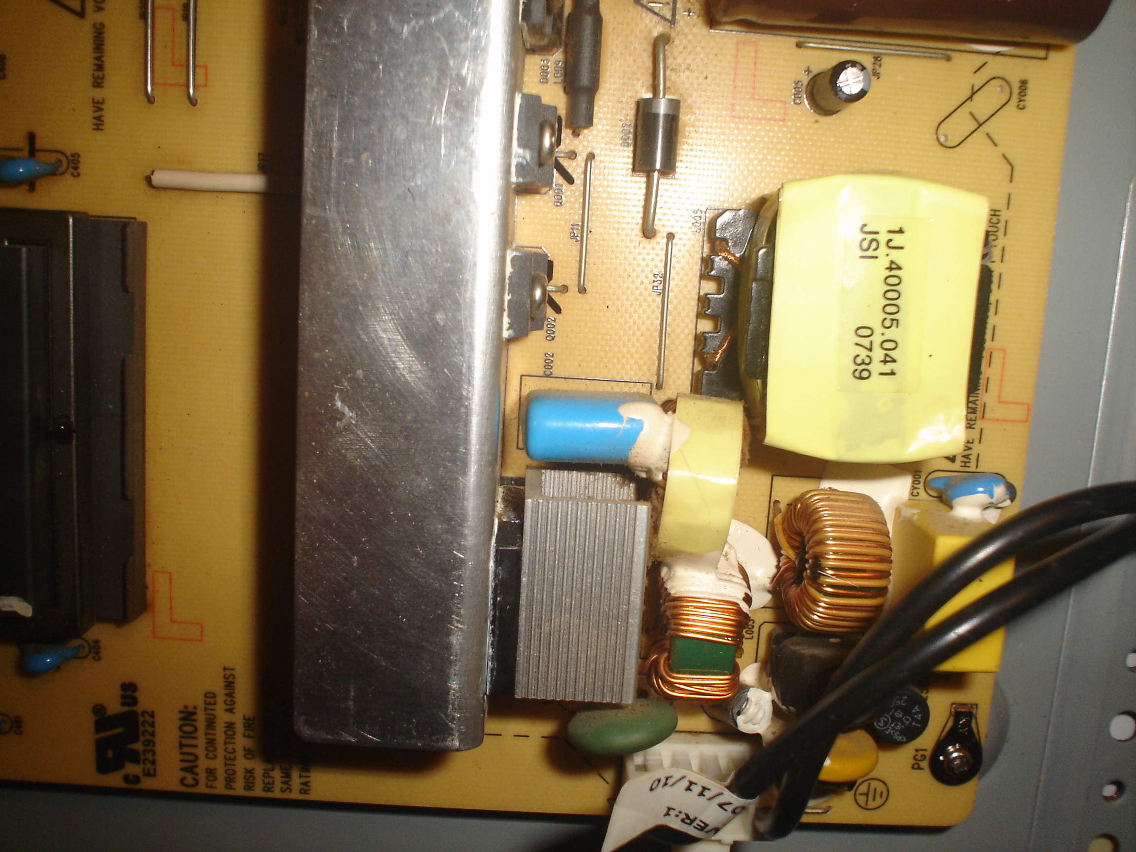

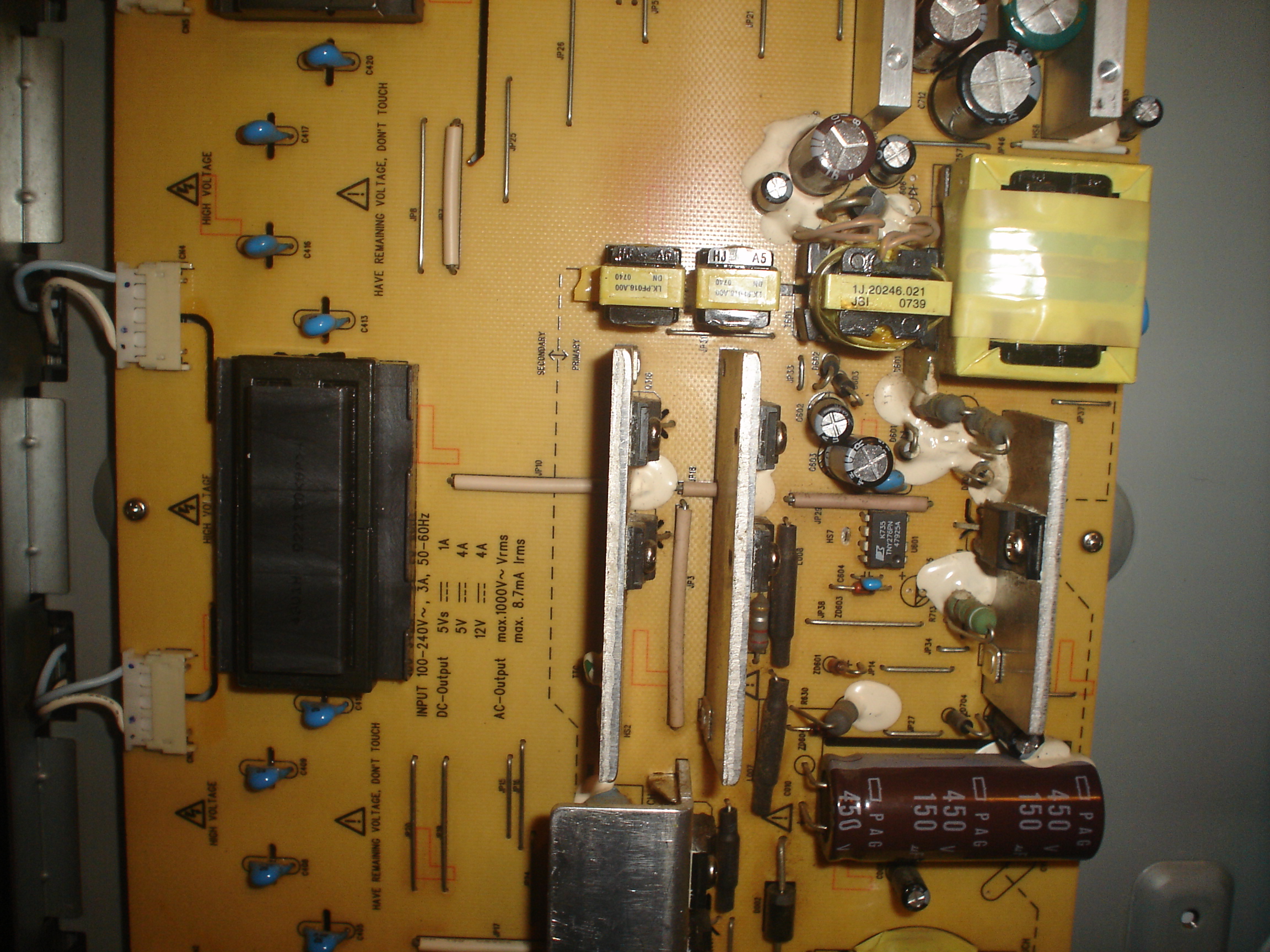

            Re: Westinghouse SK-32H240S Sob story with a Darfon board

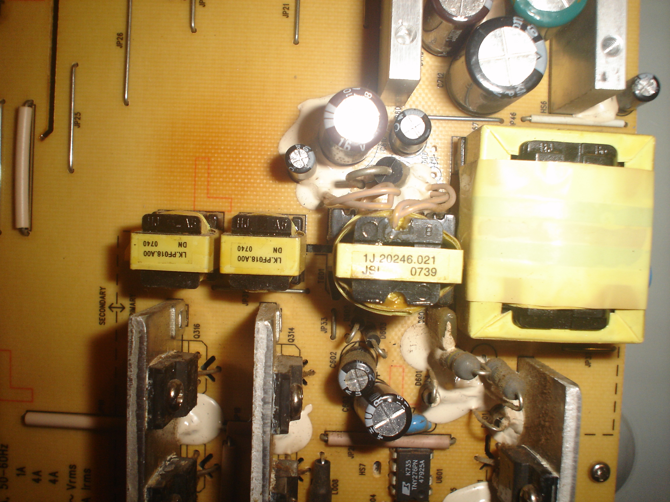

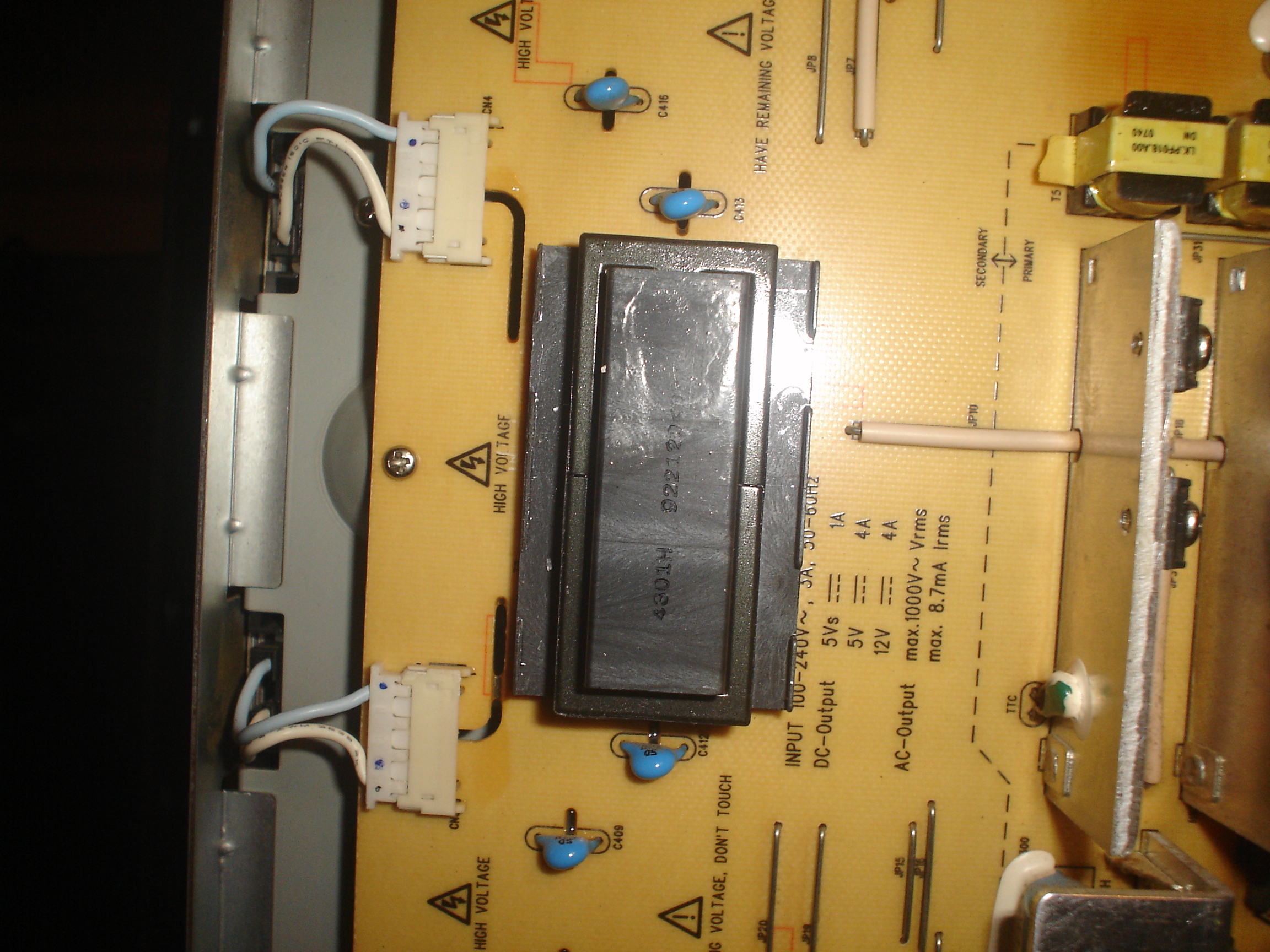

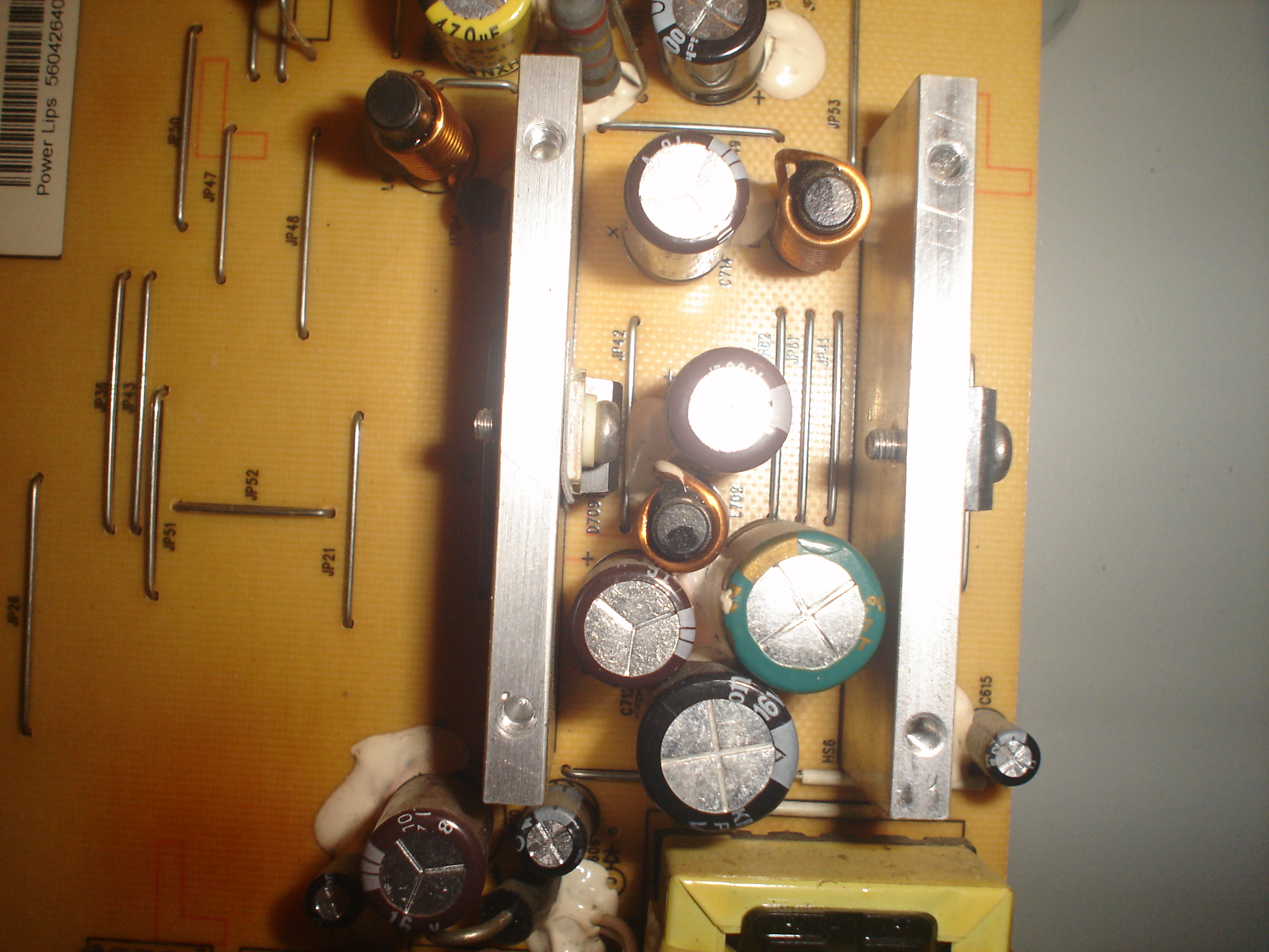

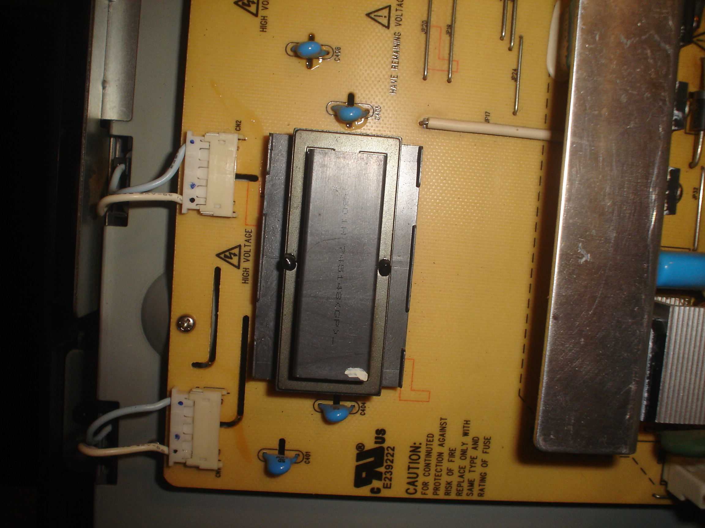

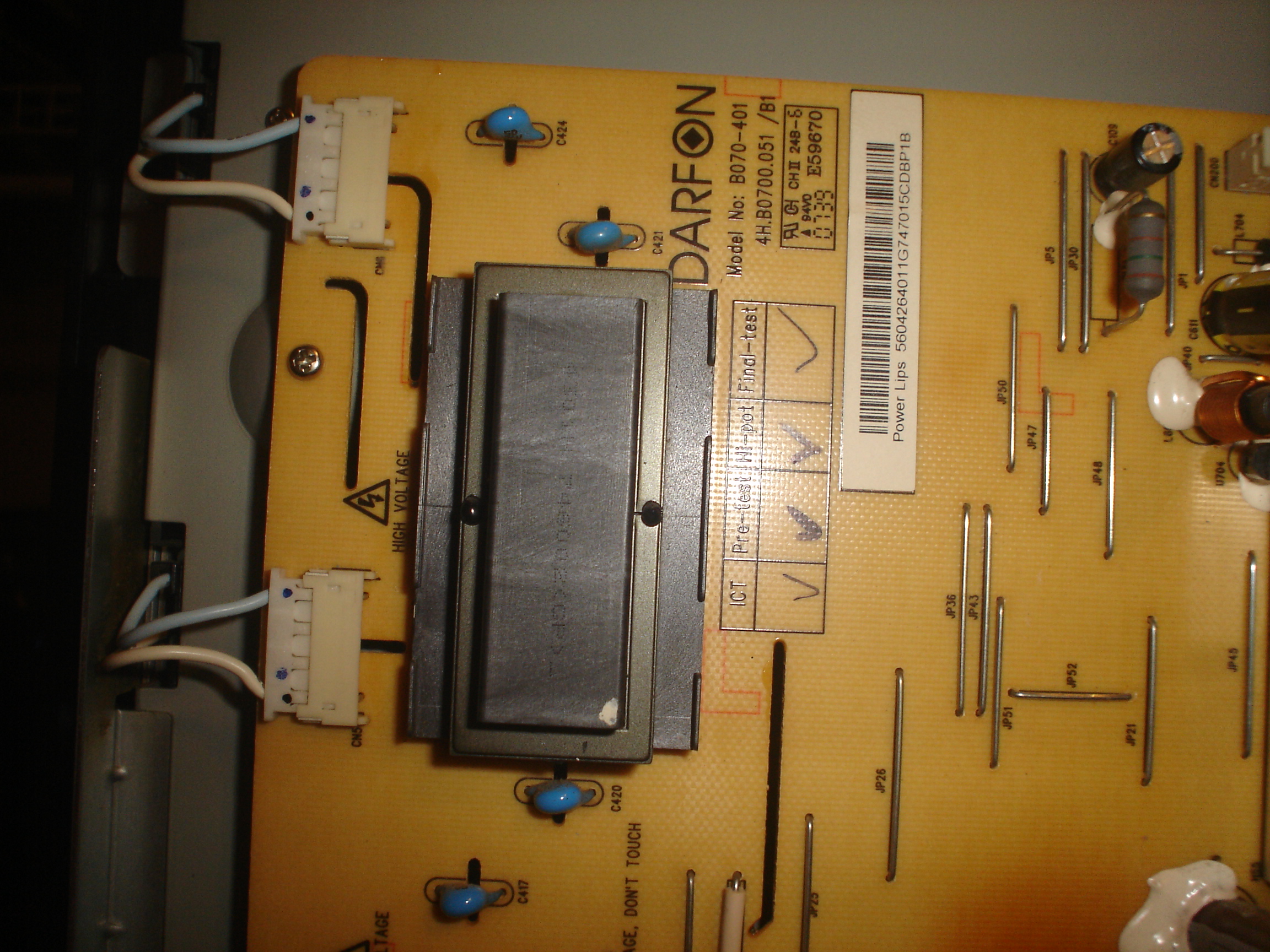

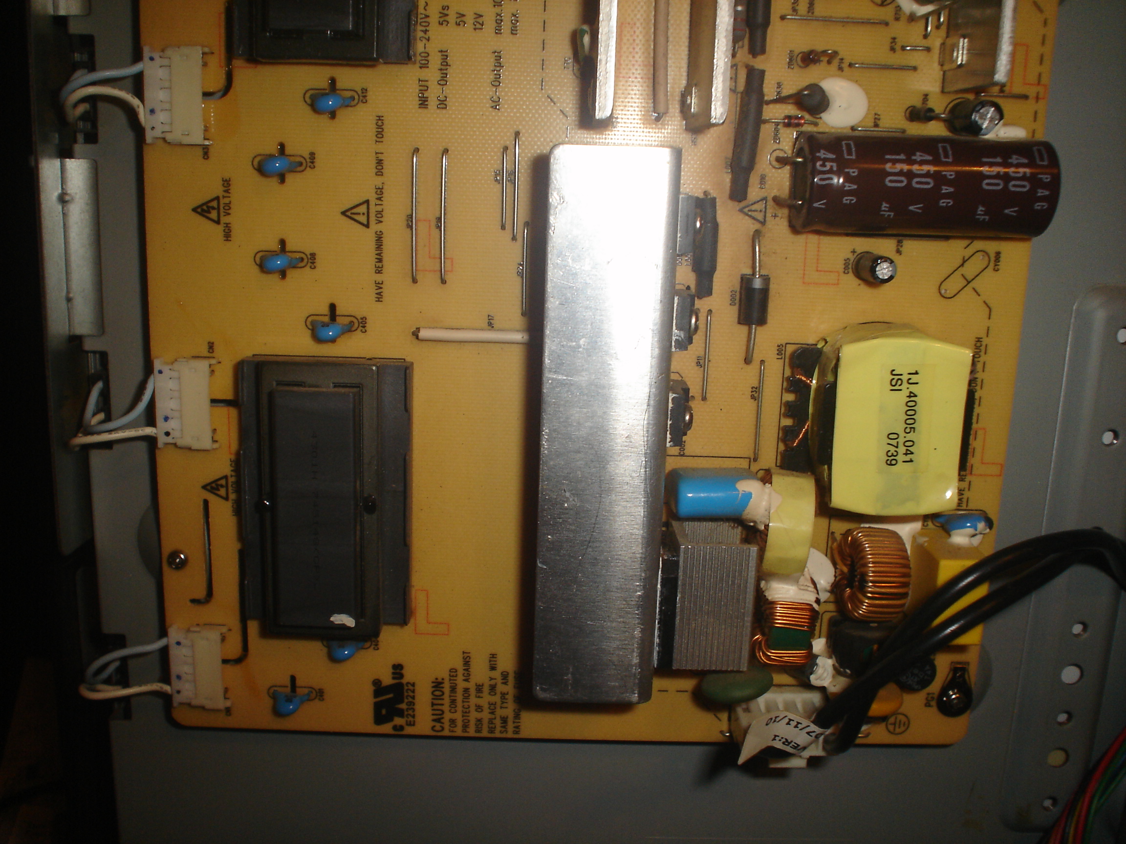

            Okay. Borrowed the wife's camera and have some assorted photos. Keep in mind I'm not sure what is going on with the replacement inverter. It has some odd coating like an clear coat of some such thing. It really looks like a smeared up mess on the photos.
            Also I'm not compressing these photos. Please let me know if they are to big or not quite right.
            There is one capacitor that looks flat out no good. That's the one with the green plastic covering next to the heat sink. The top is bulging slightly.
            So other then only knowing that all the inverters checked well within their expected resistance. All the little green guys show full "OPEN" or Max resistance? I'm still at a loss.
            What does everyone think? Should I just order in the eBay kit
            http://www.ebay.com/itm/Westinghouse.../230862176170?
            And swap out all of them? I really do not know if that would cure this or not? As I mentioned before, The set worked 100% before roasting the inverter output for only one lamp. I still can't get over that it didn't shut down on the spot. It waited until after I inspected the damage--and then figured out how to use the safety.
            Please also keep one thing in mind. While I do work as a tech, it's not board level repair. It's voltage checks, mechanical checks, parts swapping to identify bad boards. We have a service dept that handles all the detail stuff. (In other words, I can do voltage checks, and all checks that my limited meter can do. As far as ESR and component checks? That will get a bit sticky.) I can take direction extremely well, provided a basic multimeter will do. I'll check the one at work to see if it has a capacitor ability---but I think it's a normal hobby type.
