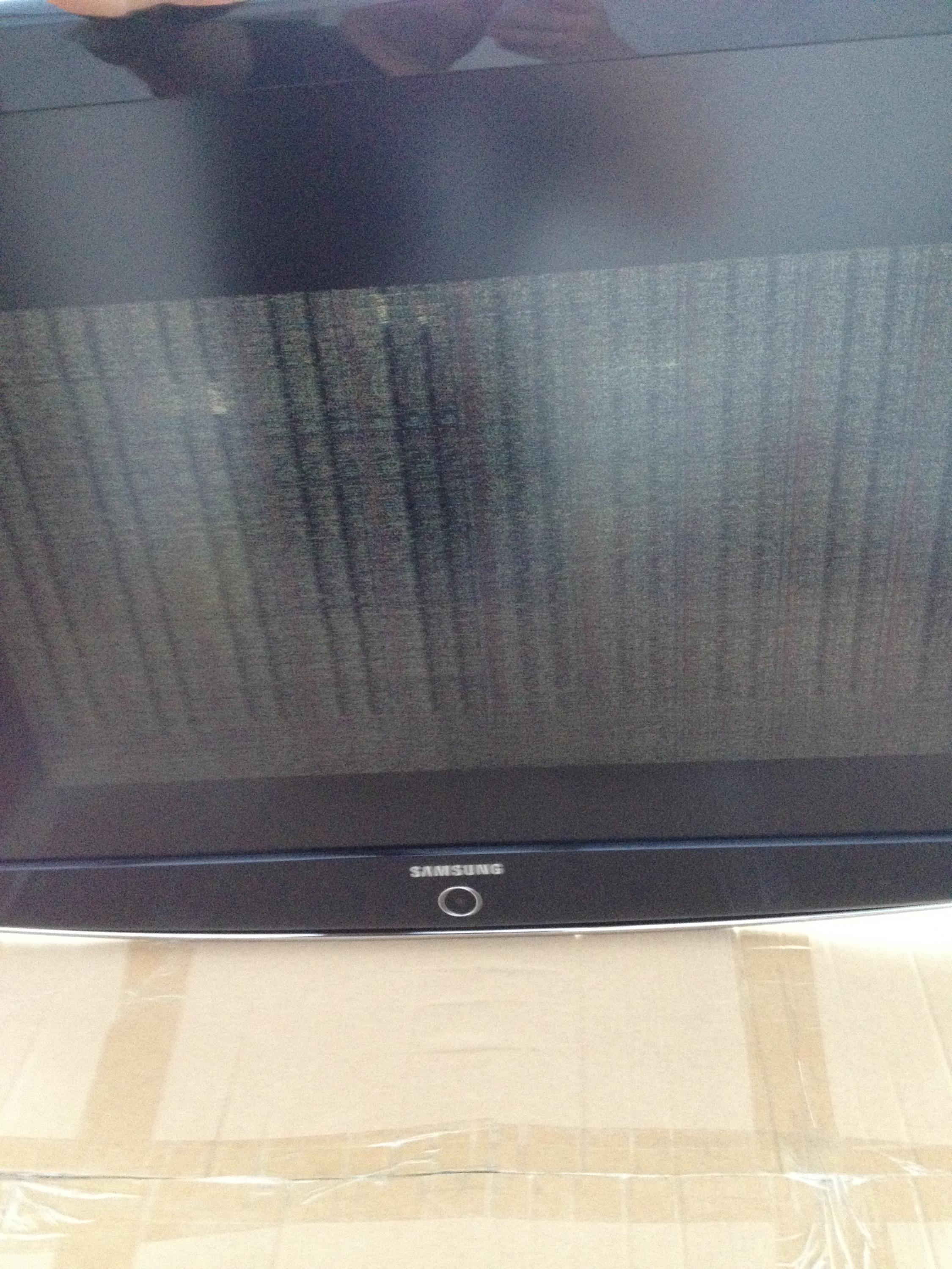

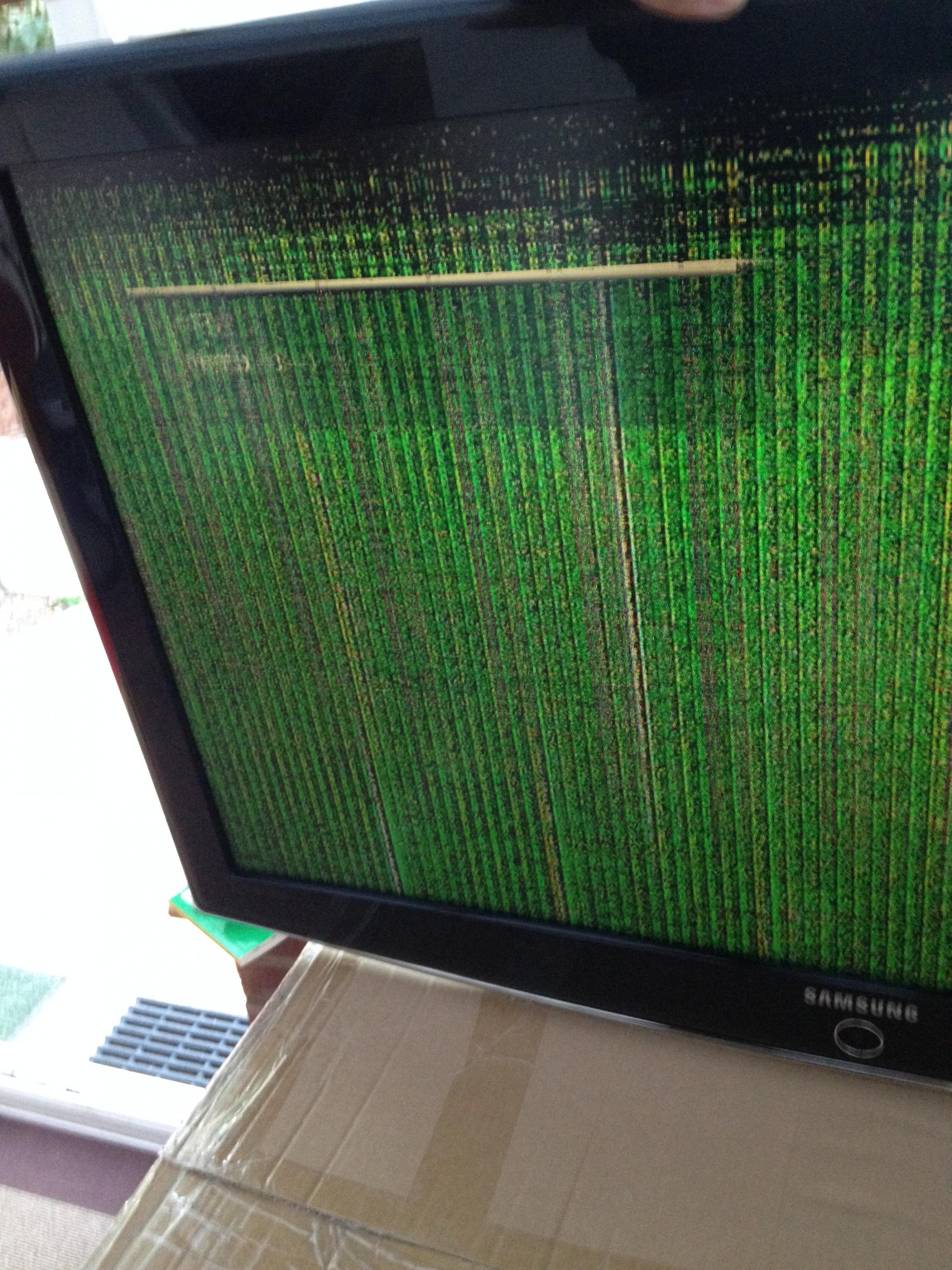

                  Hello I have the same problem on my le40r87bd.
                  After I changed all the bad capacitors and reset the ic eeprom and after changed the eeprom with a new one I have the same graphical problem
                  Tv starts first time with graphical glitches see photo and about 2 -3 restarting the picture is getting better and after 2 min is perfectly fine.
                  Is this mean is the main board faulty any idea ?
