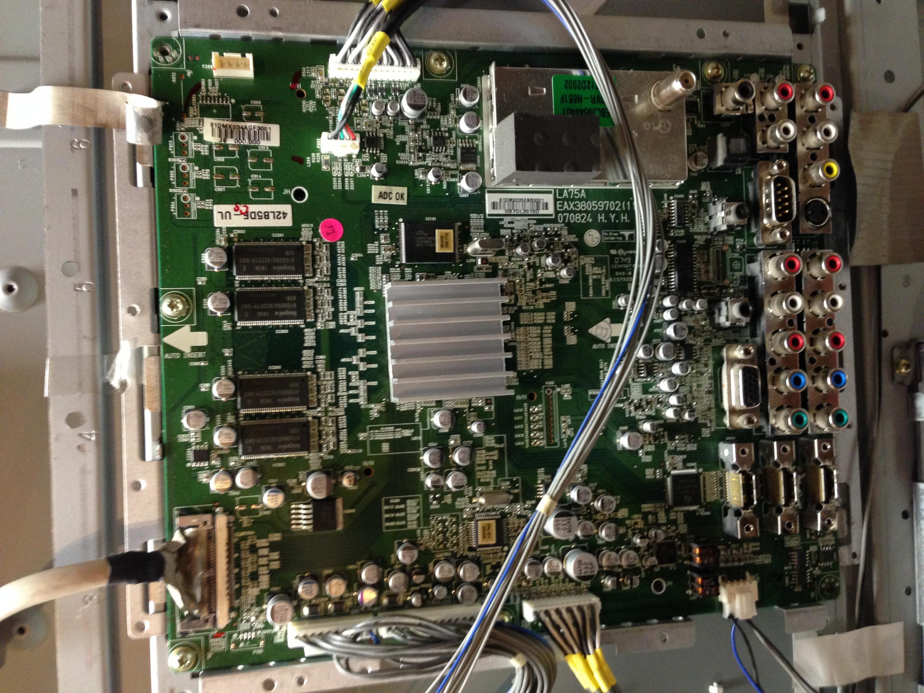

    Hi all!
    As the title states, I have an LG 42LB5d that has sound, but no video or back light.
    I have a workhorse Fluke multimeter to test with. I do not have access to a scope.
    Here are some pictures of the boards, (all but the TCON, which is really tough to get to, but I can snap a pic of that if need be). I do have access to a macro lens if closer pictures are required.
    Thanks in advance to this great forum!

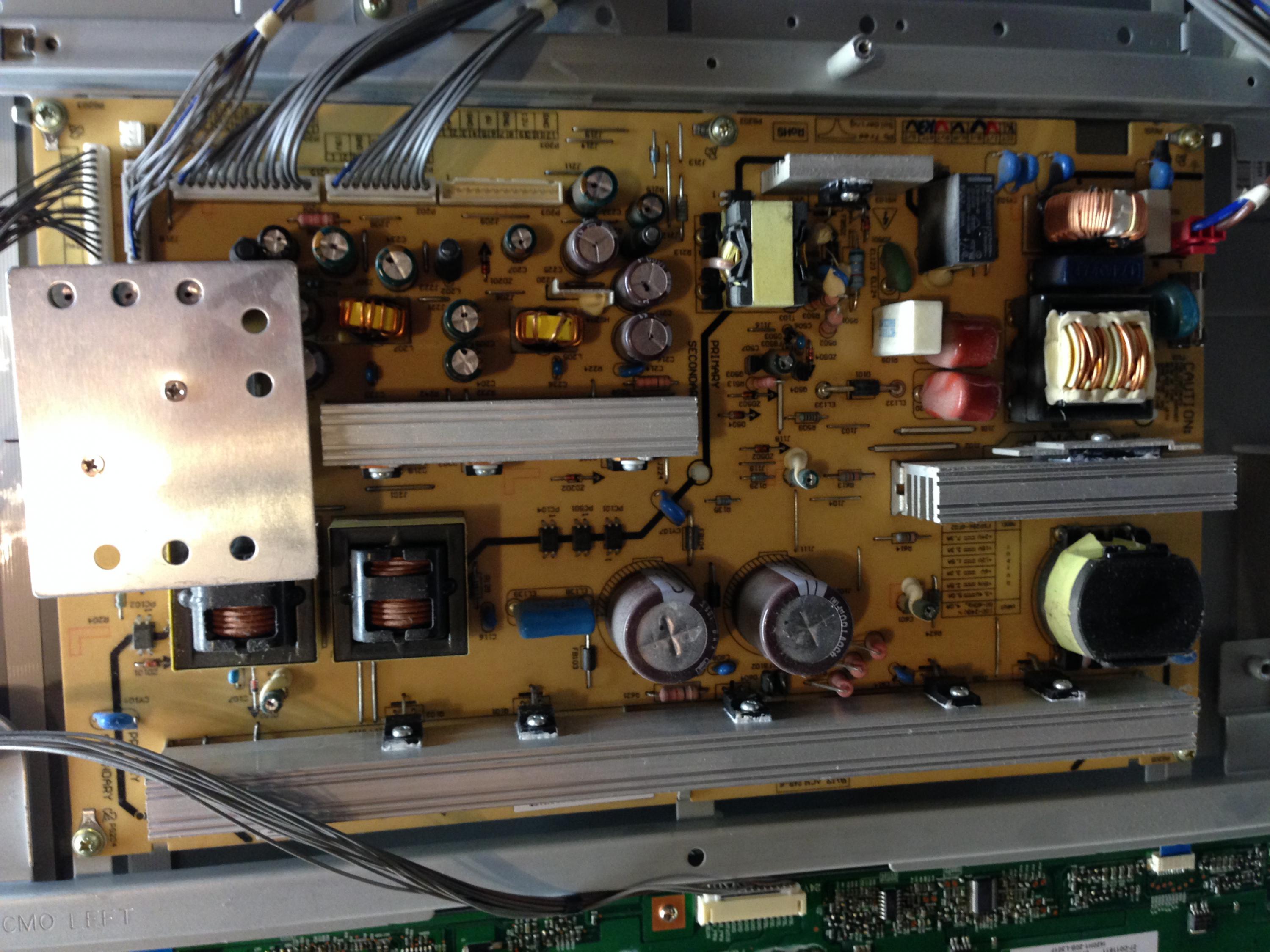

    Remove the heat sink on the left side of your picture on the power supply. Looks for swollen caps under it. Regardless of whether or not you can see any, I'd replace all of the Capxon caps in that area. I have 5 of these that all exhibited that symptom until I changed those caps.
    Reference my listing here:
    http://www.ebay.com/itm/LG-M4210NJ-M...item43c8159353
    You can see 3 of them just above the plugs on the lower right of my picture that I've replaced. I believe there are 4 others under the heat sink but I don't have the boards with me right now to look at.

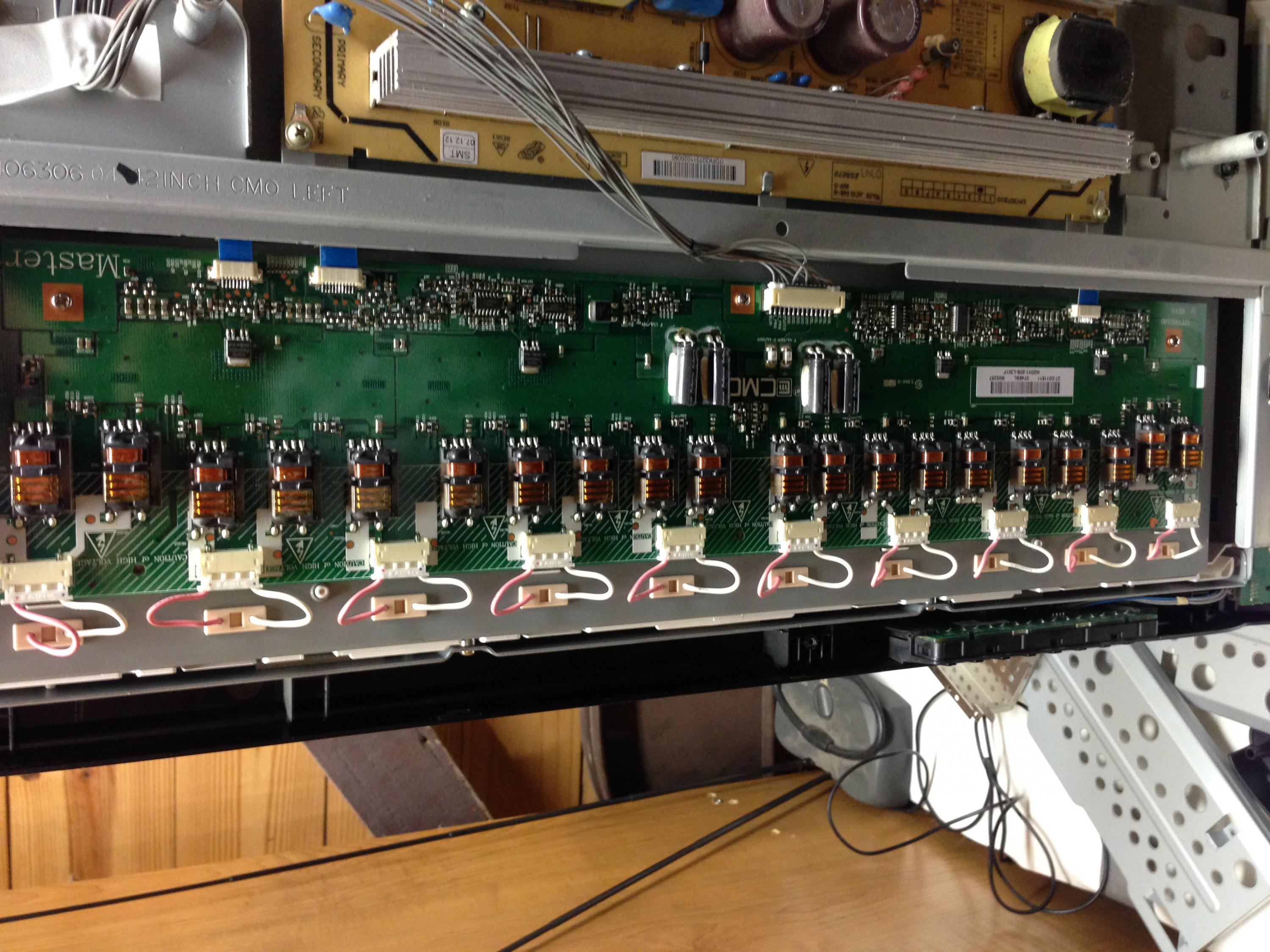

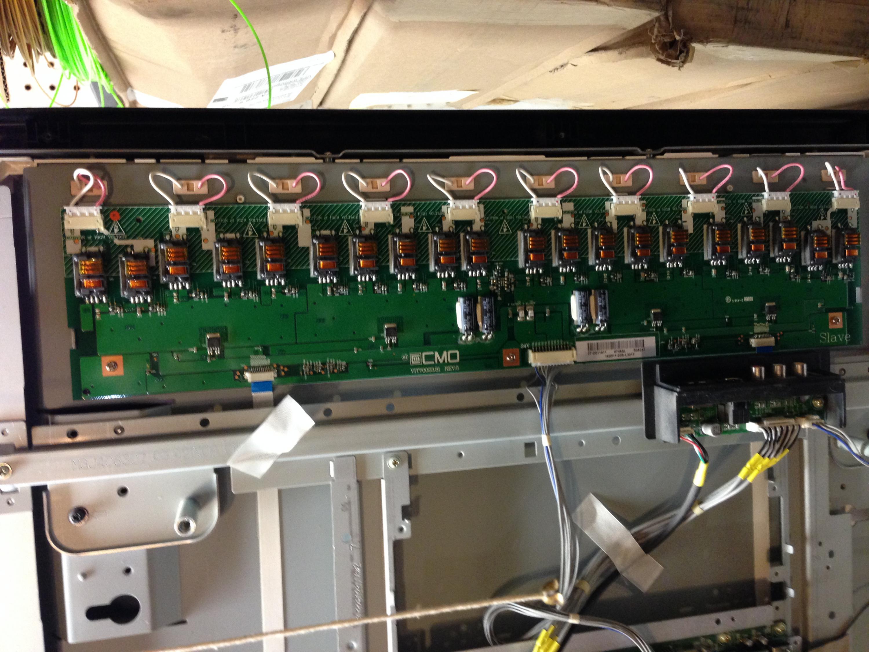

      Oh, and also check the fuse and capacitors on the inverter boards. The caps fail on these all the time. If the caps look bad and the fuse isn't blown, you can probably just replace the caps. If the fuse is blown, inspect the small 16 leg IC on each board. I cannot remember the number on it right now, but it seems to blow out once the caps get to a certain point. Typically, it's very evident by appearance if the fuse is blown. Chip will have missing / burnt legs, or a hole in it.
      Keep in mind the link I sent you to my Ebay item is a slightly different board version than yours but looks like the caps are in the same place.
        Re: LG 42LB5D No video or backlight, sound functions
        http://www.shopjimmy.com/media/catal...0058-top_1.jpg
        Do you have 24VDC right at the inverter connectors? All the fuses on the inverters are OK?
        What DC Voltage do you have on pin 14 bl_on PIN?
        Check the black fuse F1 (F 1.5A/76V) with 'OE' on top also, CMO Inverter boards are known for having this fuse going bad.

            I have 24v at the connectors, and 3.3V on BL_ON.
            The black fuse tested good.

              @aaronwt6 I replaced those capacitors and there was still no change

                  Remove the ribbon cable going from the tcon to the Master inverter and power it up and see if you get a backlight. I had one of these that needed a new main board but for some reason the backlights wouldn't come up with that cable attatched even after replacing the tcon. Never troubleshot it further.

                    Did the new main board get it to fire up? I unplugged that cable and indeed the backlight did come on.

                          @budm The only thing i did to get the backlight up was unplug the connector from the TCON. There is no picture, just a black screen with a backlight. The menu does not show up when menu button pressed.
                          @aaronwt6 I checked the voltage on both side and it was 1.46 VDC on both sides.
                          Thanks gentleman!
                            "@aaronwt6 I checked the voltage on both side and it was 1.46 VDC on both sides." Is that with reference to the chassis ground? If that is the case, the main board is notsupplying the Voltage (12VDC) to run the T-CON.

                              • mmartell
                                • Oct 2013
                                • 3189
                                Yes a replacement main board solved my problem. I put the set back together without reconnecting that ribbon and gave it back to my neighbour.
