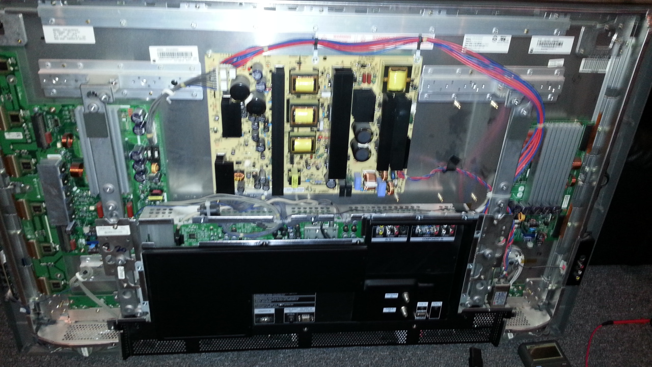

LG 42PC3D Bad Z-Sus IPM ?
  • mmartell
    • Oct 2013
    • 3189

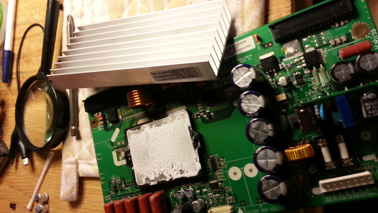

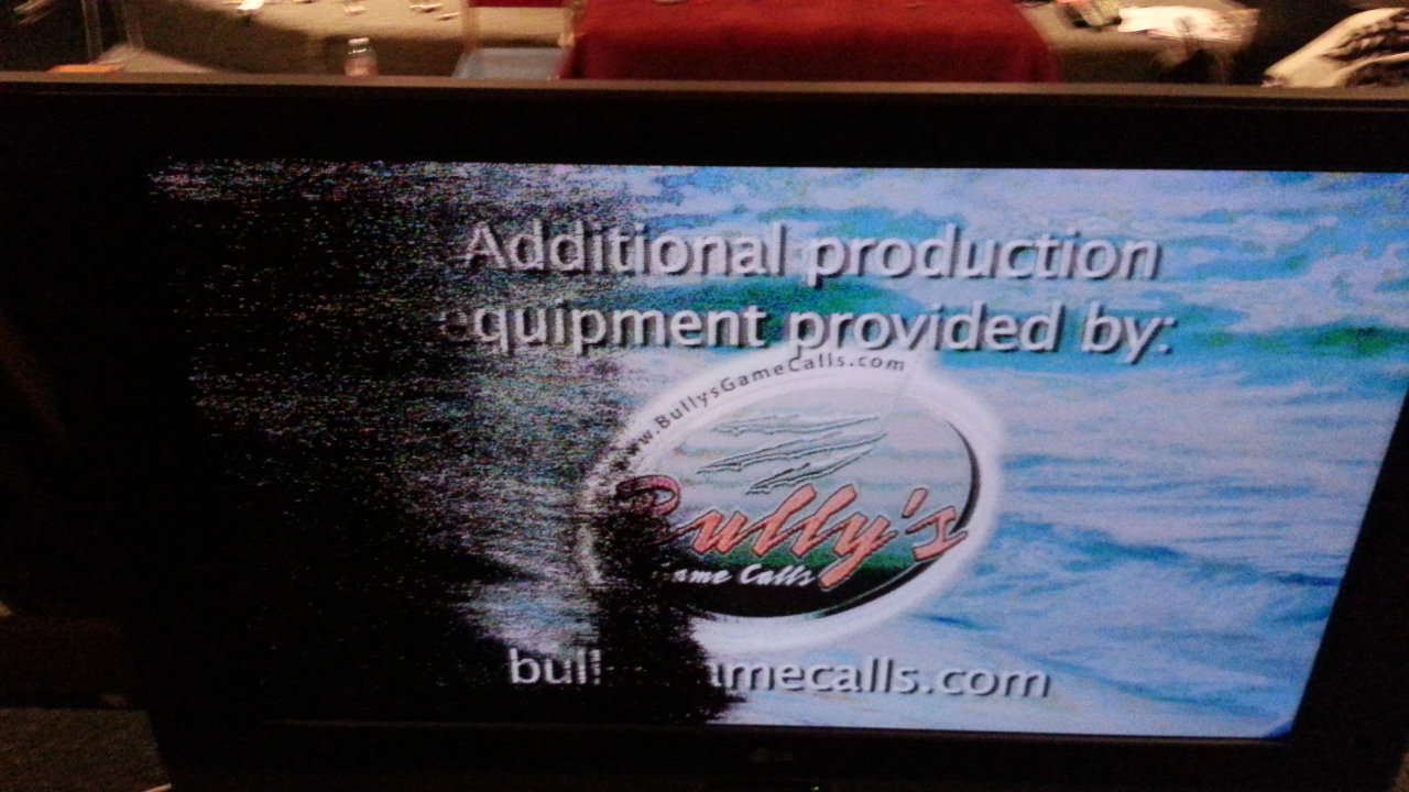

    What confuses me is there are no blown fuses and all the voltages are there and in spec. The ipm heatsink is cold. There is a short registering between Sus_Out and ER_Up_Out/ER_Dn_Out but I've read these are shorted on the board anyhow.
    When the zsus is removed the pic remains the same except there is no random sparkly noise and strobing as there is when the zsus is in.
    Is this classic ipm failure or should I be looking at logic signals from the control board ?

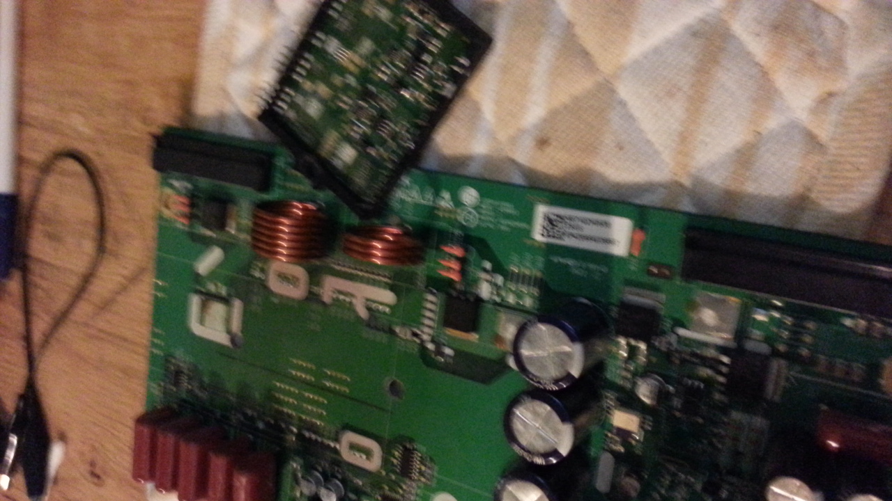

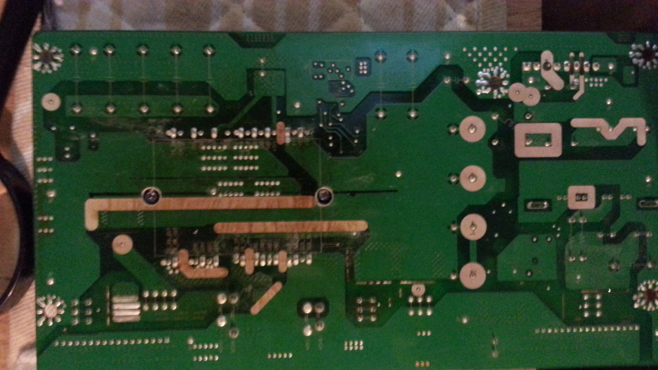

                    I looked for a replacement and they mostly appear to be pulls so I found a used board which is *supposed* to be working.
                    So now I thought lets get this ic off the old board anyway, but even with a paint gun I couldn't seem to get enough heat to lift it. Can't take off the heatsink because of the way it's mounted.
                    Or can you ?
                    Measured out where the screws were and drilled some 1/4" holes and removed the screws and the heatsing then lifted the ic with alot less heat. Don't think I drilled through any arteries but can't test without installing a new ic.

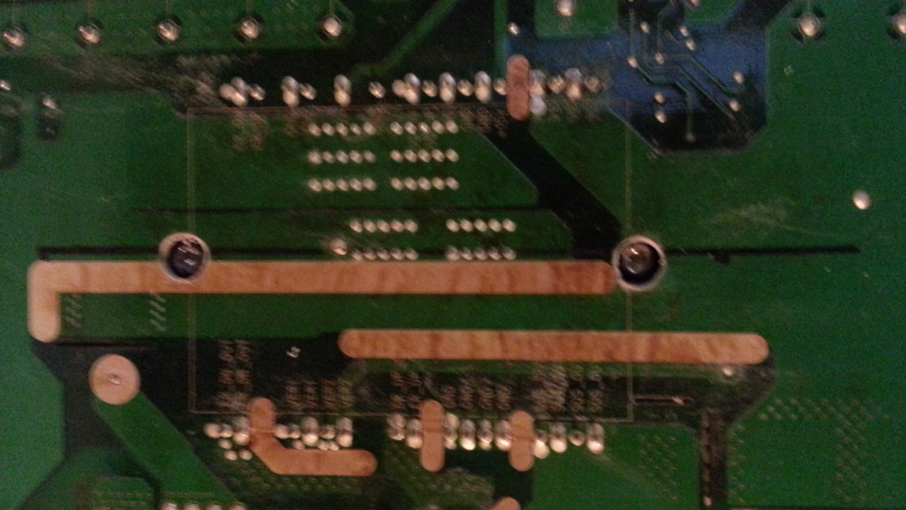

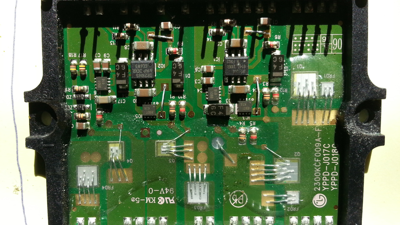

                      Had a look at the ipm itself. These things look fairly simple, why don't people undertake repairing them - those that don't blow up I mean, mine still looks like new.
                        Re: LG 42PC3D Bad Z-Sus IPM ?
                        The magic in the IPM happens in the hybrid module bonded to the back of that PCB. You can see the bond wires. They go to high-power IGBTs. Those are what fails on these IPMs.
                          Or can you ?
                          I've often wondered why they didn't put some holes in the board where the screws are or thread the IPM and have the screws go in from the top. It's nearly impossible to get those off without making somewhat of a mess of the board. I'd consider myself quite good at parts removal. I have all the right tools for the job and it's still difficult.

                              Originally LG intended the boards to be non serviceable. You'd return the board to LG as a core.
                              The move to IPMs was intended to improve their reliability - indeed it worked well for the 42V4/V5 panels and I can't remember many 42X1 or 42X4A panels with IPM failure. However it appears that there was a manufacturing defect with the IPMs leading to their frequent failure on 42V6/V7 and 42X2/X3 (and the 50X1/X2/X3)

                                didnt one member repair his own ipm? i cant find the post something about info he found on a polish forum?
                                edit found it!
                                https://www.badcaps.net/forum/showthread.php?t=34766
